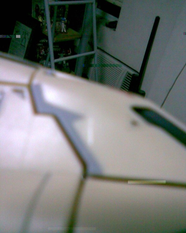

melbin234 Posted February 24, 2009 Posted February 24, 2009 i bought my yf-19 last jan, and left it inside the cabinet, then i tried to transform it for the first time at battroid mode last feb 21,. it was already a disappointment everything was so loose and to my surprise the head part fell off thinking maybe its just a loose connection but NO it turned out to be a big crack which causes the head and hand part, to be detached from the body. after experiencing this, sad to say, im not a yamato fan anymore but still a macross die hard, im suppose to buy the vf-1a 1/48 hayao kaizaki, vf-1a with super &strike parts hikaru, and the vf-oa...... its my hard earned money..... and im buying a new and free defect toy not a problem toy, which causes sleepless nights.... im sorry for being too harsh on yamato. Quote

UN_MARINE Posted February 24, 2009 Posted February 24, 2009 (edited) you guys might want to check the hip parts beside the neck part with said fracture. right in front of the painted gray arrow/line detail & behind the intake. mine has fractures on both hip/intake parts, they go all the way through to the gray hip balljoint part. it's amazing they even cracked there, all my YF19 does is stand. i don't even transform it much. EDIT: pic! there it is right in the middle of the picture. sorry about the bad phone camera pic. Edited February 24, 2009 by UN_MARINE Quote

m0n5t3r Posted February 25, 2009 Posted February 25, 2009 no cracks yet on mine w/c i got just last year... but i did loosen the screw w/c is on the right side of the neck to relieve the stress it was putting on the plastic w/c might have caused the crack on melbin's 19... Quote
