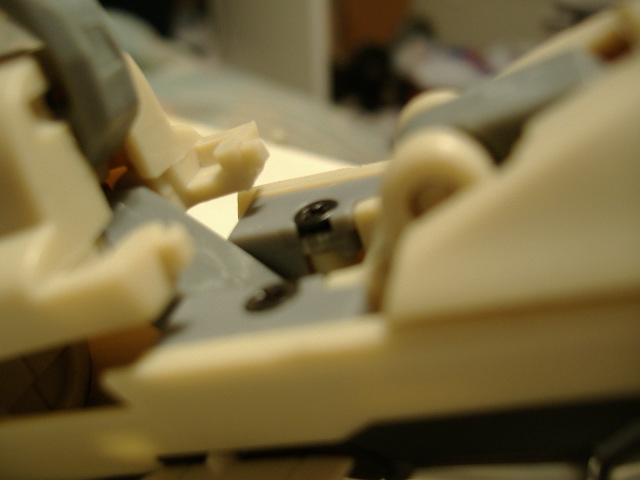

Wicked Ace Posted January 25, 2007 Posted January 25, 2007 (edited) Just what we need, another -19 thread. Anyway, I'd like to address the primary, big, debilitating, sorrow-inducing, major problem experienced by some -- the fuselage problem. I posted a picture of what to look for in Graham's review thread, but I suspect it will escape some, as the thread has grown to 50 pages as of now. I hope this thread is allowed to remain, not to induce panic or Yamato-bashing, but to inform. I hope this is helpful. If you have stress marks (or a break), please post up so that we can find out how widespread this is -- hopefully we only have a few, isolated cases; also please include when (approximate date) you ordered or received your impaired -19. For those that have a -19, here's what to look for: white stress marks under the black screw heads. Edited January 25, 2007 by Wicked Ace Quote

Beware of Blast Posted January 25, 2007 Posted January 25, 2007 Loosening the screws will worsen the problem in the long run becoz the grey plastic halves are suppose to be as tightly attached to the tan plastic as possible - I tried loosening mine but they were glue on as well. Here's something to think about - what happens should the screw threads on the tan plastics' side get worn down and they no longer hold the black metal screws and they won't tighten no more no matter how we try to fasten it? Quote

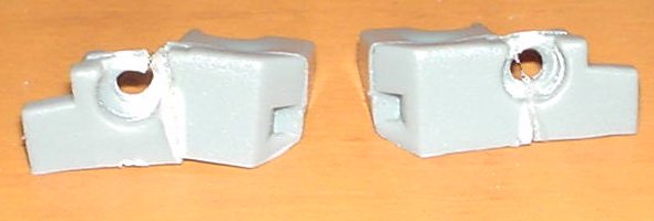

valhary Posted January 27, 2007 Posted January 27, 2007 [attachmentid=39975]In my yf19 the grey blocks are broken in both sides and i received in 1/06/07 why yamato dont do this parts in metal like bandai Quote
do not disturb Posted January 27, 2007 Posted January 27, 2007 Here's something to think about - what happens should the screw threads on the tan plastics' side get worn down and they no longer hold the black metal screws and they won't tighten no more no matter how we try to fasten it? try your best not to strip the plastic. make sure when you go to tighten the screws again, its using the same threads created from the very first time the screws were put in. its not hard to tell, the screw should go in pretty easily and shouldn't require much torque to tighten. if you have to use force, then you not in the right groove. i hope that makes sense? Quote
grouchy_smurf Posted January 28, 2007 Posted January 28, 2007 [attachmentid=39975]In my yf19 the grey blocks are broken in both sides and i received in 1/06/07 why yamato dont do this parts in metal like bandai woah that's nasty...and it's not even a month yet Quote
