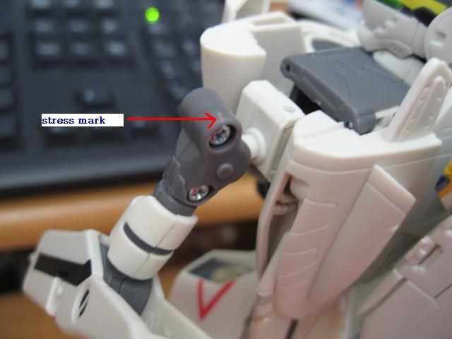

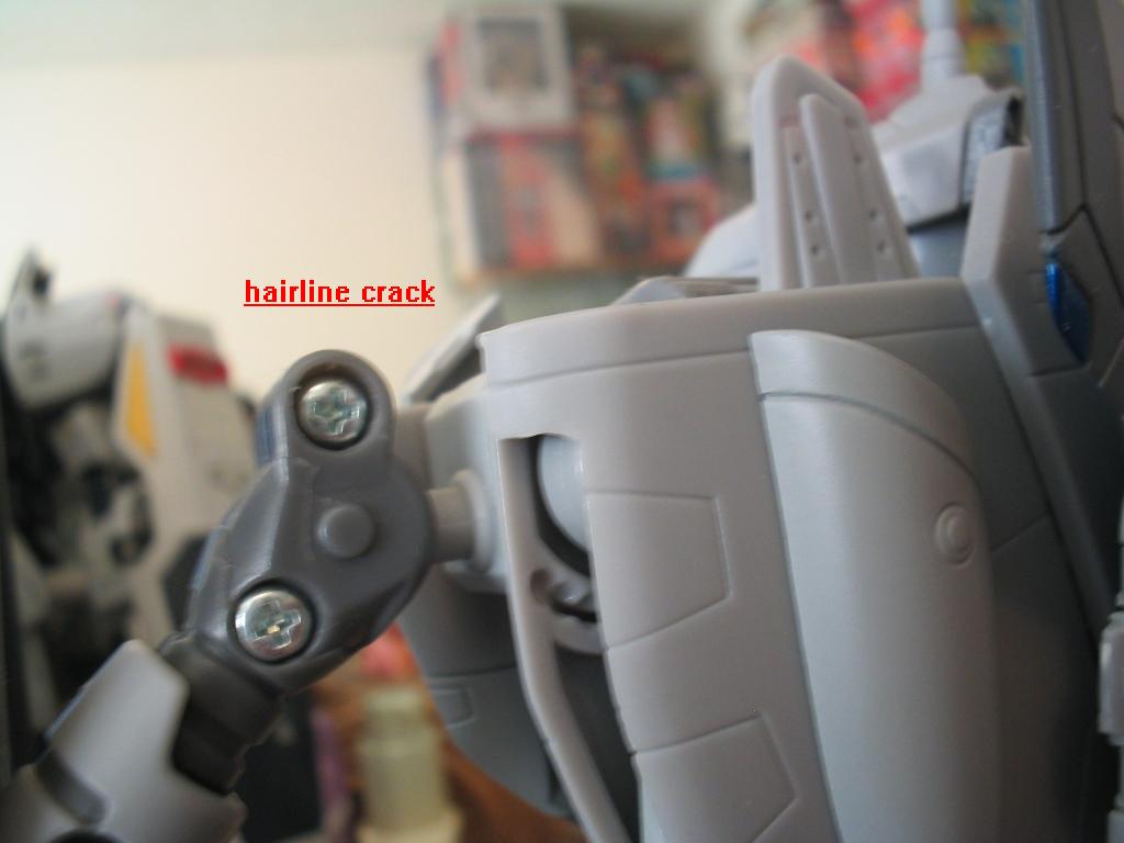

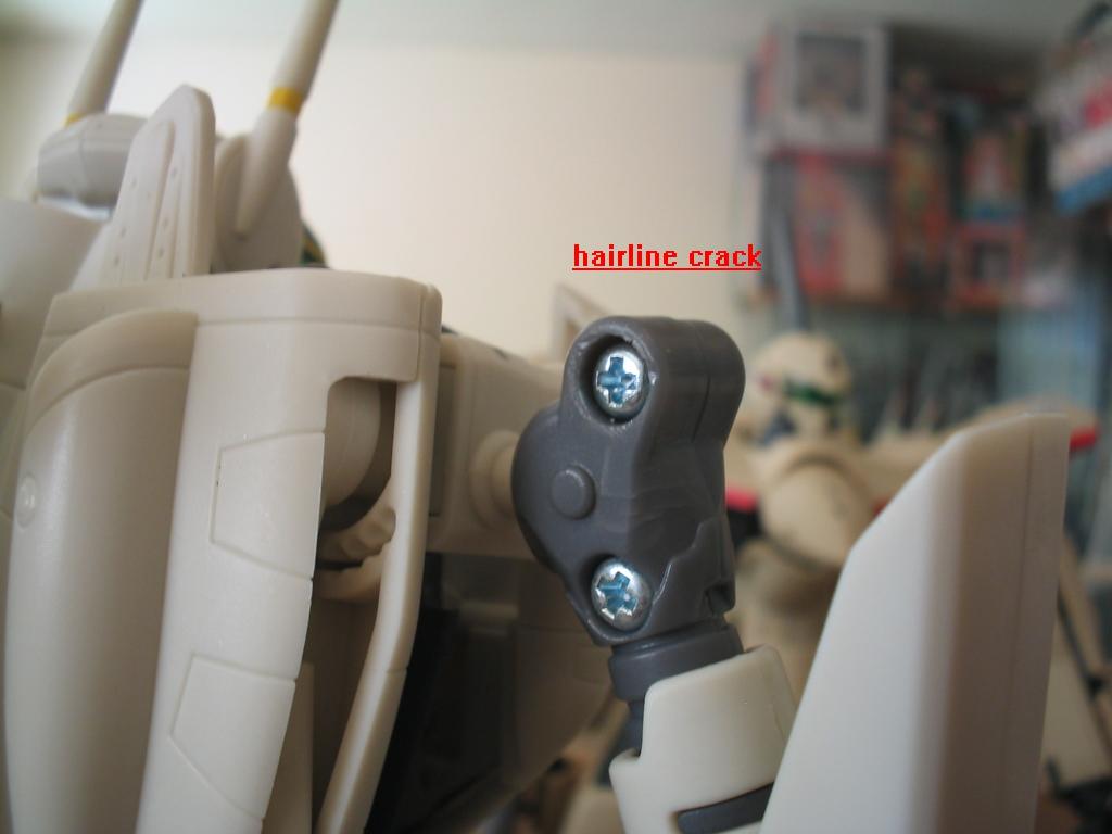

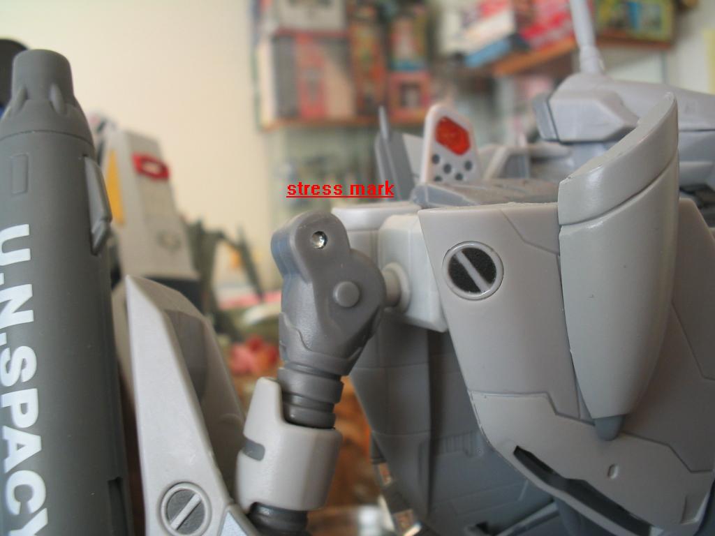

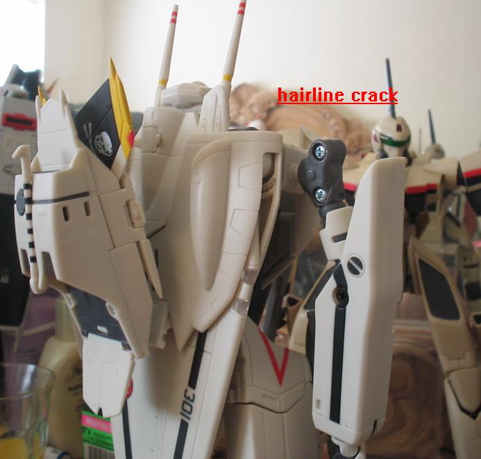

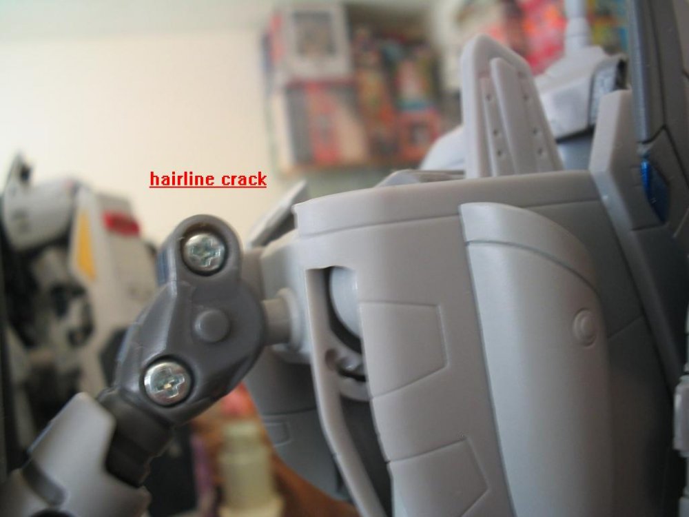

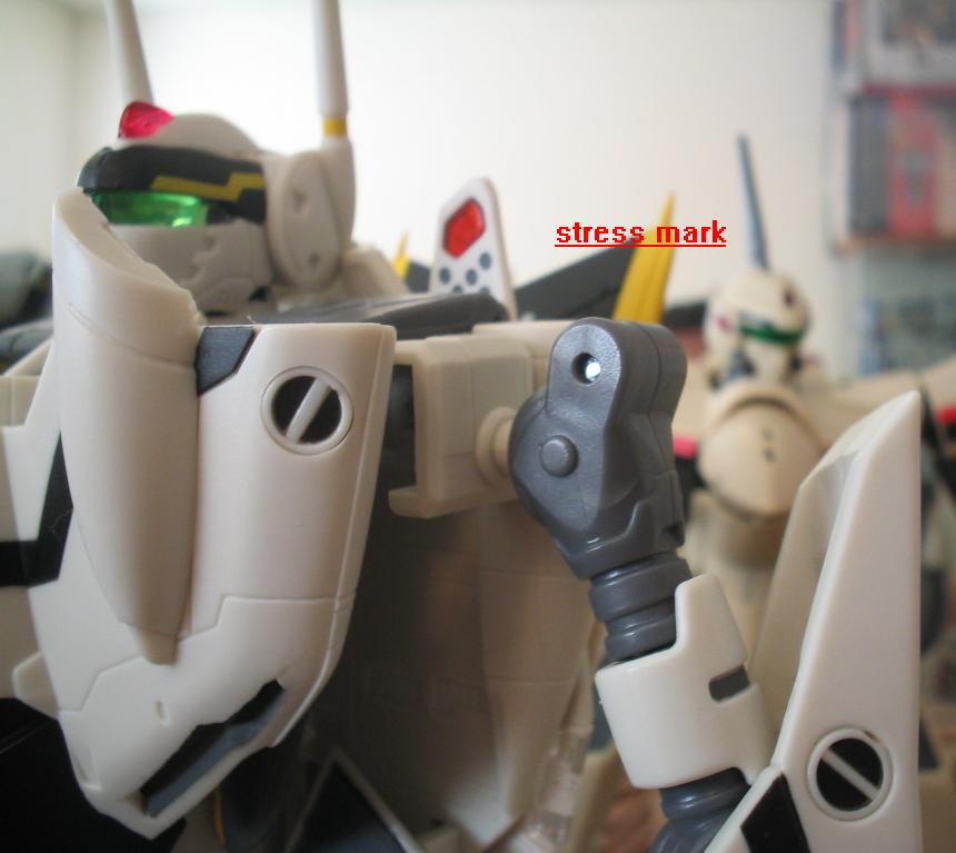

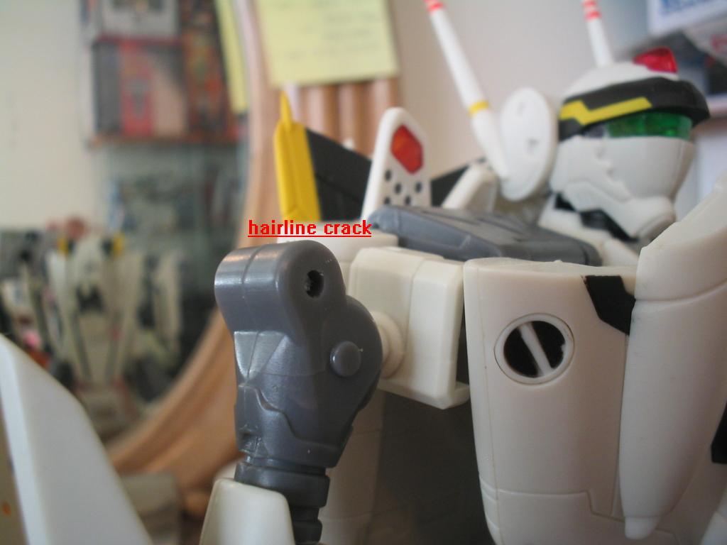

I just steeled up the nerve to take my 0S apart and check it. Sure enough, the left shoulder joint is heavily stressed and has started cracking through, though it is still intact. The pattern of the stress is the same as in eugimon's avatar. The right shoulder shows stress marks, but it is not nearly as far advanced as the left. The left shoulder pivot was the tighter of the two (have since loosened the shoulder screws slightly), so the additional stresses stand to reason.
I will get pictures up as sson as I can. Might be tomorrow.
here's some pics of my 1/60's somewhat busted shoulders graham. i took the liberty of checking my 0A thoroughly and of course there's stress marks and a "Y" hairline crack on the same shoulder. :angry: i've only transformed this valk into battroid mode and it has stayed that way ever since... same goes with my two 0S valks. talk about fragile shoulders. <_<
Do not that many people on these boards on a VF-0 yet? Seems like there should be more responses here. Either that or maybe the word is sufficiently out now and everyone knows to immediately unscrew the shoulders on their zeroes now.
