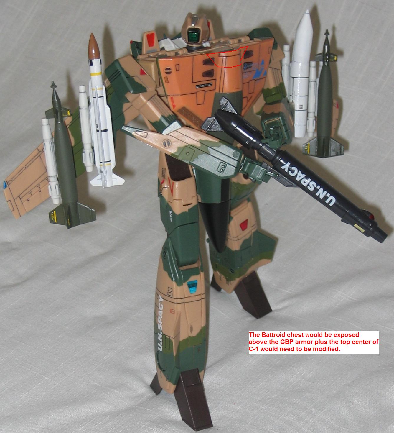

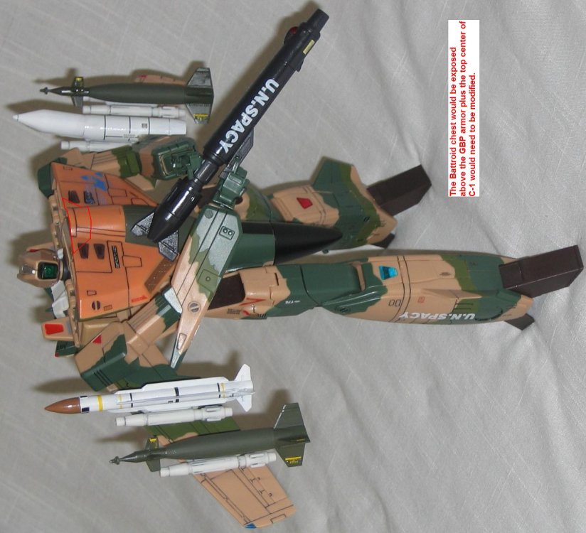

Yes, It is possible if part C-1 "Chest" is modified to fit the higher chest of the VF-1D. The top of the Battroid chest would be exposed.
Without cutting C-1 the chest armor will not fit since it locks on the exposed hinges on the top of the chest.

cool missiles where'd you get them?

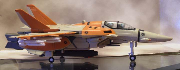

edit: i know its a 2 seater and Graham already said that 2 seaters aren't being considered right now
but Cap made it. They made it in 1/60 why not a 1/48
http://www.macrossworld.com/macross/toys/vf-1d/fighter1.jpg
http://www.macrossworld.com/macross/toys/m...urt-vf-1d-8.jpg
1/60 1/48

Macross73: The wing stores are from Hasegawa 1/48 Weapons Kits B and C.

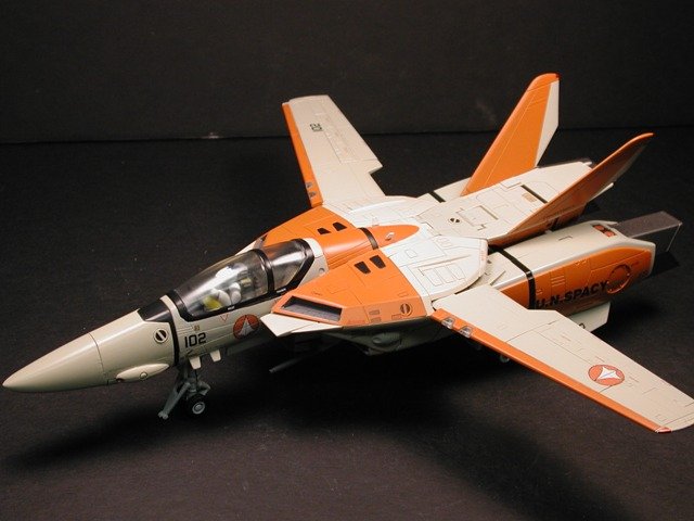

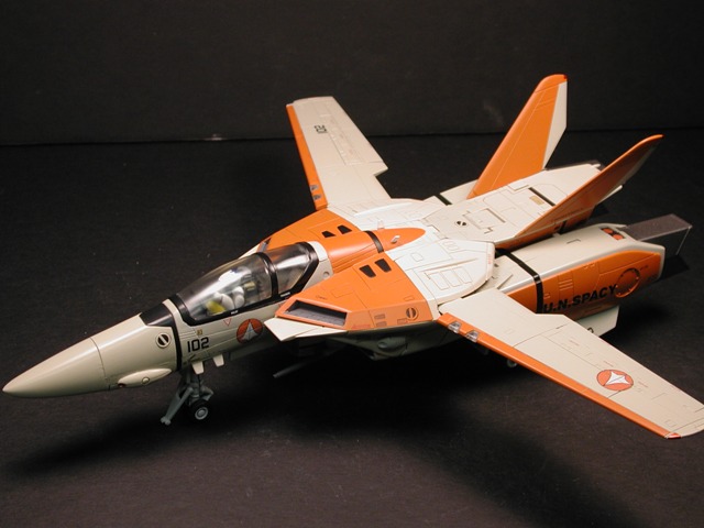

Yamato could make the 1D if they wanted for the simple reason that I, with a kit and pointers, was able to.

Yes, the list below is what is completely required for the redesign. My broad leap of logic highlighted the two parts that Yamato could not copy from the Captain's kit since the glue verse screw manufacturing would transfer to mass production well.
I did not use the kit trapezoid but modified the origional Yamato so I would not need to match the tan. So the antenna configuation is different and I do not have the Strike part hold down.
I hope that your 1D with heatshield is finished since it was your production photos that helped with mine.
