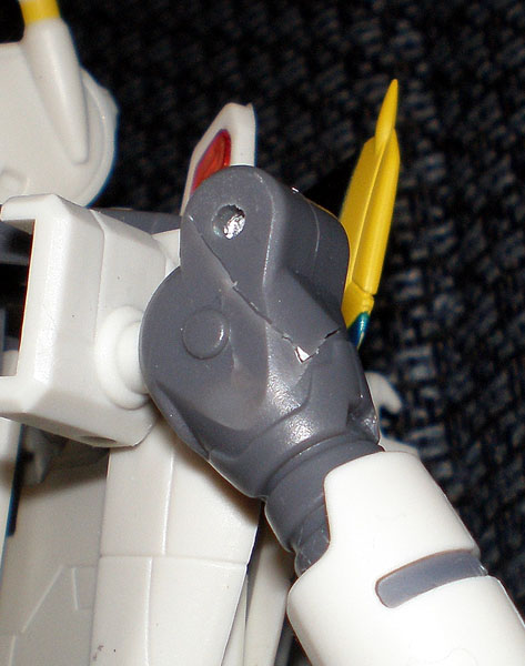

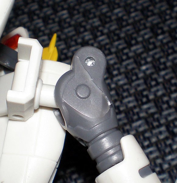

MasterOfPuppets Posted December 23, 2006 Author Posted December 23, 2006 Maybe this should be a dedicated "what's wrong with my VF-0" thread. The big "what's wrong with my _____" thread is a little overwhelming. If someone can change the thread title then I don't see why not since I need some more help. Upon reassembly of the shoulder section of my VF-0S I went about putting the screw back in. But oh no! I did it to tight and a crack formed. Looks like pretty nasty crack too. At first I kinda ignored it and just put the shoulder cover back on. Transformed it into fighter mode. Then transformed it back. After 1 transform it hasn't broken into a seperate piece yet so there may still be hope. After that transform I took off the shoulder cover and haven't touched it since. So what should I do? Just put some glue over the crack? What's some really strong glue and where can I get it? Here're some pics. [attachmentid=39215][attachmentid=39216] Quote

VF-19 Posted December 31, 2006 Posted December 31, 2006 If the shoulders are made of ABS plastic, you may be able to use hobby glue to glue it back together. Most hobby glues, while ment for polystyrene, will work on ABS, and it'll work very well too. Just read the packaging. Alternatively, you could use the glue that's used to glue abs pipes together (it will say on the packaging in the plumbing department). Quote
eugimon Posted December 31, 2006 Posted December 31, 2006 If the shoulders are made of ABS plastic, you may be able to use hobby glue to glue it back together. Most hobby glues, while ment for polystyrene, will work on ABS, and it'll work very well too. Just read the packaging. Alternatively, you could use the glue that's used to glue abs pipes together (it will say on the packaging in the plumbing department). you should be careful when using cements... they tend to melt the plastic to bond it and on such a thin piece like the shoulders, you may permanently deform the part. Quote
VF-19 Posted December 31, 2006 Posted December 31, 2006 you should be careful when using cements... they tend to melt the plastic to bond it and on such a thin piece like the shoulders, you may permanently deform the part. True, that is a major "catch". However, if done right, you should be able to get it back together with no problems! Quote
nightmareB4macross Posted December 31, 2006 Posted December 31, 2006 True, that is a major "catch". However, if done right, you should be able to get it back together with no problems! Also don't forget to give it plenty of drying time. You don't want to stretch parts out of their original proportions. Quote
VF-19 Posted January 1, 2007 Posted January 1, 2007 Also don't forget to give it plenty of drying time. You don't want to stretch parts out of their original proportions. Actually, if you use the glue sparingly, it'll be about 90% dry in about 1 hour. If you cover the part in the glue, then you'll want to wait much much longer. When I'm doing repairs with my Yammies that involve glue of any sort, I give it a minimum of 24 hours. Although, it's not uncommon for me to come back to the toy about a week later. Quote
eugimon Posted January 1, 2007 Posted January 1, 2007 Actually, if you use the glue sparingly, it'll be about 90% dry in about 1 hour. If you cover the part in the glue, then you'll want to wait much much longer. When I'm doing repairs with my Yammies that involve glue of any sort, I give it a minimum of 24 hours. Although, it's not uncommon for me to come back to the toy about a week later. I agree with you, cement gives you the best bond... it's just if you've never worked with it before, you could get yourself in trouble fast. Quote
