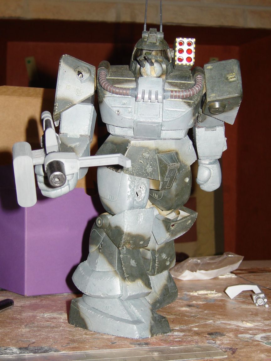

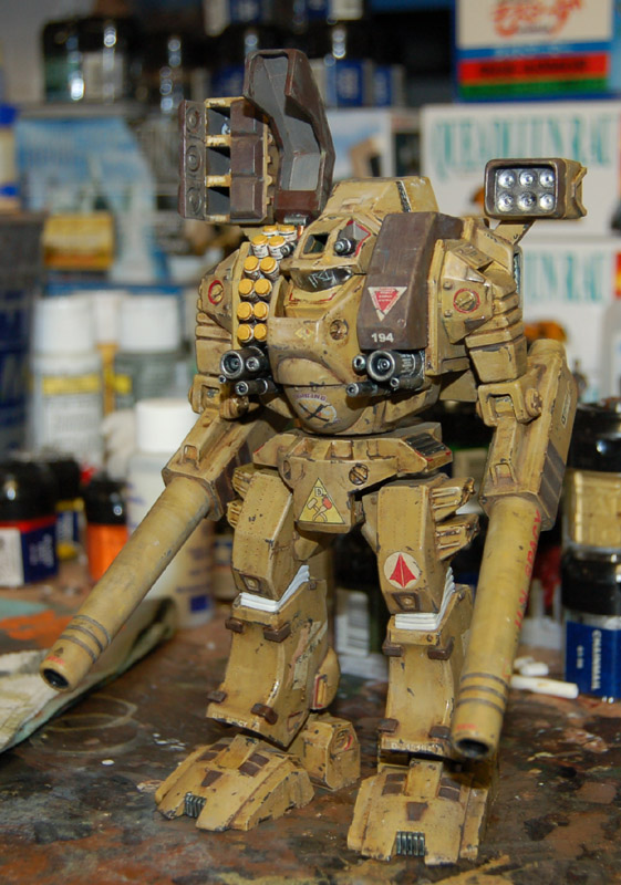

promethuem5 Posted February 18, 2007 Posted February 18, 2007 Hate to double post, but I've got super awesome progress on my 'Hawk... HWR still managed to beat me in the end, but I love working on this kit... Here's a teaser WIP shot... all that's left is mostly dry pigment stuff... scorching and barrel blackening, and to dirty up the feet... gonna treat the underside like a tank tread (lots of earth colored stippling and some mettalics.)
HWR MKII Posted February 18, 2007 Posted February 18, 2007 Looks really good P5. Is it me or did my chipping technique inspire you Also am i the only person besides Mike to build and finish his monster?

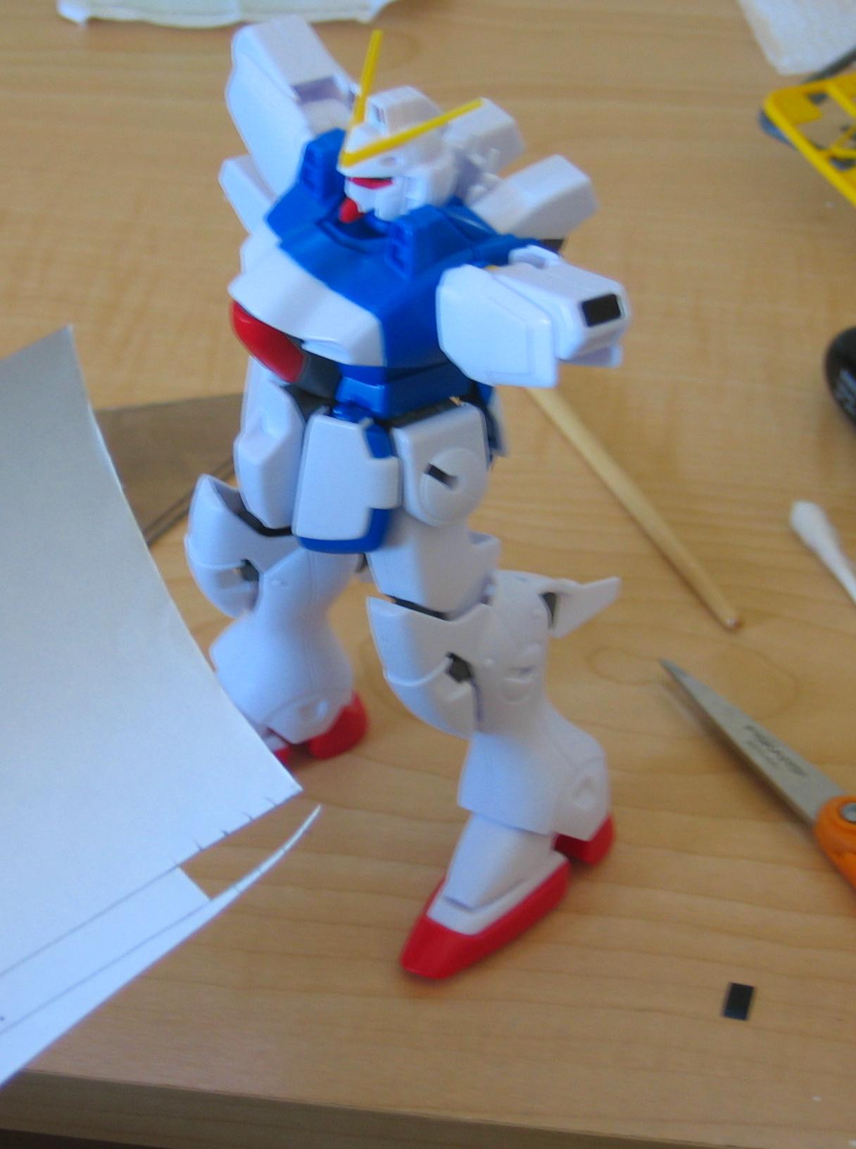

Fly4victory Posted February 18, 2007 Posted February 18, 2007 Wow, You two are at the top of the game. Great work. I would expect to see those in a motor pool next to real armor. All I have to offer is using self adhesive vinyl so you do not need to fill and paint on little Gundams.
promethuem5 Posted February 18, 2007 Posted February 18, 2007 Haha HWR, yeah, your chipping more than inspired me... I l=studied yours a bit to get the feel of how it should look and it helped me alot... finally got chipping to look natural!
Grayson72 Posted February 18, 2007 Posted February 18, 2007 Ok so describe the "chipping" process you two.
HWR MKII Posted February 18, 2007 Posted February 18, 2007 its easy. Get a good reference like heavily used construction equipment or military vehicles. Study how the chips are and the types of edges they form on. Next get a 000 or smaller sized brush. Dip it in dark grey or a gunmetal metallic type paint. Keep a good point on the brush and lightly dab it on the model. Be sure to concentrate on edges and high wear areas. Also try to put a few chips on the flat areas of some panels to add a little variety. It is literally that simple. Mo masking or actual chipping on the model is needed its all paint.
promethuem5 Posted February 18, 2007 Posted February 18, 2007 HWR's got it...I was really impressed with how easy it was once I got it figured out.... I mixed up a dark grey with a touch of brown in it... and used a superfine brush to put it on. It was funny, because I would met my hand shake a little around the edges to amke the chips more random and natural, but had to take alot of breaks cuz my hand would go numb...
HWR MKII Posted February 18, 2007 Posted February 18, 2007 Just remember, Smaller scale=smaller chips.

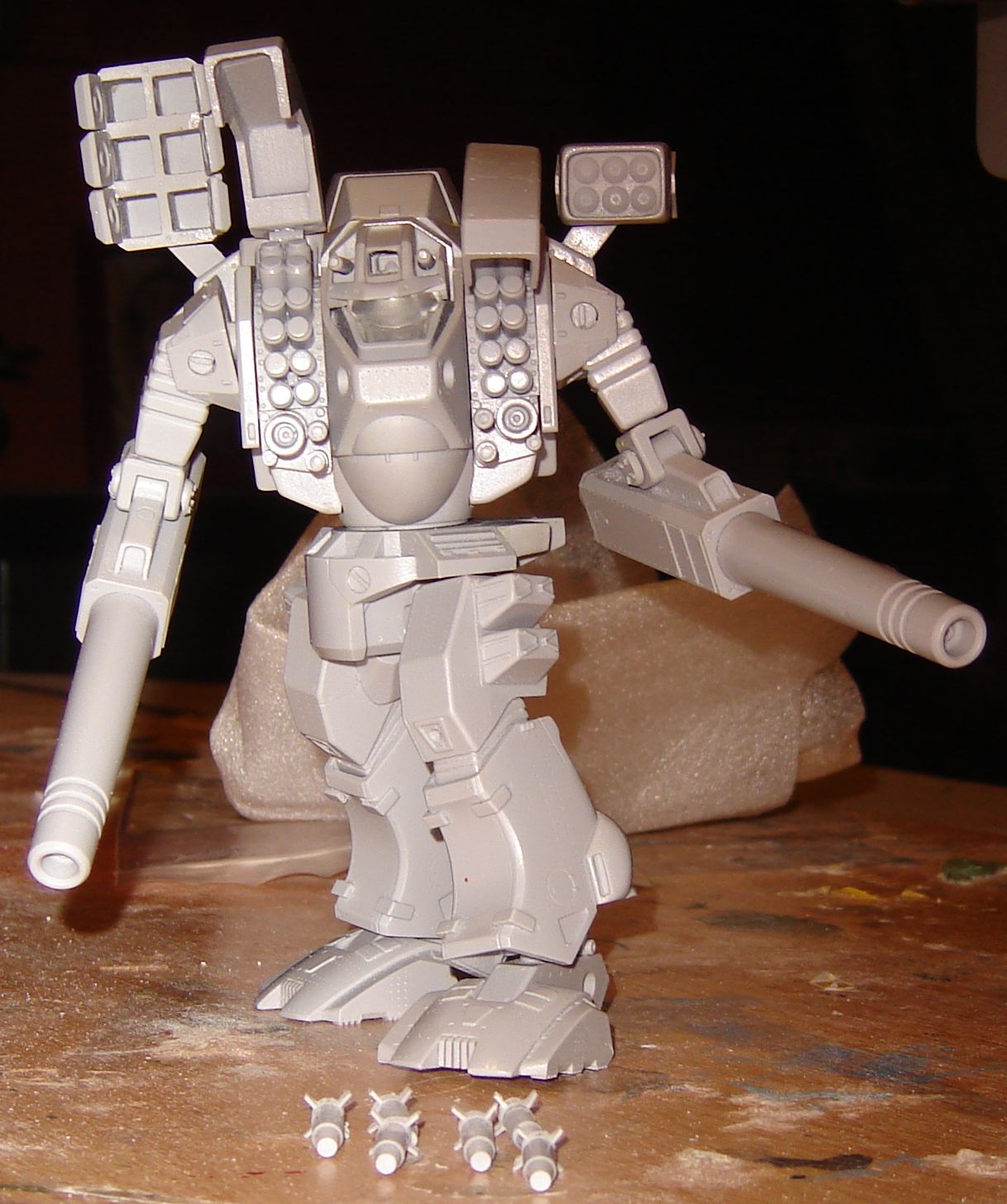

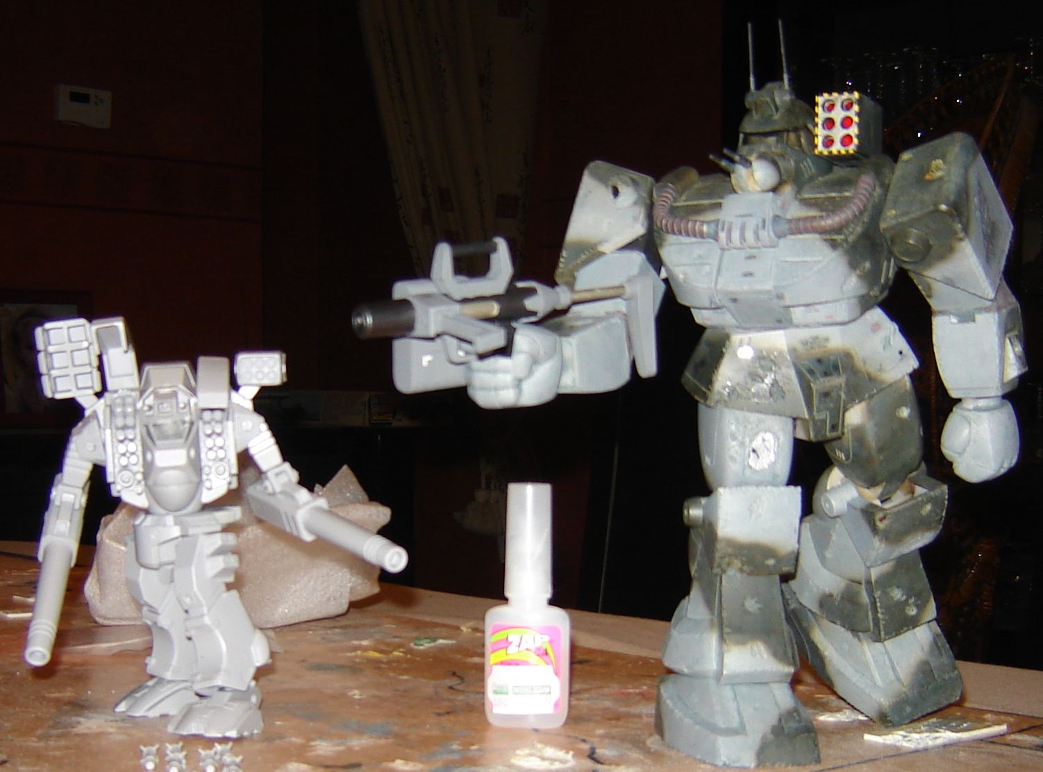

jadefalconguard Posted February 18, 2007 Posted February 18, 2007 On my workbench right now two mecha's at once. The awesome kit from John (ready to paint) and a very old TALOS kit from Revell, heavily damaged in the decal phase. [attachmentid=40583] [attachmentid=40584] [attachmentid=40585]
promethuem5 Posted February 18, 2007 Posted February 18, 2007 Just remember, Smaller scale=smaller chips. And remember, past a certain small scale point (usually after 1/72 i think) it equals no chips bc/ they would be unrealistic in scale... JFGuard, don't you just love those old Dougram kits? That one big chunk in the thigh of yours is a bit much, but the rest of the battle damage looks awesome! Can't wait to see your Tomahawk painted... the dulloat after finishing mine is drying right now, all that's left is the light lenses...

jadefalconguard Posted February 19, 2007 Posted February 19, 2007 @Prometheum : childhood memories.....although mine are clouded with Revell Robetech Defender kits I'm waiting for the Figthing Piranha's BT decals to give it the final wash and drybrush run....meanwhile I can work on the Diorama ....then the big chunk on its leg will make sense.

Berttt Posted February 21, 2007 Posted February 21, 2007 The paint chips were added using a 000 or smaller size brush and just dabbing on the dark grey paint. Really easy to do. Next ill be finishing up this monstrosity. Nice LV + Booster man, I think that makes your only the 3rd one I have ever seen worked on, let alone finished. You just don't see them out there, even WM Cheng hasn't posted finished pics yet.

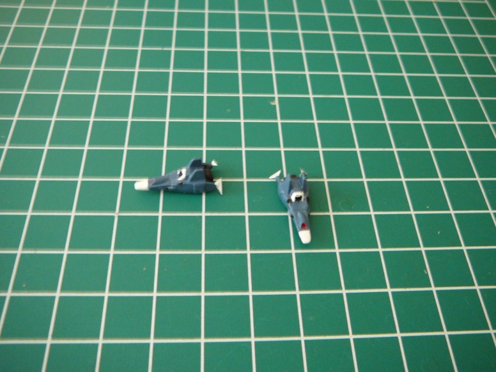

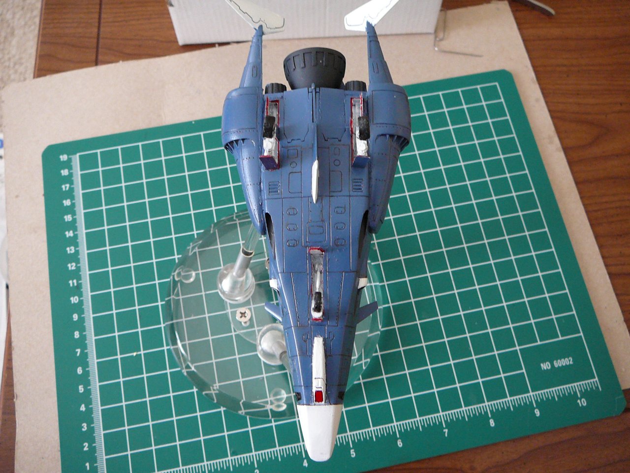

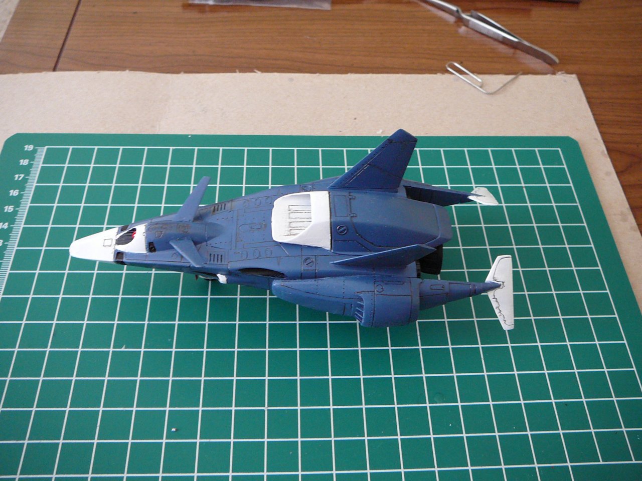

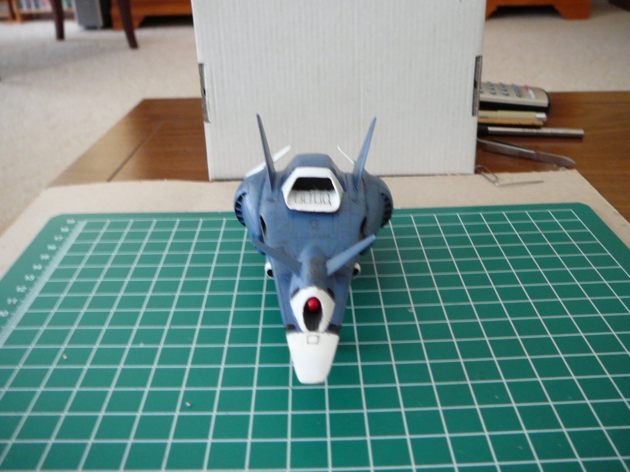

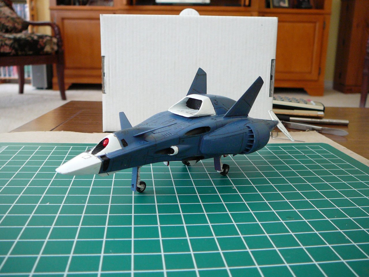

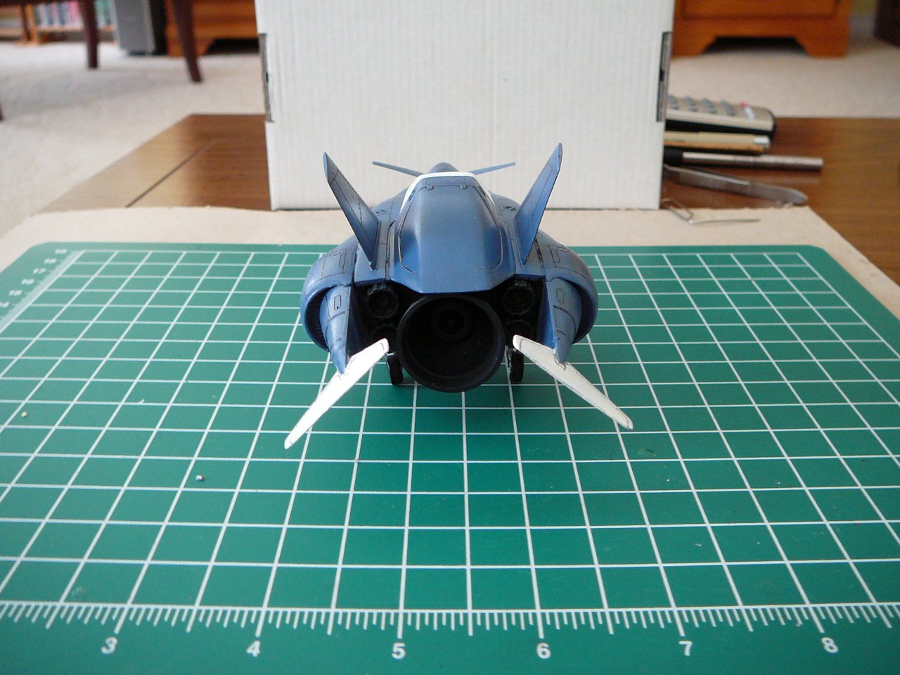

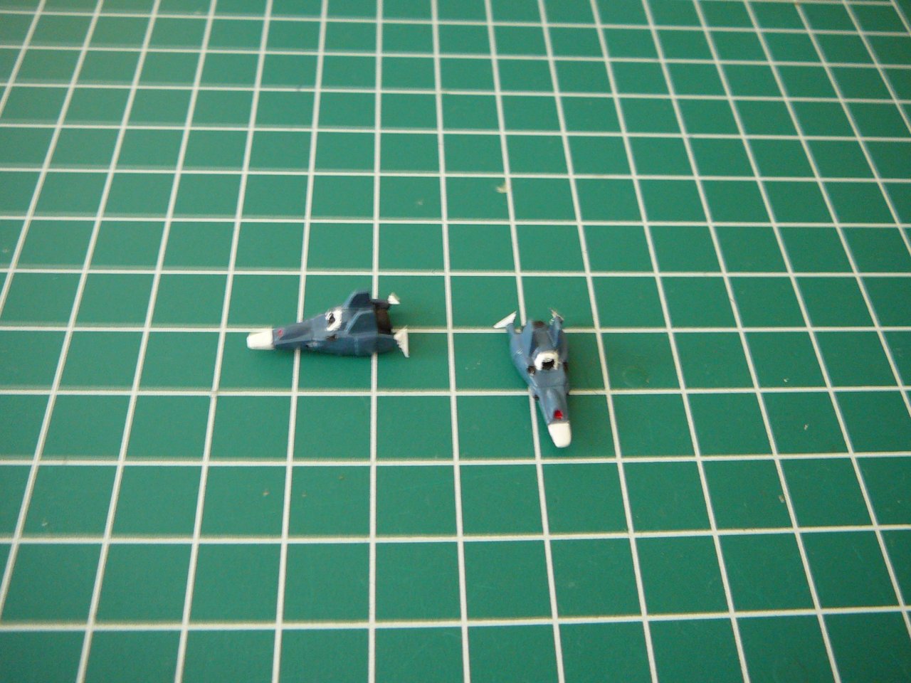

neptunesurvey Posted February 24, 2007 Posted February 24, 2007 Here are some pics of the ghost fighter. I'm almost finished and should have the final touches and decals on it by tomorrow.
HWR MKII Posted February 24, 2007 Posted February 24, 2007 That looks really good neptune. Clean finish too. This beast is on my bench at the moment.

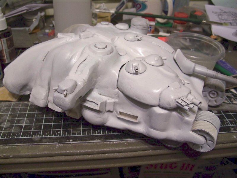

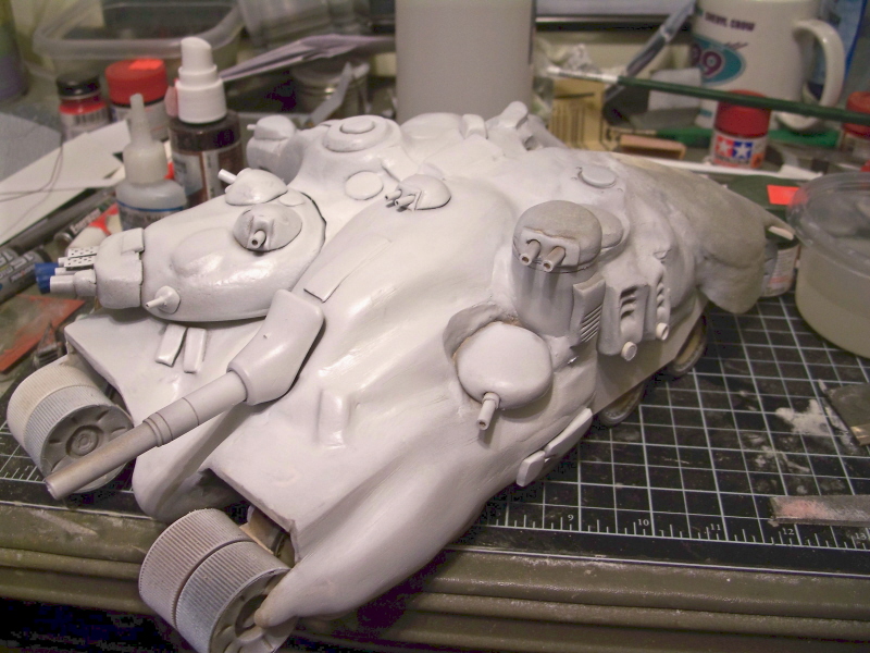

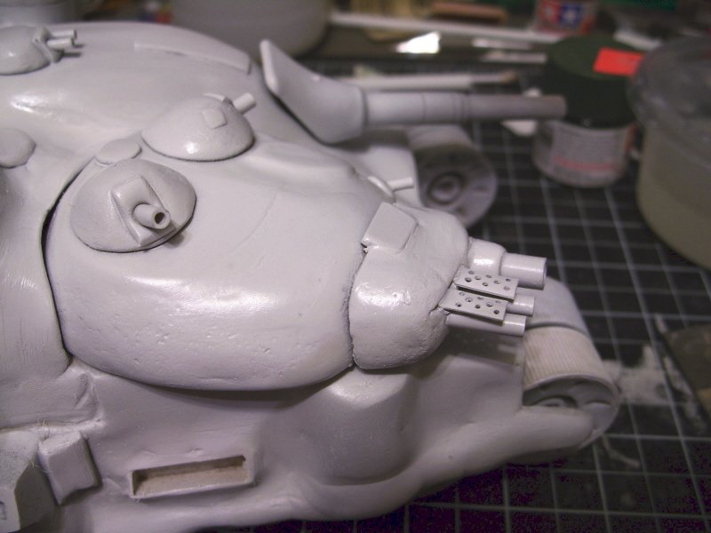

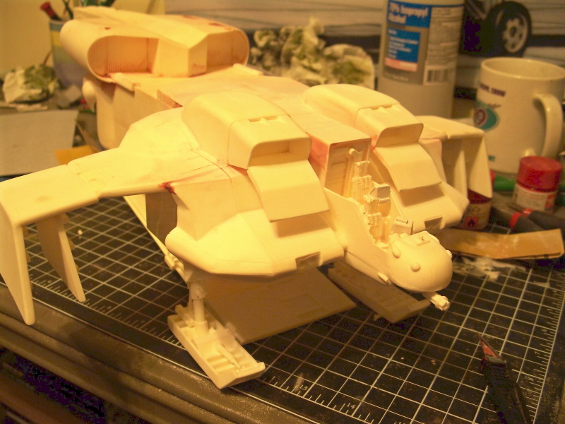

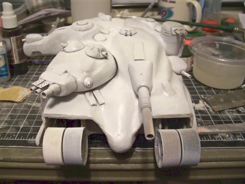

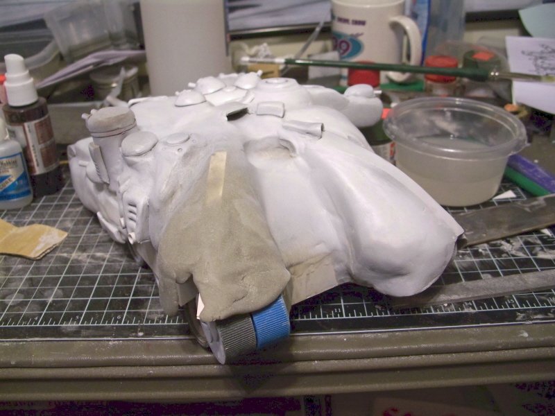

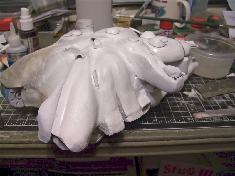

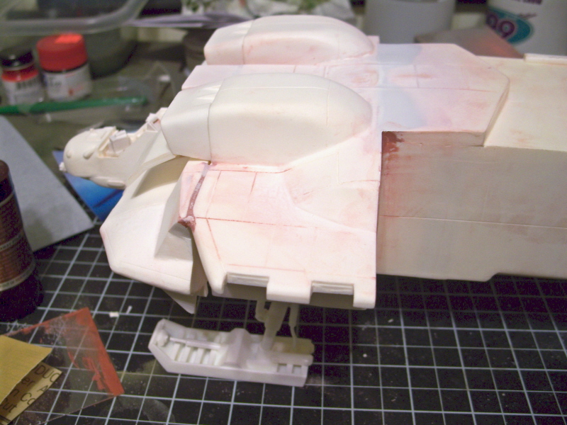

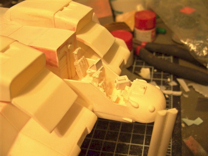

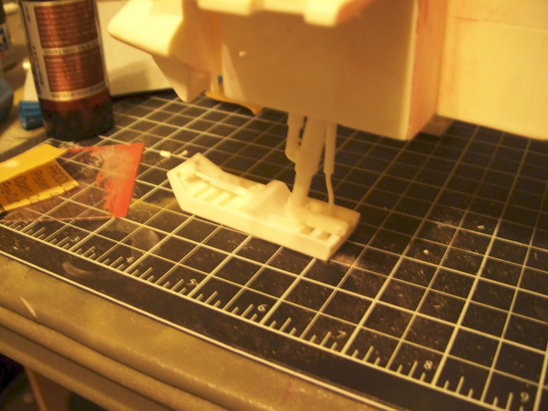

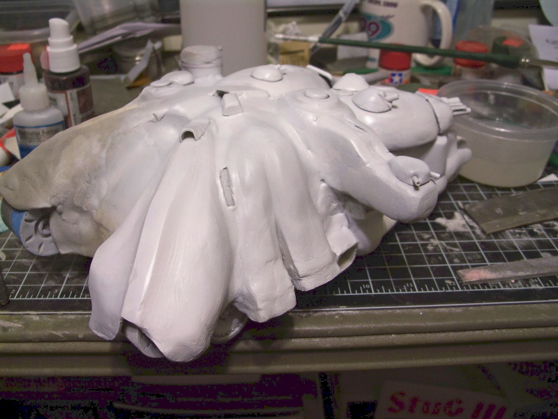

HWR MKII Posted February 25, 2007 Posted February 25, 2007 Dropship is having issues so i decided to shelve it for now. BUT i brought this back out and can see the light at the end of the scratchbuilding tunnel. The Octo Tank from Venus Wars. Its about 80% complete needing the left and rear sides completed abd fine details. But it is almost there.
MechTech Posted February 25, 2007 Posted February 25, 2007 Keep it up Neptunesurvey. The ghost (and babies) look good. HWR, the Octo tank looks good too. I think that was one of those designs heavily influenced by Sake ! - MT
promethuem5 Posted February 25, 2007 Posted February 25, 2007 HWR, what's wrong with the Dropship? Is that tank thing totally scratchbuilt? It's really impressive, but why'd you decide to build a tank that looks like a big snot?
HWR MKII Posted February 25, 2007 Posted February 25, 2007 HWR, what's wrong with the Dropship? Is that tank thing totally scratchbuilt? It's really impressive, but why'd you decide to build a tank that looks like a big snot? It is a scratchbuild P5. But it doesnt look like snot. Watch Venus Wars to see what it can do.
promethuem5 Posted February 25, 2007 Posted February 25, 2007 Is that all epxy putty and plastic tidbits, or what? I've never heard of Venus Wars, but it looks kinda neat... different, but neat.
