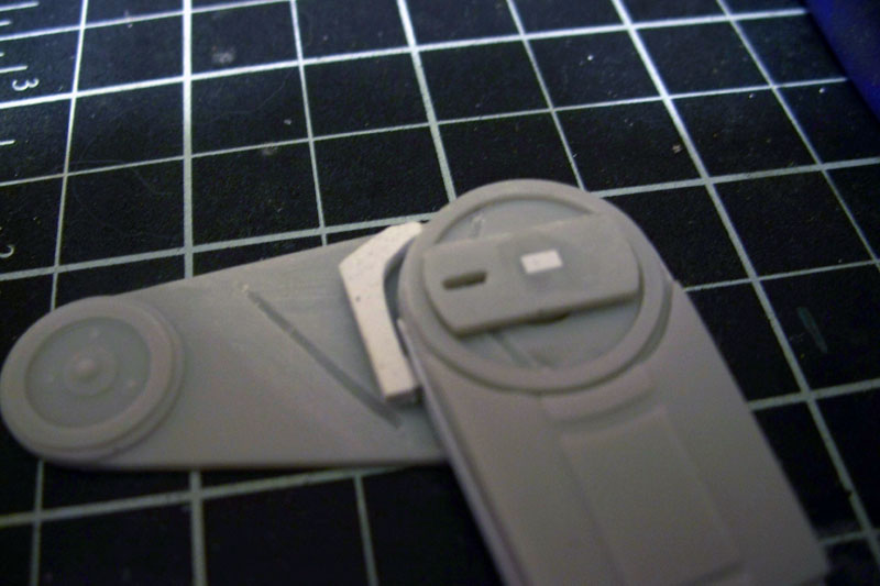

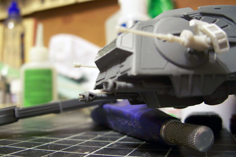

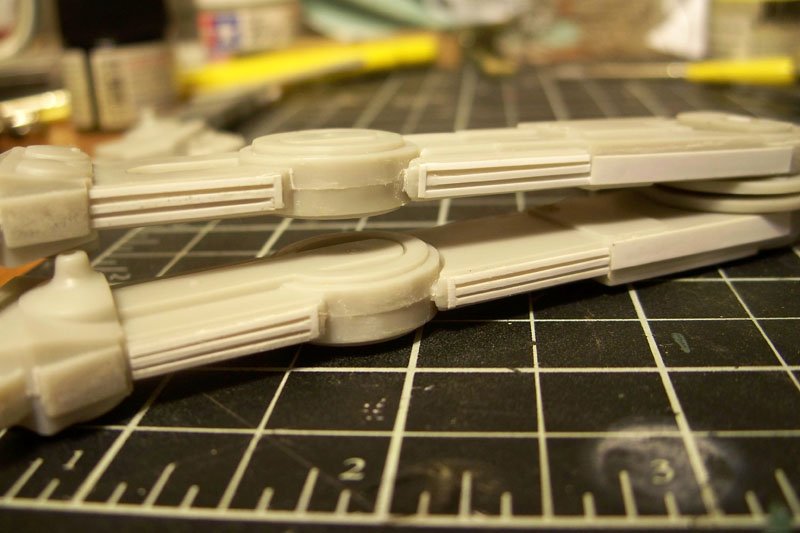

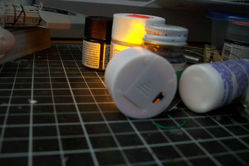

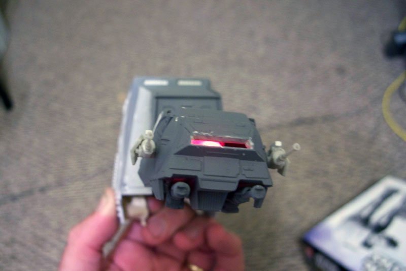

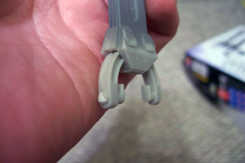

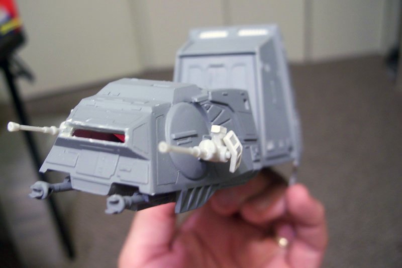

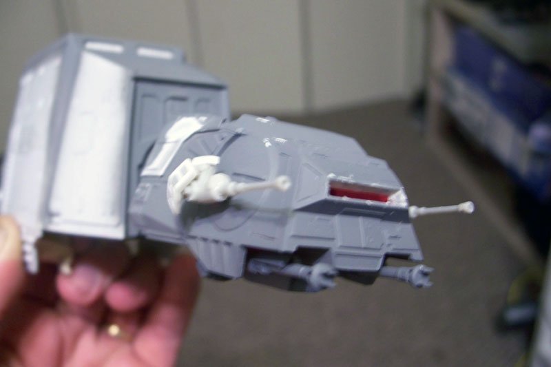

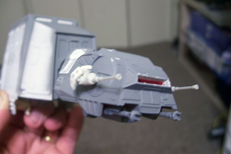

HWR MKII Posted July 21, 2007 Posted July 21, 2007 I have a Fine Molds Y-wing awaiting a start. But right now im still tackling my AT-AT. Installed an LED in the head and im trying to cram as much studio model correct detail into it as i can. The legs are mostly done. I just have to scribe the feet, fit any missing greeblies to the underbelly, final assembly and paint.
HWR MKII Posted July 21, 2007 Posted July 21, 2007 Heres some pics of said AT-AT. enjoy. Sorry for the blurr i took these really fast.
David Hingtgen Posted July 21, 2007 Posted July 21, 2007 Fine Molds Y-Wing already!?!? Man you work fast. And an AT-AT. I'll presume ERTL/AMT?
HWR MKII Posted July 21, 2007 Posted July 21, 2007 (edited) Where did you get all the correct greeblies from ? I studied pictures of the movie models and scratch built what wasnt there. Its mostly strip details on the legs and alot of scribed and engraved details. Prett easy overall once i found the right width of strip styrene. The chin lasers were lobbed off and trimmed down. Then i took some 1/72 King Tiger barrels cut to fit and glued them on. Edited July 21, 2007 by HWR MKII

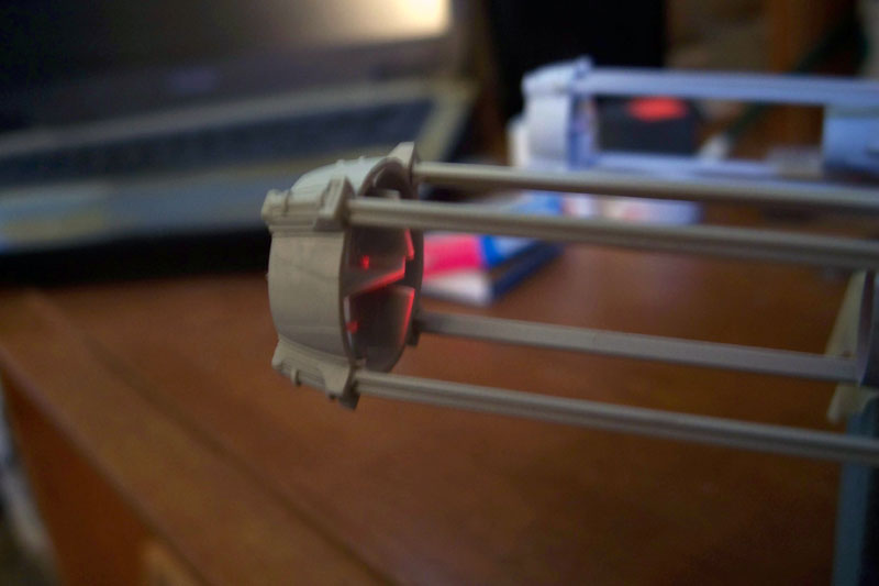

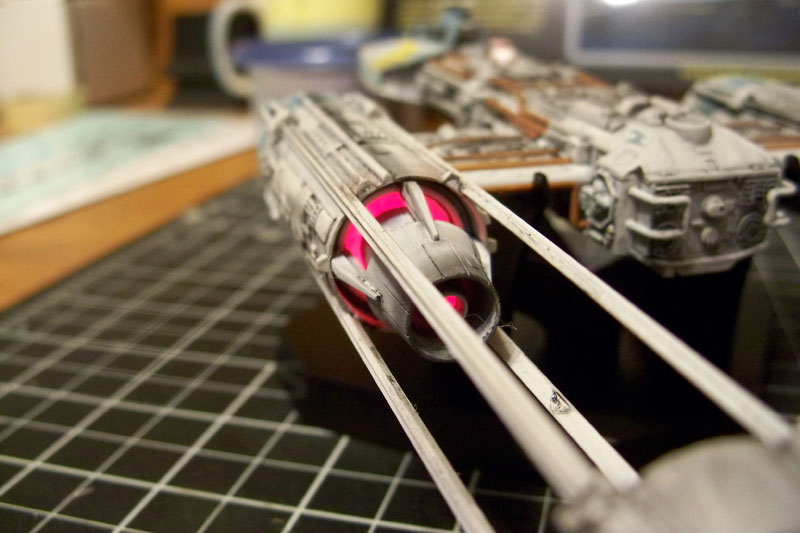

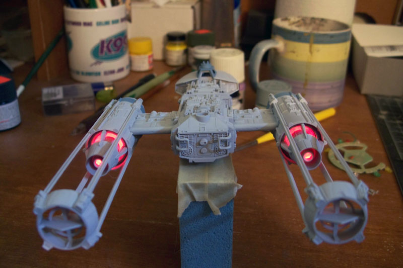

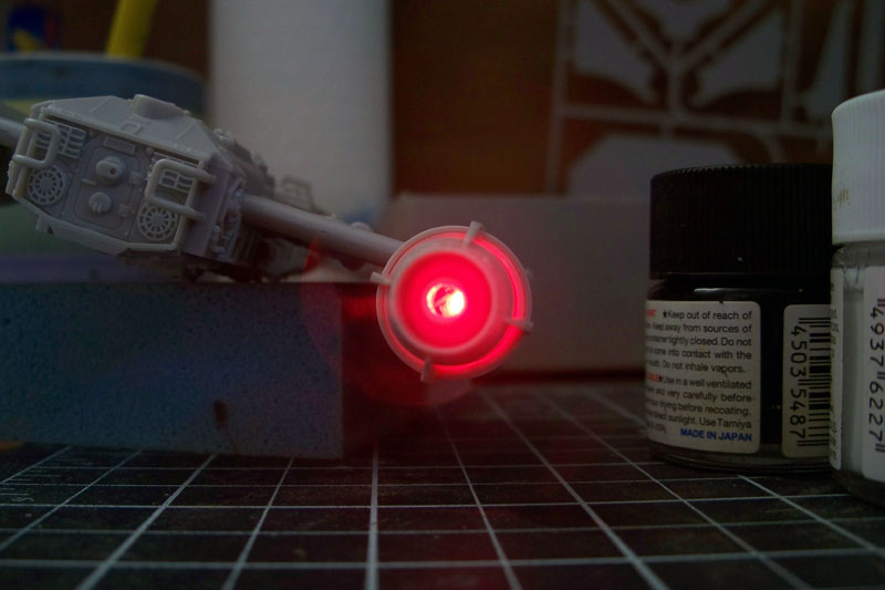

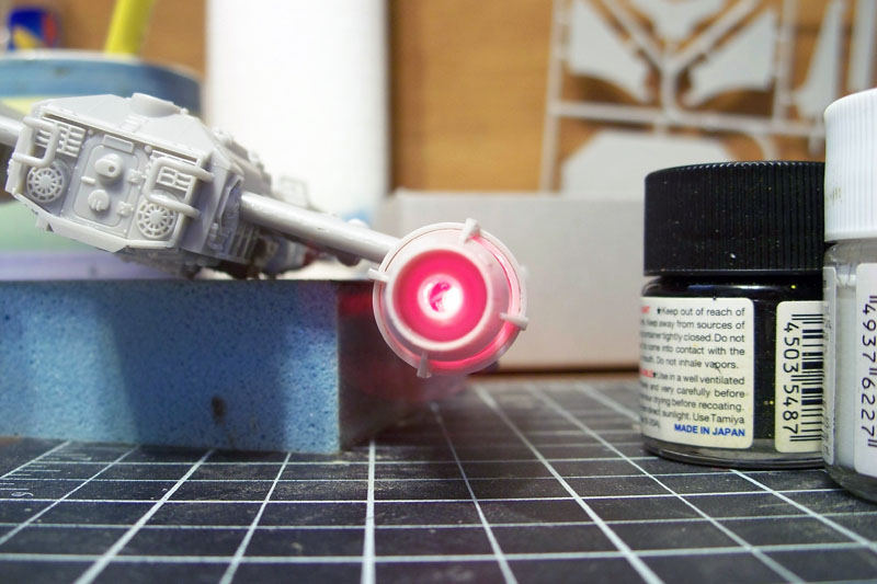

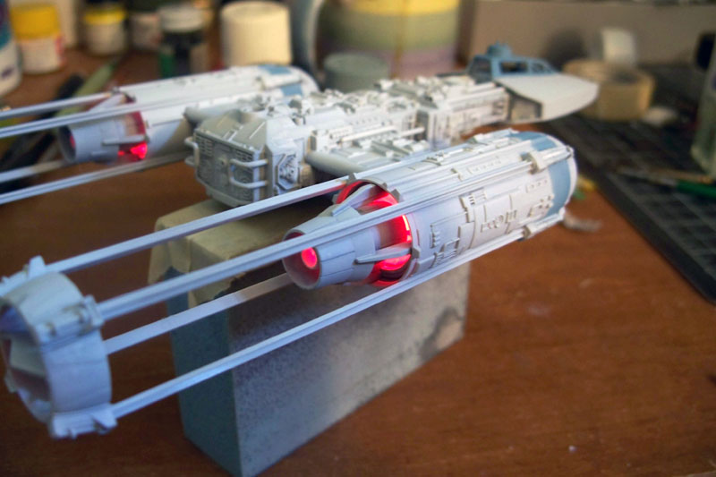

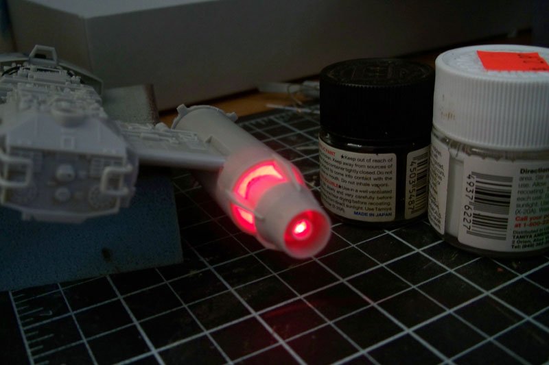

Kylwell Posted July 22, 2007 Posted July 22, 2007 Gold 3 #1 Engine lit. It's even the proper shade of pink! Sweet!

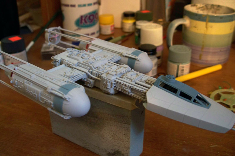

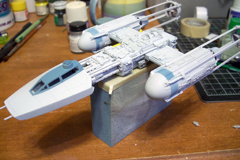

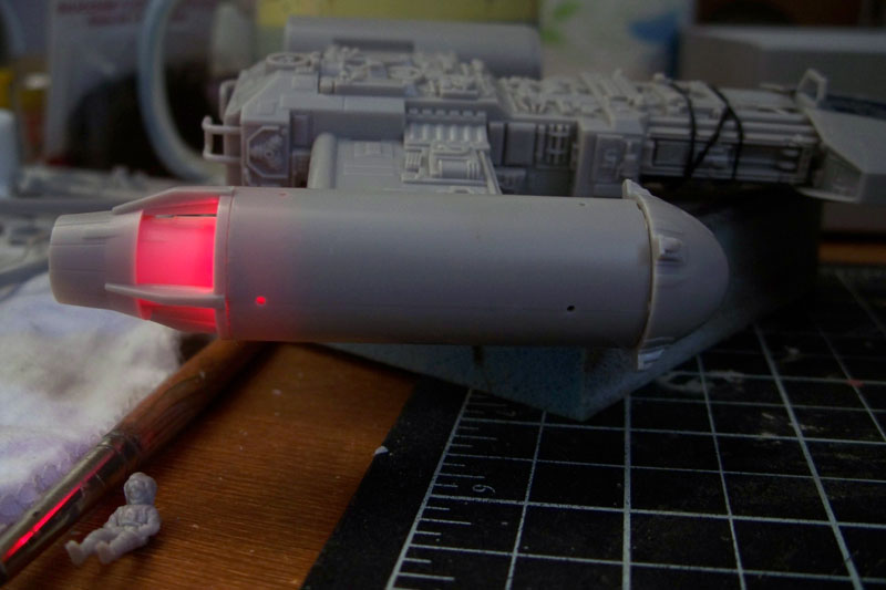

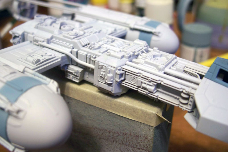

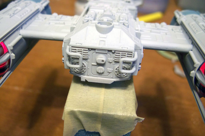

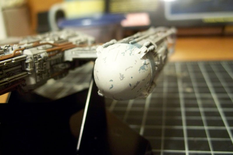

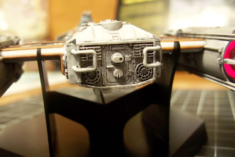

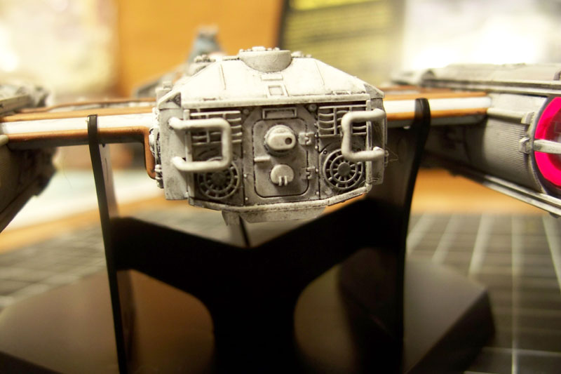

David Hingtgen Posted July 23, 2007 Posted July 23, 2007 I don't see any putty---does it go together that well? I know they have separate parts covering many of the seam lines, but that really looks like an exceptionally "seamless" kit.
HWR MKII Posted July 23, 2007 Posted July 23, 2007 (edited) It is THAT seamless. They replicated the detail so well you can see the 3 phillips and one flathead screws on it that hold the head of the cockpit together. They are on the underside. They got the details on the falcon that close too. Theres a few allen head screws on that which were replicated too. Tamiya extra thin cement and some tight rubber bands during construction help too. Edited July 23, 2007 by HWR MKII
wm cheng Posted July 23, 2007 Posted July 23, 2007 It is THAT seamless. They replicated the detail so well you can see the 3 phillips and one flathead screws on it that hold the head of the cockpit together. They are on the underside. They got the details on the falcon that close too. Theres a few allen head screws on that which were replicated too. Tamiya extra thin cement and some tight rubber bands during construction help too. WoW! I love the Y-Wing! That looks fantastic! I love the details - please post pictures when you're done (or at least let me know) I'd love to see what you do with it. Its looking great so far, really nice kit. I was toying with getting it, but I already have the 1/48 SMT Y-Wing resin (back when there was nothing else available). But now seeing your pictures - I'm temped again... but I also have the FM Falcon, which will take forever if I ever get around to it?! Its so much fun to weather Star Wars rebel fighters! Its where I learned all my techniques on - just don't build anything else right after one - they all appear so trashed!
big F Posted July 23, 2007 Posted July 23, 2007 (edited) It is THAT seamless. They replicated the detail so well you can see the 3 phillips and one flathead screws on it that hold the head of the cockpit together. They are on the underside. They got the details on the falcon that close too. Theres a few allen head screws on that which were replicated too. Tamiya extra thin cement and some tight rubber bands during construction help too. I love it when they are that detailed, it really serves well if you are that anal about authenticity. If it dont look right it aint right thats what I say Tamiya extra thin and a collection of rubberbands should be in every builders construction kit. Edited July 23, 2007 by big F

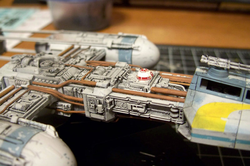

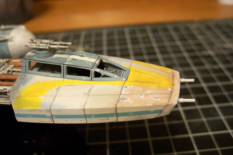

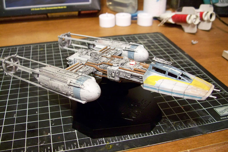

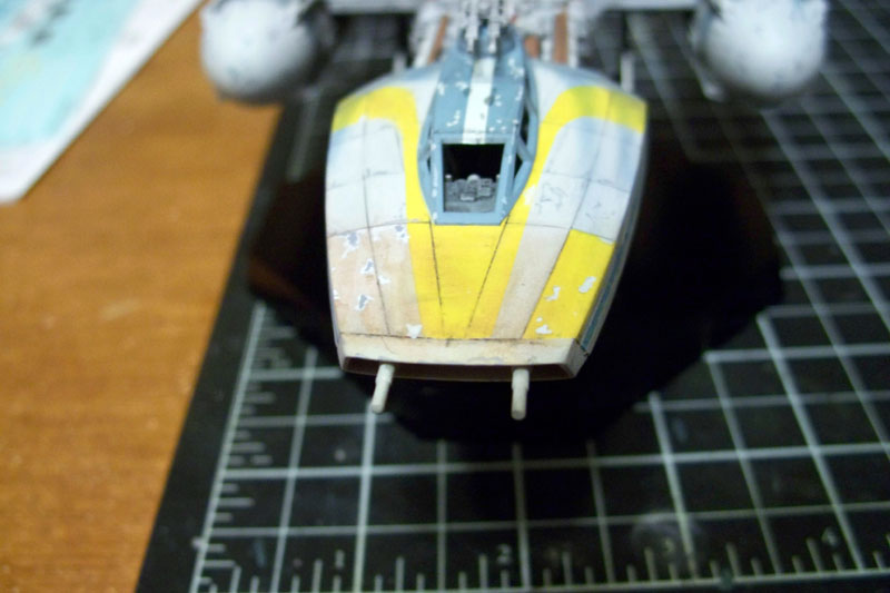

HWR MKII Posted July 23, 2007 Posted July 23, 2007 Ill be posting more pics tonigt. So far the only changes are 2 coats of future, decals another coat of future and the oil wash. Next up is dullcoat, pastels, chipping and another layer of dullcoat.
wm cheng Posted July 24, 2007 Posted July 24, 2007 Ill be posting more pics tonigt. So far the only changes are 2 coats of future, decals another coat of future and the oil wash. Next up is dullcoat, pastels, chipping and another layer of dullcoat. Hmm, another layer of dullcoat after the chipping eh? Doesn't the dullcoat well... dull the silver of the chipping? Do you paint the chipping on top - or do you scrap away the paint to reveal the silver beneath?

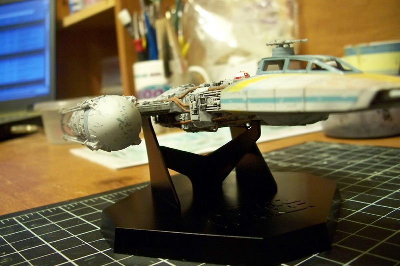

HWR MKII Posted July 24, 2007 Posted July 24, 2007 No silver will be used. I will be using greys and whites on it where applicable. The filming models didnt have any silver on them just chips through the layers of paint and streaks of other color on top. This model is nowhere near the size of a studio Y wing though so the effect will be getting replicated with paint. Im laying down a final layer of dullcoat to even out the look for the scale and seal in the pastels. The first coat of dullcoat is to give the pastels something to stick to. Gloss+Pastel = not good.

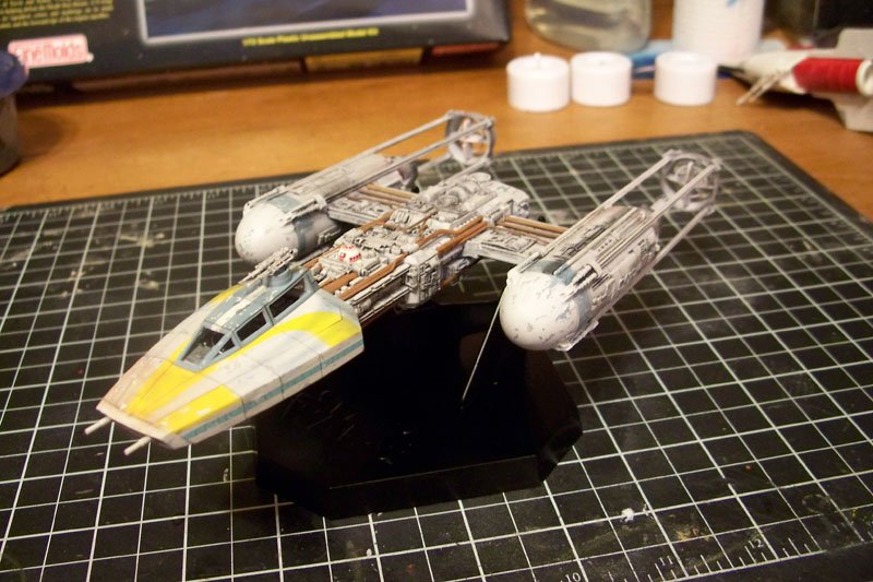

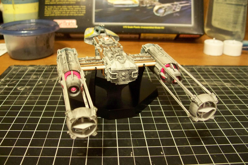

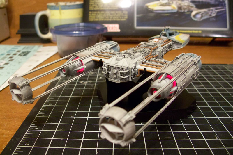

HWR MKII Posted July 24, 2007 Posted July 24, 2007 Aside from the pilot the Y-wing is done. The base coat is testors Light Grey cut about 25% with tamiya flat white. future, decals and a second coat of future were applied. I only used the 3 yellow decals and the R2 unit decals. The "blue " ones were too bright to me and compared to the 3 reference books i have with this particular Y wing in them. I mixed the best match i could using tamiya paints. The model was given a dulcoat then pastels were used to tone and dirty up certain areas and to add the more feathered streaks. Then more paint chips were added to again match the references on hand. The model was then given a final dull coat to seal the pastels and even out the tone on the paint chips. Overall this kit has to be one of the best models i have built since the Fine Molds Falcon. No putty as needed and the parts fit was "almost" perfect. I hope you enjoy the pics as much as i enjoyed building it.
jardann Posted July 24, 2007 Posted July 24, 2007 That looks great man! I guess I'm going to have to get that kit. The precision of the fit that everyone is raving about would be very nice. I'm currently working on a 1/72 A-6 Intruder model and the fit on it is horrendous! But it was very cheap, so I guess you get what you pay for.
VF-19 Posted July 24, 2007 Posted July 24, 2007 Sweet Y-Wing! And I notice an A-Wing in the background of some of the pics too... As for my workbench, I resumed work on a GM-Custom that I started last year. It's got something of a Flanker-esque camo scheme on it, but it's only about 7o% done at this point. I've still got the little fiddly bits to paint and attach, decals and a flat coat to do...
wm cheng Posted July 24, 2007 Posted July 24, 2007 Fantastic! Really well done HWR MKII!! I loved your paint chips, especially the ones that have the lighter ring of white around them - they look really like the grey coat has worn down to the metal. How did you do those? Did you just paint on top by brush? If so, couldn't you tell it was painted on top since there is the slight thickness to the paint as its applied over the basecoat (in real life I mean - they look fantastic in the pictures, but I find photos can hide a host of sins) I'd love to see your Falcon too - I can't wait to start on that, but I just don't see when I'm ever going to find the time. Did you light that as well? I got the photo-etched landing baffles too. How did you light the Y-Wing, is the battery inside the model? How do you access it once it runs out? What about the switch? Thanks for sharing! Wm
HWR MKII Posted July 24, 2007 Posted July 24, 2007 Hey WM This is a surprise! Norally were asking you 50 questions. First for the lighting. In short each engine is a self contained unit with light, circuit, batteries and on off switch inside each one. This eases troubleshooting if one has issues i can just take the front cap and the nozzle out and remove the whole assembly. its pretty easy to do. A better explanation can be found here. http://www.starshipmodeler.net/cgi-bin/php...p=765728#765728 As for the scratches they are painted right over the base coating. The trick is to use a thin paint. once dry and dullcoated over you cant tell its painted over. Its just the light grey base coat with dark ghost grey for the darker parts. I also used some of my "blue" mixed for the rings and canopy on the nacell fronts. Some scratches are also decals included in the kit but not all were covered. The ones on the nose where it looks brownish were replicated using photos of the same filming model in Star Wars Chronicles. one of the best SW references around. I didnt light the falcon. When i got it the PE parts and clear engine parts werent on the market yet. I can post some pics later if you like.

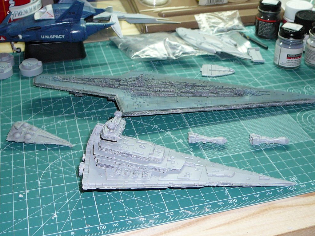

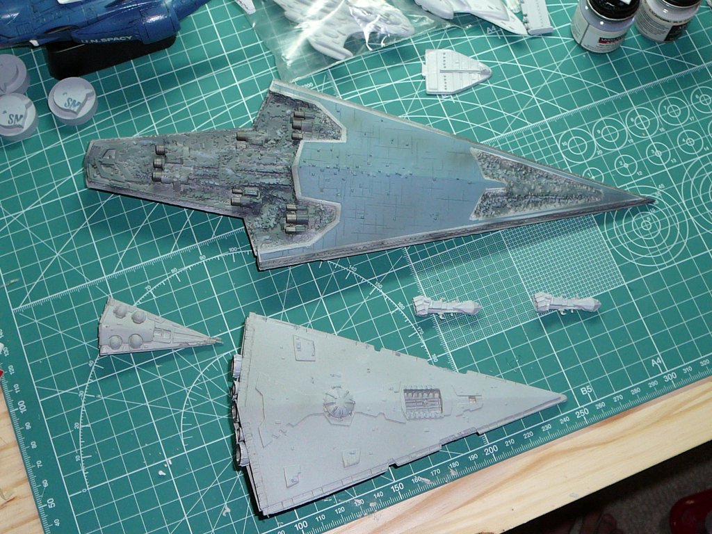

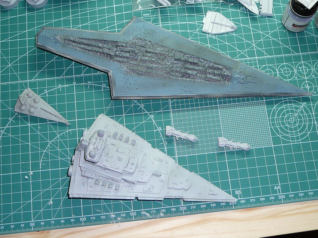

neptunesurvey Posted August 17, 2007 Posted August 17, 2007 Here are my current projects. The SSD comes from Scale Solutions and the SD is 1/10000 and comes from Odysseyslipways. Just need to find bases for the SSD and SD and will be finished.
MechTech Posted August 18, 2007 Posted August 18, 2007 Those look great. You know, I always thought the designers were at an American Indian museum looking at arrow heads when they got an idea what the baddies warships should look like - MT

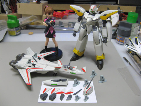

Cancer107 Posted August 21, 2007 Posted August 21, 2007 Can I post my picture here? 1/144 VF-19P fighter and battroid, modified from Bandai Fire Valkyrie kit. 90% done.

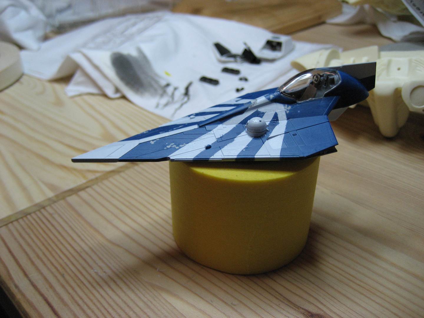

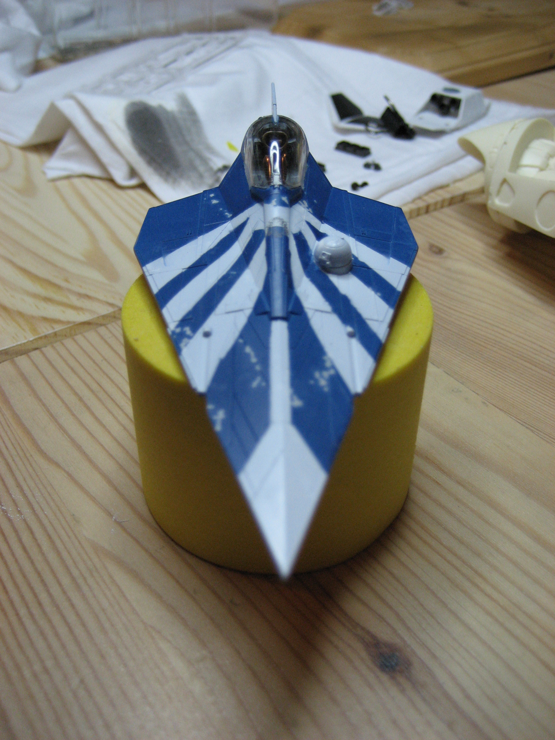

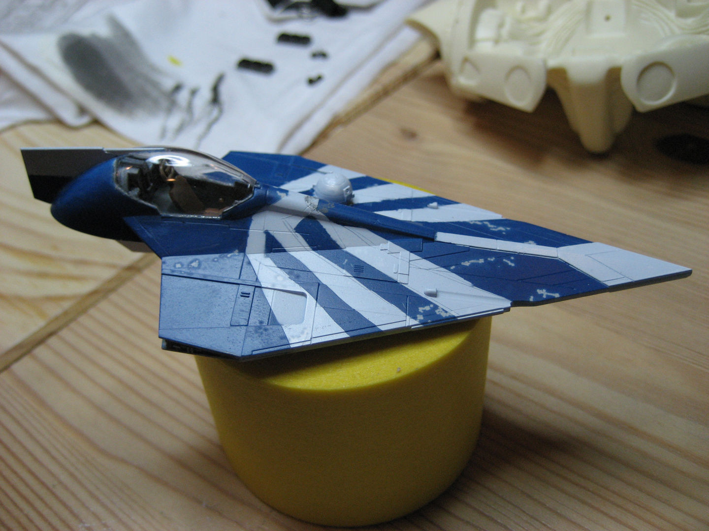

redfinger61 Posted August 21, 2007 Posted August 21, 2007 Not Macross, but I thought you guys might like it....It is the Fine Molds 1/72 scale Delta-7 Jedi Starfighter.....This color scheme is the one belonging to a Jedi named Ploo Koon, he gets shot down after order "66" is given, this is the ship he was flying. There were no decal options for this paint scheme so I had to mask it all, it was a quite the chore. Anyway enjoy the pics! I also have a WIP of a Has VF1-S Bat that is almost done I will post pics of that soon. Ashton
