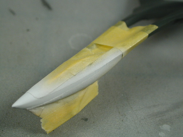

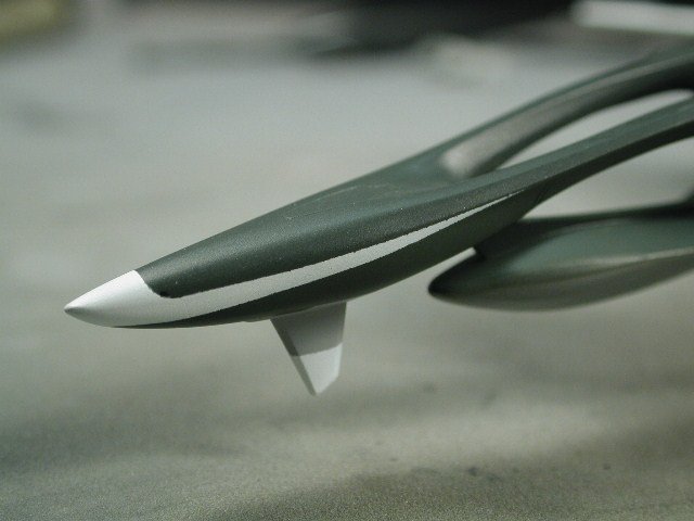

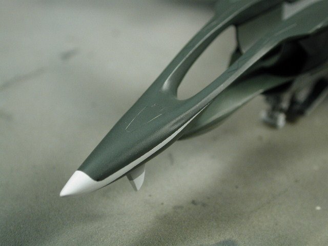

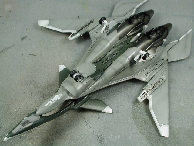

wm cheng Posted August 25, 2003 Author Posted August 25, 2003 Well here it is, not too bad, but not great, if you look closely, the edges isn't perfectly smooth. The overall contours are right and there is no overspray, but there are areas where the adhesive on the Tamiya masking shows through as a fewy little bumps - normally I wouldn't look this closely - but its such a small plane - I mean this line is only an inch long! So any imperfections will show up large in scale comparatively. Aftermarket decals would be great for this bird!! This really should of been a decal! What's next, Bandai will want us to spray the stencils "no step" in 1/100 scale Quote
wm cheng Posted August 25, 2003 Author Posted August 25, 2003 This shot shows the "bumps" better - I don't know how to get a smoother line? Quote

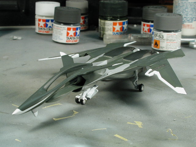

wm cheng Posted August 25, 2003 Author Posted August 25, 2003 This is where I'll let the plane stand overnight for the clear-coat to dry. (Must keep hands off - before I ruin any other paint finish) I can be so impatient especially when I get to this point where I would do the oil wash, post shading and decals. I have repaired the wing-root hinge area and put lots of coats of clear-coat over that area as well as paint the wing pylon details in metallic steel as well. I think my plan is to tone down the white and light grey with a neutral grey when I do the post shading phase. Then at the end - after the decals and clear-coat to protect the decals, I will remask the light green and spray those with a flat/matte finish. So I will keep the semi-gloss of the darker shade and engines, but get a flat sheen on the lighter green areas - hopefully that will restore the original contrast between the two colours. Quote

Commander McBride Posted August 26, 2003 Posted August 26, 2003 Wow...more great tips...I need to find some Tamiya masking tape! Thanks forsharing the article on Tamiya paints too..that was great! I had a bit of trouble finding some myself, but once I did, I'll never go back. As for that line, it's not perfect, but I don't really think there's anyone who could do better. Quote

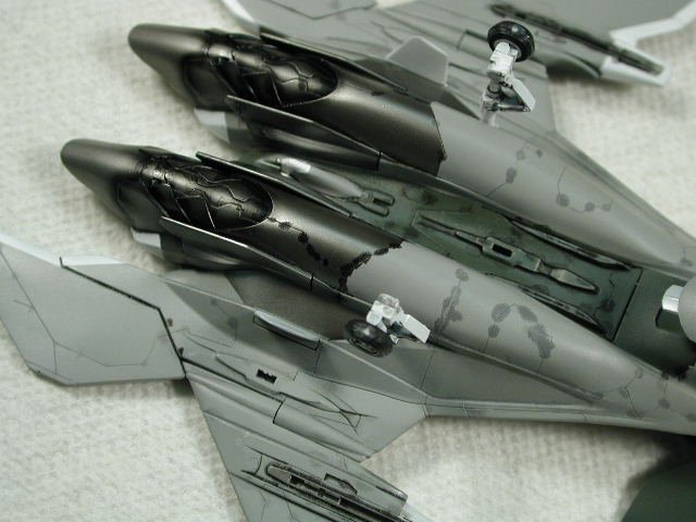

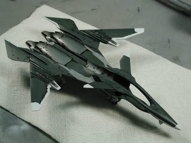

wm cheng Posted August 26, 2003 Author Posted August 26, 2003 Starting the old wash...here's my spotted bird. Quote

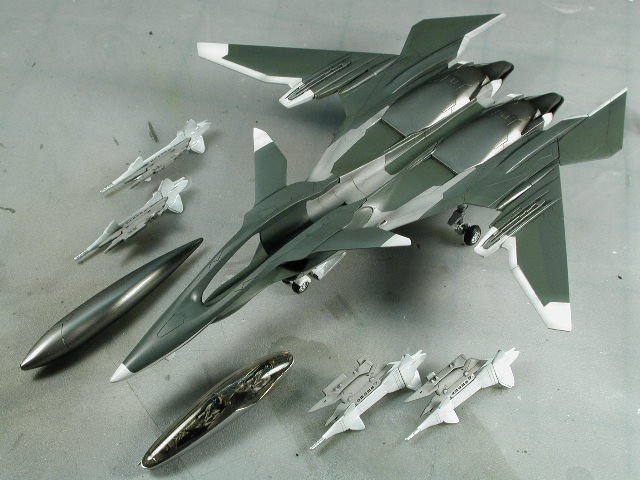

wm cheng Posted August 26, 2003 Author Posted August 26, 2003 This shot is a close up of the different greys - the black wash for the engines and dark moveable surfaces and the lighter grey for the regular panel lines. Quote

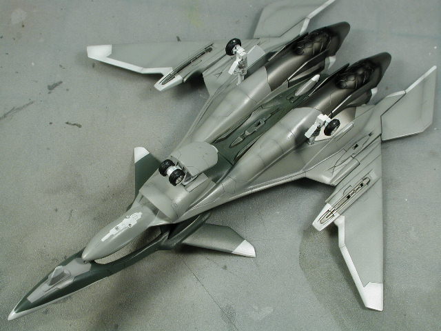

wm cheng Posted August 26, 2003 Author Posted August 26, 2003 Here's a shot after I wiped off the excess oil paint and did a light little post-shading on the panel lines with Neutral Grey. I darkened the forward edges of the white with the grey, and this had the effect of darkening the white while lightening the dark green/grey which reduced the contrast of the white markings to blend them in a bit (they did stand out a bit starkly - bullseye ) Quote
wm cheng Posted August 26, 2003 Author Posted August 26, 2003 The weathering on the top is really subtle - I didn't want it to look battle-worn, just tie all the colours in a bit (the photo doesn't really show subtelty well). There will be another light dusting of grey after the decals to tie those in - so its always best to error on the side of caution. You can always add more, over-doing it is a harder fix. This photo shows the other missiles (I decided to paint the bodies/shaft white - like the Superslyph, but haven't decided on a fin colour yet - I don't think I'll take the instructions pale purple) the centerline tank (which there are no paint instructions - but I did the Alclad Steel because I like the finish so much - in hindsight, this will be my Alclad test model ) and off-course the cockpit pod. Quote
wm cheng Posted August 26, 2003 Author Posted August 26, 2003 A great view!! Its decal time soon, as soon as I let the clear coat dry!! Ya! Quote
