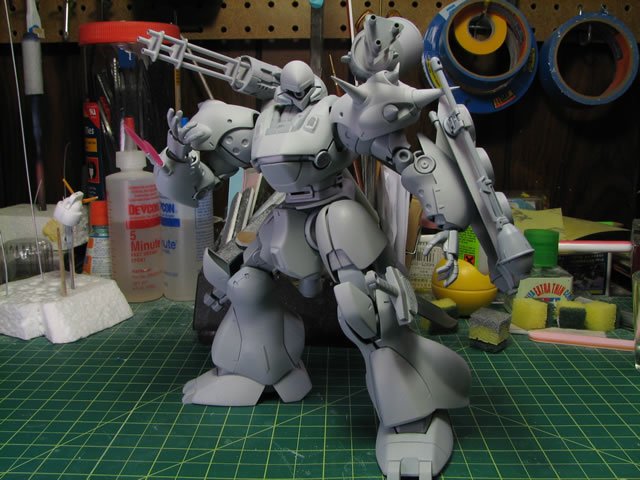

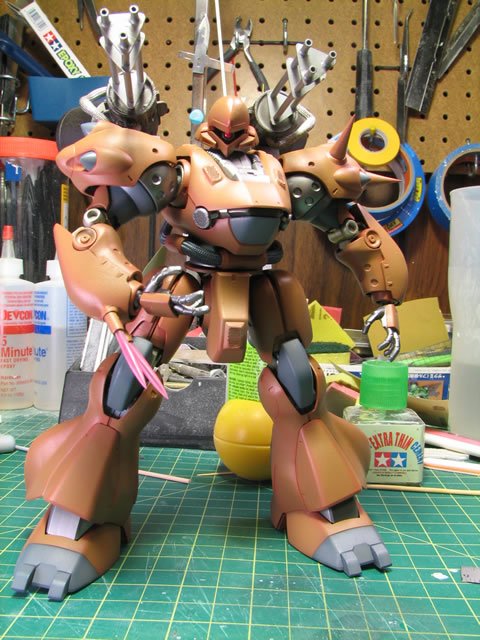

shiyao Posted November 9, 2006 Author Posted November 9, 2006 (re: part 1 of my questions) Like for instance, how did pic #1 turn into pic #2 (L to R, attachments below)?? really just "masking"? even if you removed the parts into sub assemblies there'd still be a LOT of masking. and a LOT of waiting for paint to dry. Quote
David Hingtgen Posted November 9, 2006 Posted November 9, 2006 Basically---yup. Painting is done last. Think about all the aircraft models with camoflage--the camoflage doesn't follow panel lines or subassemblies at all. Mask mask mask... And Tamiya masking tape is worth the price. Quote
zeo-mare Posted November 9, 2006 Posted November 9, 2006 yup alot of masking is always required, and i second the tamiya tape, it is well worth its price. chris Quote
