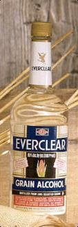

ghostryder Posted August 1, 2006 Posted August 1, 2006 I mentioned in an earlier thread that 90% isopropyl alcohol removes the stock Yamato paint when rubbed with a cotton swab. I haven't had the guts to soak a part overnight, for fear of damaging the ABS. According to chemical compatibility charts, isopropyl alcohol gets a "B" for compatibility w/ ABS ("A" being "no effect" and "F" being "your valk is toast"). One of the things on the chemical chart that got an "A" for compatibility was ethanol (booze). For kicks, I got myself a bottle of 190 proof (95%) Everclear and tried the swab test - works just as well as isopropyl! I may try soaking a 1/48 part for my next project. Anyone try ethanol for removing valk paint? Quote

MechTech Posted August 1, 2006 Posted August 1, 2006 I've heard of everclear being used for lot's of stuff, but this takes the cake! At least your liver will thank you ! Good thinkin'!- MT Quote

ghostryder Posted August 2, 2006 Author Posted August 2, 2006 IT WORKS! These pics show the results of just 15 minutes of soaking with occasional scrubbing with a toothbrush. The CF color looks intact and I see no signs of "permafrost" on the colored ABS. BEFORE AFTER Quote
ghostryder Posted August 3, 2006 Author Posted August 3, 2006 (edited) ... it also works for the Stealth, with no permafrost on the black ABS (this paint was much tougher to brush off because of the rough surface texture) Edited August 3, 2006 by ghostryder Quote
