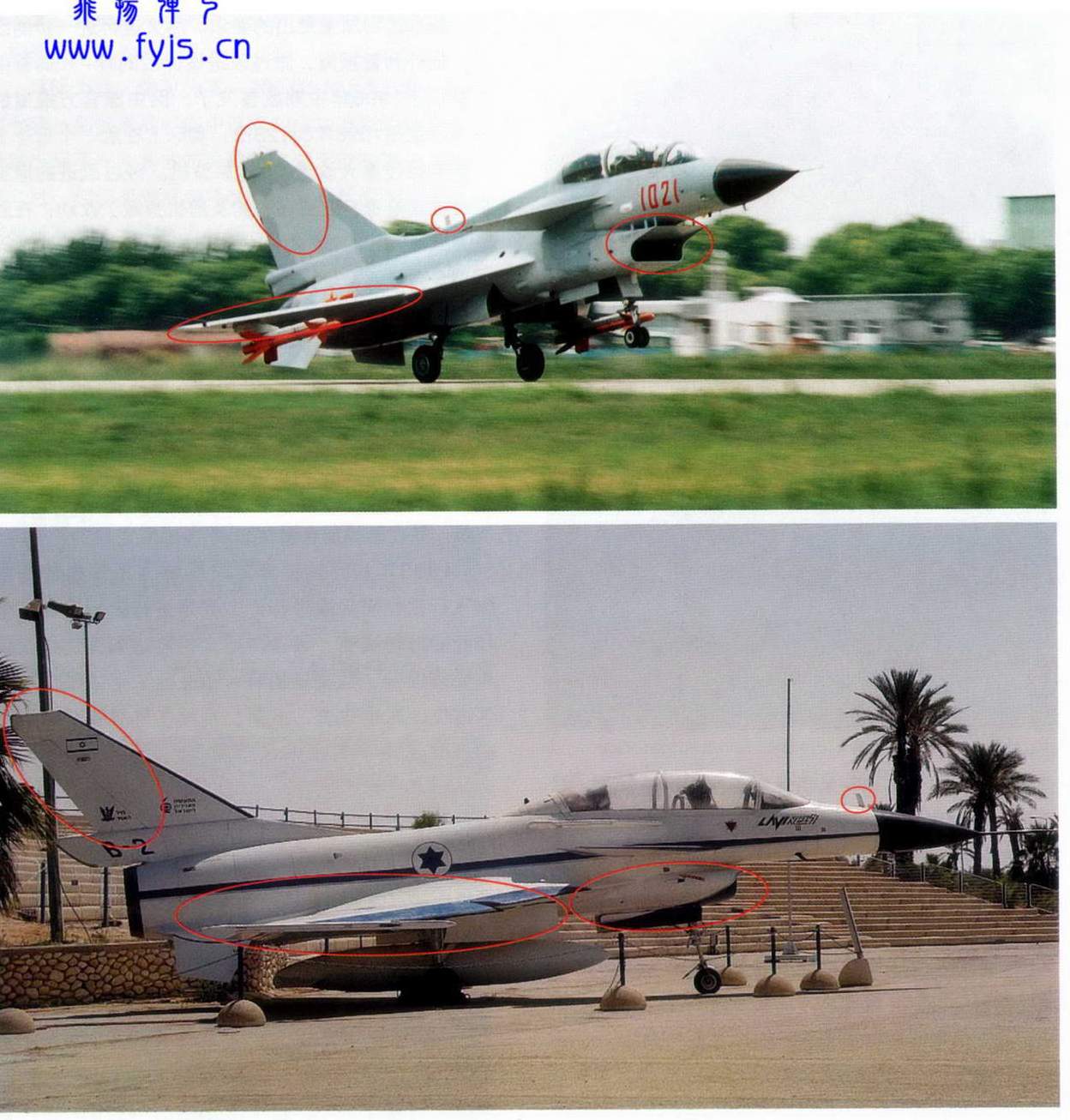

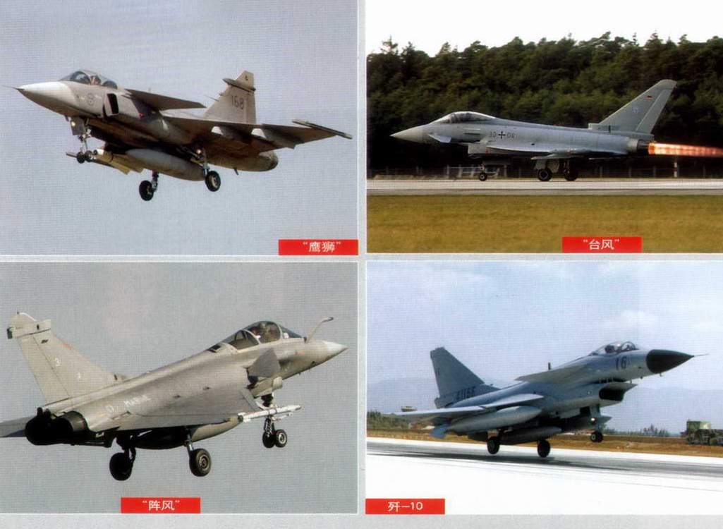

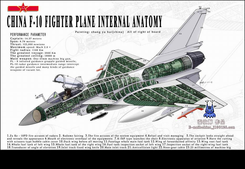

F360° Posted February 2, 2007 Posted February 2, 2007 I found some pic for you guys. [attachmentid=40117] [attachmentid=40116] [attachmentid=40115]

Retracting Head Ter Ter Posted February 2, 2007 Posted February 2, 2007 I found some pic for you guys. Damn canard/delta/single tailfin designs all look the same to me!

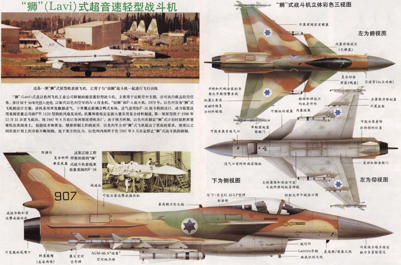

T.V. Posted February 2, 2007 Posted February 2, 2007 I found some pic for you guys. Thx! I still haven't found the lineart I was looking for, but then again the article is 1 or 2 years old and the mag is boxed up somewhere, so it'll take some time before I'll find it. Anyway, here's an page from a more recent article. It's from Combat Aircraft, nov '06. I marked the paragraph that deals with the discussion wether or not the J-10 is a "carbon copy" or simply a reverse engineered and modified Lavi, or an original design. I've added some Lavi line art as well.
Retracting Head Ter Ter Posted February 3, 2007 Posted February 3, 2007 How accurate is that Lavi lineart? Some features seem significantly different from the J-10 if we go by that lineart.
