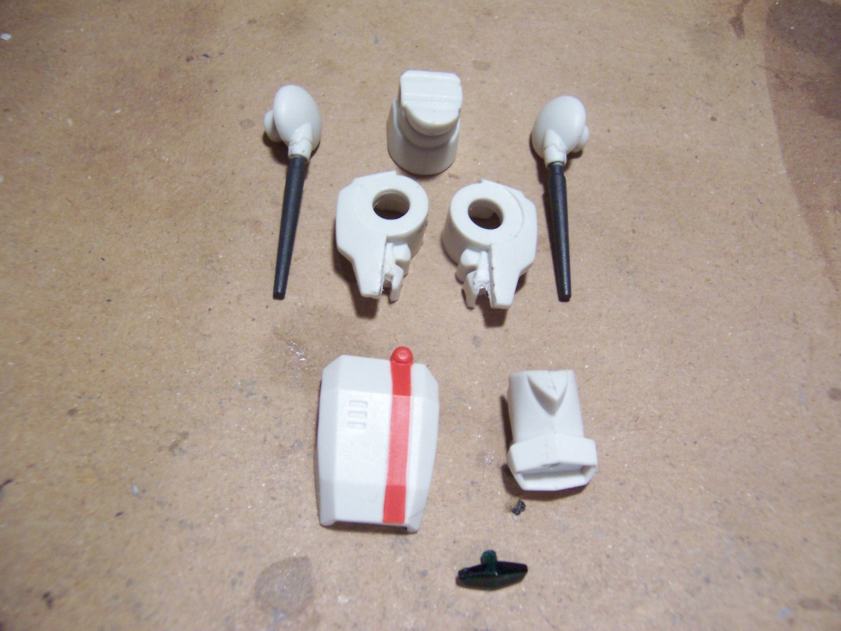

nightmareB4macross Posted July 7, 2006 Posted July 7, 2006 Here is the VF-1J, there are two parts I forgot to take a pic of. Quote
1 VF-1 2NV Posted July 7, 2006 Posted July 7, 2006 Damn man, I don't think I have the balls to do that. Good for you. Now try it with a s head. Quote
nightmareB4macross Posted July 7, 2006 Posted July 7, 2006 1 VF-1 2NV said: Damn man, I don't think I have the balls to do that. Good for you. Now try it with a s head. 414279[/snapback] Sorry can't take the pic right now, I 've got the "A", "J", and "S" head sitting in mold as we speak. Click into my sig for more details. Quote
GutsAndCasca Posted July 7, 2006 Author Posted July 7, 2006 nightmareB4macross said: Here is the VF-1J, there are two parts I forgot to take a pic of. 414275[/snapback] Looks like that poor head had to endure a little pain to get where it's at. *winces* But hey, if it's in the name of a recast then it was worth the sacrifice. Quote
