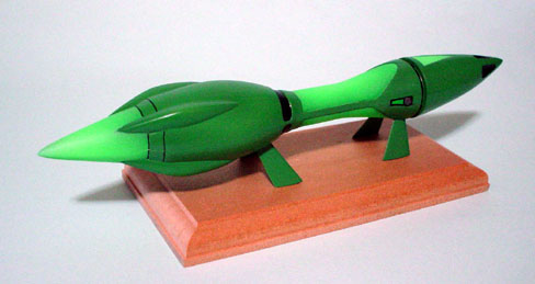

I have been searching and searching for a yf-19 1/72 fold booster. I have been looking for recasts but no luck, I have got quotes for sctrach builds but its just way too much. So since I have built and painted models for the longest time, I figured why not give scratch building a chance, but befor I go any further I would like to gather facts, advice, and tips from you wise model builders. -thanks for takeing a look. also heres a pic on what im trying to go after.
Well, first of all, there are two 1/72 fold boosters out there. The first comes with the Club-M 1/72 YF-19 resin kit. It's pretty decent, but the clear 'window' parts are cast in a foggy clear resin, and fit rather poorly (I had one, but recently sold it). The Club-M kit will run you about $100
The other (which is the one you have pictured) was a limited run kit by UN・BALANCE, sold in limited quantities at Wonderfest
It looks pretty good, but it's cast solid. No clear windows or inner detail.
It's pretty rare, but I've seen them on Yahoo Japan Auctions from time to time, selling for about Y6000 (around $55)
