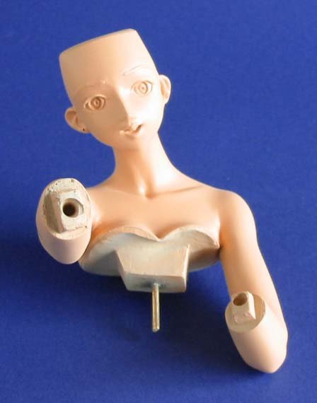

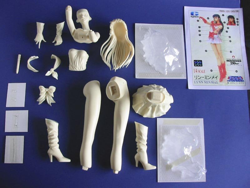

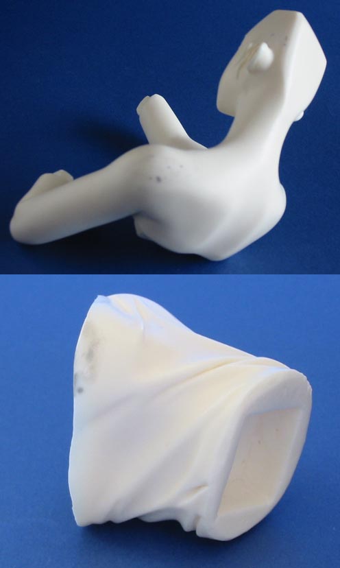

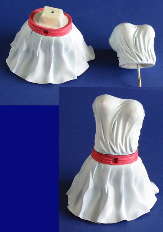

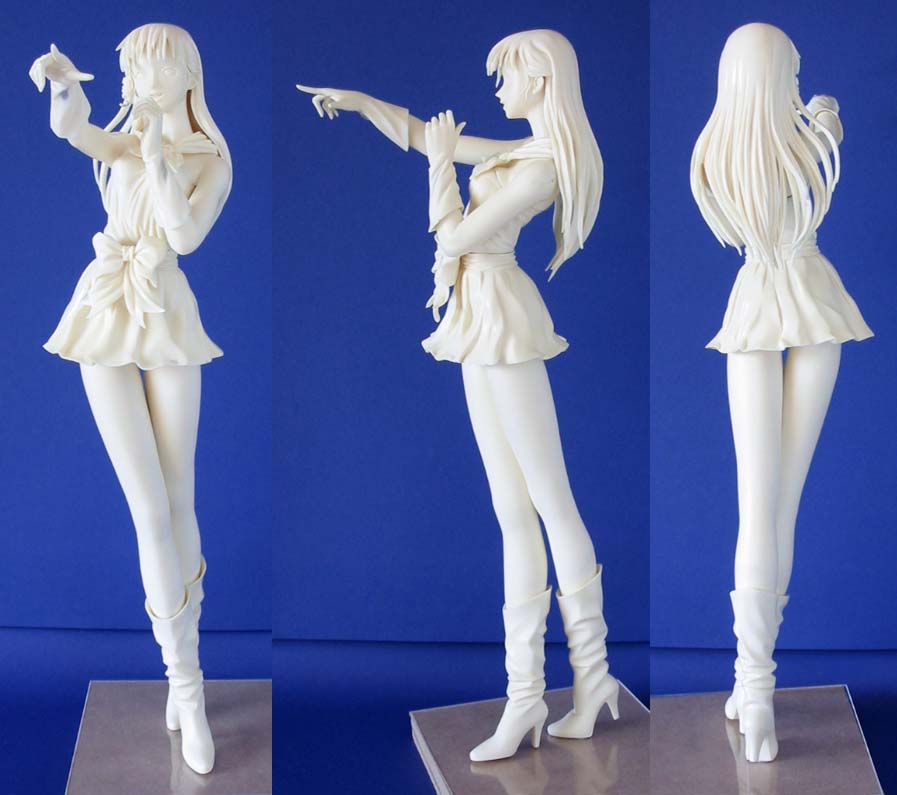

Starting to build a 1/4 scale Minmay kit.
- First stage: puttying - fortunatelly this is a good quality casting kit,so I finished this stage easily. :)

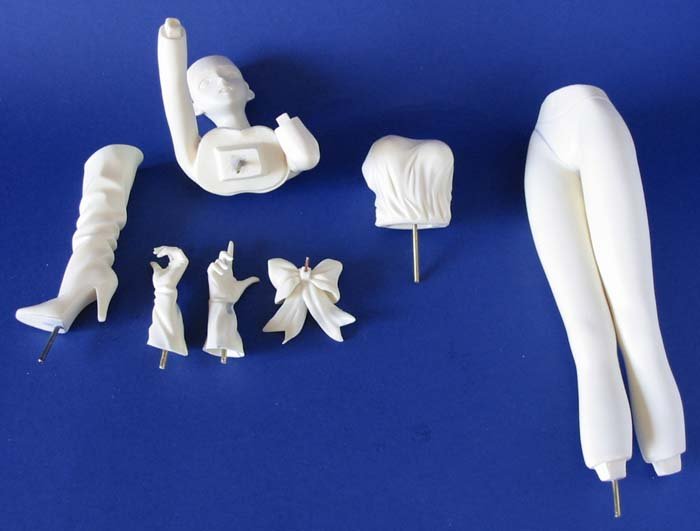

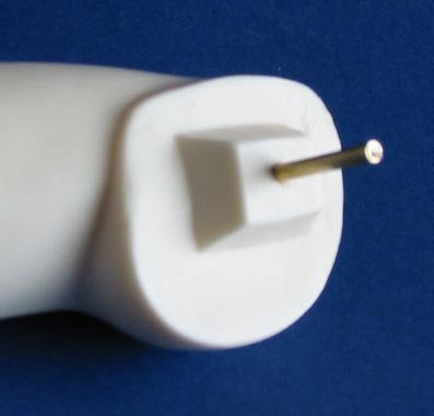

- Second stage : pinning - I'm using 2mm brass rod.

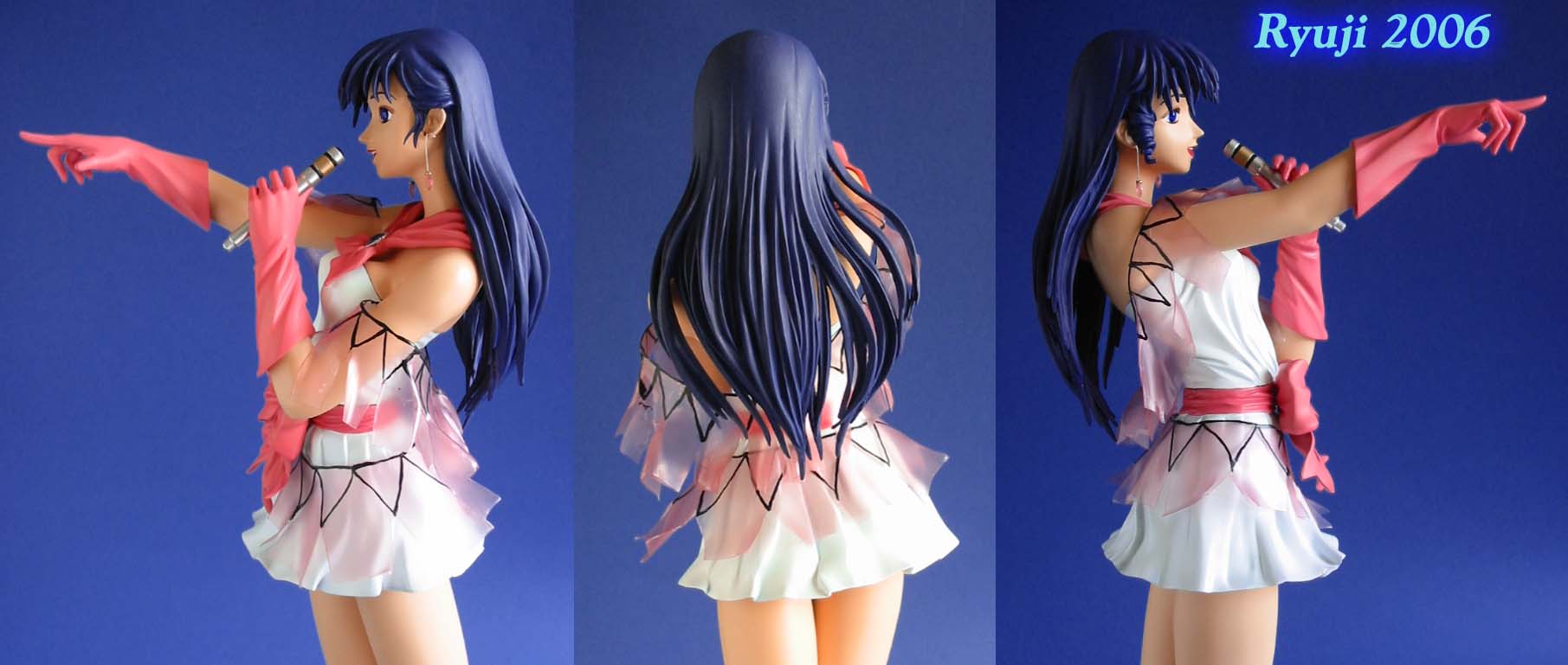

I like that sculpt. Minmay looks far less "childlike" and more like a young woman.
It also would be a great pose to modify to make the outfit she wore in her concert
at the end of DYRL.

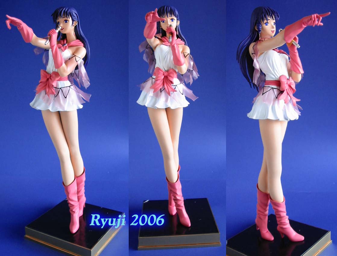

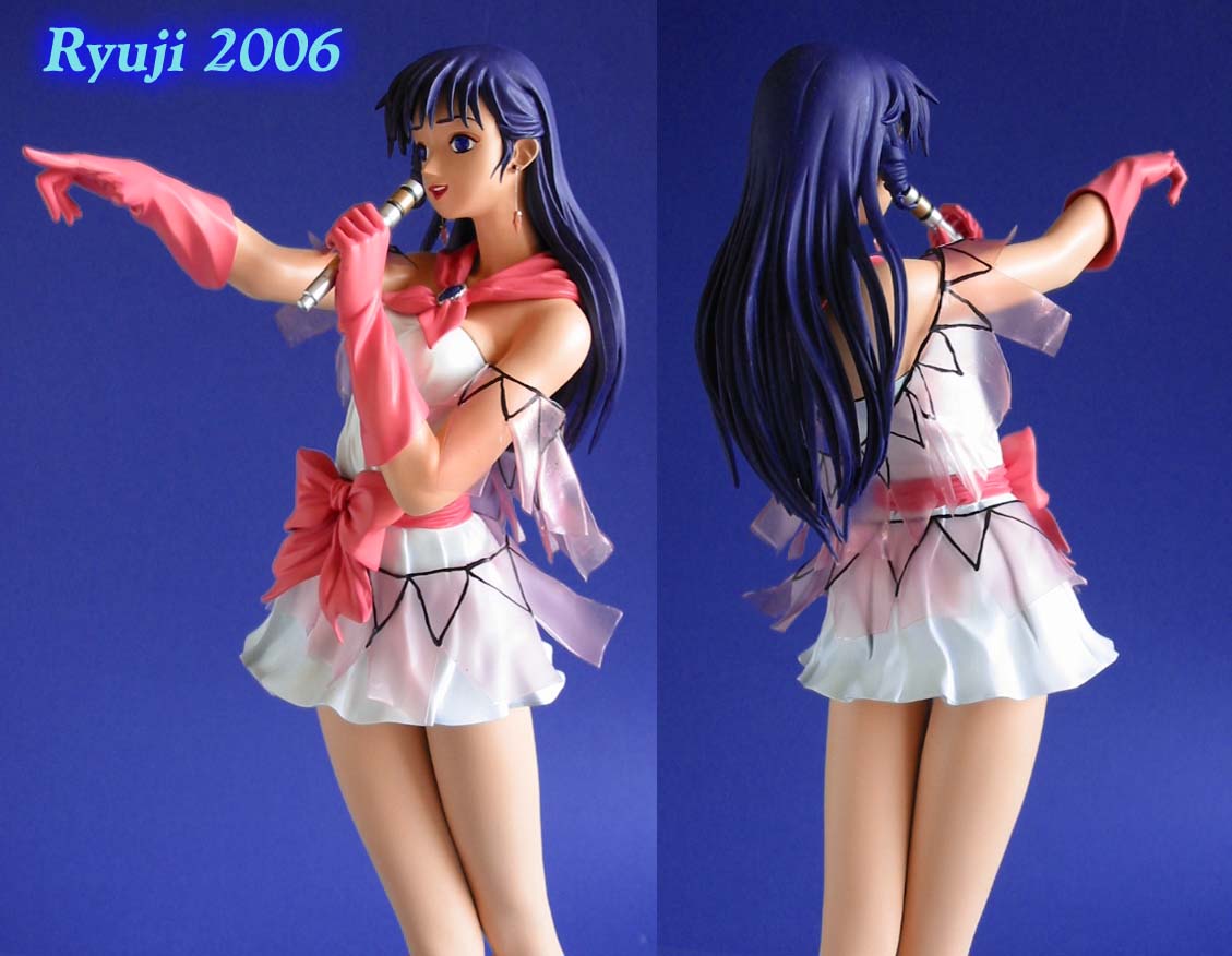

This kit is in my opinion one of the best one made out there with Minamy in her concert costume, although the legs could have been a little more to proportions!
This kit is so much more detailed than the Arii 1/6 one I have. The Arii one of this outfit is one of the better detailed ones. How tall is it when assembled ?
Great work by the way
I Wonder if there are any surprise final coating like other Minmay from the past :rolleyes:

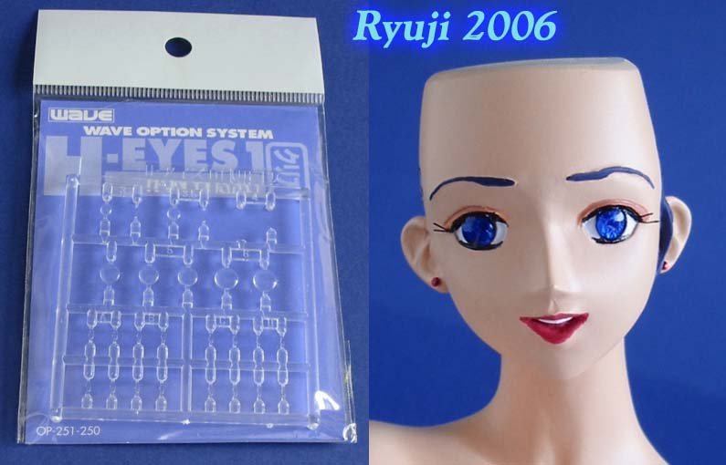

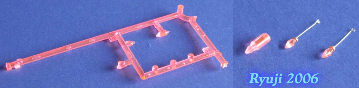

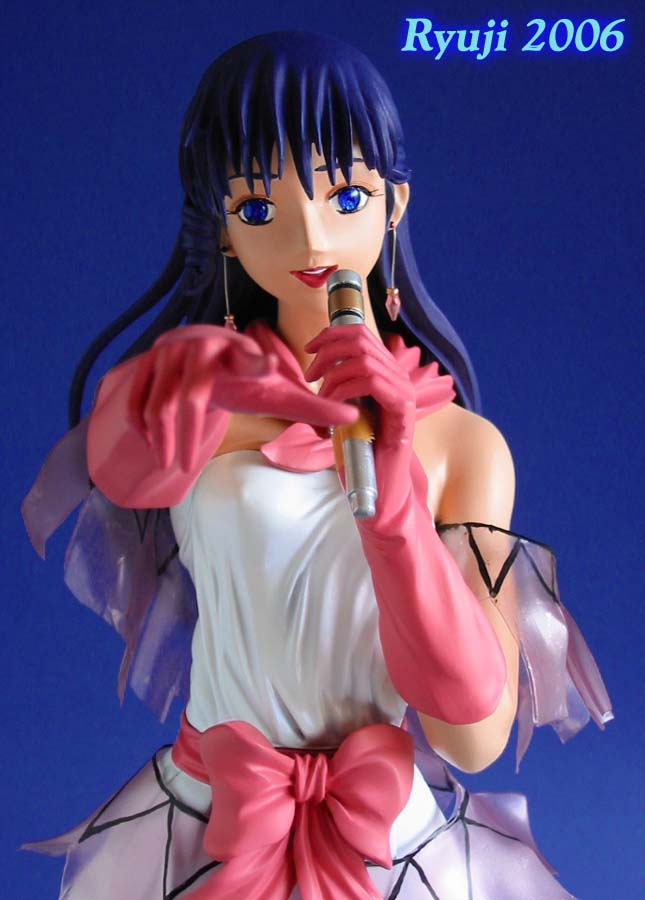

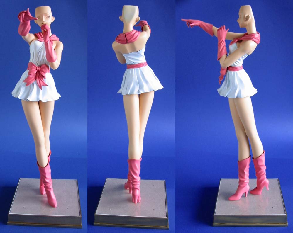

Making transparent eyes.
I usually use clear resin,but this time I used Wave parts to make eyes lens. :)

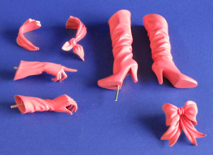

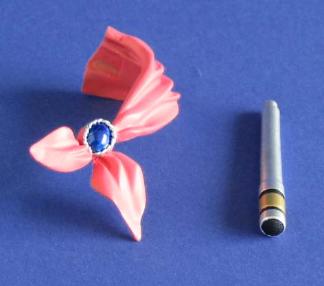

Replacing earrings.
The original earring was a not clear resin part,so I rebuilded using clear plastic from Gundam kit. :)

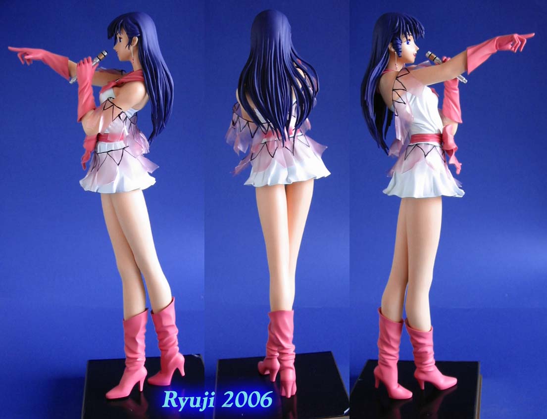

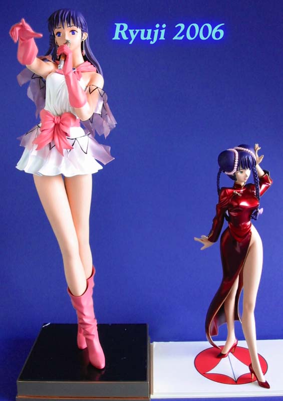

Wow... that kit looks very big... :blink:
Congratulations, Ryuji!

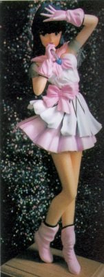

I have other 1/4 Minmay kit, but I don't buid it yet.
This is it:

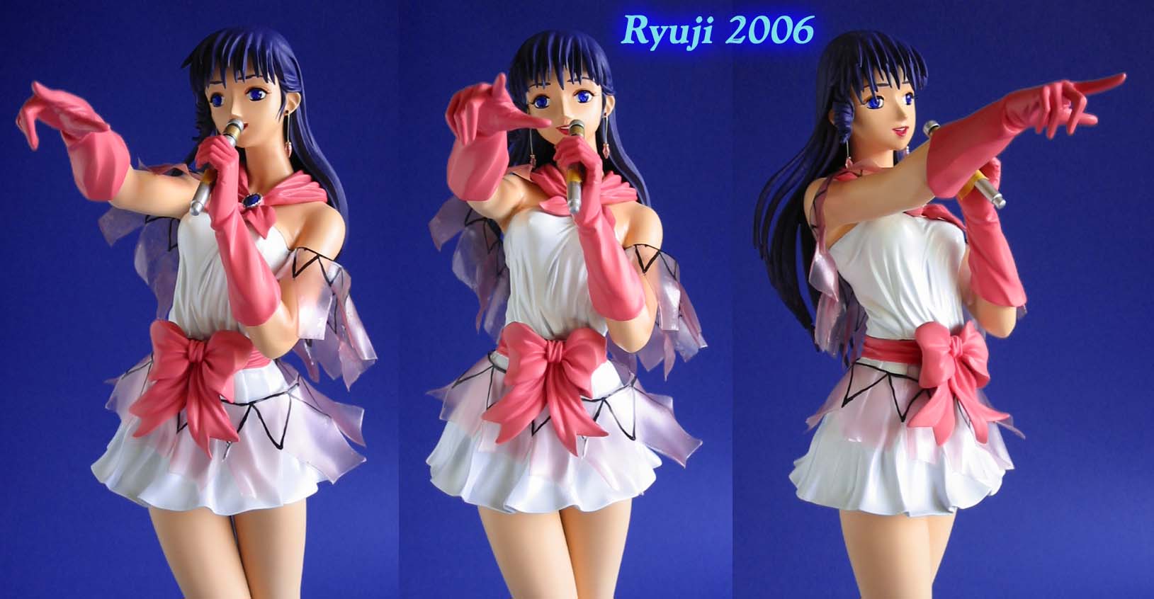

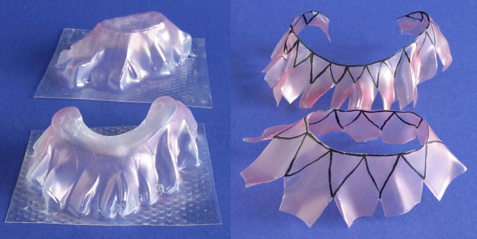

The main differences (apart from size) between this kit and the Arii 1/6 as far as I can tell is the clear bits. The ruffells round the skirt and sholders IMO they make the kit look far better. The hair sculpt is far better too. I think that when I build mine I`ll make clear ruffles instead.

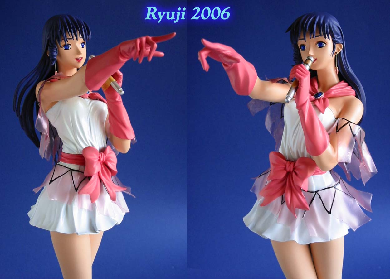

Just out of interest what did you use for skin tone.
415866[/snapback]
I used Gunze (GSI) Mr.color.
First, I paint the primer (Mr.SURFACER 1000),then a layer of Mr.WHITE SURFACER 1000 and then a mix of flesh (51), gloss white (1), flat white (62) and gloss clear orange (49).
