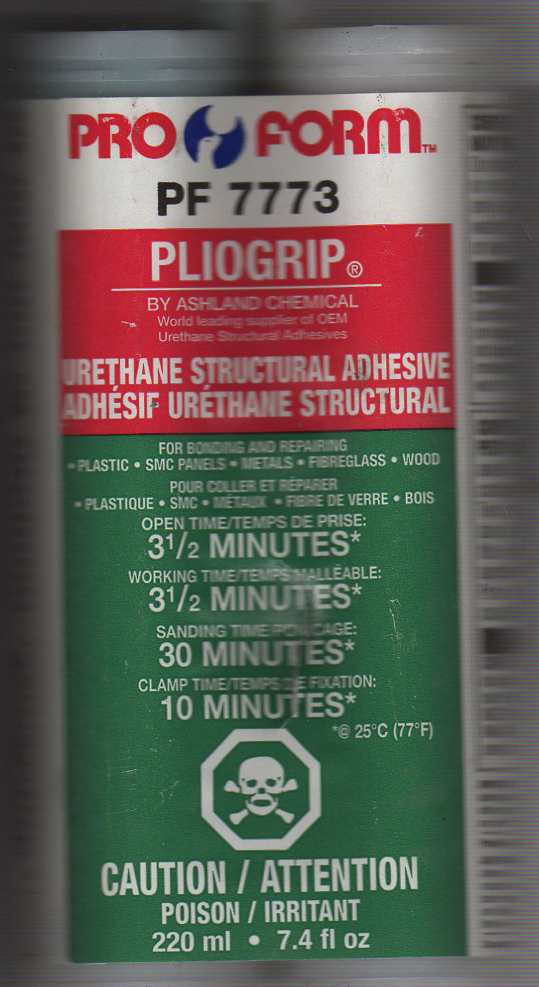

Chas Posted June 30, 2006 Posted June 30, 2006 (edited) I used to work in rapid protoyping and we did a lot of work for the automotive industry. We used to use this stuff all the time and, used properly, there wasn't anything that it wouldn't hold. I don't know if it's available through retail, but you could always check it out. It is a urethane structral adhesive, for binding plastic, SMC panels, meatals, fiberglass, and wood. As always it is best to sand, or otherwise scuff-up both of the mating surfaces to give the stuff something to bite into. Good Luck! If you can't find this stuff you could try contacting Ashland Chemical, the manufacturer and see if they have any suggestions. Edited June 30, 2006 by Chas Quote
