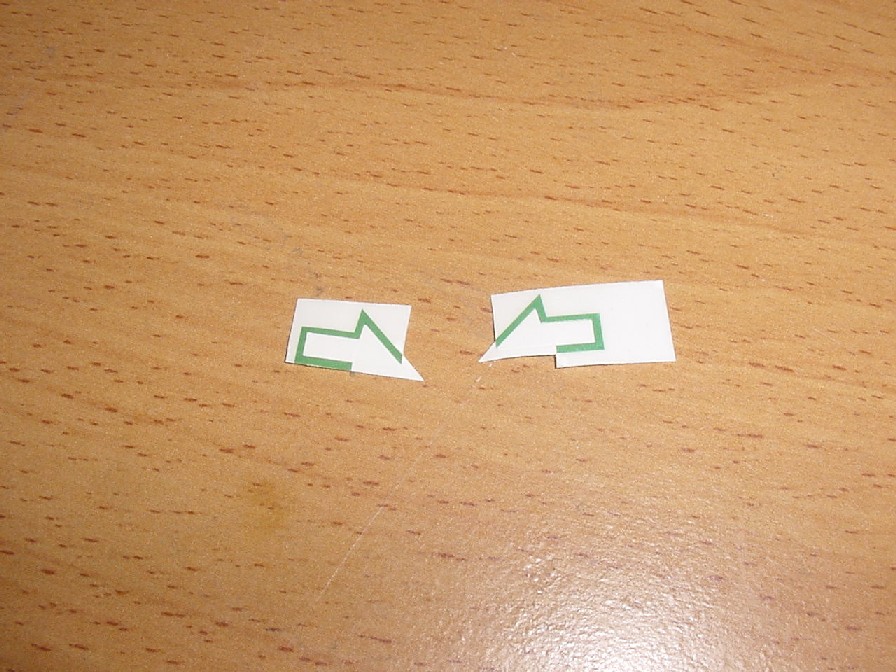

David Hingtgen Posted October 14, 2006 Posted October 14, 2006 While that is among the most accurate paint charts I've ever seen on a computer monitor (most are so off they're utterly worthless) it's still not dead-on. I've bought most of those paints, and in real life they're all a bit brighter. If I had a Hikaru, I'd give a suggestion. Italian red is "Ferrari red" though. Guards red is "Porsche red". I like Chrysler engine red myself for a bright red---no other "hue" in it. And while we're on the subject--I asked before but no one answered: Is the white plastic used on Max and Milia the same as a Hikaru? (1J for all) Quote
do not disturb Posted October 17, 2006 Posted October 17, 2006 Since wer're on the subject of paint matching anyone know what's a good paint match for Hikaru's RED and Max's BLUE on the 1/48 VF-1A's? I'm looking to make a custom 1S head and would really appreciate it. I'll probably use the testors in those small bottles. pick a red/blue thats close and just paint the arrows. even if they don't match perfectly, its nearly impossible to tell since theres no other red/blue highlights on the S head to draw a comparison to. seriously, unless you 're holding a swatch of the red/blue next to the head, you'll never be able to tell. if you want a really close match and don't want to paint at all, you can use the left over leg armor arrows stickers from the FP kit. http://www.macrossworld.com/mwf/uploads/po...-1095874328.jpg And while we're on the subject--I asked before but no one answered: Is the white plastic used on Max and Milia the same as a Hikaru? (1J for all) i checked out the M&M's and the nose cones on the rest of my valks and the M&M nose cones are definitely a brighter shade of white in comp to the rest of the valks. Quote
