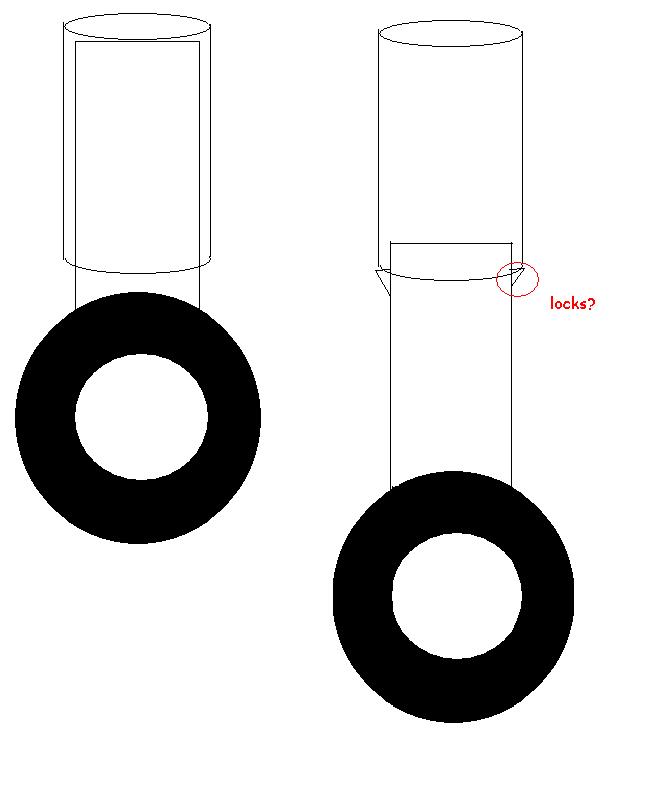

Hey David, for the YF-21 rear landing gear what about having a mechanism similar to the vf-1/vf-0 gunpod extension? In figther mode the rear landing gear wold be almost half long. When the gear is open, you can extend and lock the gear for landing. I'll try to make an example with my no good paint skills.
Sorry for my lack of skill
Or maybe twist and lock? I did something similar for the front landing gear of my 1/72 yf 19 a long time ago. I'll try to get some pictures and post them tomorrow.

It's not so much length as depth. We need rotating gear more than extending/compressing gear. That'd cut the depth required for wheel wells in half. But it's equally easy to implement---it's how most real fighters do it, and how Kawamori designs every valk (excluding the VF-17) to do.
What you drew would certainly help most nosegears though, and would also allow another issue I have with recent valks--GIGANTIC catapult launch bars on the nose. Real planes kneel down so the launch bar can reach----the launch bar isn't big enough to reach down to the catapult in normal conditions. Yamato toys can't kneel, so the launch bar is like 3x as big as it should be, to reach the ground.
Yamato frankly has greatly advanced most parts of the valks, yet still has the landing gear of a 1955 tin toy! If they would spend 1/10 the money on the gear that they do on working airbrakes etc, they could have much better gear that'd fit in much much smaller wells, allowing better fighter and battroid modes.
A lot of it comes down to "we have to make this area bigger to accomodate the gigantic wheel bay inside". Or "the wheel bay takes up so much room inside the leg/nose, this part has to be way smaller to get out of the way".
If they had rotating gear (simple and easy to do) they could make the wells half as deep. And if they had compressing gear (like Gatillero drew) they could also be half as long. I bet a wheel bay for the nose gear only 1/4 as big could have helped the YF-19's belly a lot. The alternative is removable gear. Either way, it leads to much smaller gear bays. You either have to have rotating wheels/compressing struts, or removable gear. Yamato's "simple working gear" leads to gigantic wheel bays that interfere with everything around them.
Real plane manufacturers have spent decades coming up with ways to make landing gear fit into as small a space as possible--and most of them are very simple to implement, and have even been found in small diecast model jets, etc.
PS--you did a twist-and-lock? Incorporating a 90-degree turn of the wheels? That's exactly what nearly every valk could use for the main gear.
PPS--I am so going to scan my WAPJ F-14 schematic showing the gear rotation. Only drawing I've ever found that actually shows it--despite it occuring on so many planes. Such a simple concept, but hard to explain (since wheels and tires rotate anyways, it's hard to explain how they rotate the OTHER way)

Exactly, I'll get the pics tomorrow, it's crude, I used a Bandai 1/100 VF-19 Kai front gear to do it.
I'd have concerns whether a rotating, collapsable landing gear strut would be durable enough. The top part of the strut that the lower part collapses into would have awfully thin walls on a 1/60 scale toy.
Graham
FYI, I know a guy who does steerable/rotating metal landing gear at 1/400 scale for airliners. Like, .1mm tubes and such... Builds the axles from scratch from needles I think. For solid metal diecast planes. And I think he's done a few 1/200. The 1/200 airliners weigh far more than any Yamato ever would. Actually, a 1/400 747 weighs more than a Yamato 1/48 I think. Haven't seen one collapse yet. The parts are nearly microscopic, but diecast is frankly very weak---actual aluminum or steel tubing is far stronger. (Diecast is mostly zinc with a dash of magnesium, aluminum and copper---little better than pot metal)
Also, just follow real planes--you don't arbitrarily slice the strut in half and try to make two tubes of similar diameter slide into each other---the lower, smaller oleo strut goes into the thicker main strut. There's supposed to be an obvious size difference, so that the main strut (tubular) can have much thicker side walls---otherwise real planes would be collapsing their thin-wall tubular gear struts all the time.
