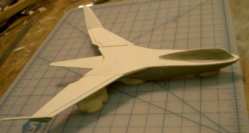

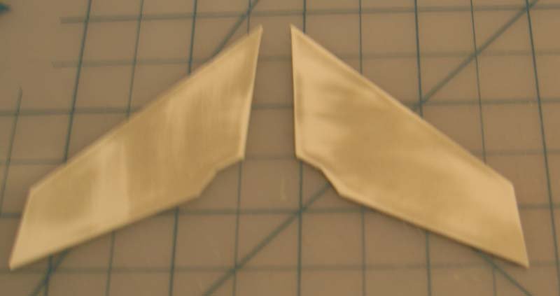

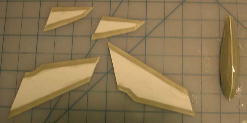

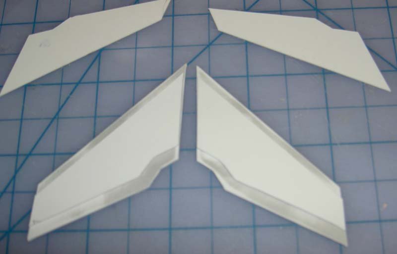

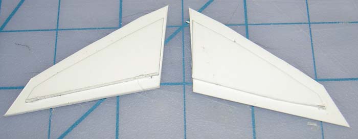

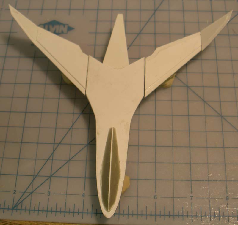

Valkyrie Posted April 14, 2006 Posted April 14, 2006 I posted about this project in the 'what's on your workbench?' thread earlier today with a couple progress pics (a mere 24 hours into the project). I've been working on it a bit more tonight, and I took some more pics to document the project a bit more. And I thought I'd post them here. So if you're at all interested in the project or how it's being done... then by all means, read on. Keep in mind, I'm by no means an expert at this kind of thing. This is just me applying a few tricks I read on the 'net, and a few more build ideas that I came up with, that sounded good at the time. This isn't exactly my first attempt at a scratchbuild, but it does hold the potential of being the first one that I actually finish. And in less than 6 months, no less! First, here's the earliest pics I took of it. I wish I thought to start taking em sooner. At this point, the latest application of putty (Avees Apoxy Sculpt) was still curing, so I started on the wings. I got the shape of the wings onto styrene by drawing them in AutoCAD, then printed them at 1:1 scale. Then I cut them out, used spray adhesive to glue them on to sheet styrene, then cut them out. I based their thickness on the 1/144 drone kit that I have. They're about 0.04" thick at 1/144, so I'm making them 0.08" at 1/72. But, of course, they're thinner than that at the leading and trailing edges. I could have just cut them out of .08 styrene and sanded down the edges, but I thought it might be easier to make them consistant if I did each wing in 3 layers. Here's what I did: 1) cut out wings on .04 styrene 2) cut out 4 more on .02 styrene, with the edges trimmed back, then glued one on each side of each wing 3) same thing for the canted wingtips 4) fill in the gaps with putty, tapering down the edges And that's about where I left off. I hit the dome with a bit more putty while I was at it, to flesh it out a bit more. Same with the nose, which looks very close to being right to my eye. I'll leave you now with a couple mock-up pics I took along the way. I may be biased, but I think it's looking pretty good so far 'Til next time, whenever I have time to work on it more... I'll probably start on the engine pod then. Quote

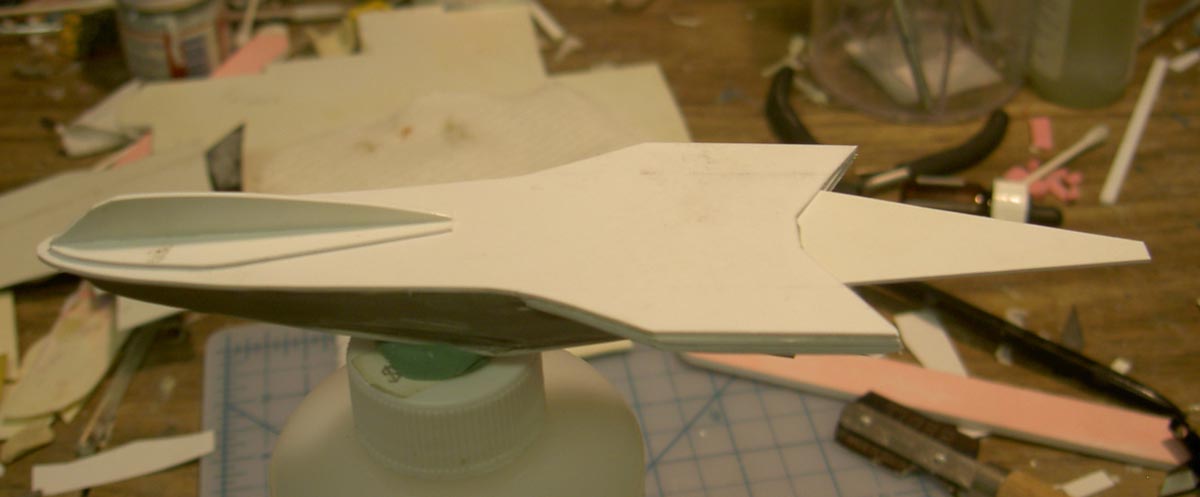

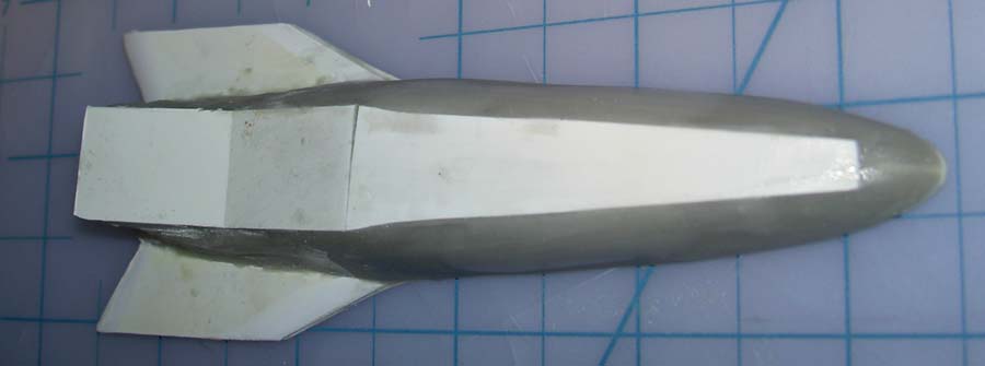

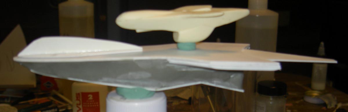

Valkyrie Posted April 17, 2006 Author Posted April 17, 2006 Alrighty, got a couple days of progress to post on. Rather than wait until my next days off work, i'm finding myself working on this thing for an hour or so every night after work. I seriously can't keep myself away from it! So it seems my Modeler's ADD is temporarily cured! But as a result, I probably won't get my Wonderfest project done in time Anyway, onto the build: (using my own webspace this time) I'm going to need the engine pod to be a seperate piece, so I started by laying down a strip of styrene to conform to the V shaped groove, and a small block to act as a locator for easier assembly. Then I cut out the intake extension and the vertical guide for the pod. I assembled it with plastic cement, reinforced with CA (superglue) when it was dry, threw on a very rough coat of putty, and called it a night The next night, I drew and cut out horizontal guides for the intake and two 'ribs'. The intake wasn't quite to my liking, so I did without it for the time being. When mounting the ribs, I immediately regretted throwing on the putty the night before. But I still made it work. Just had a bit more plastic to cut. After gluing them in place with CA, I fleshed it out a bit with more Apoxie Sculpt. Which brings me to tonight. I got the intake guide fixed up. Gluing it on centered and square was the hardest part here. More fleshing out with putty A bit on the fuselage too (the two parts are still seperated though) And here's a better angle. And one more thing, about the missiles -- I completely forgot, I already have some! The Club-M YF-19 and VF-11 come with High-Maneuver missiles! Honestly, I've never been a huge fan of Tanmen's sculpt of them. But they'll definitely be a good starting point, if nothing else. Anyway, I hope you all are enjoying watching as I fumble my way through this project. Though I know somewhere out there, Cap'n A is reading this and thinking "Hah! Amateur!" But it's all good. I'm having fun Quote
