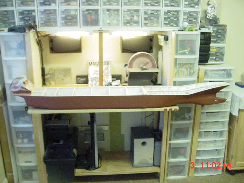

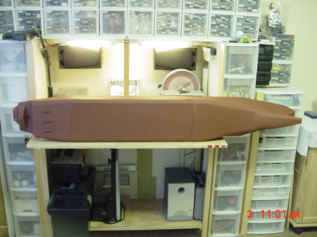

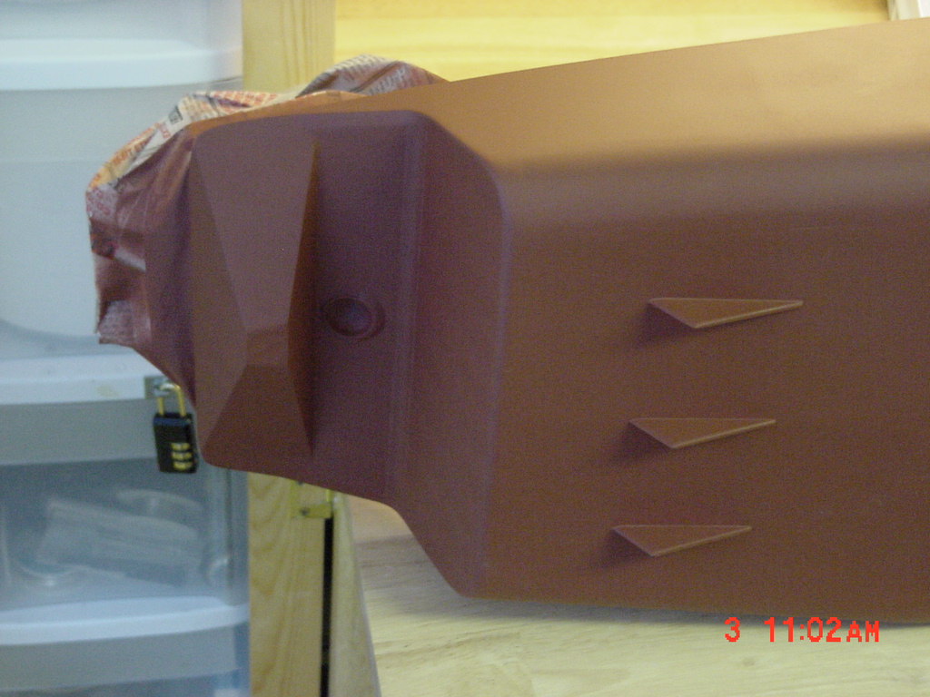

MechTech Posted December 3, 2006 Author Posted December 3, 2006 (edited) UPDATE 3 DEC 06 PRIMER!!! Hey SDF-1, sorry about the files. Funny thing is, I can't open them either!!!??? If you know of another way to post these, I'd be happy to do it. Like how some people post the picture directly into the thread - I don't even know how to do that. Thanks for the compliments Thor. Each thruster housing in itself is watertight. The covers with silicone RTV seal the back - that's easy. The front has a plate that holds the motor on with two screws. Each plate has a tube assembly filled with epoxy around the shaft seals. The shaft seals are a grease seal on the front followed by two brass rings that also seal the shaft. The area between the brass rings is filled with silicone oil (the silicone oil won't harm the styrene). If you look a few days back you can see the oil fill spouts. The primer revealed a few flaws (like I thought it would). You can see the width of the beam a little bit better now. After I glued the three skegs on the back (that's what they're called on a surfboard) it reminded me of a surfboard! [attachmentid=38624] Side [attachmentid=38625] Bottom [attachmentid=38626] The stern (three hydrodynamic skegs on the right). After my wife and I looked at several drawings, we agreed this type was the closest to canon (verses having a squared of rear right on top of the motor box). This week it's float test time!!! - MT Edited December 3, 2006 by MechTech Quote

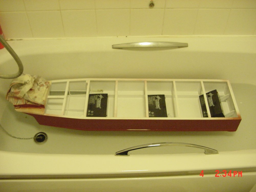

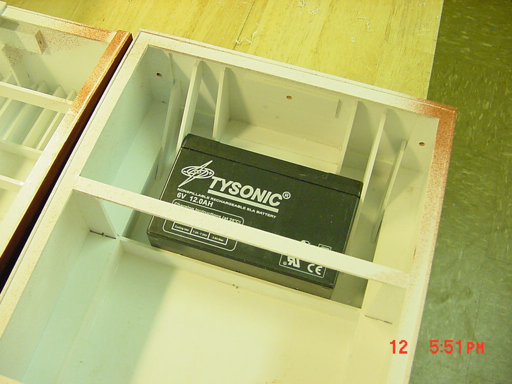

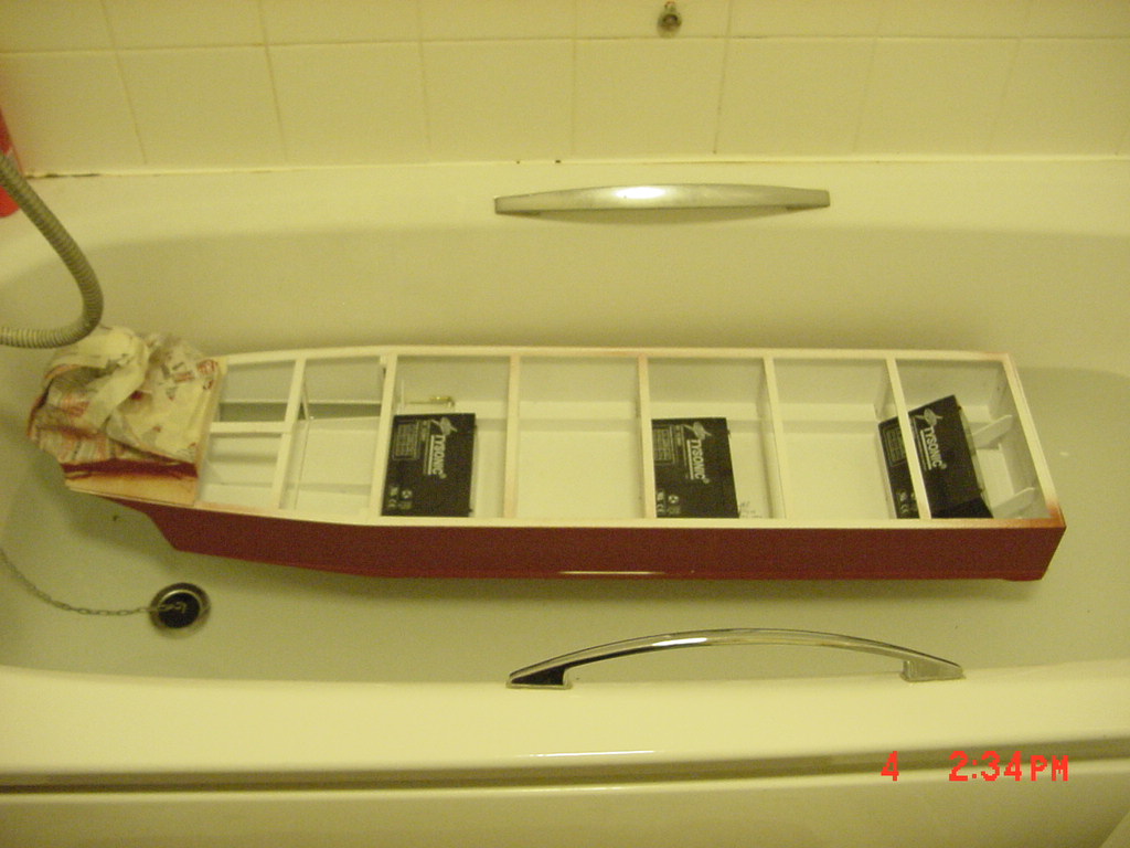

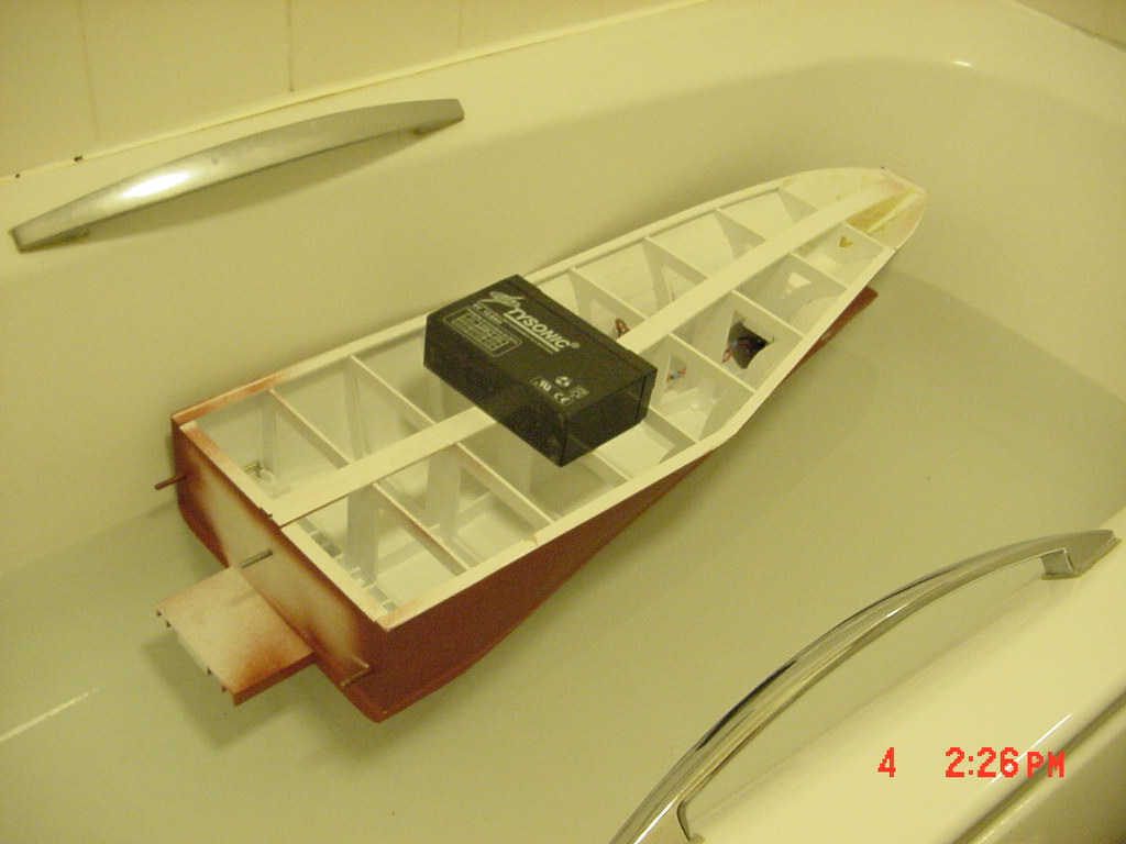

MechTech Posted December 4, 2006 Author Posted December 4, 2006 UPDATE 4 DEC 06 FLOAT TEST! YEA IT WORKS! NO PROBLEMS! [attachmentid=38635] Here's the front. It's so stable, you can rock it with the 4.5lb battery on top! [attachmentid=38636] Here's the back with all three batteries (13.5lbs). Plenty of buoncy to spare! I think I'll have to add some weight to the hull (still have more goodies to put on anyhow). When the winds and rain let up, I'm going to the reservoir! - MT Quote

big F Posted December 5, 2006 Posted December 5, 2006 Well looks like your well on your way. Plenty boyant enough by the look of the pictures. all the better for the handfulls of destiiods and Vf`s you`ll have to pack in. What primer did you use ? Quote
neptunesurvey Posted December 5, 2006 Posted December 5, 2006 You have achieved a major success! Is it me or does it look shorter then 6ft. Quote

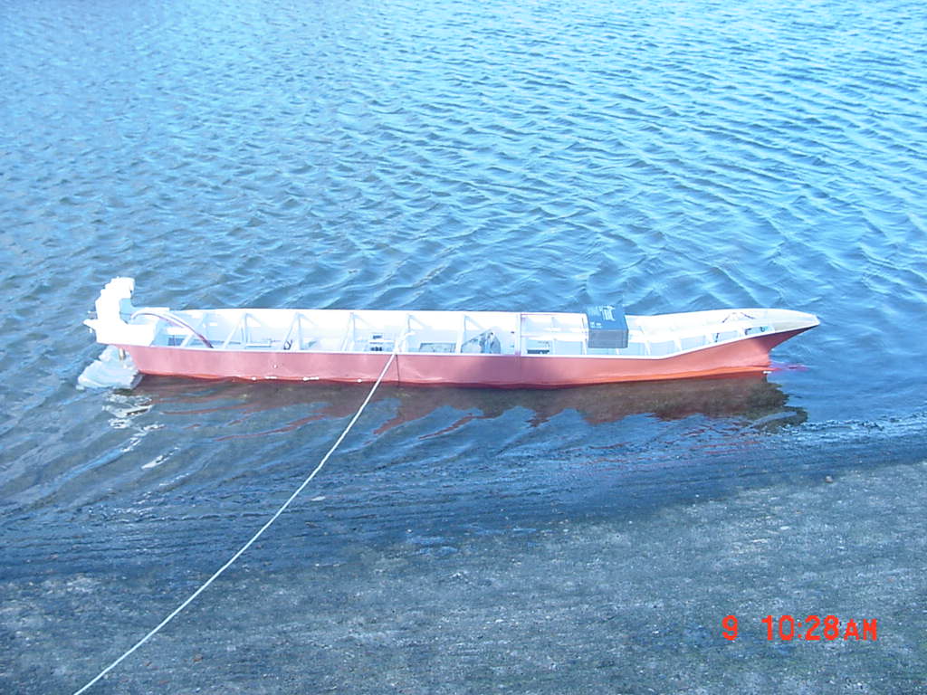

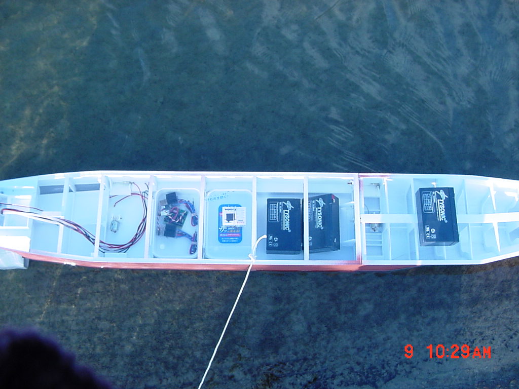

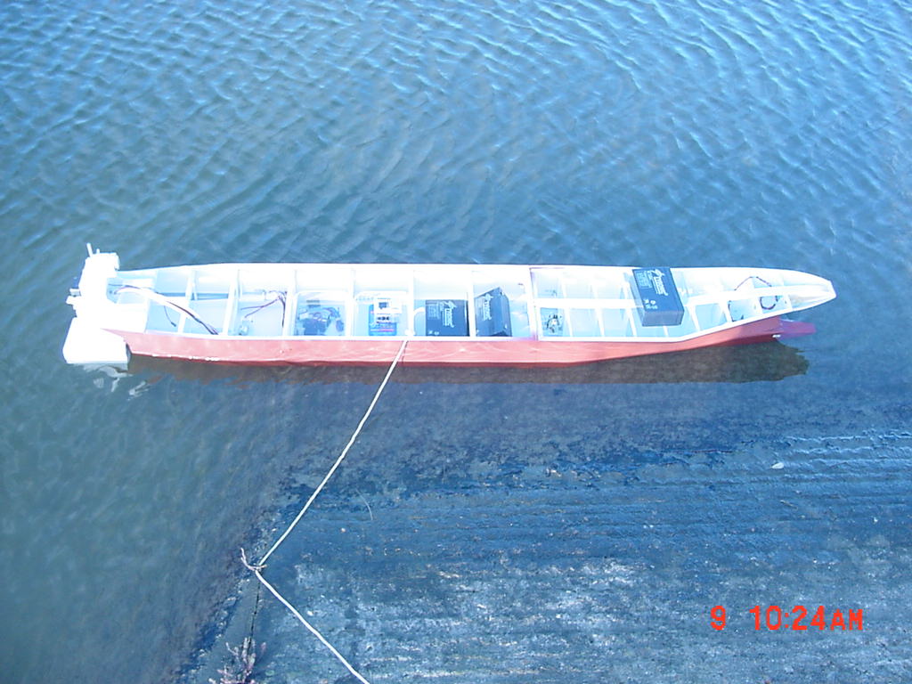

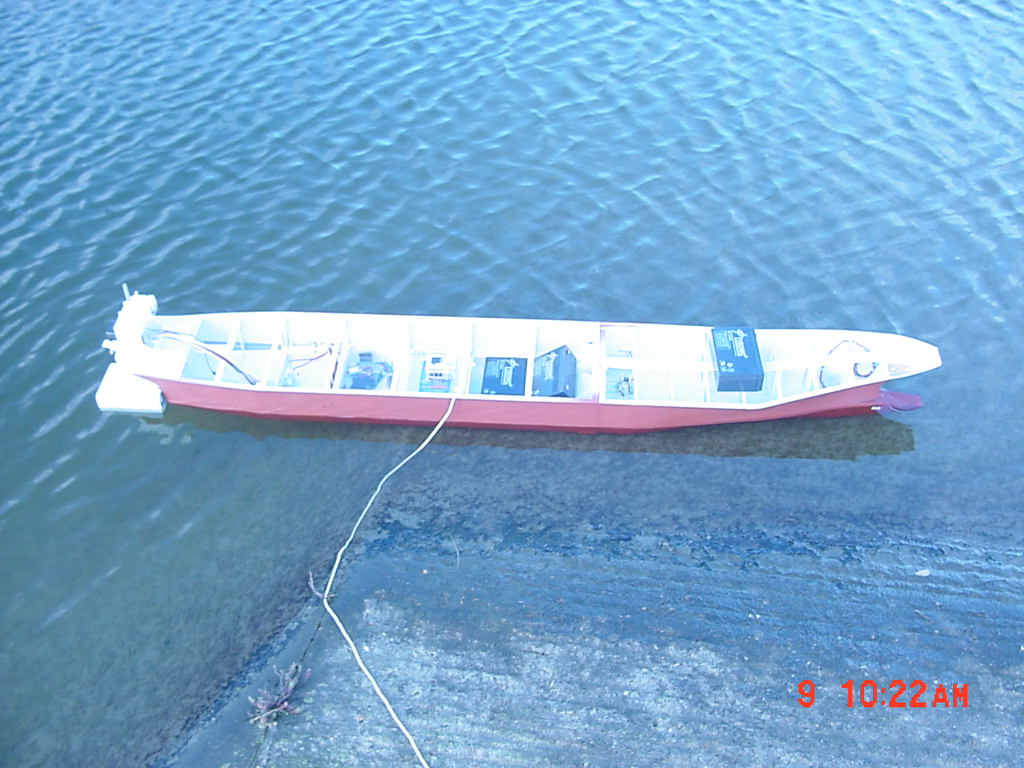

MechTech Posted December 9, 2006 Author Posted December 9, 2006 UPDATE 9 Dec 06 Her first taste of the reservoir ! [attachmentid=38806] With the pod up. [attachmentid=38807] With the pod down. [attachmentid=38808] Regular side shot. [attachmentid=38809] Top layout. (Note the batteries towards the front) I was afraid I was going to have to make room in the front half for a battery and I was right as you can see. I always balance everything out before mounting it in place. The least amount of weight I have to add later on to balance her out, the better. Keep in mind the top half isn't on there yet either. The hull is VERY STABLE. It pops right back into place after rocking it in the water. Good news ! Everything went well except for my leg slipping into the freezing water and cutting my hand aftr falling - BUT THE SHIP IS OK! Tonight I'm hooking up the actuators for the side stabilizers. - MT Quote
honneamise Posted December 9, 2006 Posted December 9, 2006 This is unbelievable! And it does not look like a small floating model ship, more like one of those huge models like that were used in Bond movies, "Liparus" comes to mind! I really hope you won´t encounter any stability issues once you have added the enormous upper half! I mean, if you build it light-weight there should be no problem, but if you are going to add all the interior stuff and a full complement of destroids, there might be a considerable weight increase. But considering the sheer size of the model, the "machinery" should still outweigh the upper parts. I´m looking forward for more!!!!! Quote

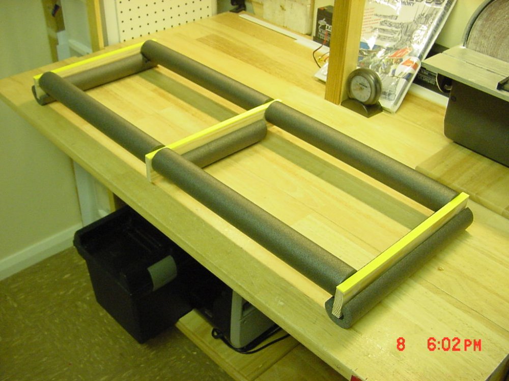

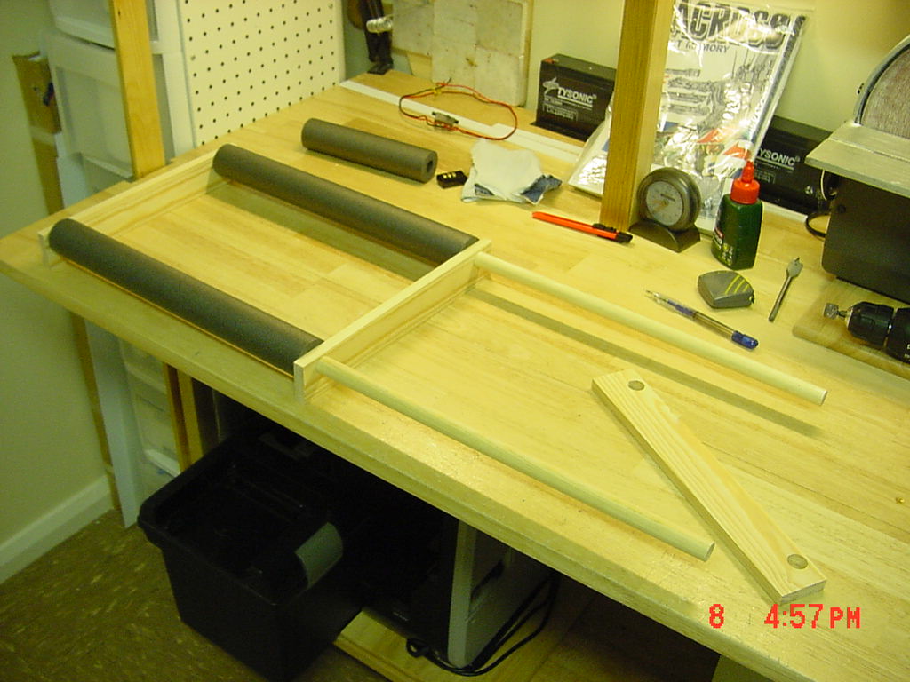

MechTech Posted December 10, 2006 Author Posted December 10, 2006 (edited) UPDATE 10 DEC 06 Make a stand! It's an expression. I needed a maintenance stand for working on it and for the water side. Thanks again everyone for the encouraging words. I always knew it would float (I've built a bunch of other ships before-but not scratch built to this degree). I just didn't know how well. [attachmentid=38837] Building the maintenance stand. [attachmentid=38838] Completed stand covered with pipe insullation and yellow foam board. [attachmentid=38839] My favorite lunch box and spare (still unwrapped) are going to become my electronics and radio boxes. The gasket seal on them and quick release handles make these perfect. I picked them up on sale at an asian market back home. [attachmentid=38840] One of the winches to control the stabilizers. [attachmentid=38841] Another view. [attachmentid=38842] The winches (one shown with lines on either end) and pulleys. These are what will actuate the stabilizers. I'll make an MPEG when it's all hooked up. That's as far as I got last night. - MT Edited December 10, 2006 by MechTech Quote

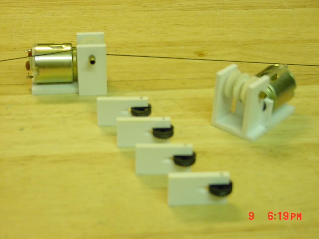

MechTech Posted December 12, 2006 Author Posted December 12, 2006 UPDATE 12 Dec 06 Thank you guys again for the encouragement and compliments! Sorry about the whole water thing do not disturb. At least no one saw ME do it . After I finish the bottom, the top will have two elevators, opening main hatch, folding ramp, water guns and some other goodies I'm working on. Chas you're too funny man, "Daedalus Day, December 9th." You get the first "card." I was wanting to do the stabilizer actuators this week, but I figured I better fix the battery compartments first since some of the linkages will run through that area. Remember the battery on top of the front (and it was still VERY stable!) and the battery propped up towards the front, they're all fixed now! [attachmentid=38915] The front battery compartment. [attachmentid=38916] Another view. [attachmentid=38917] The midship battery area rebuilt and the tab box shortened with new strengthening. This will lower the center of gravity and increase the stability even more - yeah! Maybe I'll get to the actuators this week after all Take care guys - MT Quote
