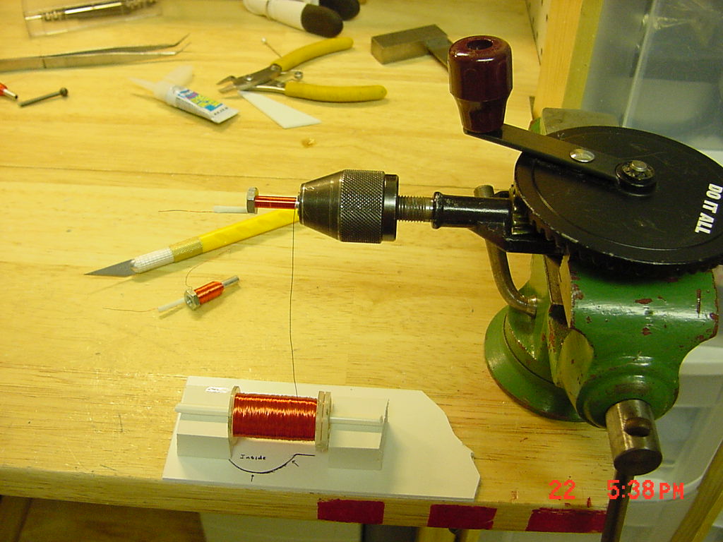

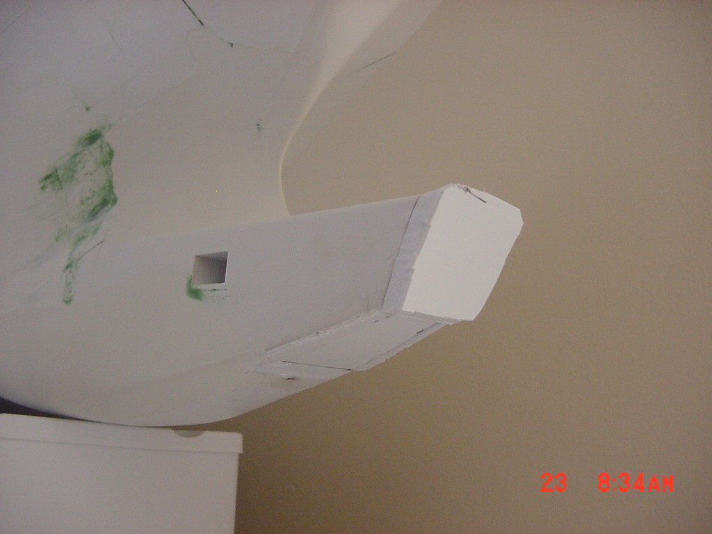

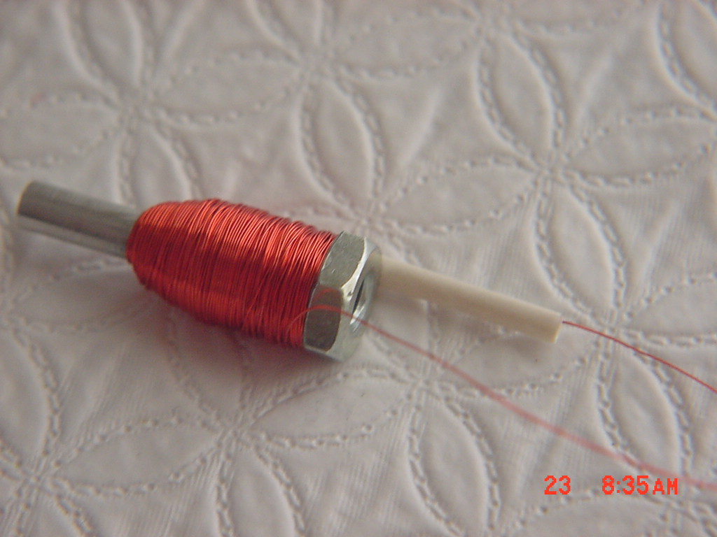

MechTech Posted July 23, 2006 Author Posted July 23, 2006 (edited) UPDATE: 23 July 06 It's been really hot here lately, but I haven't been sitting on my butt the whole time! I had to make my own solenoids for the actuators on the stabilizers. I couldn't find the voltage or size I need, so I have to make my own (talk about scratch building ). I also changed the shape of the bow nose (ONE MORE TIME!). I inverted the shape from what it is supposd to be from the drawings. It's fixed now. I just have to file and sand it down. Here's some pictures to give you an idea. Winding the solenoids Solenoid core windings Rough cut bow changes I wound the solenoid core on aluminum tube to help it cool faster, plus the bit sticking out will act as a heat sink and spring holder. The nut on the other end helps to focus the magnetic flux towards the front of the coil (the other reason for the shape of the wire windings). This upcoming week is going to be busy with Vacation Bible School, so I don't know how far I'll get. - MT Edited July 23, 2006 by MechTech Quote
big F Posted July 23, 2006 Posted July 23, 2006 Great work. I know how teadious it can be winding your own coils and such. I used to have to wind transfromer coils by hand "Yawn". Dont wear yourself out this next week, I,m on holiday this week and I`ve already been given "little jobs" to do round the house. So no fun for me. Quote
