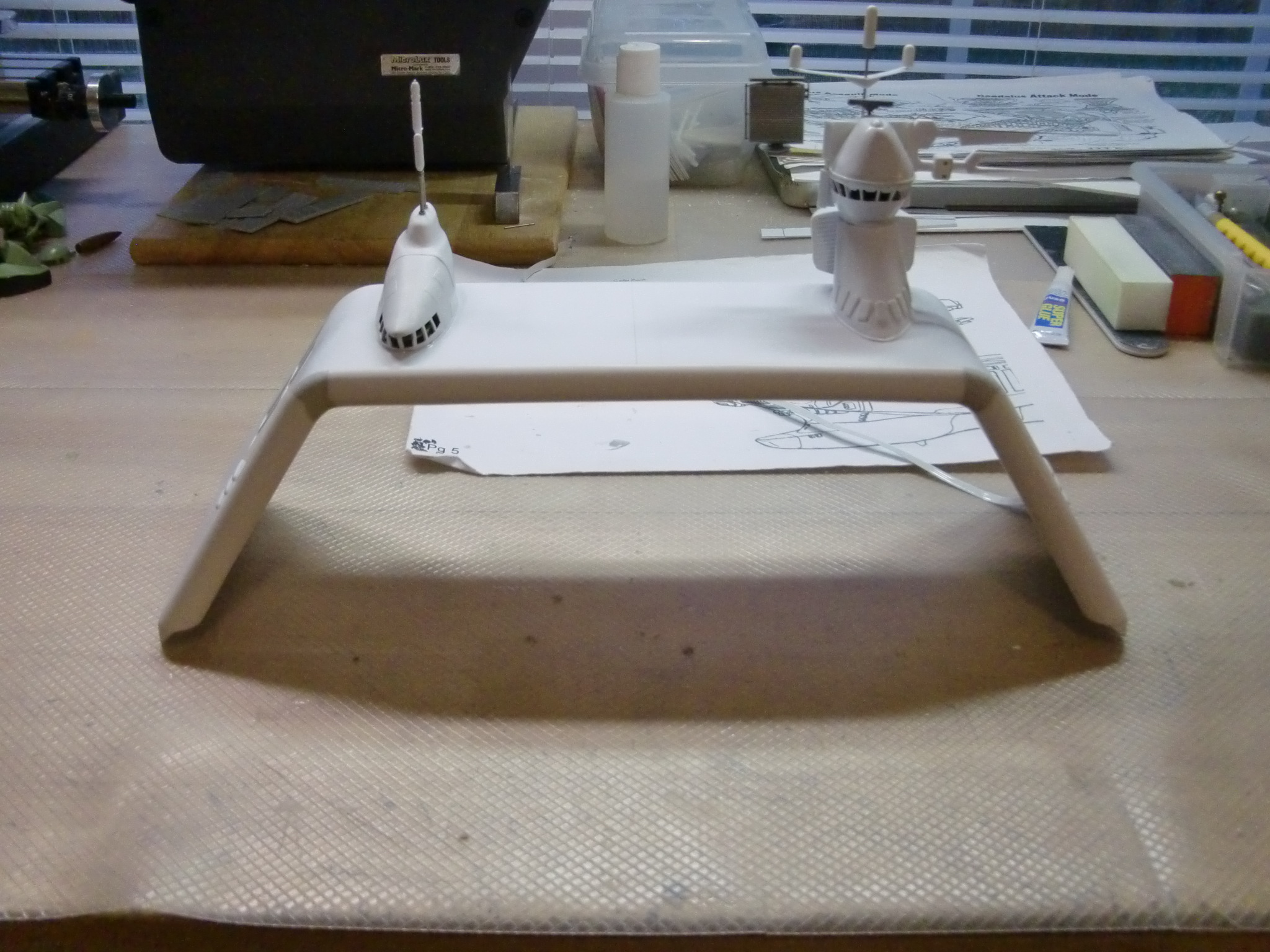

UPDATE 19 MAY 2011

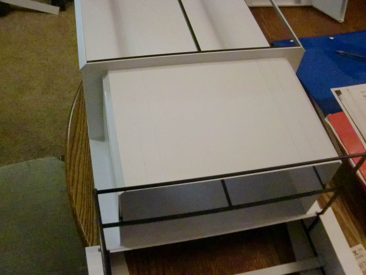

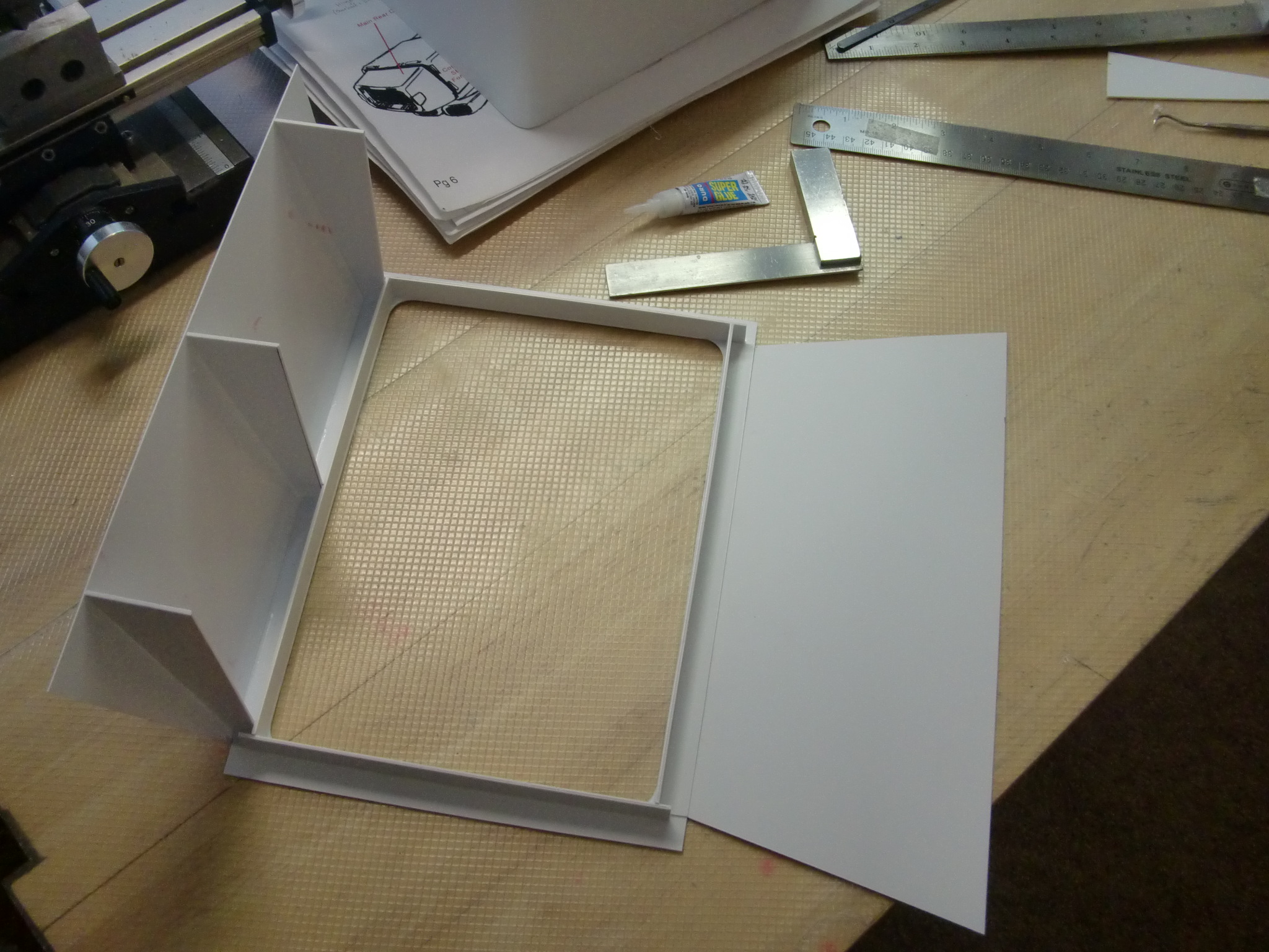

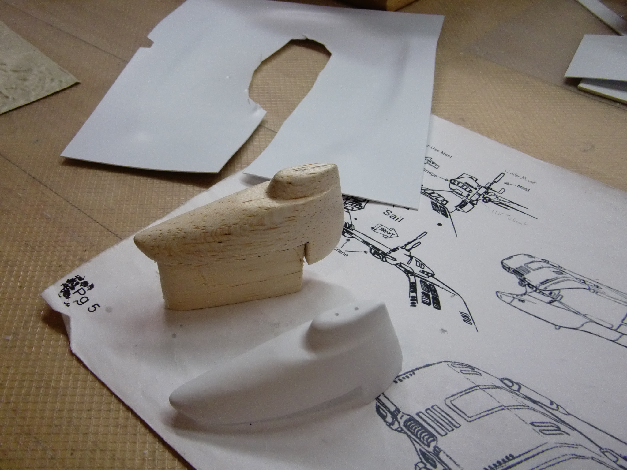

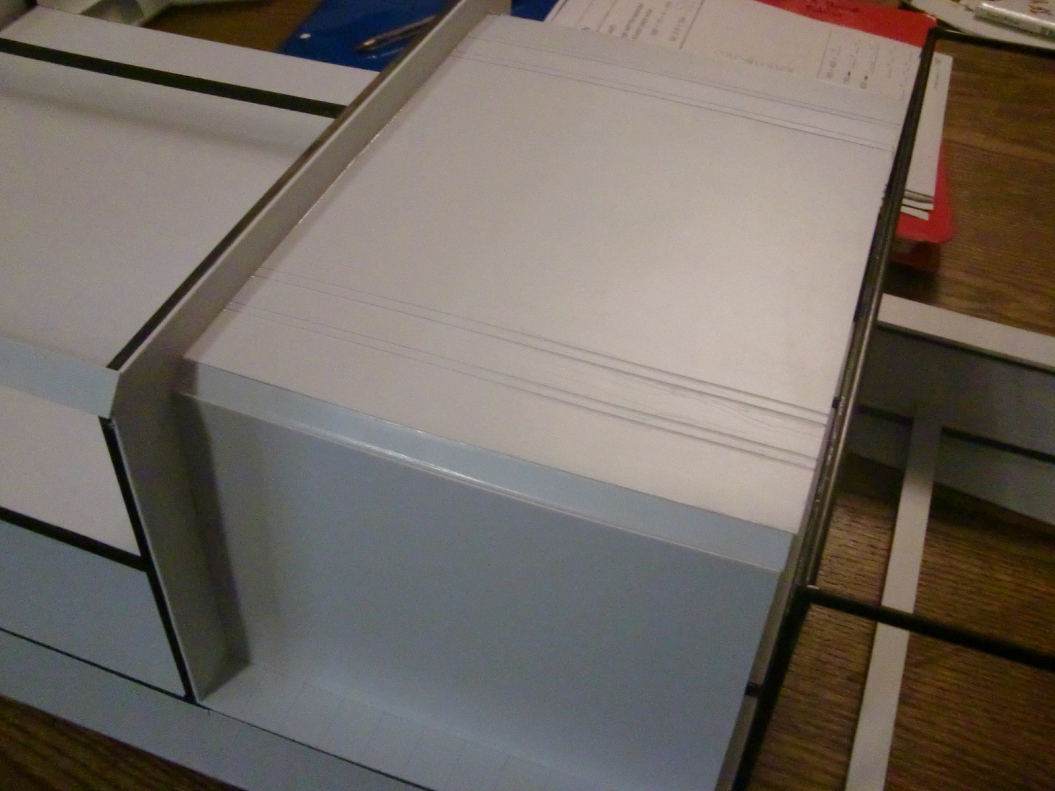

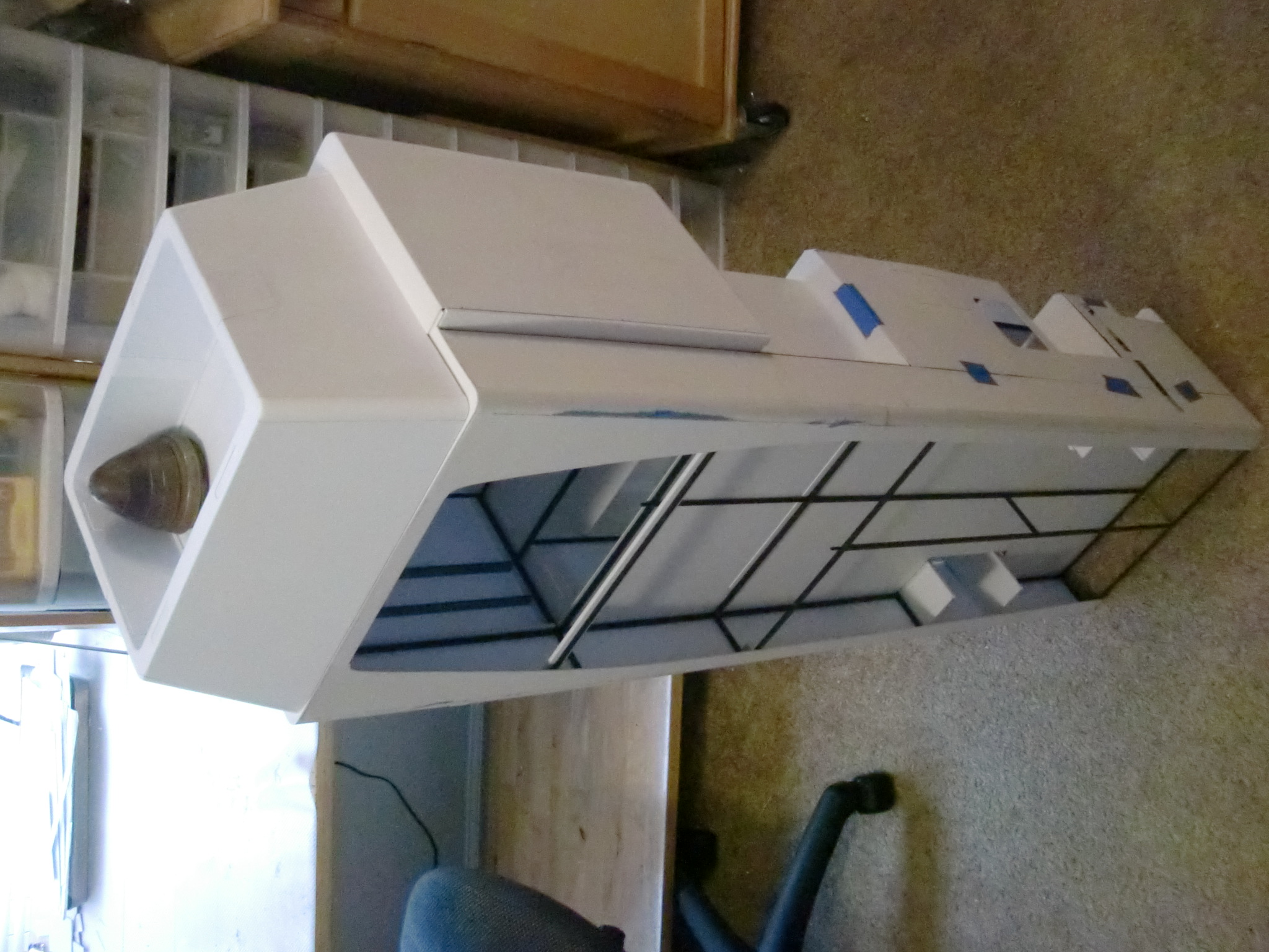

Well, after a month of working my butt off at work, I was just too tired when I got home to do anything on my baby, but now I'm back on it! The upper rear (suspected container crane holder and side loading ramp areas) is now getting worked on.

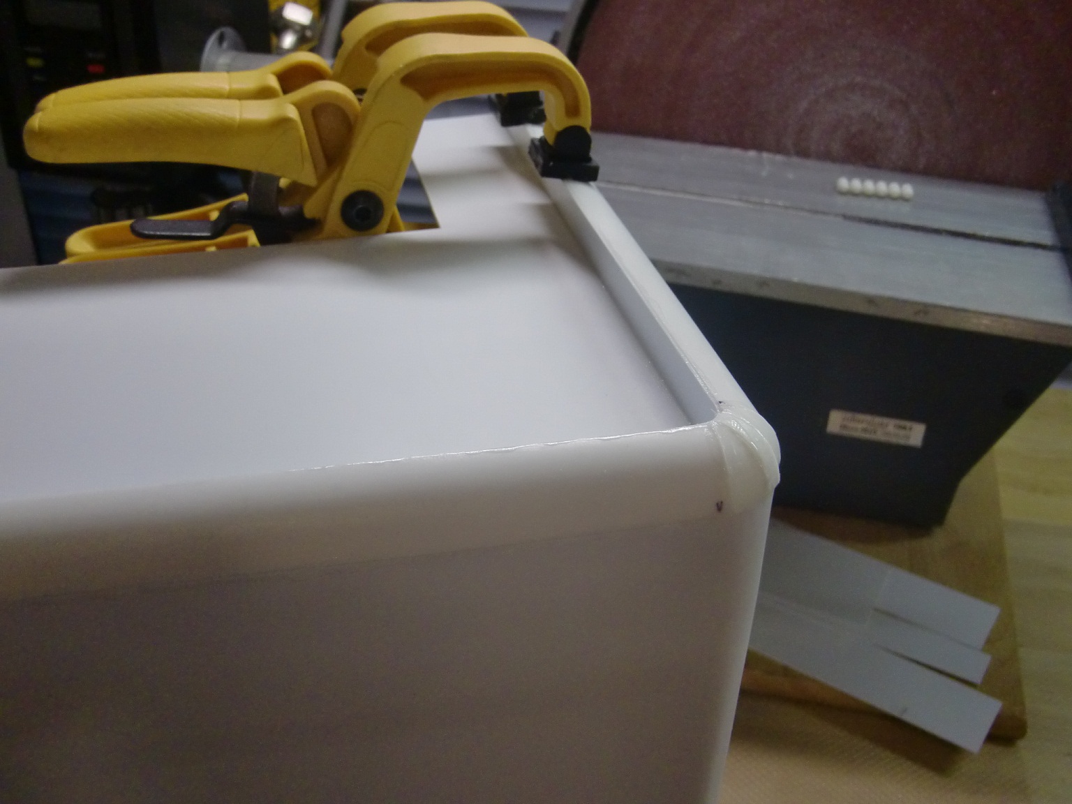

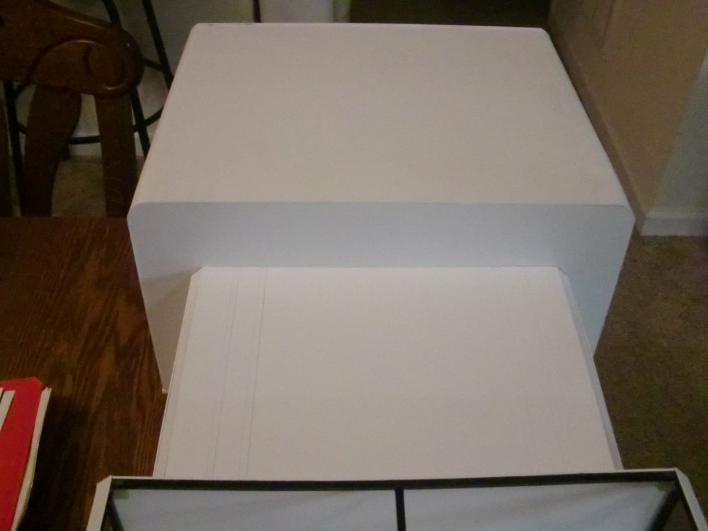

The first part completed was the "hanger" for what some of us suspect is a container for a "loading/unloading crane." It's the very rear end of the ship - for now. You can see some of the scraps that I used to make the inner (no one will see) frame for the railed area.

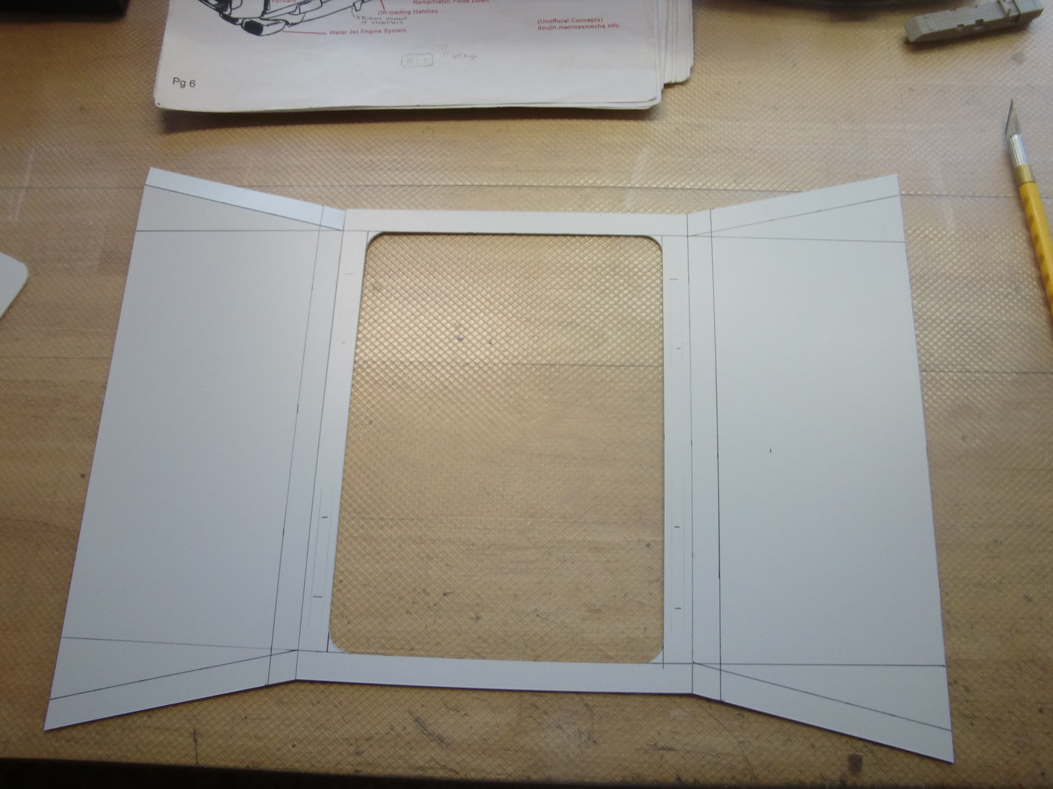

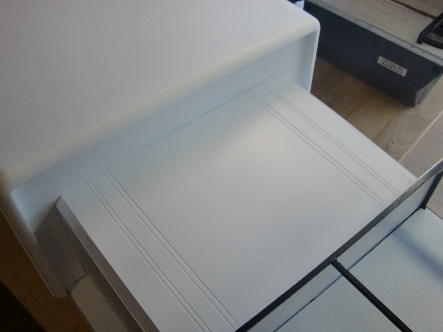

That area is now covered and I scribed in with a 1/8" wide chisel being draggeed along the edge of a ruler.

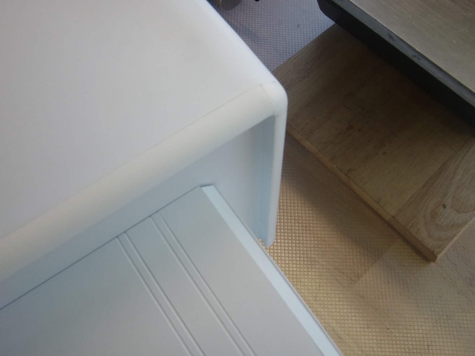

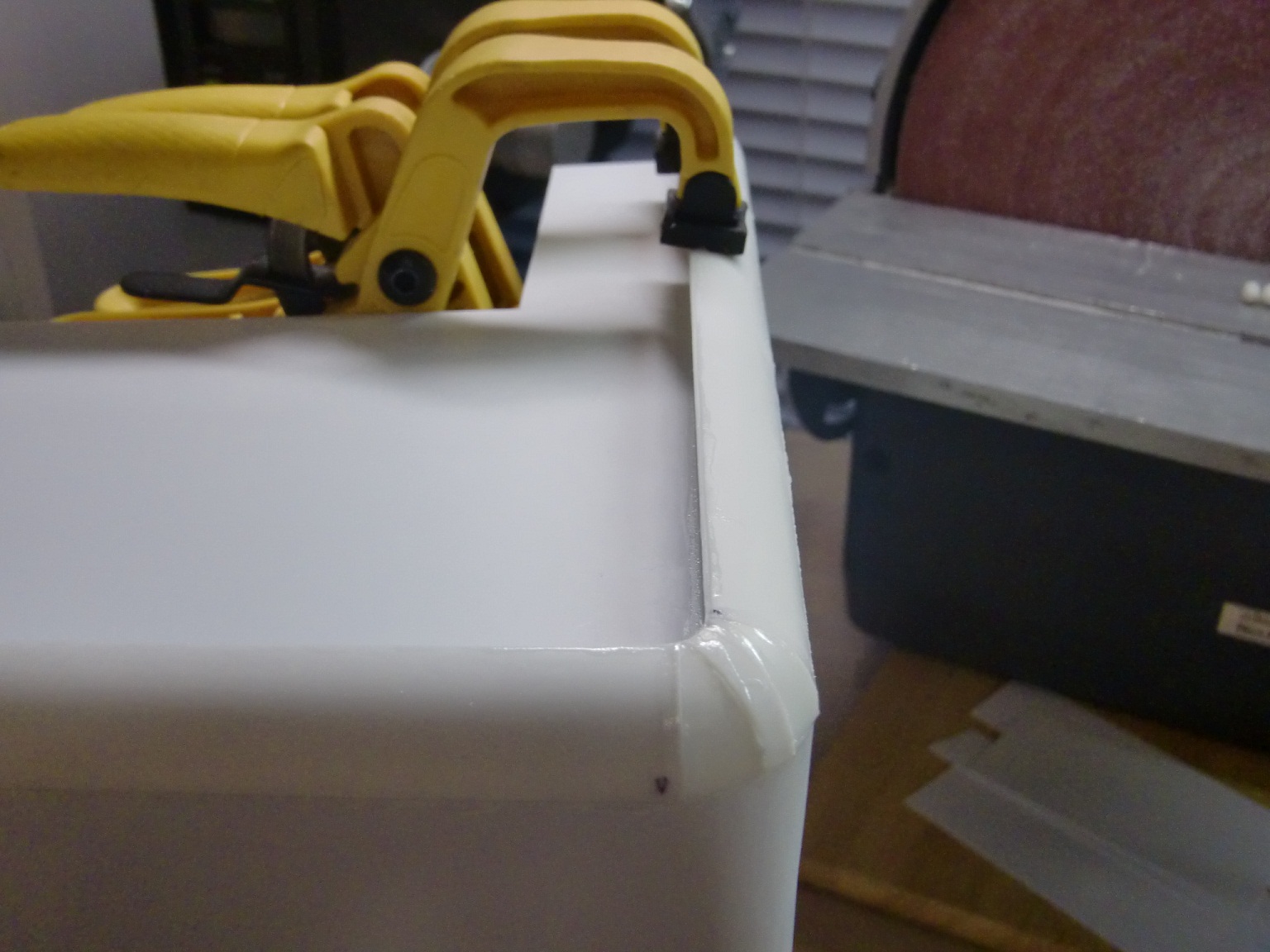

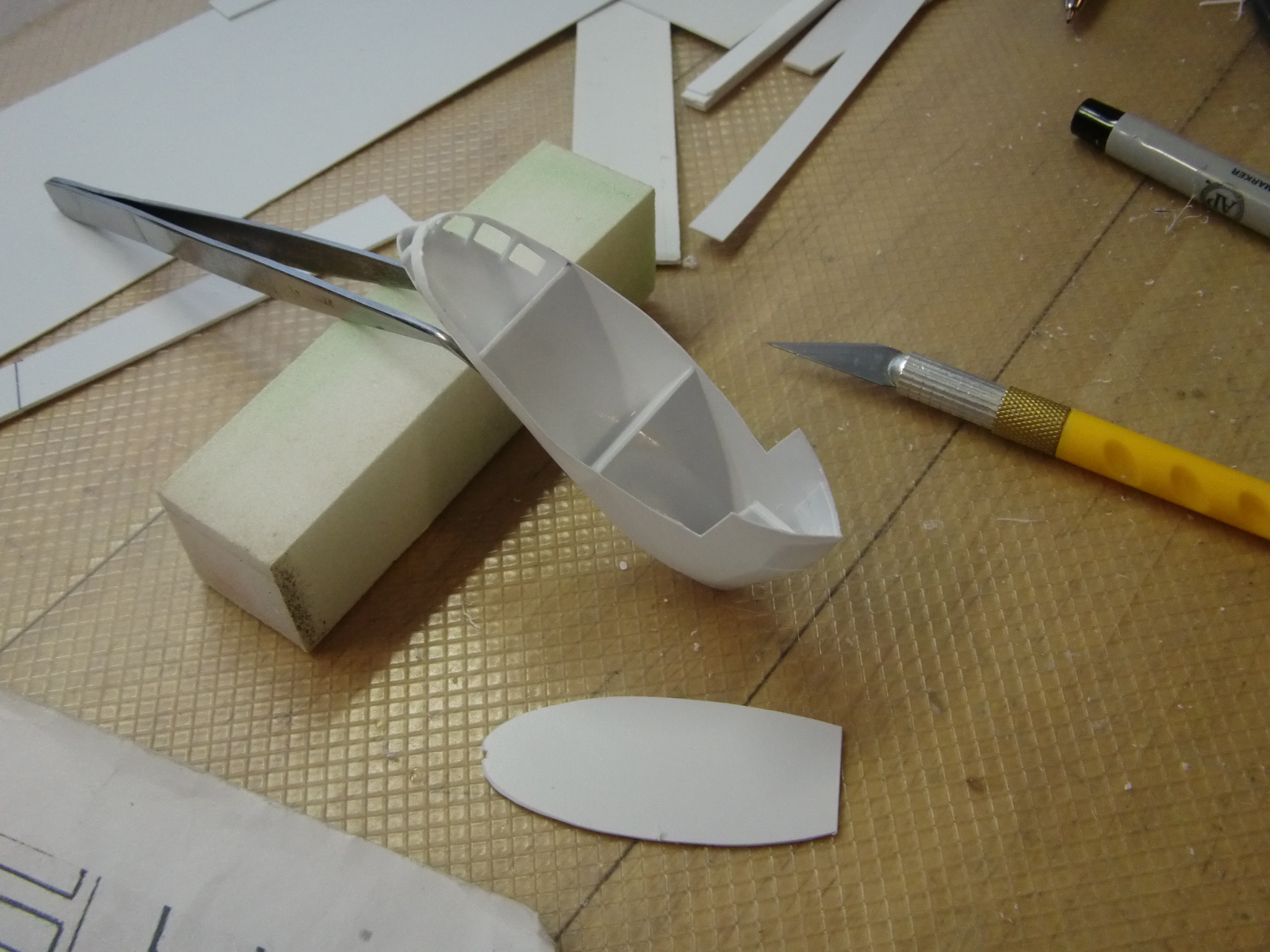

Photo 3337 shows where an "lip" should be where the container crane would normally "park" inside (all supposed) of course). I'll be making a lip since this box will be covering the raising/lowering works of the motor pod.
3339 through 3342 shows the lip and the intircate corners I had to make. the corners were originally left open, fit with carefully cut corner bits, and then covered with TONS of superglue. File it down and then sand it and you get a noice smooth and round corner ready for some paint!

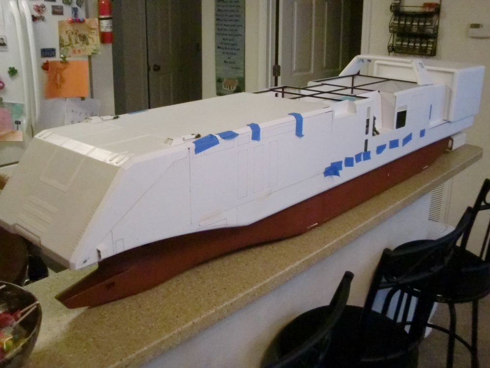

BIG UPDATE 5 June 2011

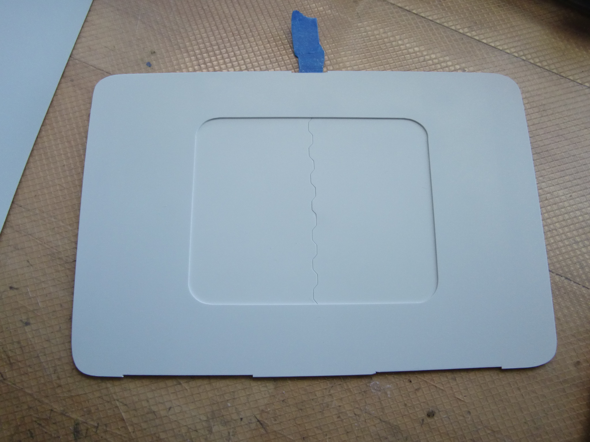

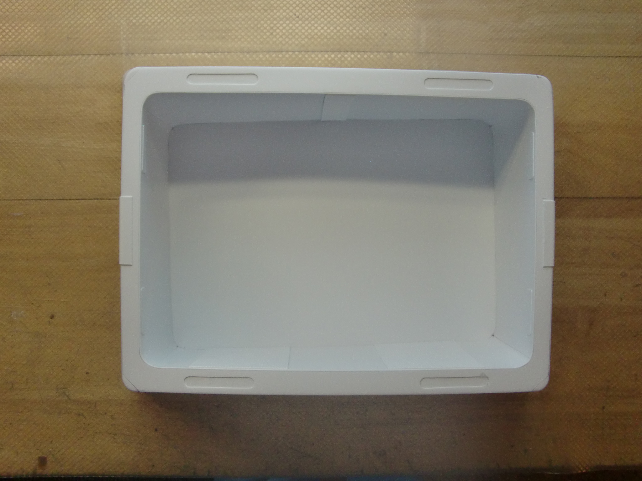

Hey everybody, dig out your Sir Mix-A-Lot CDs and sing along with me..."I like big butts..." :lol: You guessed it, I've been working on the stern of the Daedalus. When anything measures across in several scale meters, you gotta call it big!

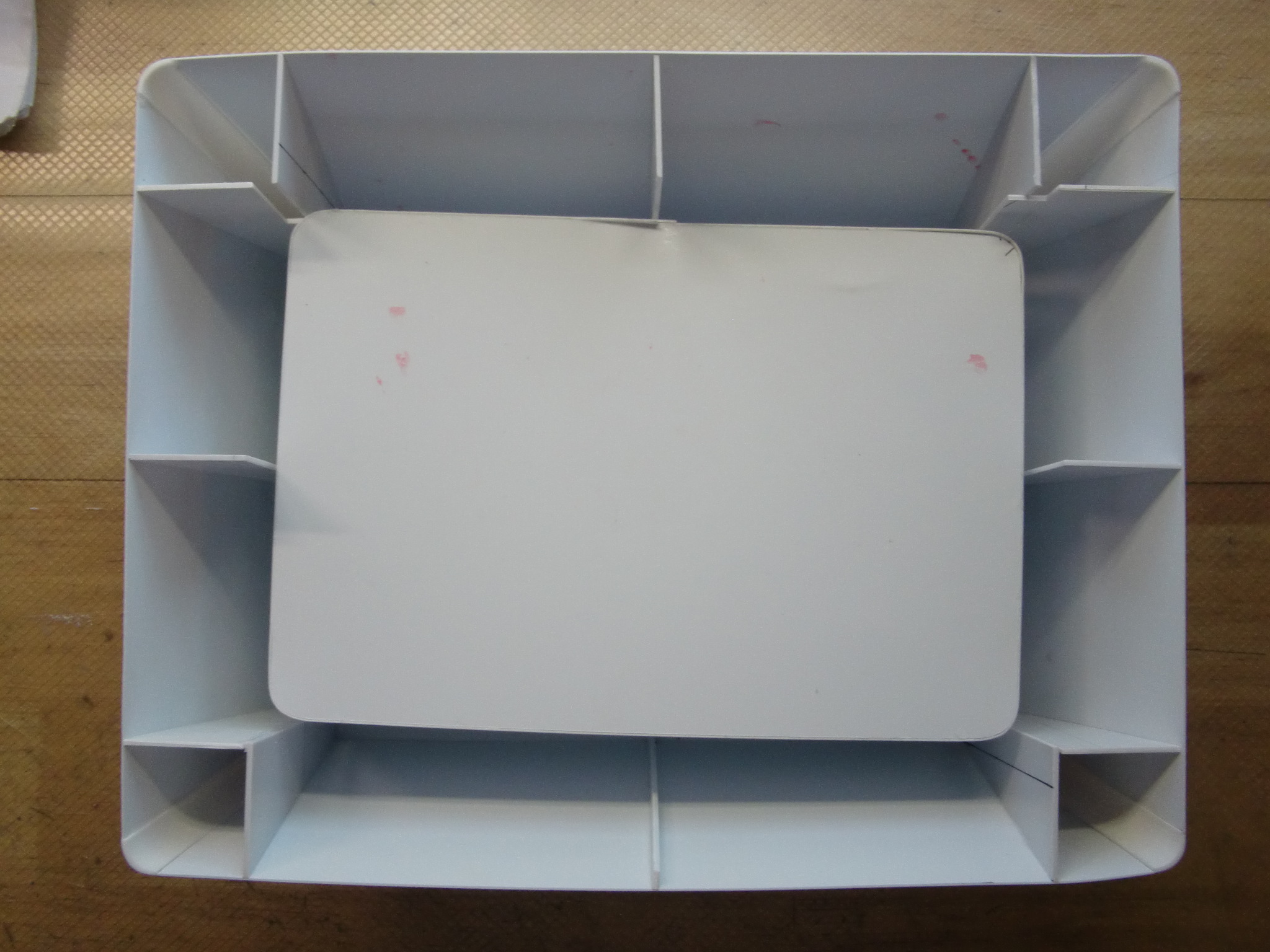

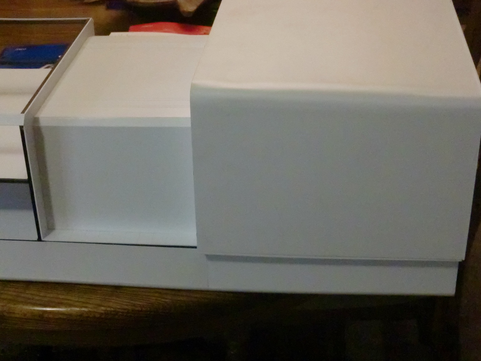

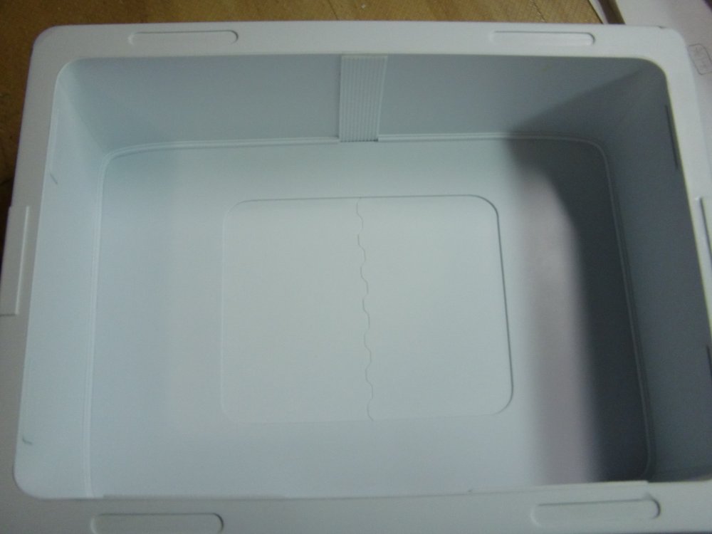

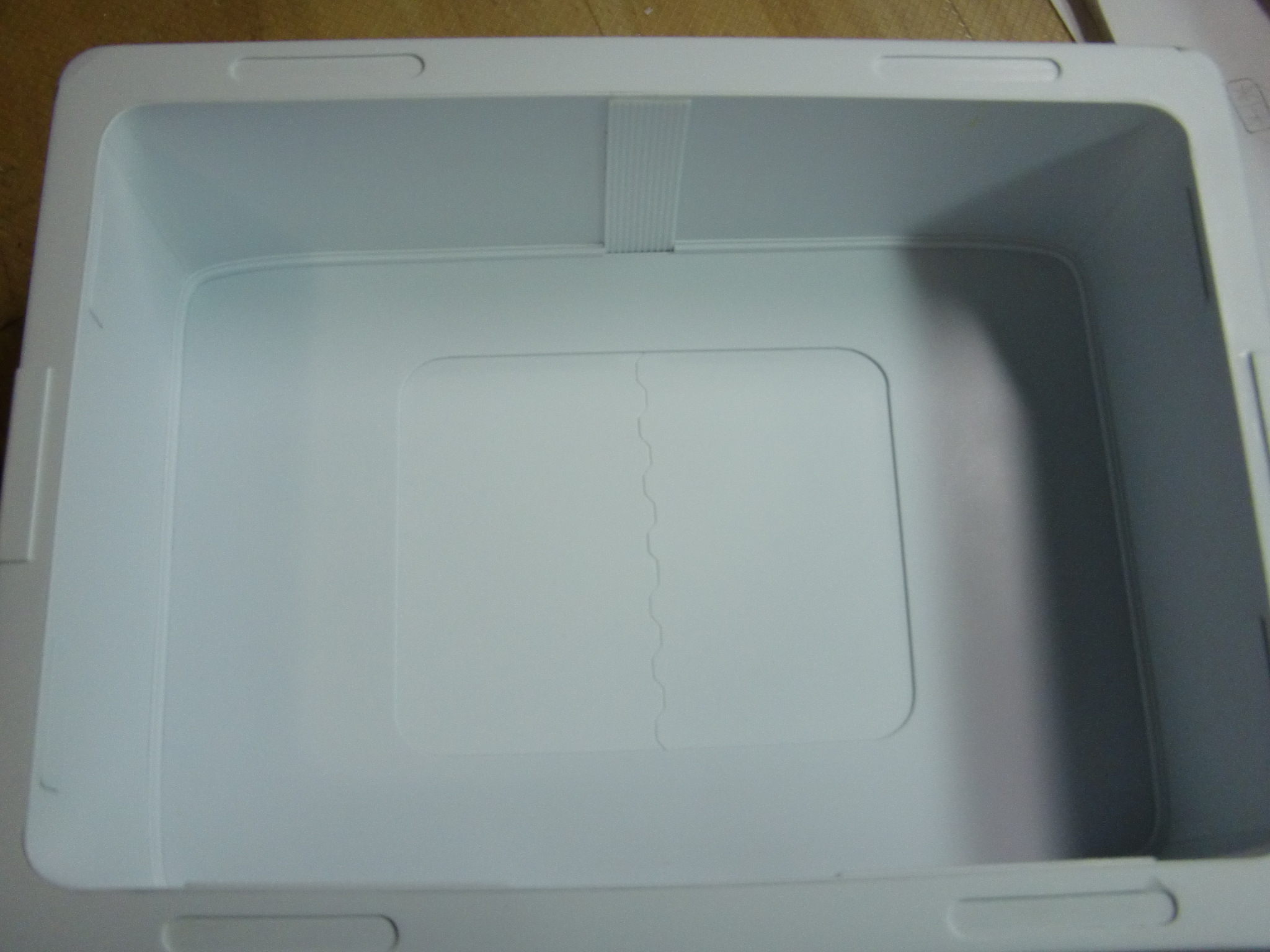

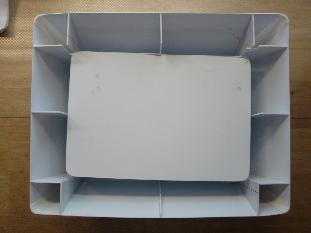

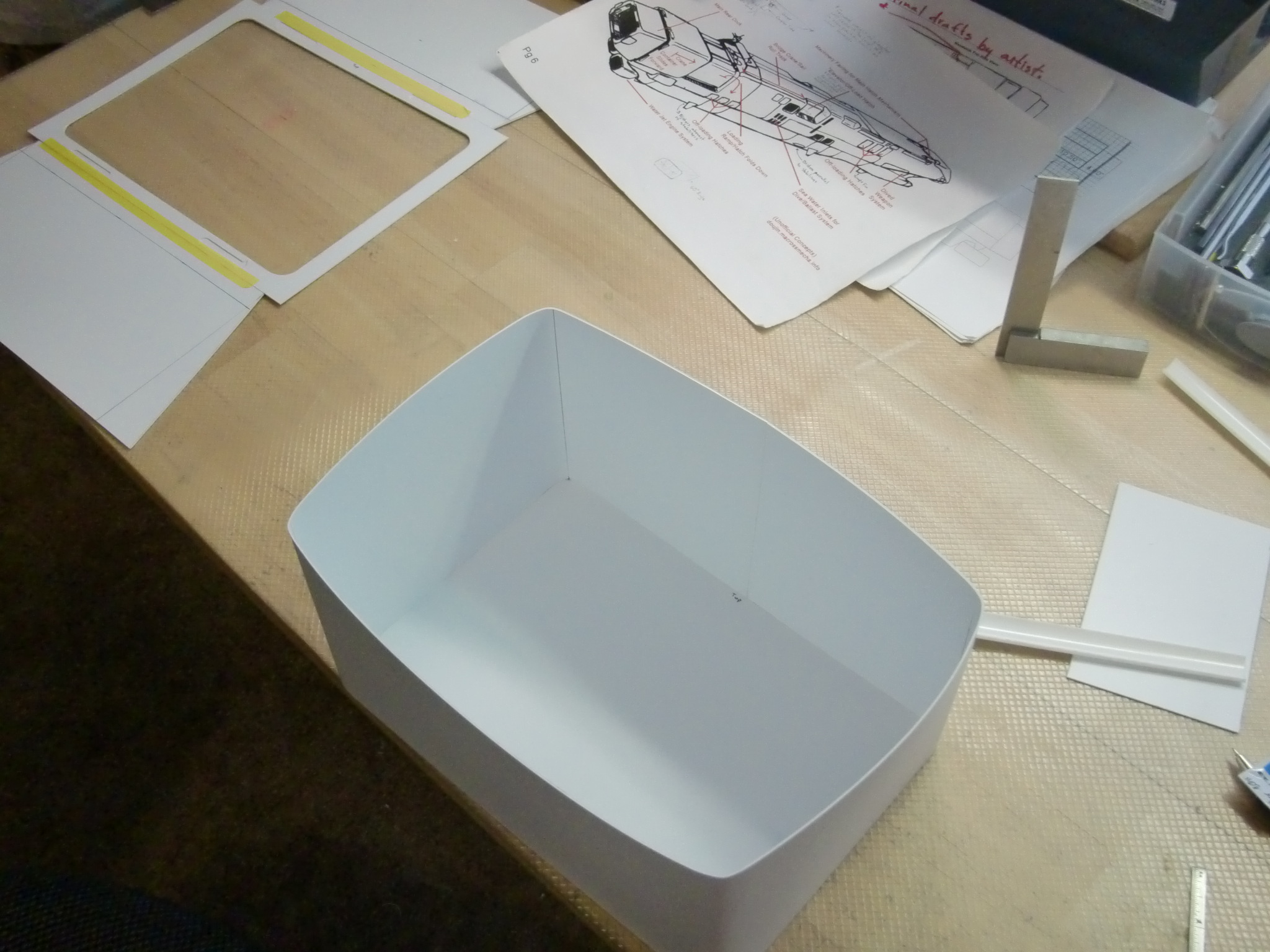

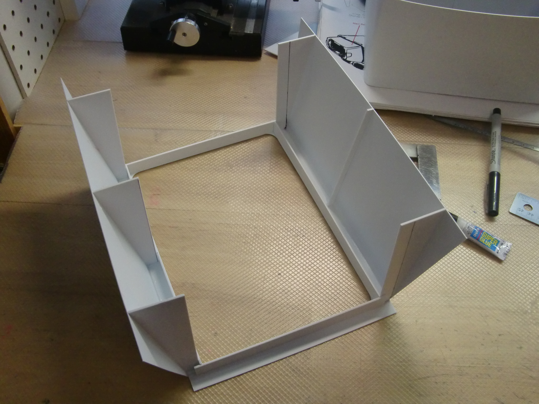

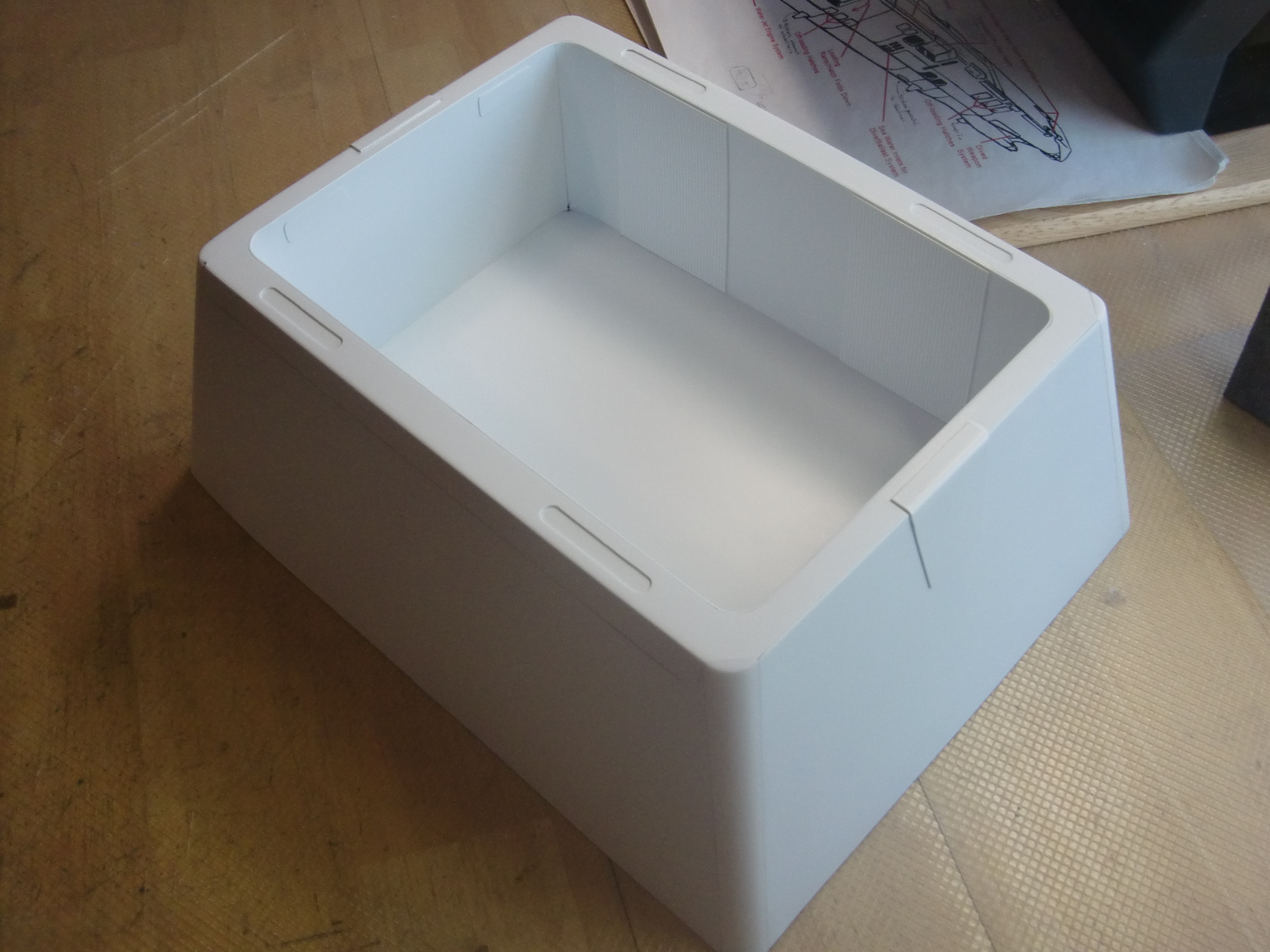

First off, construction of "the dog food bowl." That's what my young daughter called it. You know, it DOES look like one too. I coulda bought one and saved the time making this one ;)
"Stern 1-7" photos show the basic construction of the final stern piece before detailing it inside. Note just how crooked the box got glued into the "dog food bowl." When I stretched it out into the rounded corners that's when I got problems. Of course while gluing it in I was at a perspective that did not allow me to see the crookednes!!!! Oh well, I want this done and I wasn't about to redo it again - unlike other assemblies you've seen.

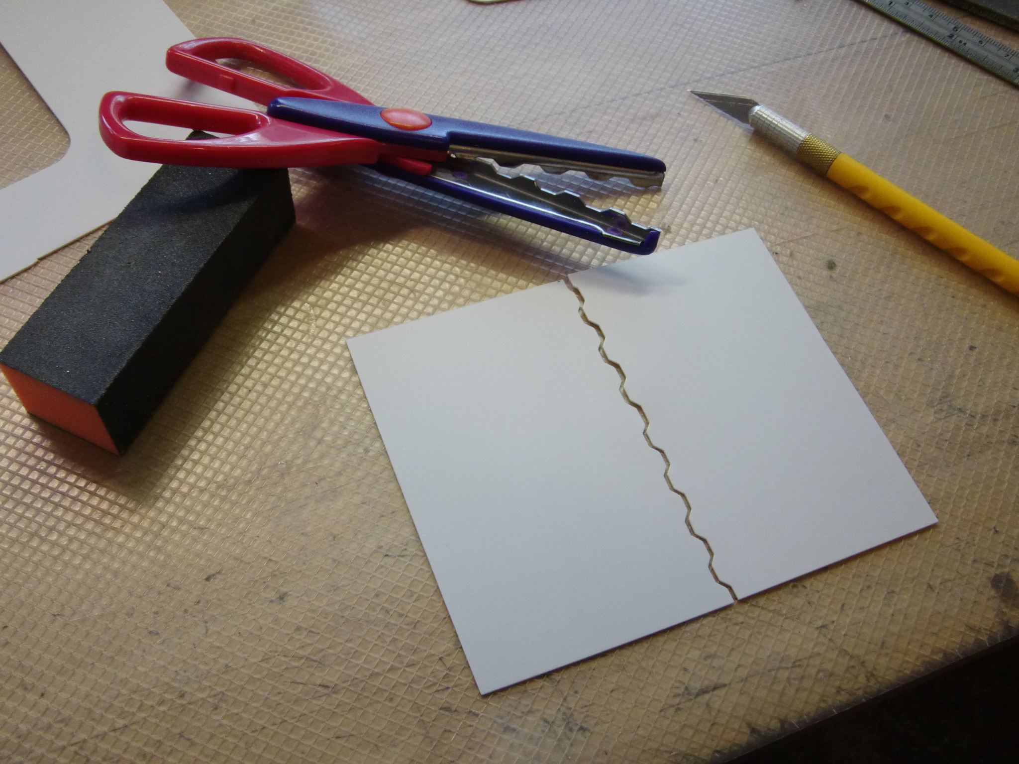

"Stern 8" Shows the "facy" snips I used to make the serated doors. I saw these scissors years ago and knew I'd use them on the Daedalus some time. My son asked what they were, I said nothing ans just cut some paper with them. He said, "space ship doors!" I'm proud of him :D Putting this second layer on the inside actually de-emphasizes the crookedness.

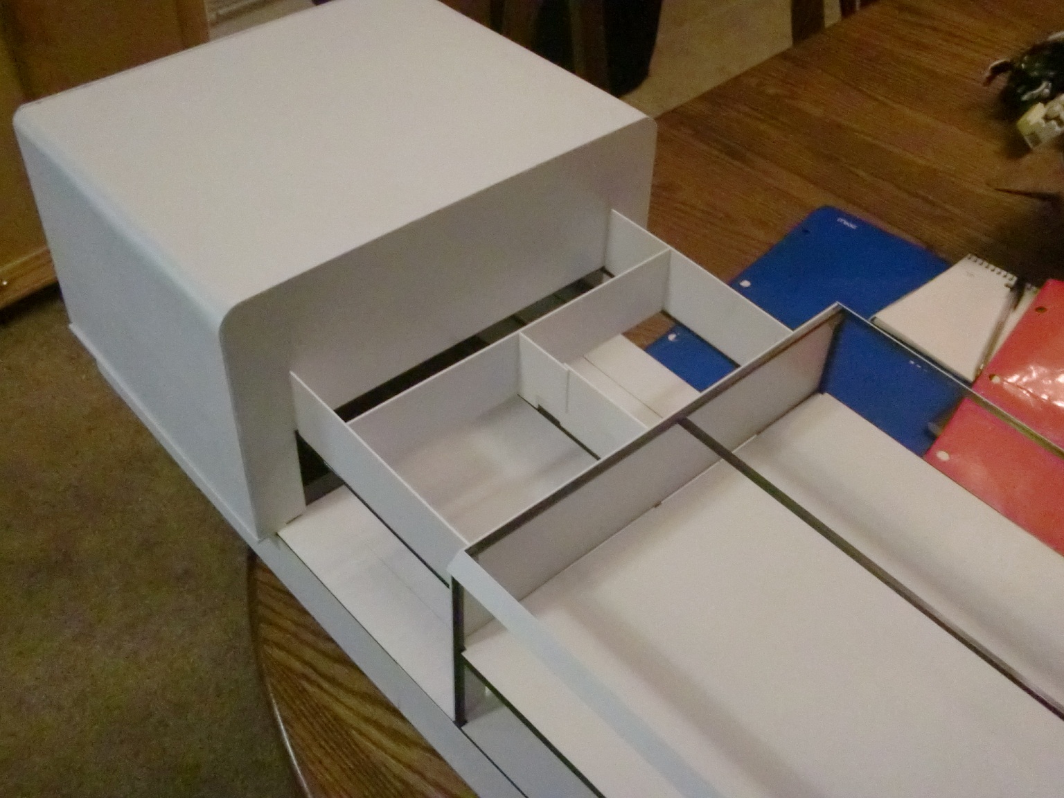

"Stern 10-11" shows the completed "bowl" with details and then it glued to the rear. There i still A LOT of cleanup to go on the rear. when I was gluing this on I needed a compact weight so I used the best thing I could find that I have, a WWI shell fuse (INERT). I've still got to add some detail and sand/file ome corners.

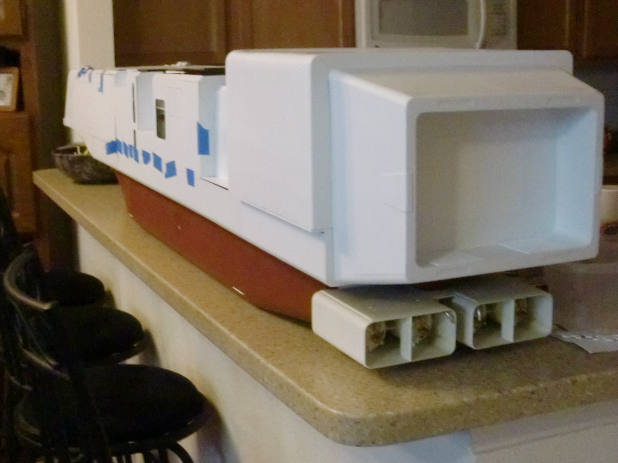

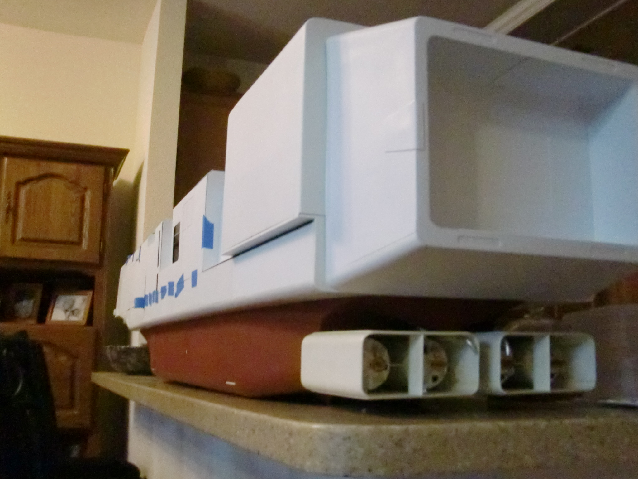

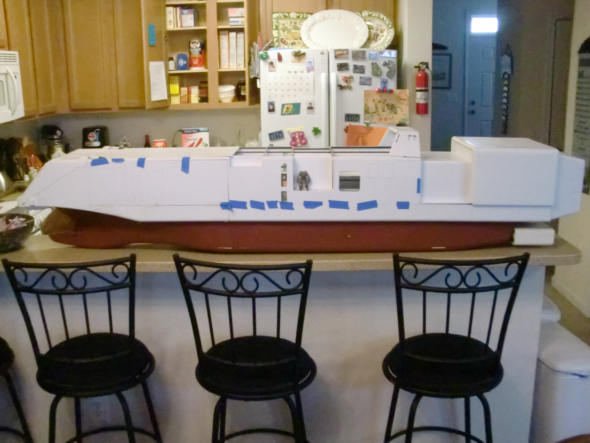

The rest of the photos I believe are self explanitory. See if you can find the Spartan destroid in the photos for size comparrison (where's Waldo :p ).
"Stern 9-10" show the doors inserted into the stern assembly. This is what I'm guessing the Daedalus would look like connected to the SDF-1. All the drawings just show blackness so I used some artistic license.

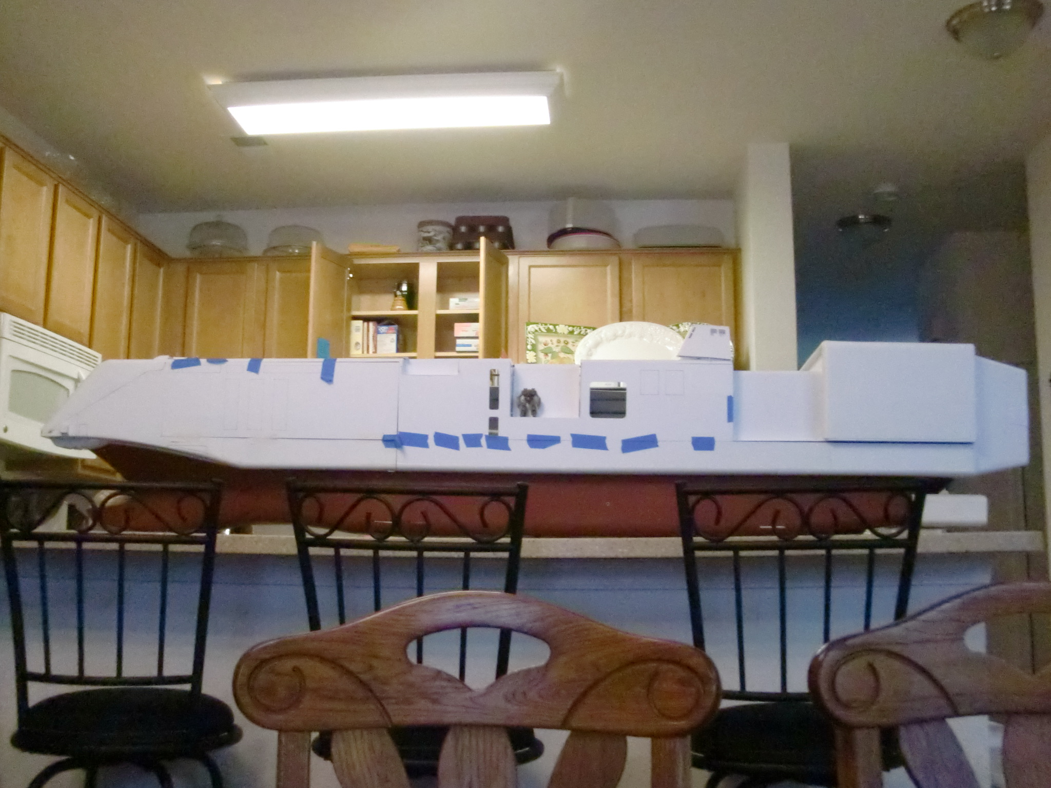

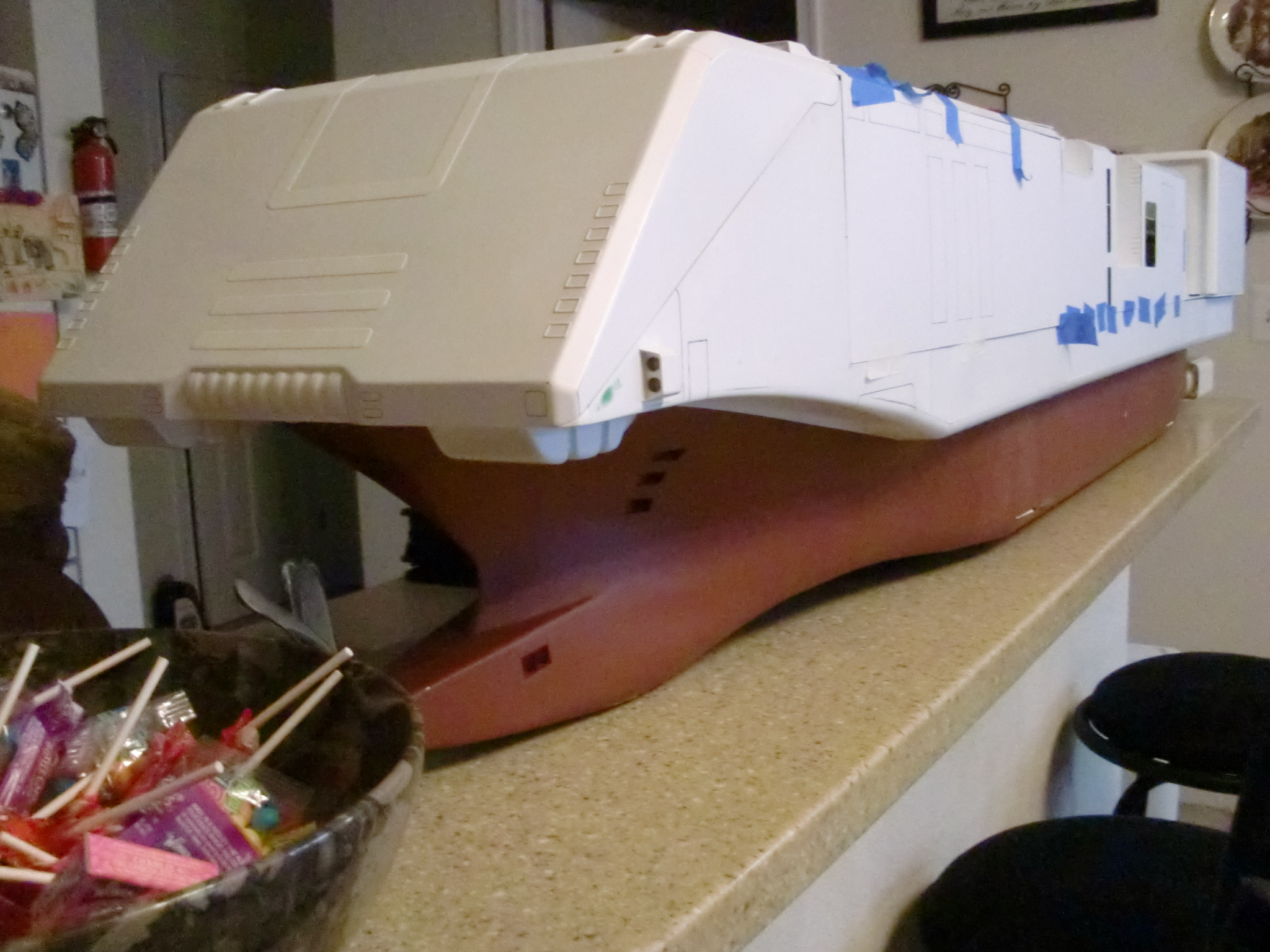

The rest of the "money shots" help make it worth the while spending all this time building this monster. You can see that I'm about 90% done now. I'm defenitely in a "glass is half full" kind of attitude. It should be done soon - construction wise. Then I gotta figure out how/what to paint it.
That's it for today. I had to get this thing off the breakfast bar again or my wife will get ticked. I don't see why, it only takes up 80% of it, no big deal, and it looks cool, she just doesn't agree :lol: Thanks for checking in everyone! - MT

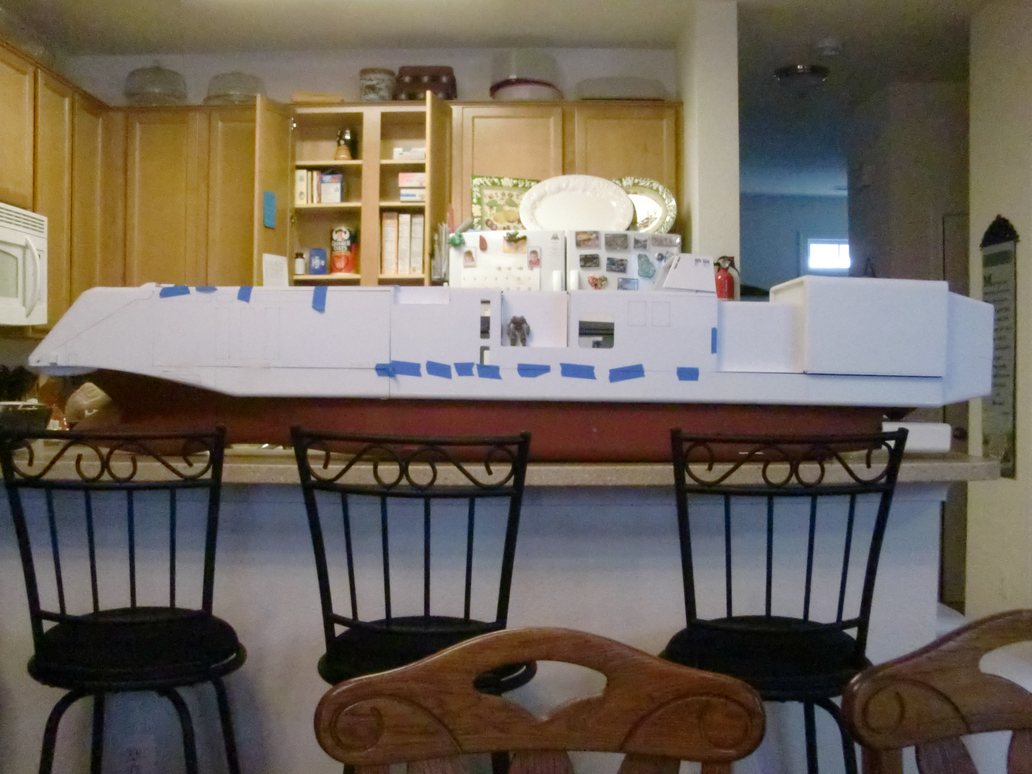

Thank you everyone for the compliments and comments. I freaked out one day. I came home and noticed the Daedalus was no longer on the counter! I didn't move it! What happened!? I asked my wife and she said she and my daughter moved it together! I thought - NNNOOOOOoooooooo!!! I went and checked on it and thankfully nothing was broke :unsure: So I try to keep my family from messing with it. ;) Yes, I'm getting there. Main parts to complete:
1.) Bridge.
2.) Side panels & detail.
3.) Stern details and brace thingy (check out the line art).
4.) Re-assemble interior pieces.
5.) Slap some paint on it!!!
Thanks everyone for checking in. I hope to have more work done this week! - MT

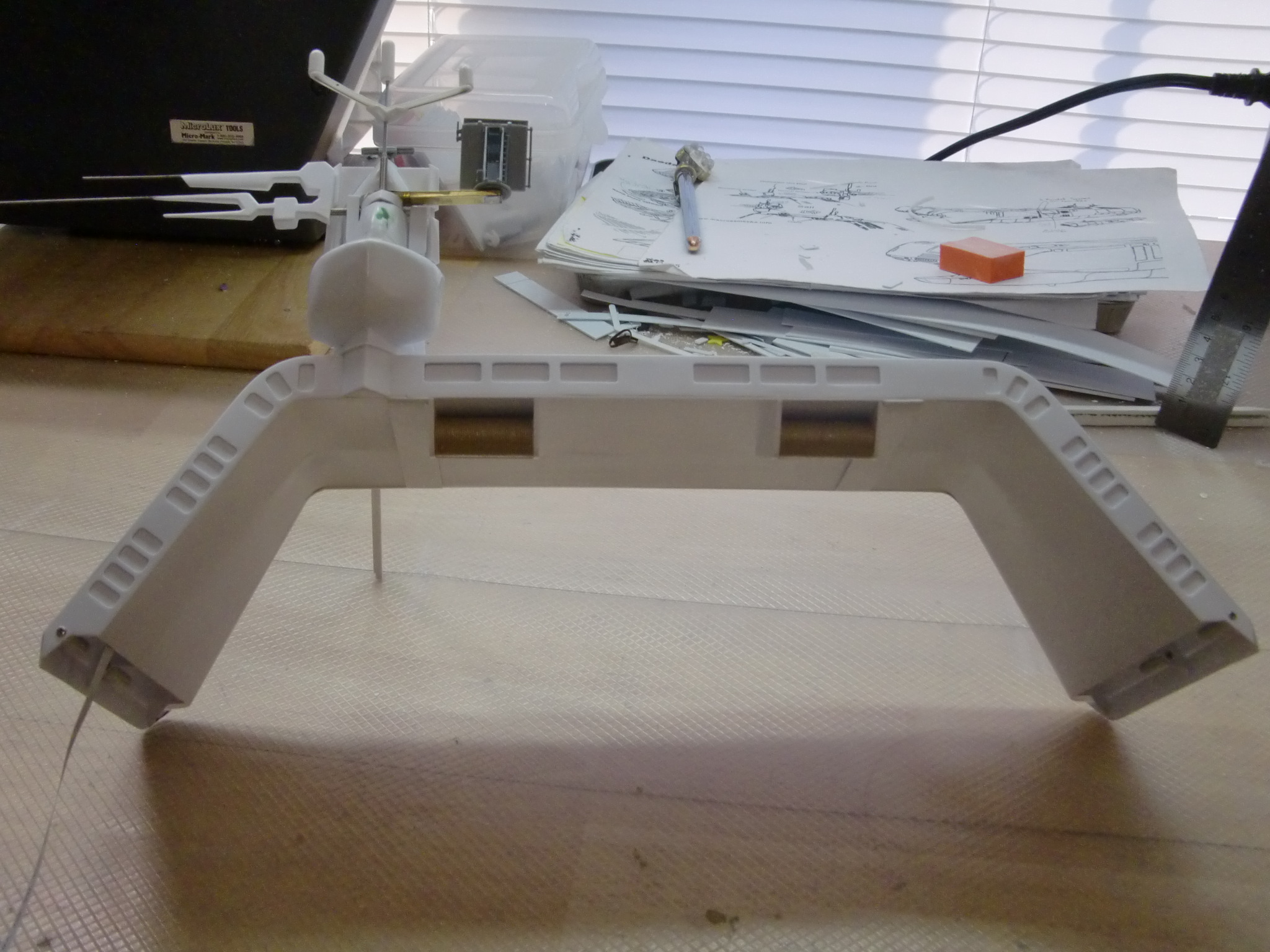

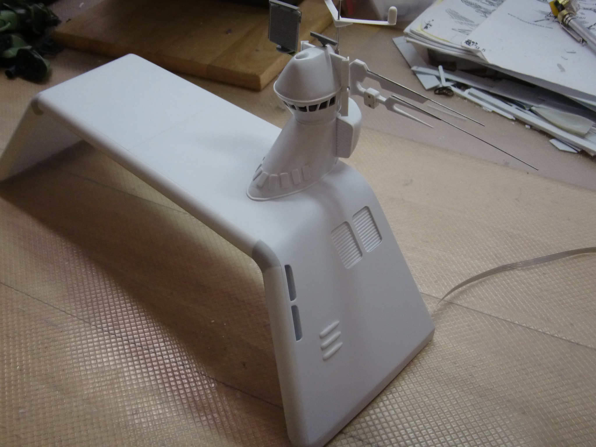

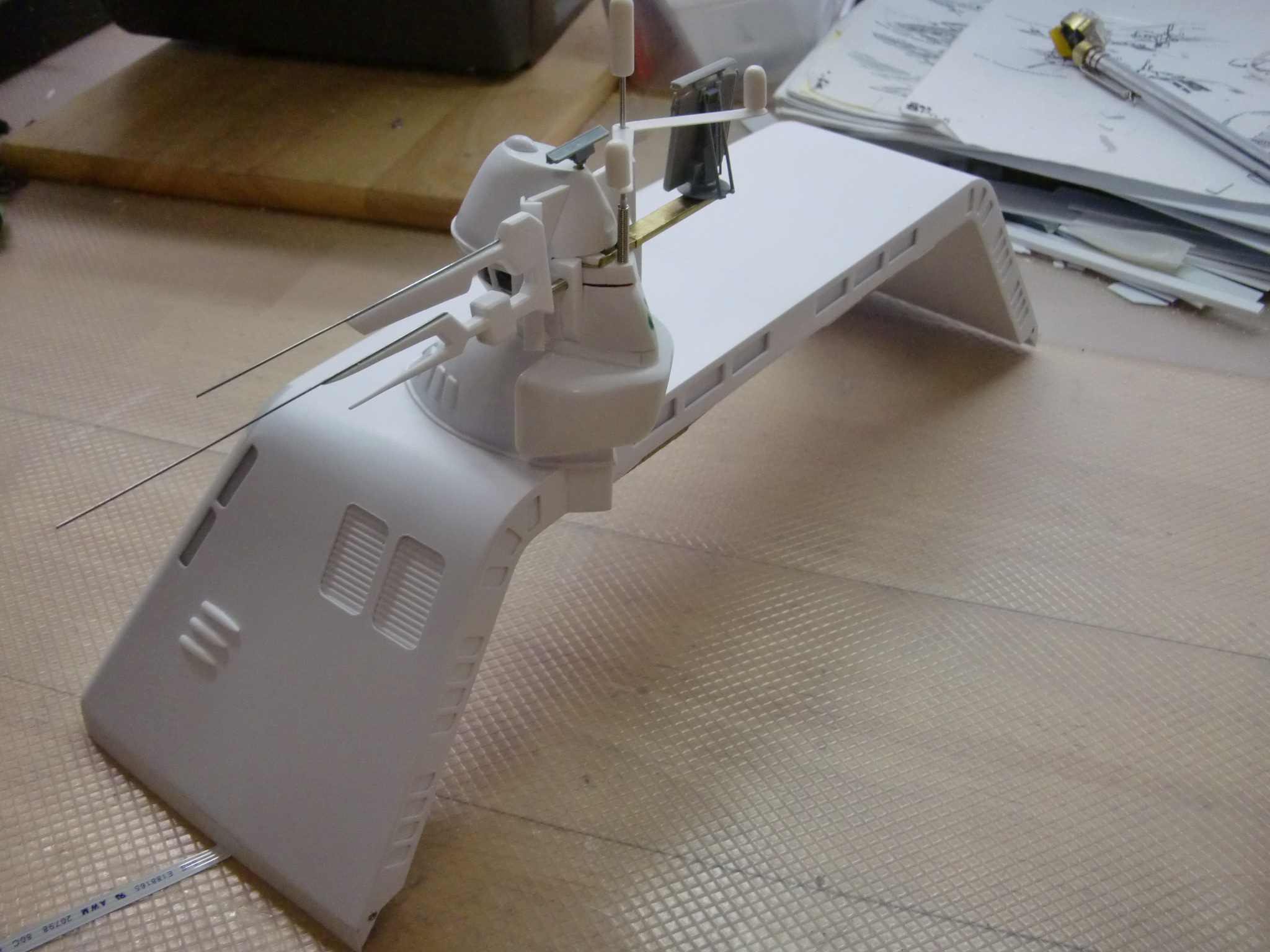

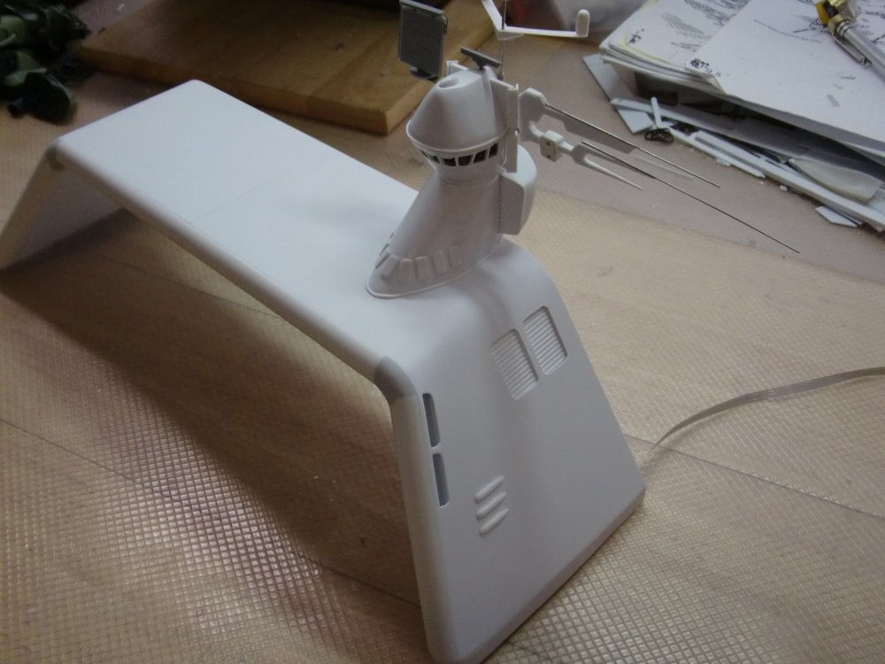

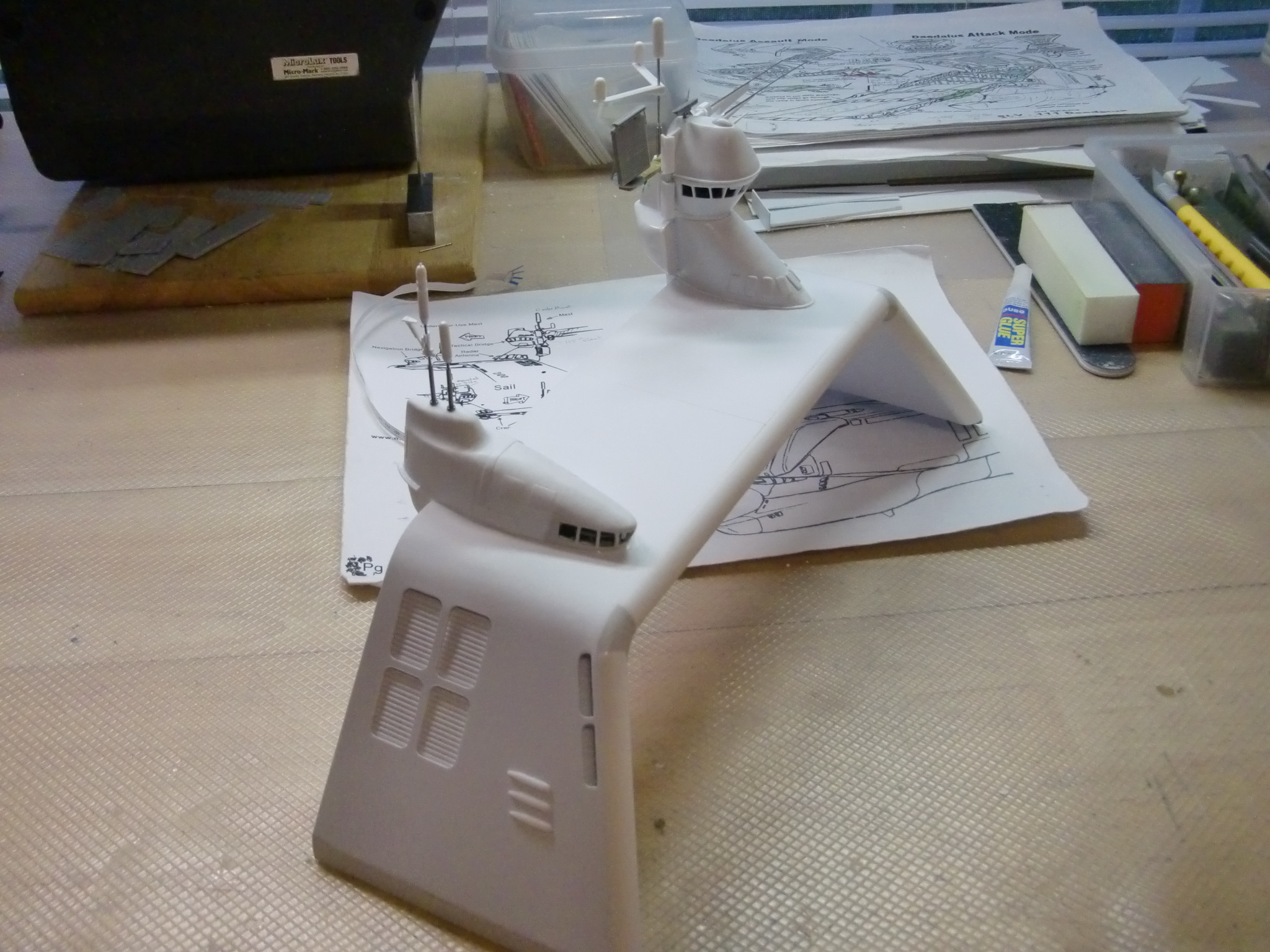

After two years (baby steps) the sail and bridges are done for the Daedalus. At one point my wife caught my son and I working on our projects at the workbench. He has a ship I'm helping him build (when he's not playing with his Transformers) and of course you can tell what I was working on by my post. She thought it was "SOOOoooo cute" she took photos.
You can see the completed photos of the Navigation Bridge. If you ask me, it looks like a shark's mouth with teeth. This is the last item completed. The Tactical Bridge is the taller tower. I managed to get it mounted up this week too. If you look back in this thread, you can see the photos for the building of the interior gears and drive belt that run the radars (air search and surface search). The SDF-1 had both types of radars and old fashioned antenna so I did the same here. Plus it adds action to the whole thing.

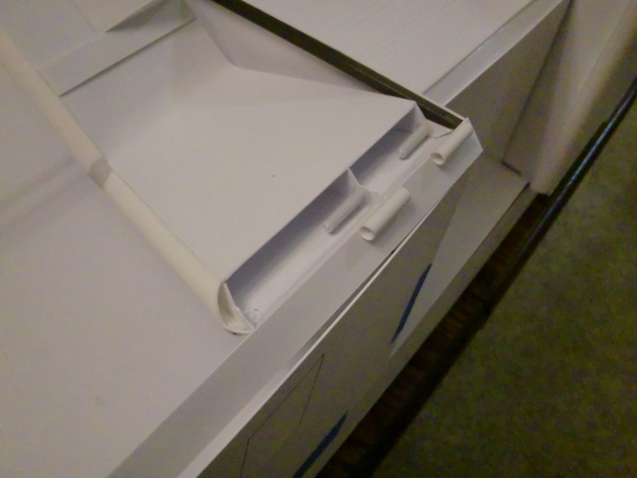

I also completed the reels on the bottom that are supposed to be for a crane !?!? Don't ask, that's all it says in the drawing text - no "how" it works or for what it goes too.
I also completed the bridge seating and painted it too. Here the paint is still wet.

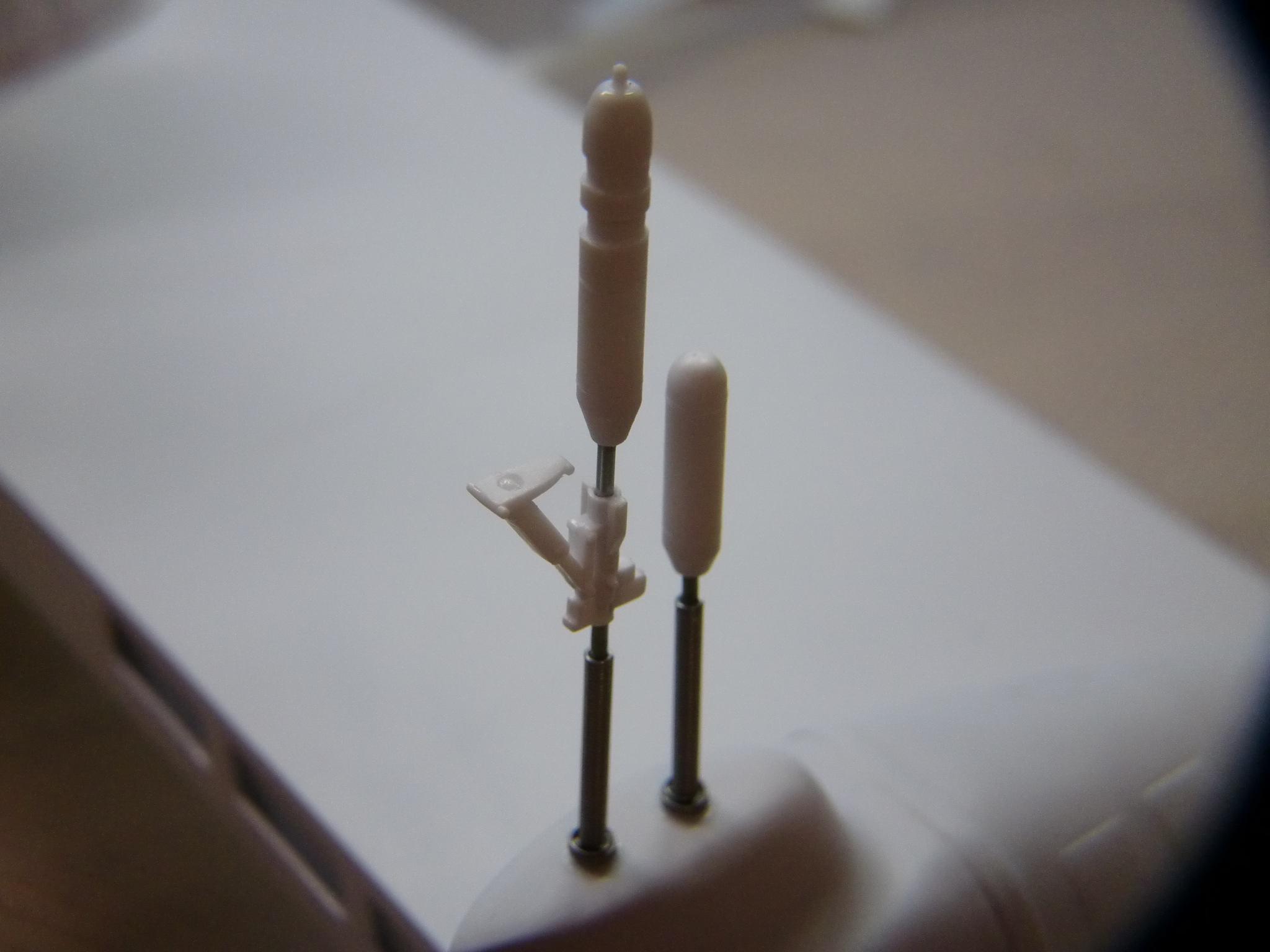

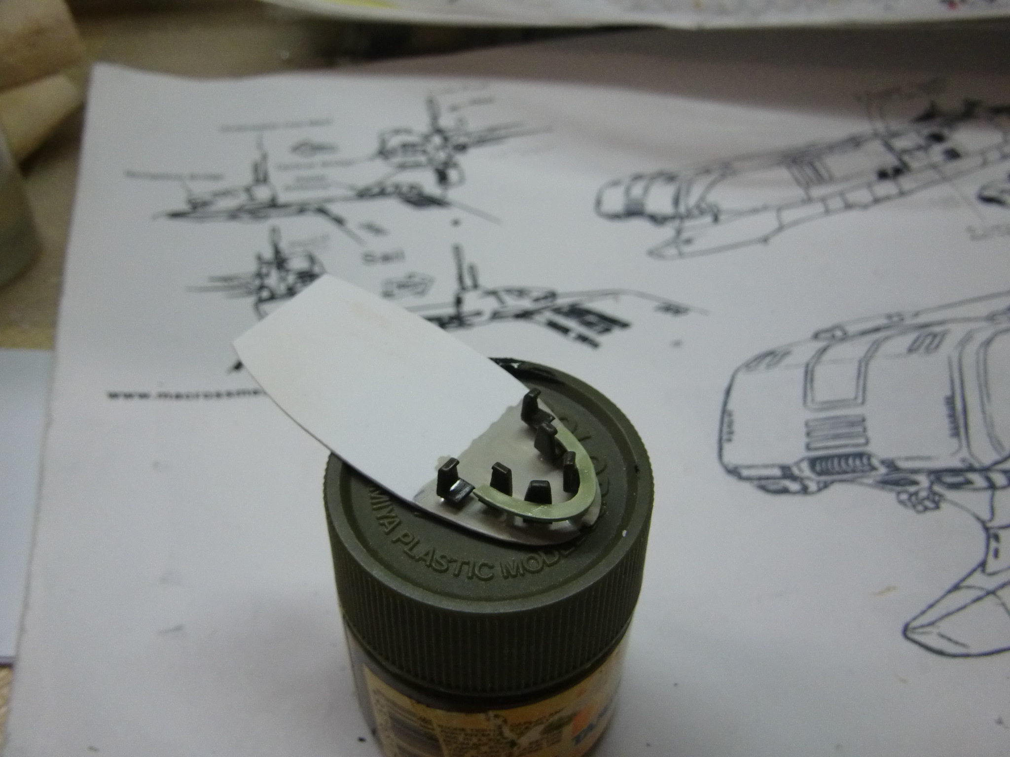

Then the Navigational Bridge masts were turned on my drill press. The shafts are conncted with springs to the tower. If the masts are struck or bumped into, they simply spring back - no heartache over broken plastic and hours of work (save all your printer parts when you take one apart ;) ). The same was done to the Tactical Bridge already.
You can see the sail latches made from simple tube and spare sprue pieces. The sail is now ready to be put into service. And oh yes, the radar movie... I couldn't post it due to lack of rights :( Sorry!
And a couple of other shots of the port tower as it was attached first.
That's it for now. I'm glad this thing is getting finally getting done - the end is in sight!!! :lol: Take care guys and enjoy the shots! - MT
