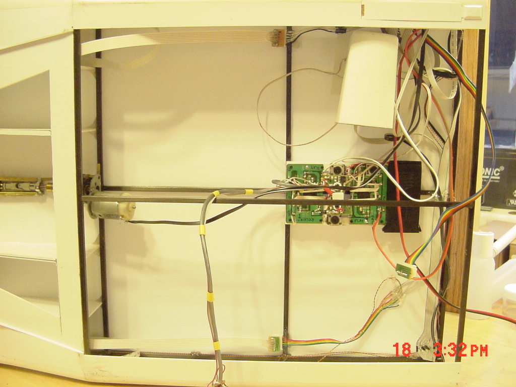

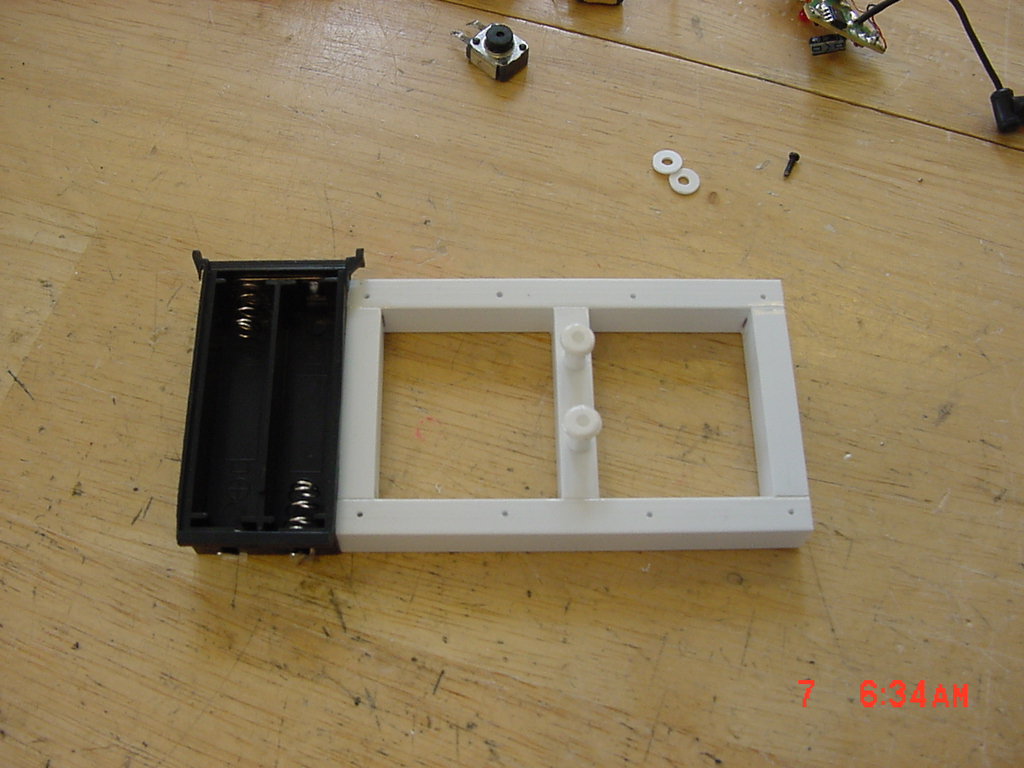

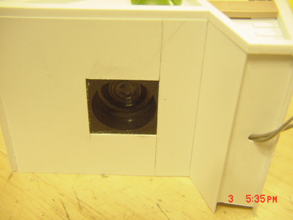

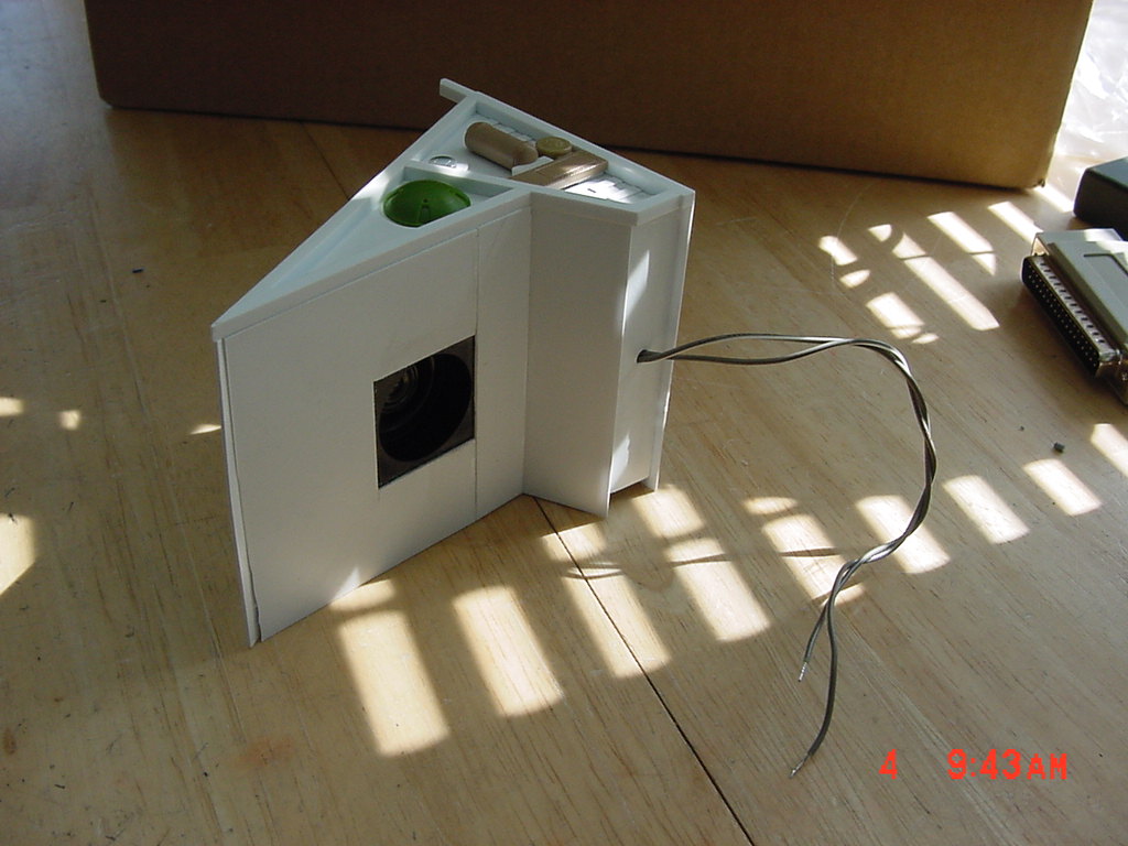

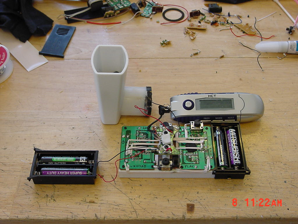

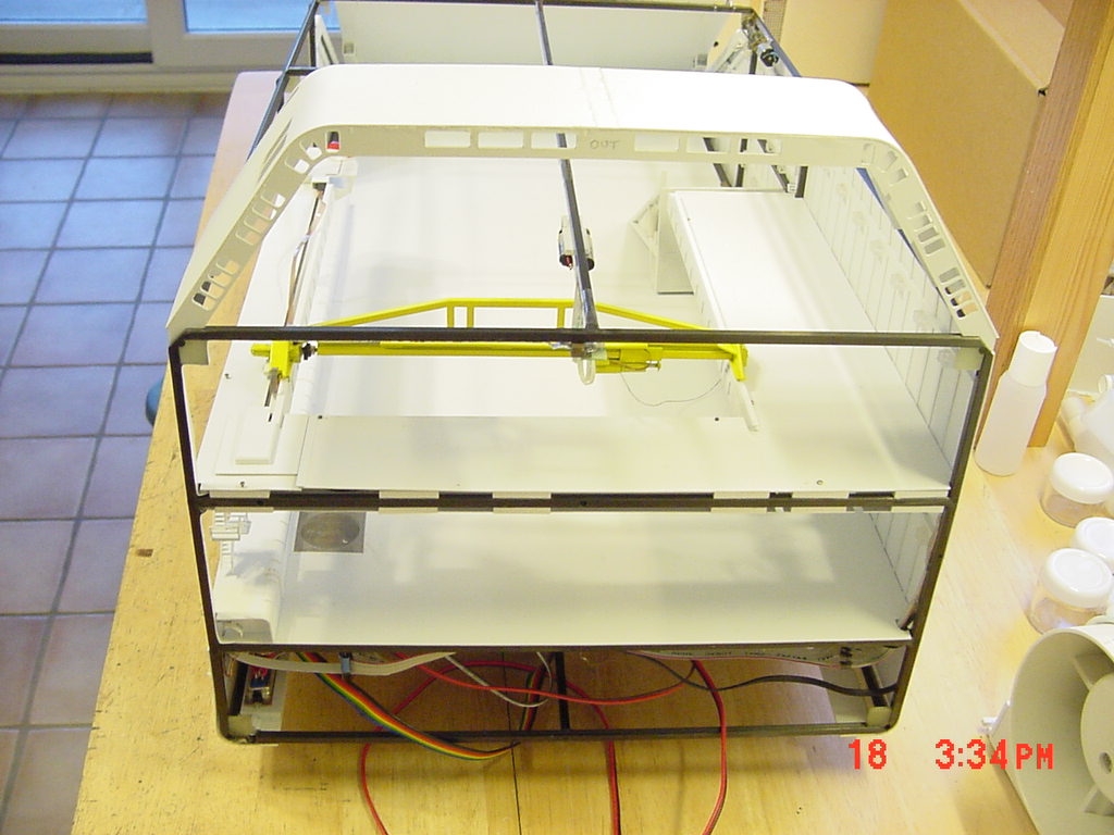

MechTech Posted April 13, 2009 Author Posted April 13, 2009 Sorry for the LONG delay in updates. I did get a B+ in my class which is good for someone who SUCKS at mathematics! The ship will float with the hanger deck on it. In fact, with all that stuff just on the bow, the front bow half floats by itself. Thank you ALL for the many compliments! It helps keep me going when I'd LOVE to be building something else at that time. UPDATE 13 APRIL 09 I'm back to my days where I was designing and installing high end car stereo systems (except this time much smaller and in a "ship." First I built this hidden speaker: Then I really hated the sound quality (it was the driver) so I ripped it out and now the ramp is hollow again! Then I built this frame to mount three boards on: The two end boards are the sound cards containing the recording. The output of them sounded HORRIBLE. When I took the output, put a load on it and ran it through an amplifier (the tiny, funky shaped board in the middle) it sounds 100% better. Each board only has 30 seconds of time so one will be like alarms and announcements while the other will be "Daedalus Attack" related stuff. Then I can plug an MP3 player into it and play like an hour or two of background stuff (or even music)! The new speaker unit is made from a MUCH better speaker, styrene tube, and a segment of styrene towel rack holder! It sounds great. Nothing sits above deck in the newer installation: That little square in the top right hand corner is the speaker under fine stainless steal mesh. It will be covered a little better later on. The smaller flashing light by the door failed so I replaced it and added detail: After COMPLETING the controller and looking over the sound cards, I realized I would have to manually actuate the sounds. So how to add buttons to the controller and not make it look overcrowded? This was my solution: The smaller button in the middle controls amp power and the two big buttons control sound effects. The buttons are black with same colored yellow plastic cut THICKNESS wise from the battery hatch cover. It's a little thinner now, but my buttons match the case! That's it for now. I still have to wire all of this up. I tried to put this all on the same power supply, but I was getting nasty results despite using filter devices on the power inputs. So one runs off the ship, and one runs off of batteries. That's it for today. - MT Quote

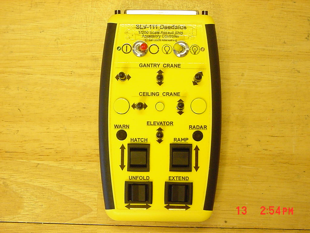

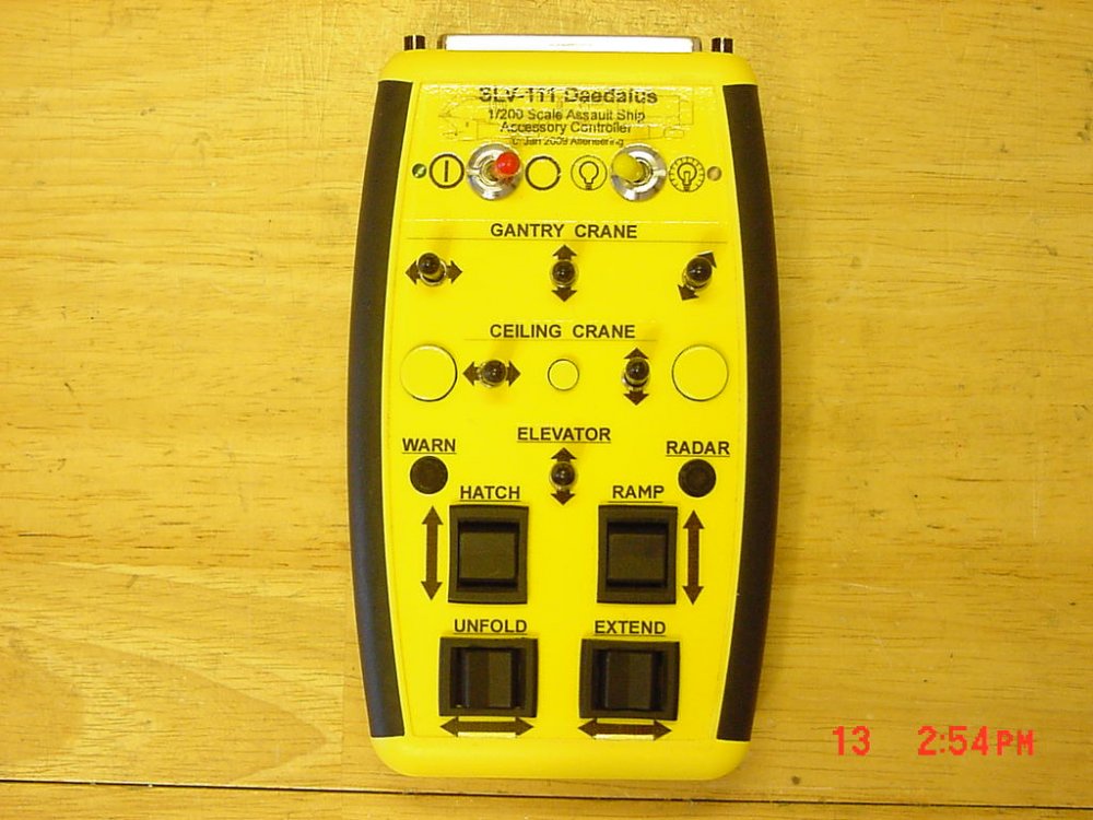

neptunesurvey Posted April 14, 2009 Posted April 14, 2009 So, is the crane/ramp controller a modular to attach to the main controller or is it a separte controller? Quote
MechTech Posted April 14, 2009 Author Posted April 14, 2009 Thanks guys! I'm hoping to wire it all up this week. The yellow controller is for all the the stuff on the top section basically. The Radio control is for the lower hull (piloting and throttles). Basically the "playing around stuff" doesn't need the radio turned on or all the massive 6 volt batteries charged up. This is a bonus at some shows where R/C units must be impounded for safety reasons. - MT Quote

neptunesurvey Posted April 15, 2009 Posted April 15, 2009 Thanks guys! I'm hoping to wire it all up this week. The yellow controller is for all the the stuff on the top section basically. The Radio control is for the lower hull (piloting and throttles). Basically the "playing around stuff" doesn't need the radio turned on or all the massive 6 volt batteries charged up. This is a bonus at some shows where R/C units must be impounded for safety reasons. - MT I was wondering about how much power all of the controllers would consumer. I'm guessing the R/C shows have an area where you place your boats on display. Like a carshow where you show off all of your cool bling. Quote

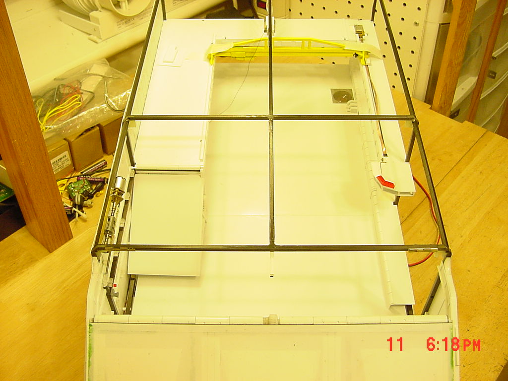

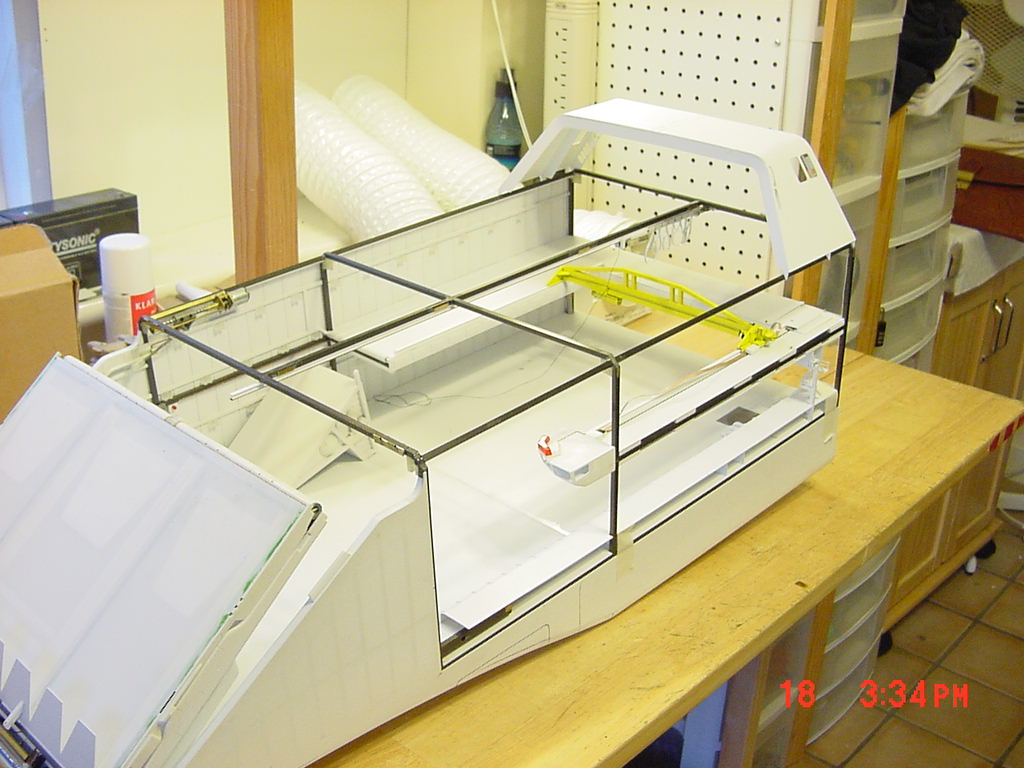

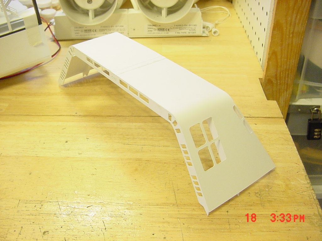

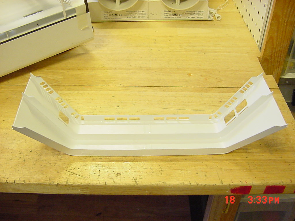

MechTech Posted April 18, 2009 Author Posted April 18, 2009 Thanks guys. I think my mini van would be a good candidate for a "Pimp My Ride!" UPDATE 18 April 09 I got all the of the sound gear mounted, hooked up and tested. My son got a kick out of testing it! I'm tired of soldering so today I started work on the sail (bridge). This was cut with a laser for accuracy earlier on if you remember. A REAL expensive SD Daeadalus It fits perfect (pheeew!) That's it for now. I'm contemplating working on some Mospeada bad guys (see What's lying on your workbench post). Take care! - MT Quote

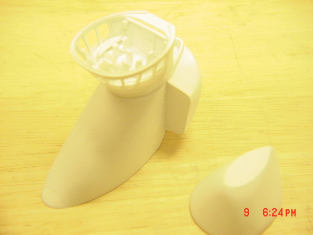

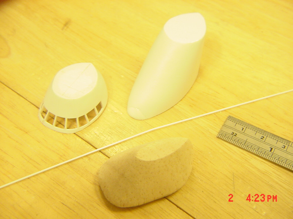

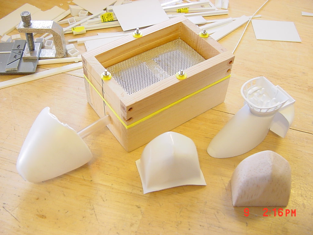

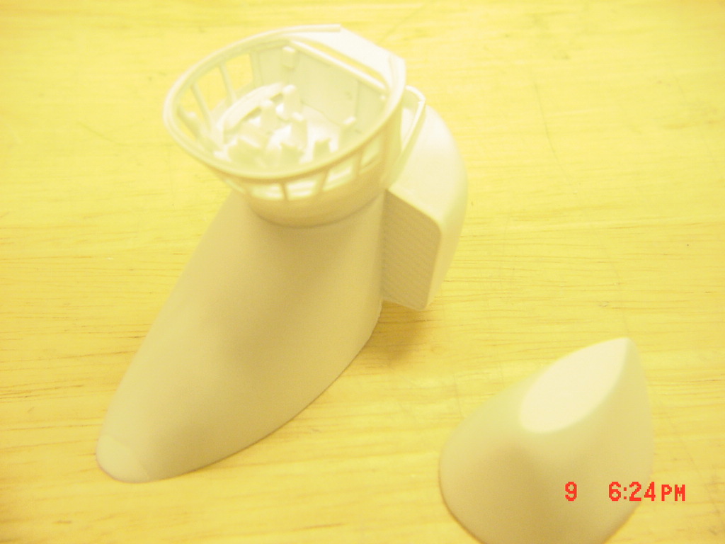

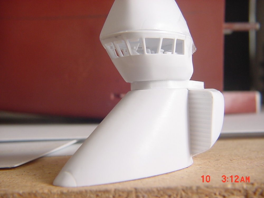

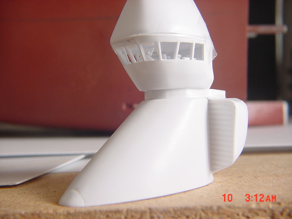

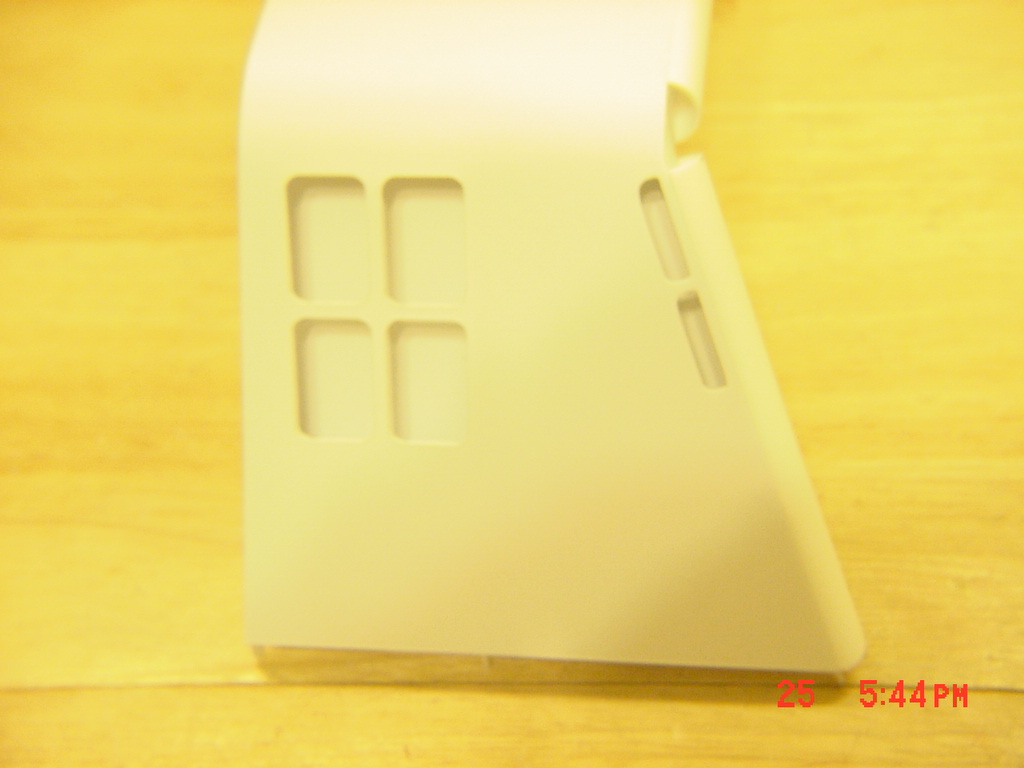

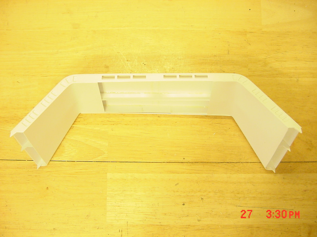

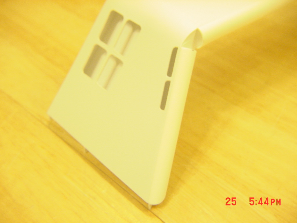

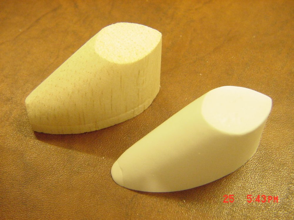

MechTech Posted April 27, 2009 Author Posted April 27, 2009 Thanks 505! I'm getting bored building it Pineapple salad - Welcome to MW and thank you! A 1/200 VF-1 standing up is 2.4 inches tall. A figure is about 8mm tall. UPDATE 27 APRIL 09 Most of my work has been on the sail and the funky towers going on top of it. The most complicated (and detailed one) I'm hitting first, the tactical bridge. I'm forming the towers by vacu-form to make them light! These sit at the very top and have to be light to keep the center of gravity down. The sail bottom is left off so I can put the deck with people and crane components in it. Not a lot of pictures, but LOT of sanding and a lot of measuring/shaping. That's it for now. - MT Quote

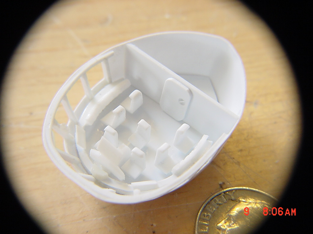

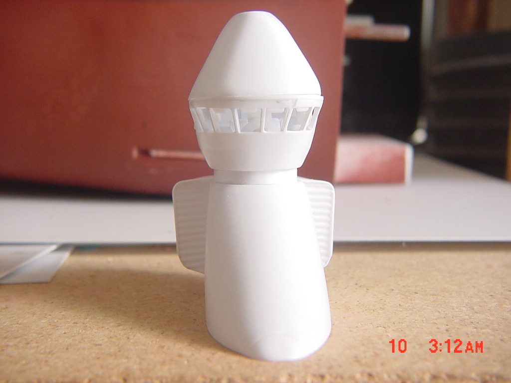

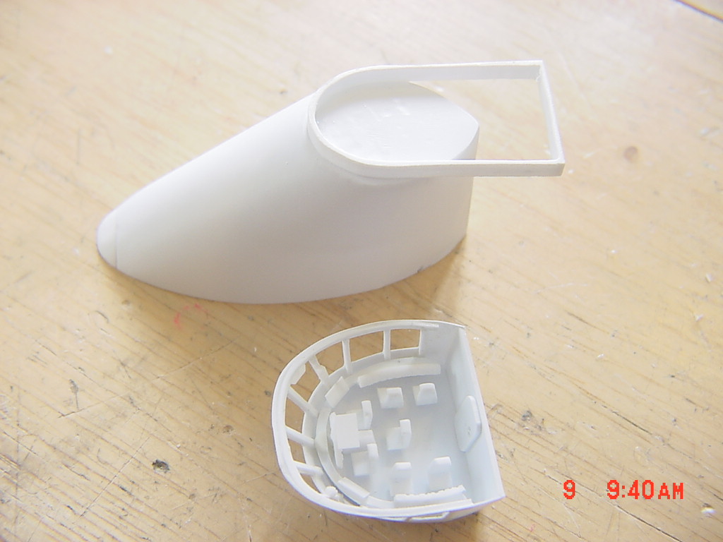

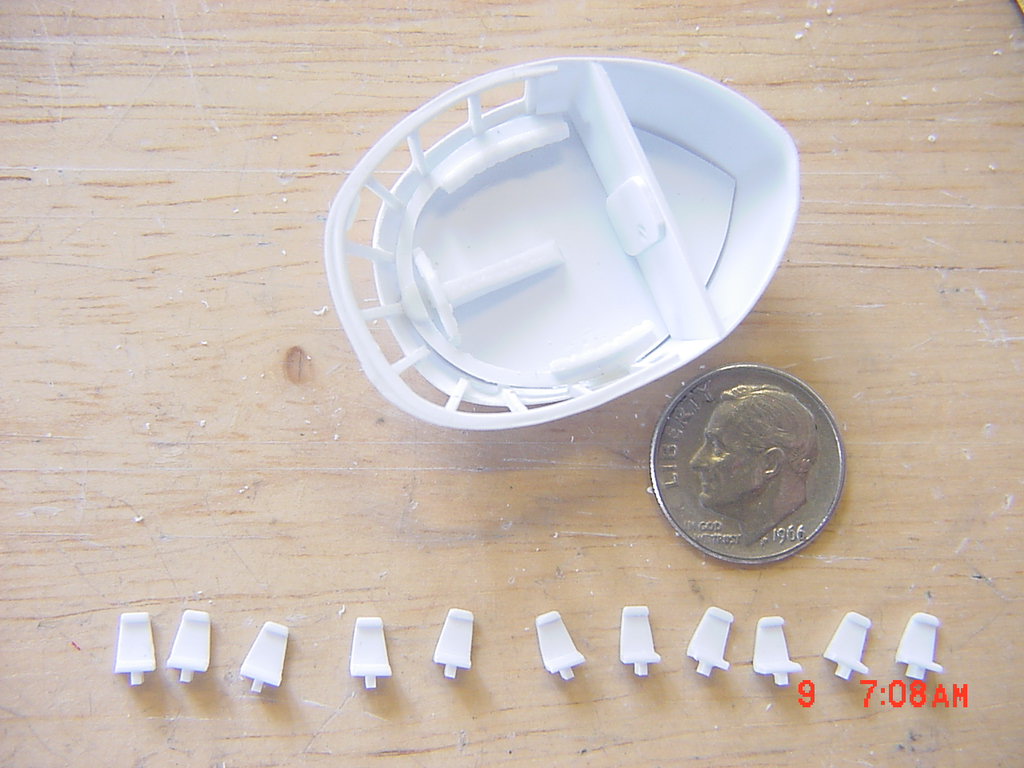

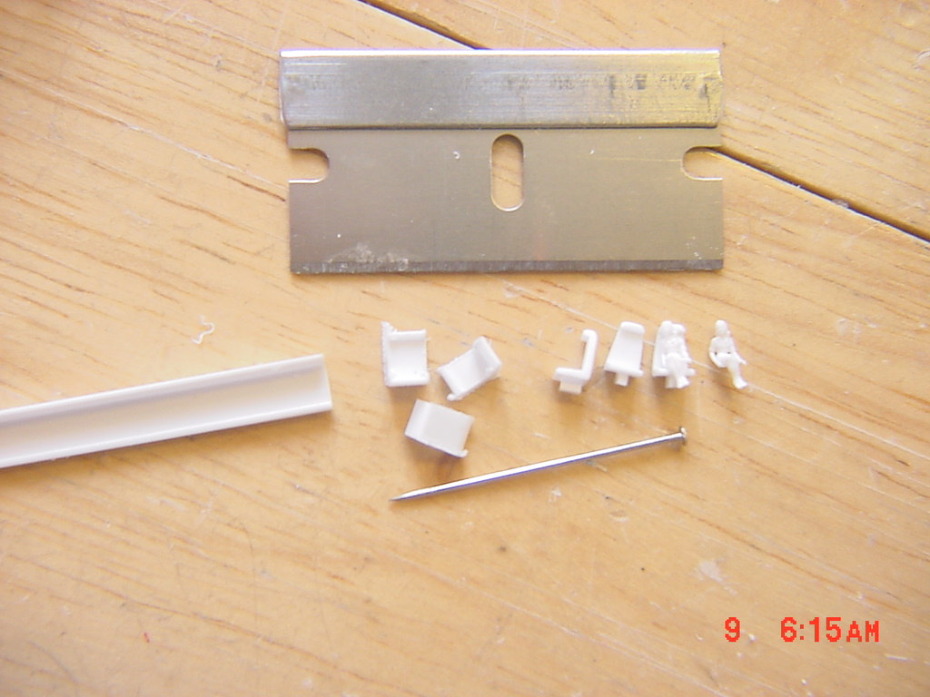

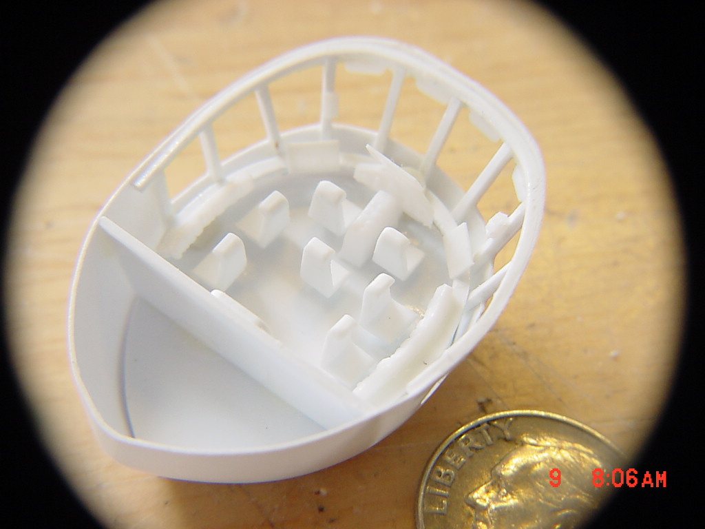

MechTech Posted May 10, 2009 Author Posted May 10, 2009 Thanks Claude! UPDATE 10 MAY 09 I got some work done on the tactical bridge. You can also say I went into the furniture and decorating business too . The tactical bridge basics Completed chairs with "bridge bunny" to scale. Here's the furnished bridge BEFORE making further changes Next comes what I think is a sensor array And the final assemblies to include a test fit [ attachment=66759:Test_Fit_Bridge_1.JPG] The parts will fit perfect when glued, these are just test fit to show assembly. Next I'm on to the mast and making some radars that turn (even though there's none in the lineart). Even the Aegis destroyers have rotating surface scan radars! - MT Quote

MilSpex Posted May 11, 2009 Posted May 11, 2009 (edited) Completed chairs with "bridge bunny" to scale. are you kidding me?!?! incredible. Edited May 11, 2009 by MilSpex Quote

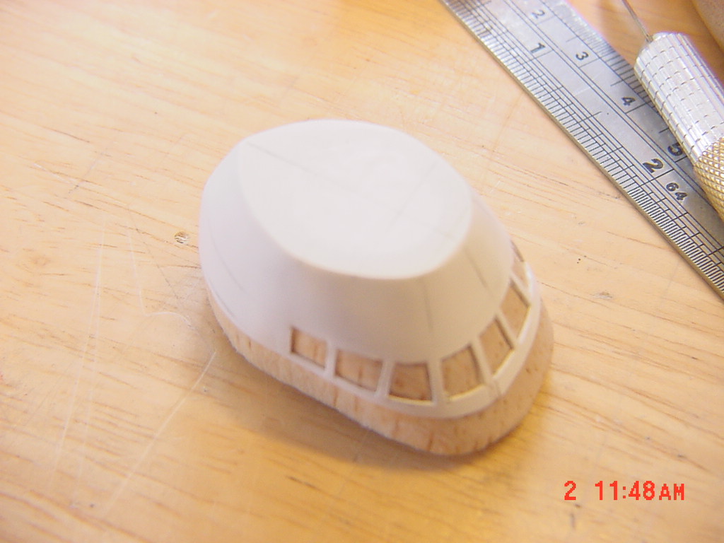

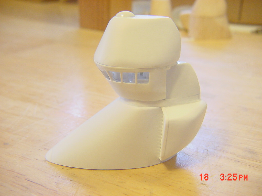

MechTech Posted May 18, 2009 Author Posted May 18, 2009 Thank you everyone for the compliments! The encouragement has helped a lot! There's other kits I'd rather be building too right now. Progress has been slow. My workshop got an unexpected upgrade this weekend when my wife decided she wanted two more bookcases! I had to rearrange my shop to fit the other two cases in "my area." The advantage is that all my books are now in my shop. Disadvantge - lots-o-dust! Thanks Eric! Your site has some great kits on it. Any chance you might reduce your drawings 50% and make them 1/200? That's what I want to build, an Arleigh Burke class destroyer. I've even got most of the armament too from other scratch builds. I thought about using Gator Board, but was concerned about the weight. Most of my major structure is carbon fiber square tune with .020" walls plus additional details. Minor UPDATE 18 MAY 2009 The key part to the whole bridge assembly has been keeping it light. All the pieces you are seeing are no more than .010" or .020" thick. That's why the vacu-forming. Consistently thin walls and no putty to make curves that are thin and light. This is all I have so far The uneven areas behind the windows is where the masts will extend and project upward from. This is a weird designed bridge. That's it for now. - MT Quote
