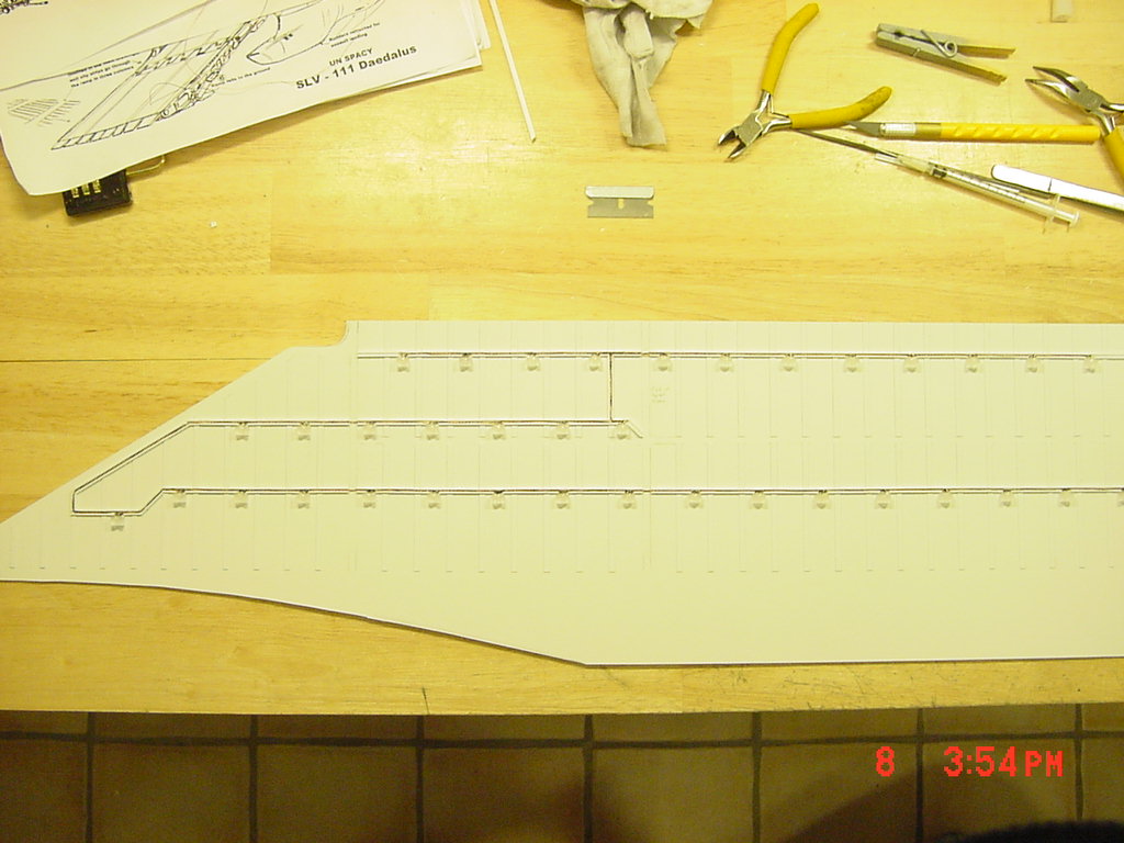

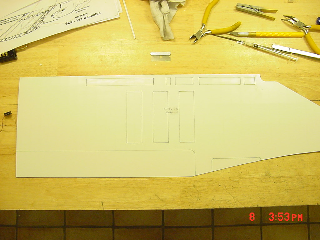

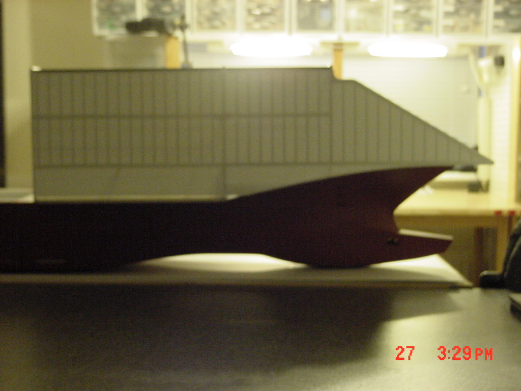

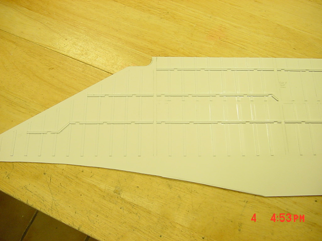

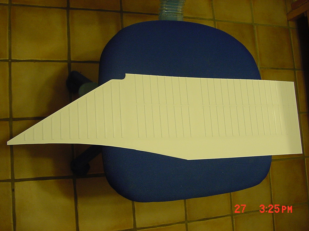

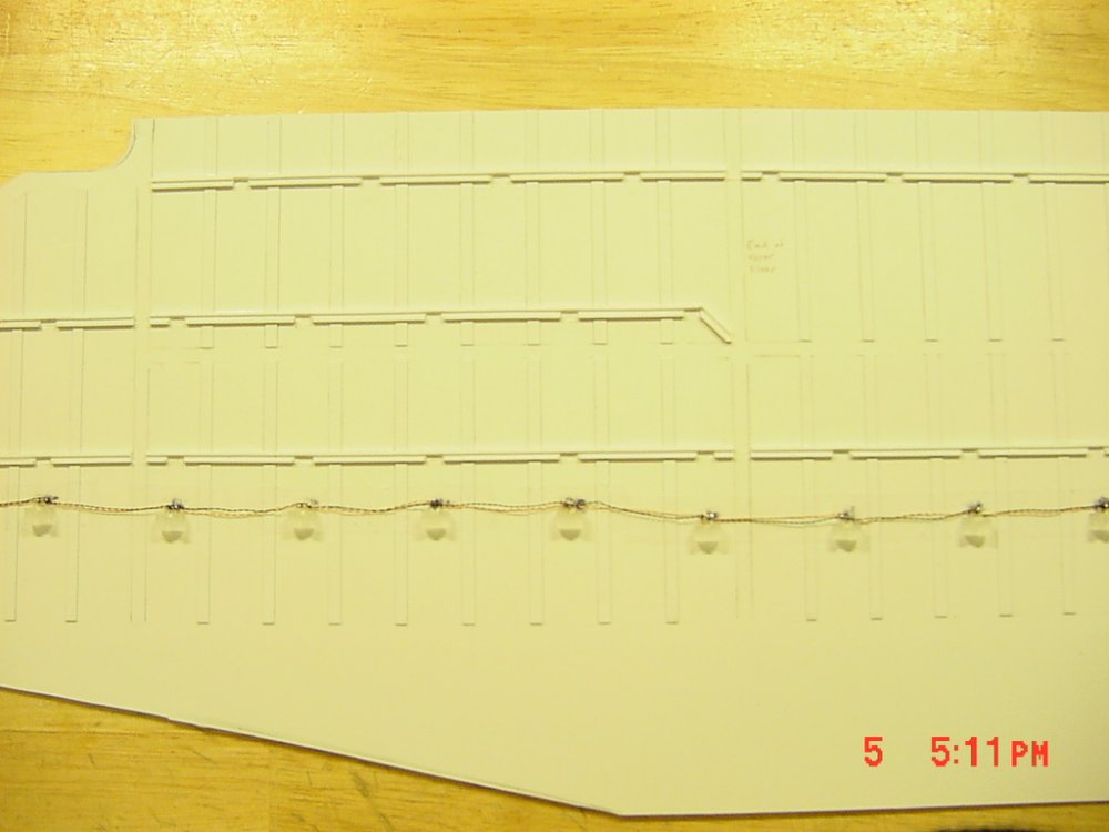

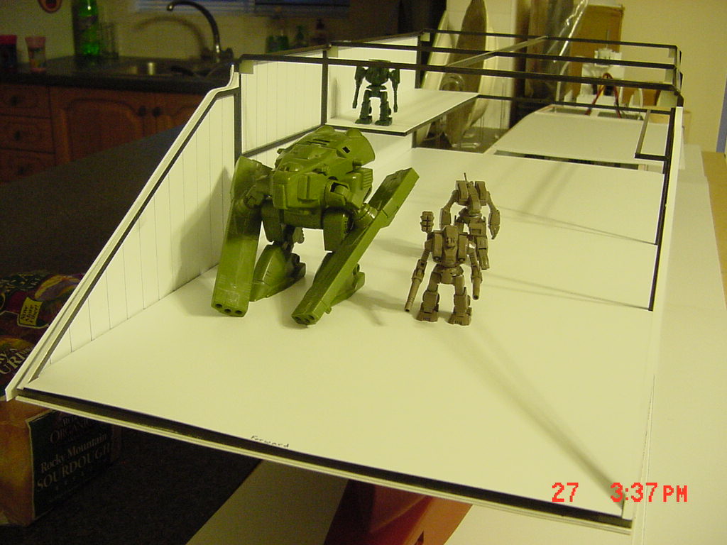

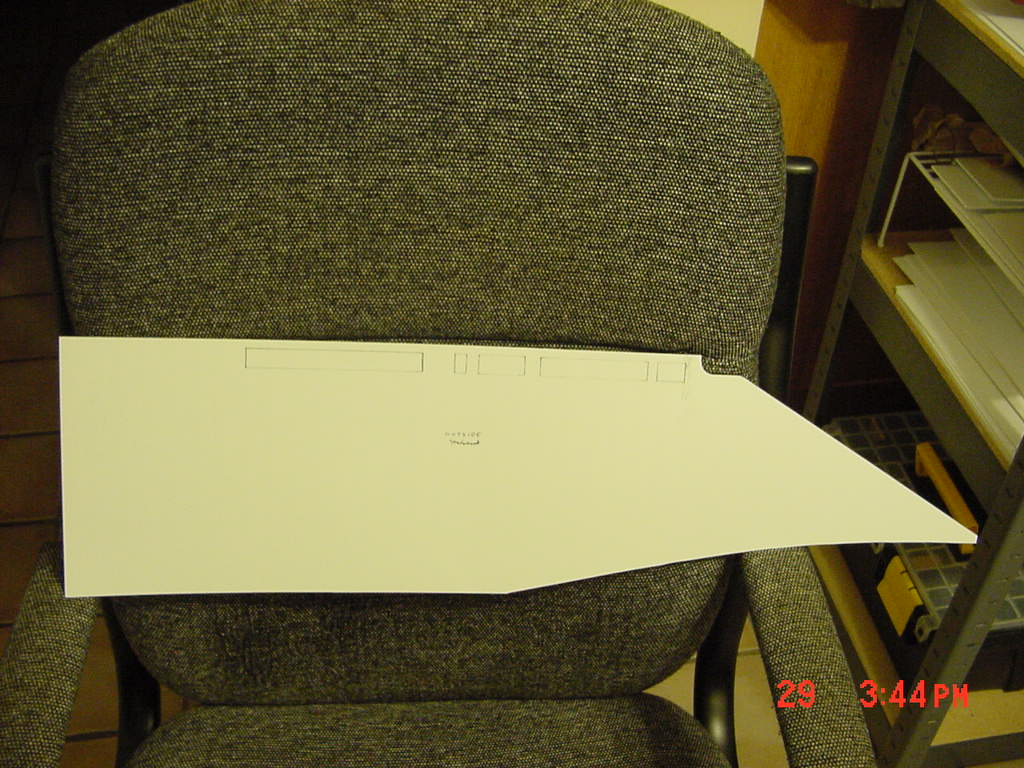

MechTech Posted August 29, 2007 Author Posted August 29, 2007 Hey guys, the chickens worked! We got pinned!!! Special thanks to that special mod out there - whoever you are! UPDATE 29 AUG 07 Here's what I've done this week so far. Got the starboard side ribs glued and trimmed to fit precisely around the carbon fiber frames. Here's a blurred view sneak peak at the side outline (my camera has it's good and bad days). A sneak peak at the interior with unfinished models for comparison. Panel lines etched for whatever the heck they are for. Thanks for the encouragement everyone. This is a great board to learn stuff and find vendors. I've gotten a lot of both here and just trying to return the favor. My workbench JUST butts up against the kitchen counter. If I push my ship over a little too far when needing extra room, I find it moves back "all by itself" mysteriously. The ship will be lit up in the interior. If you imagine a mail slot 12" deep and only 3" high with no light coming in around it, that's what the interior decks will look like. Plus lighting just adds to the realism; especially when put into fixtures. The main hatch will have Daedalus Attack capability. The door will open and the ramp come down - or the door opens and the ramp extends outward. Engineering that has been really fun. Somebody make a paper mache Zentraedi cruiser! If someone comes up with a metric ton of silicon rubber, we can recast it! I'm not paying for shipping though! Talk to you all later. - MT Quote

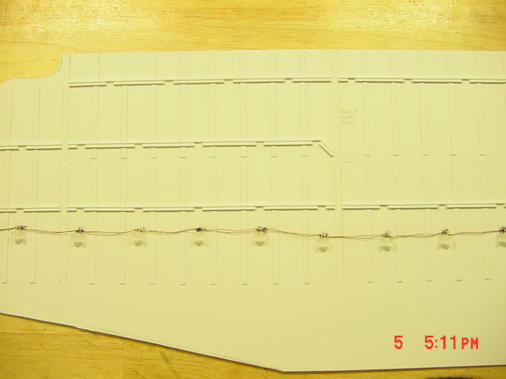

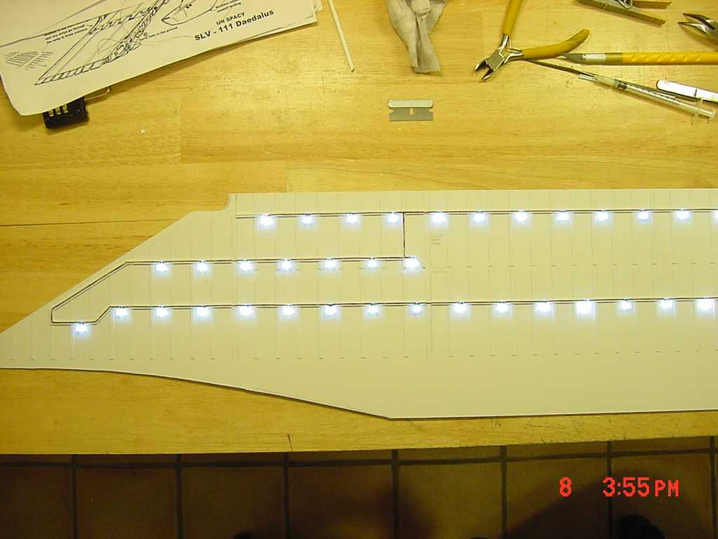

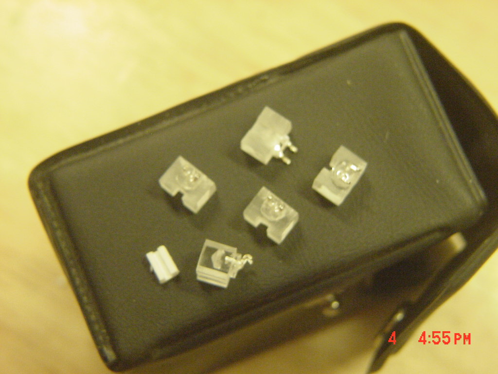

neptunesurvey Posted September 8, 2007 Posted September 8, 2007 Looking good as usually MechTech. How much voltage will it be using when you are done? Quote
warpaint22 Posted September 9, 2007 Posted September 9, 2007 Well I don't mind if you don't fdinish till 2020, just means we get plenty of entertainment. I think you should submit your work to a hobby mag, it would be a shame not to. Great work as usual the lighting is great, will it shut off when the hatch is closed or remain on? Quote
MechTech Posted September 9, 2007 Author Posted September 9, 2007 Thanks again everyone for all the compliments. The lights will be on their own switch. Remember the port (left) side will be able to open up so the completed project will double as a display case when not in the water. The lights will use about 4 to 4.5 volts when done - I think. I took them all off some Christmas wreaths I got really cheap on sale. I saw the price and realized how much the LEDs cost on their own. Anyhow, they came with battery boxes for three AA's and there's circuits inside with resistors. I could hook them back up and make a "giant" 1/200 destroid disco with flashing lights ! I probably will submit my work to a hobby magazine, but I have to get to the point where it's done or nearly done to get finalized looking photos. There's no pictures of what the Daedalus looks like in the rest of the ship, so the rest of the construction should move quicker. I can just make it up as I go along. - MT Quote

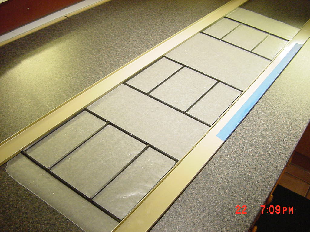

MechTech Posted September 23, 2007 Author Posted September 23, 2007 UPDATE 23 Sept 07 I thought which parts I need to be working on first and I figured I better get the ramp and all it's mechanisms in first. That way I don't have to worry about working around walls or destroying details. Plus this is the toughest engineering part of the whole ship for me. It's not exciting, but here's 42 pieces of precision cut and machined carbon fiber being epoxied together. The two metal parts are keeping all the parts squared off while the epoxy cures (Devcon 2-Ton). These three frame make up the panels for the bow ramp. The sides and tops will be thin styrene to keep the weight down. I don't know whether I'm building a ship or plane some days in trying to keep the weight down. These three panels will then be hinged together and have three actuators to fold and expand/retract the ramp into the bow. That's where I'm really having to do the thinking! Talk to you later. - MT Quote
neptunesurvey Posted September 26, 2007 Posted September 26, 2007 Will you be using more carbon fiber on other sections of the structure or just the ramp? Quote
