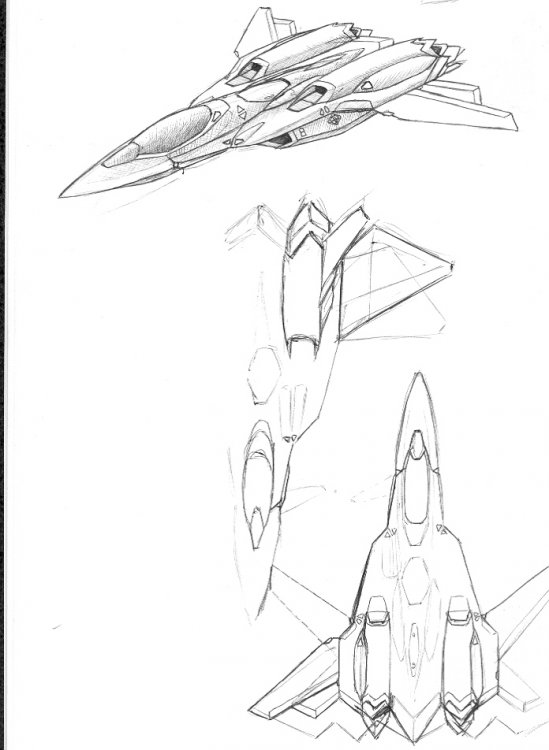

Lestat Posted March 6, 2006 Author Posted March 6, 2006 I used 3d studio max 6, and paint shop pro 7.04 for the modelling and texture making. Attached is my original sketches for the craft. Thought it might interest some people. Quote
