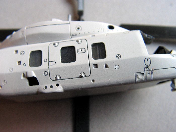

Stamen0083 Posted February 5, 2006 Posted February 5, 2006 I use Painter's Touch gray primer. It's also available in white, but I think the latter is more rare. In anycase, it lays down a very thin layer, covers everything, and is very smooth and forgiving of mistakes made when spraying. Samples of my primed works can be seen here: And:
David Hingtgen Posted February 5, 2006 Posted February 5, 2006 (edited) That primer coat's smoother than a lot of my final finishes! --where do you get it? Craft stores, Wal-Mart, hardware stores? Edited February 5, 2006 by David Hingtgen
Gabe Q Posted February 5, 2006 Posted February 5, 2006 Hey, I use Painter's Touch primer, too! It's good stuff. It goes on real thin. I buy mine at Home Depot. It's around $2.19 for a full size can. That's a price versus perforformance ratio you just can't beat.
