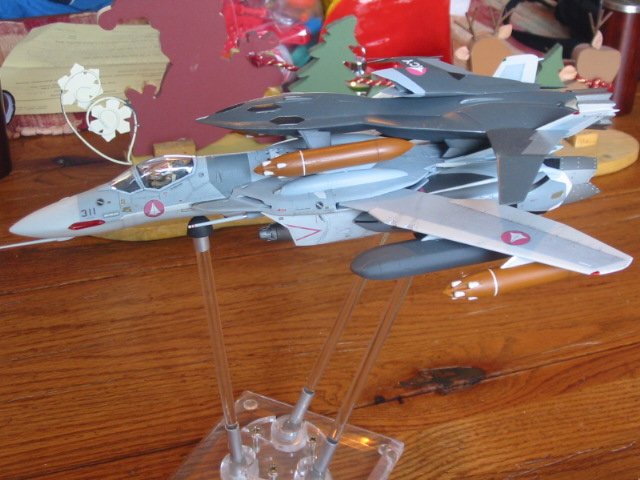

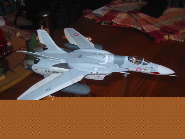

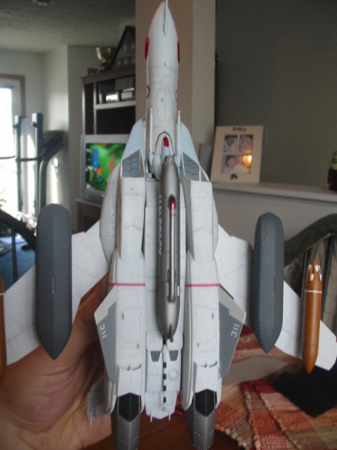

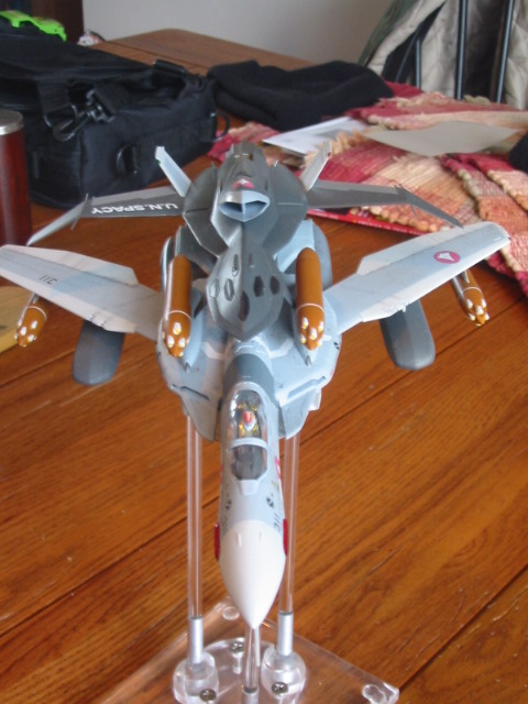

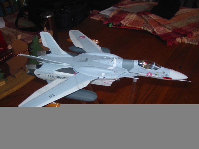

Dobber Posted December 8, 2005 Posted December 8, 2005 (edited) Hi evryone, I finished this a few weeks ago but kept forgetting to take pictures. This is the VF-0S painted up like Shin's VF-0A with the Weapons and Ghost Booster. Sorry for the poor quality pictures, I only have a lousy 2 mega pixel camera so you unfortunately can't see alot of the subtle weathering that I did on her. I added ejection handles and the exhaust vanes to the kit, I hope you all like. Chris Edited December 8, 2005 by Dobber Quote

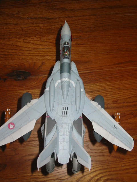

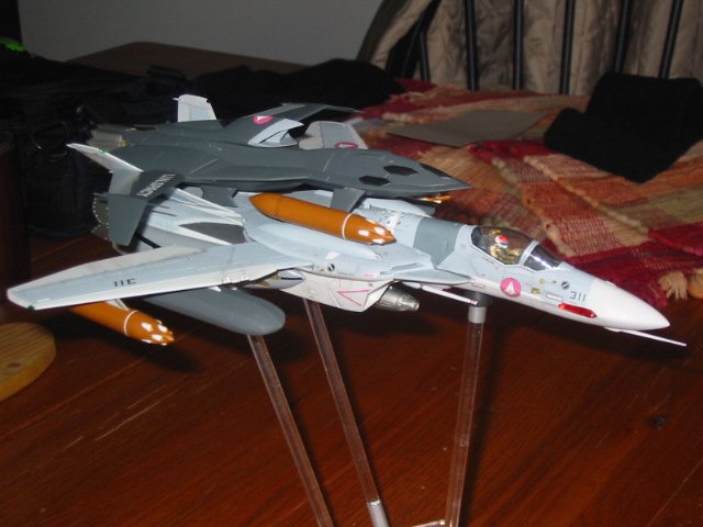

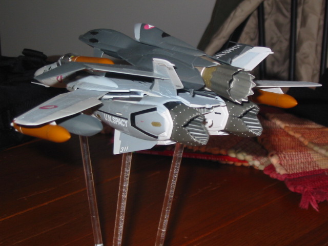

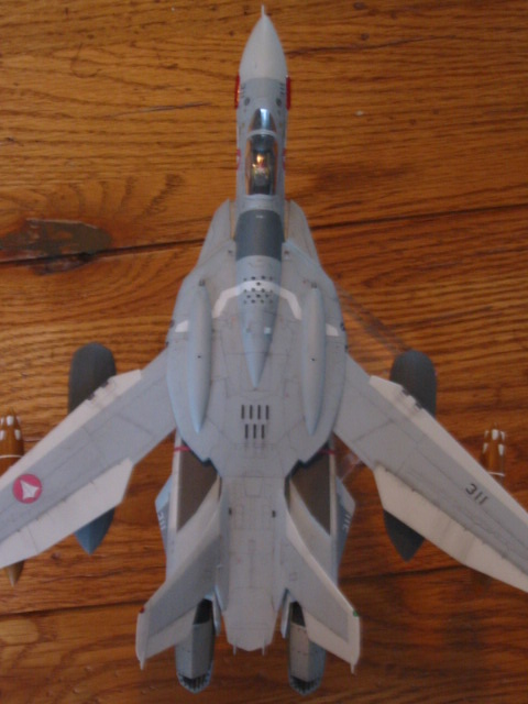

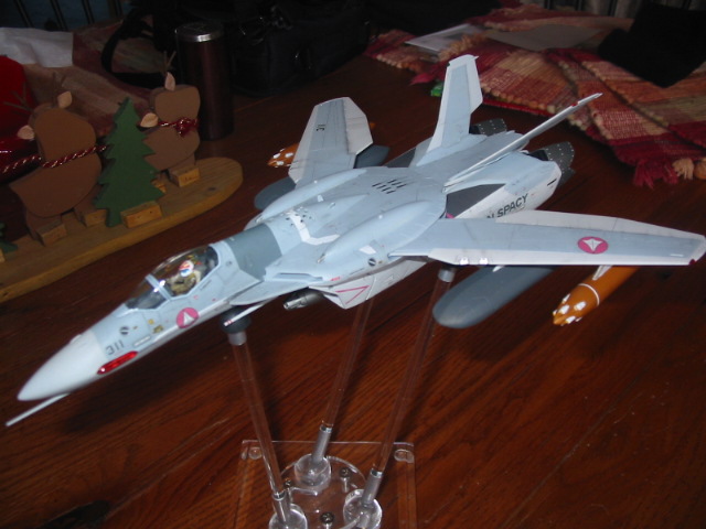

Dobber Posted December 8, 2005 Author Posted December 8, 2005 (edited) some more pictures. Chris Edited December 8, 2005 by Dobber Quote
nightmareB4macross Posted December 8, 2005 Posted December 8, 2005 Excellent work on the paint scheme!!! What colors did you use? Quote
Ignacio Ocamica Posted December 8, 2005 Posted December 8, 2005 Looking really good!!! I like the subtle weathering Excellent job. Quote
rnurmin Posted December 8, 2005 Posted December 8, 2005 Wow, that looks really nice. Hard to believe it is a model kit Quote
UN Spacy Posted December 8, 2005 Posted December 8, 2005 WOW. I never knew the Ghost was that huge! Excellent work man. What's next? Quote
Dobber Posted December 8, 2005 Author Posted December 8, 2005 Excellent work on the paint scheme!!!What colors did you use? 350706[/snapback] Thanks for the compliments. I used Testors Modelmaster Acrylic "Standard US Navy Grey" for the upper surfaces, and Testors Modelmaster Acrylic "Light Grey" for the lower surfaces, both straight from the bottle. Now I'm working on a hasegawa F-14A . She's almost finished too. Chris Quote
Fortress_Maximus Posted December 8, 2005 Posted December 8, 2005 I like! Great work! How long did it take you from start to finish? thanks for sharing! Quote
Graham Posted December 9, 2005 Posted December 9, 2005 Looks great. I'm glad you decided to build it with the landing gear up. Valks in fighter mode look so much better that way IMO. Graham Quote
David Hingtgen Posted December 9, 2005 Posted December 9, 2005 Dobber--could you post the FS numbers for the paints? Testor's Acrylic lines are all over the place, I have about 4 different ones names "light grey". And then there's the fantasy acrylic line... Though I'd presume you're referring to 36495. No idea for Navy grey, unless it's one of the Marine paints. Quote
Dobber Posted December 9, 2005 Author Posted December 9, 2005 Dobber--could you post the FS numbers for the paints? Testor's Acrylic lines are all over the place, I have about 4 different ones names "light grey". And then there's the fantasy acrylic line... Though I'd presume you're referring to 36495. No idea for Navy grey, unless it's one of the Marine paints. 350934[/snapback] Lets see, the bottle says 4765 Light Gray ModelMaster Acryl and 4233 #5 Standard Navy Grey 1/2 ModelMaster Acryl. This color I just found about a year ago and I absolutely LOVE IT!!!! It really is the perfect US Navy blue grey. And yes the bottles actually have the different spellings of Grey/Gray on them! . Graham, I also prefer and build my models with gear up whenever possible. That's one problem with Hasegawa Tomcats.....pilots won't fit in them! Chris Quote

wm cheng Posted December 13, 2005 Posted December 13, 2005 Wow Dobber, fanastic work! Keep posting... I love seeing this work - I can't wait for the F-14. I need my model fix (since I can't build right now, Christmas & got a short 4wk production) I can't believe you hand brush - I can't hand brush to save my life!! I didn't know the Ghost was removeable - how does it attach on? I must get one of these kits now! Great work on the scheme, it looks great - keep up the fanastic work! Quote
Dobber Posted December 14, 2005 Author Posted December 14, 2005 Actually, I don't think it supposed to be removable....I just liked how the 0 was looking that I didn't want to hide her under the ghost perminantly! What it does is it has slots between the engine and the wings and they slideinto the vertical stabs and then it just rests on top of the 0. The thing is, is that this requires different vertical stabs that are actually canted out further than normal....which I think looks better..... than normal....but when the ghost isn't on my kit is "Technially" inaccurate because the vertical stabs are still canted out farther. Like I said, personally I think it looks better though, since the VF dosn't have horizontal stabs. What I did with the upper missile pods was to just drill out little holes that the pegs fit into and the pods just fit in well enough with out glueing! My Tomcat is just about done, just need to do the lights and a few other things, but she is essentially done! I'll post pictures later tonight. Chris Quote

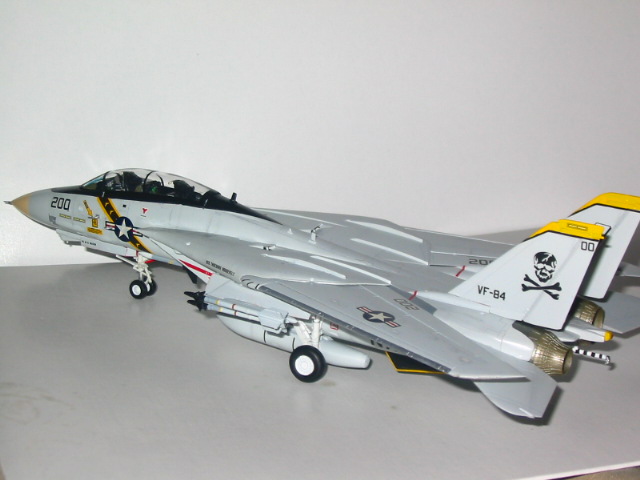

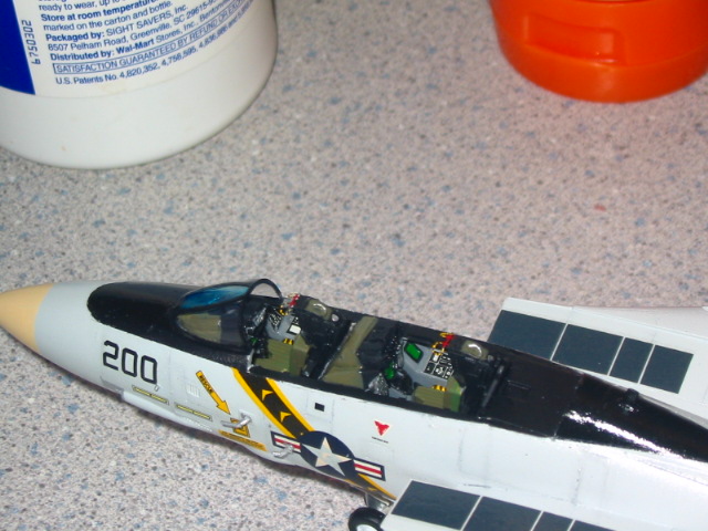

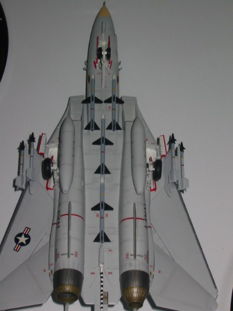

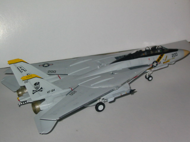

Dobber Posted December 15, 2005 Author Posted December 15, 2005 (edited) Here are a few shots of my Tomcat. It's night time so the pictures are so so. still need to finish a few things on her too. Here is a taste anyway. Since this is a CAG bird she's really subtly (spelling) weathered, If you look hard enough you can see! Chris Edited December 15, 2005 by Dobber Quote
