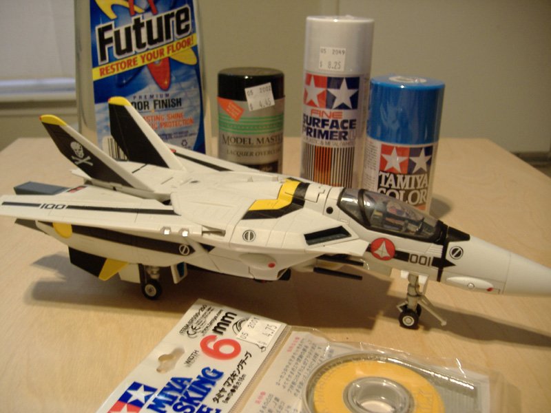

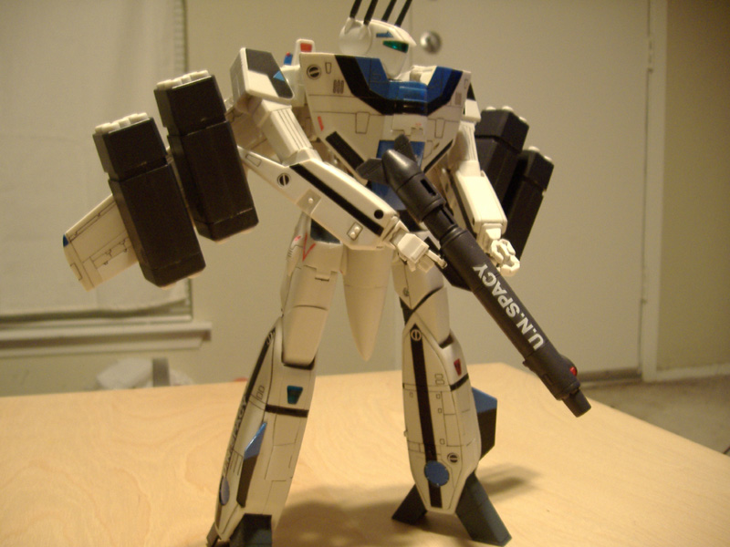

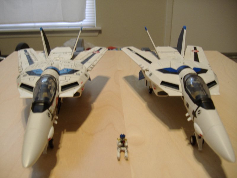

Wicked Ace Posted November 29, 2005 Posted November 29, 2005 (edited) I was envious of the people that had a Max -1S displayed and wanted one of my own. My problem was that I didn't want my custom (or hack-job if you prefer), to look "better" than the Roy and Hikaru it would be displayed next to. My goal was to make my Max -1S look like it came from Yamato; I tried to use as much of Yamato's stock paint as possible and tried to mimic the stock paint look on any parts requiring color changing. I think I've done a decent job of an adequate paint scheme, just like what Yamato gives us. Let me know what y'all think. Here's the conversion "kit." I used Tamiya TS-10 French Blue (I'm using a canned paint, so there's no re-mixing/matching any paint in the event of a scratch). Edited November 29, 2005 by Wicked Ace Quote

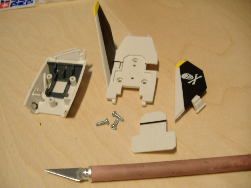

Wicked Ace Posted November 29, 2005 Author Posted November 29, 2005 The tail section disassembly: Quote

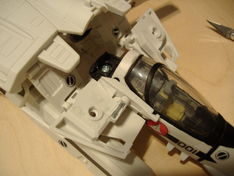

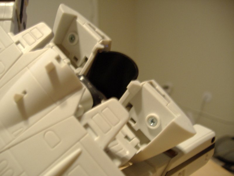

Wicked Ace Posted November 29, 2005 Author Posted November 29, 2005 Here, you can get to the two screws that hold the chest plate on. Quote
Wicked Ace Posted November 29, 2005 Author Posted November 29, 2005 Getting access to the screw holding the battroid's head on -- once the screw is removed, you need to use a little effort to free it from its base: Quote

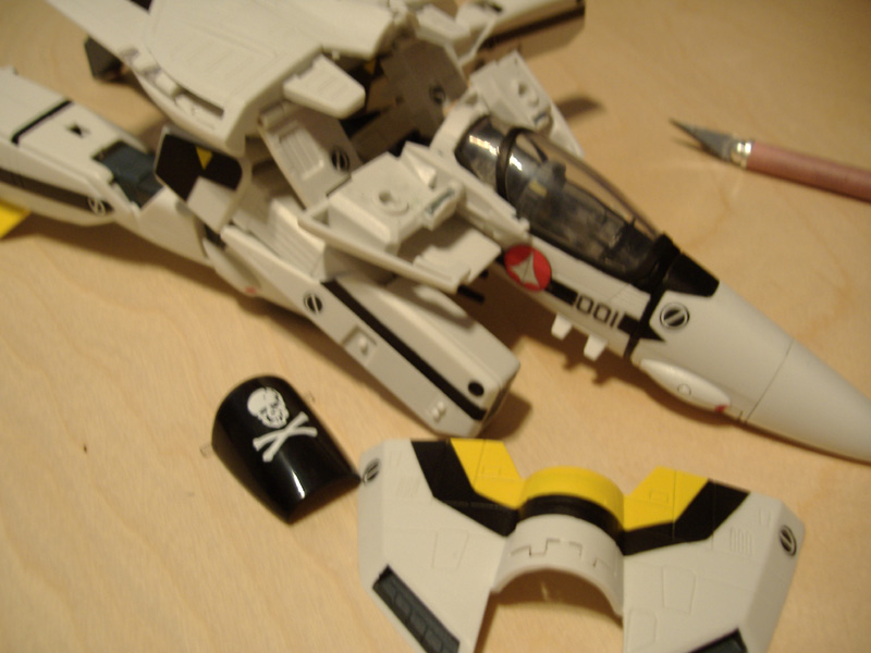

Wicked Ace Posted November 29, 2005 Author Posted November 29, 2005 The freed heat shield and chest plate: Quote

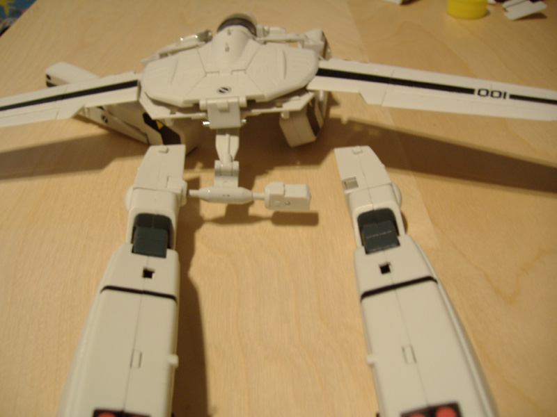

Wicked Ace Posted November 29, 2005 Author Posted November 29, 2005 How the legs come off -- just pull outward (I wish I had seen a pic like this before I took apart my first Valkyrie): Quote

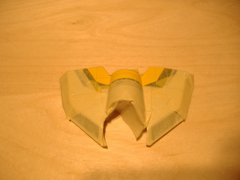

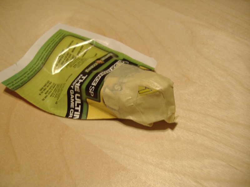

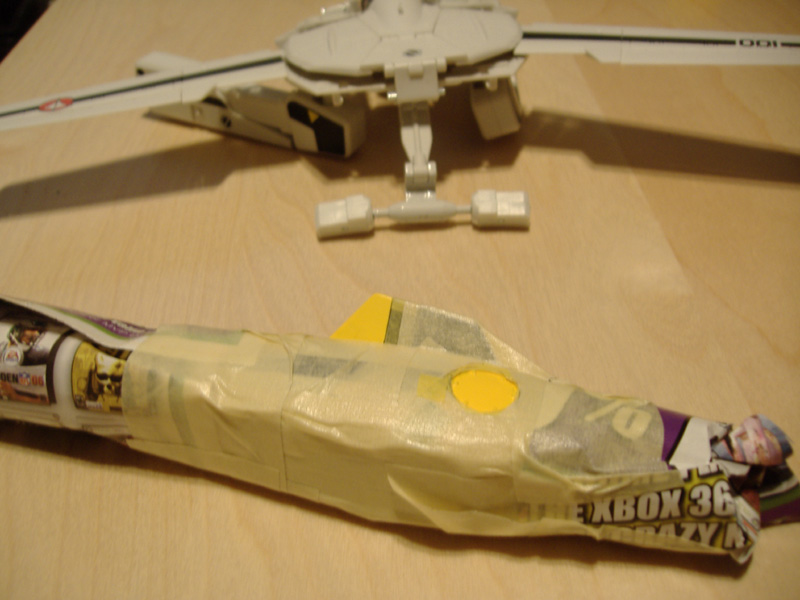

Wicked Ace Posted November 29, 2005 Author Posted November 29, 2005 The masking (a.k.a. the "fun part") -- after masking, make sure to scuff the original paint with a scotch-brite pad and/or fine grit sandpaper, then apply primer (I like Tamiya's Fine Surface Primer): Quote

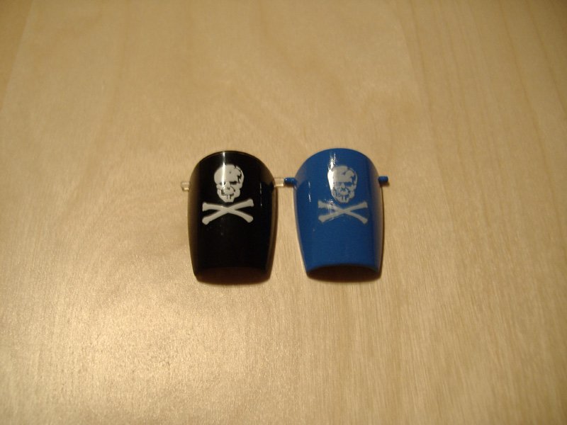

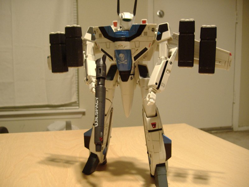

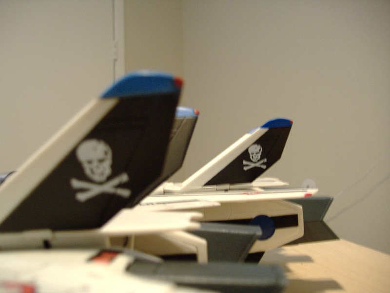

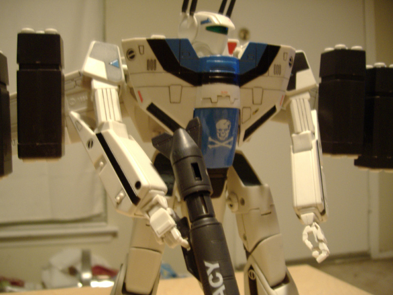

Wicked Ace Posted November 29, 2005 Author Posted November 29, 2005 Of course, most of you will be able to strip off the black paint and substitute blue on the underside of the heat shield. Not me. Yamato gave me a heat shield with a crooked skull. My approach was to scuff the top of the heat shield, paint it blue, add a skull decal, and brush on lots of Future. The result didn't turn out too badly; however, looking closely you can see the edge of the sticker -- I'll fix this later by redoing the heat shield with a waterslide. A stock Roy heat shield and mine: Quote

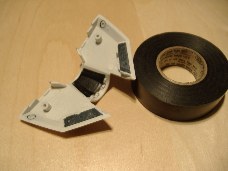

Wicked Ace Posted November 29, 2005 Author Posted November 29, 2005 Oh, and to protect my new heat shield, I added electrical tape to the underside of the chest plate, where the shield resides. This has kept the heat shield from being gouged for three transformations now. Quote

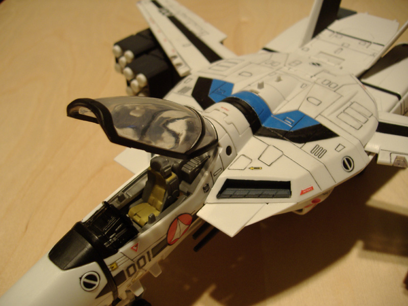

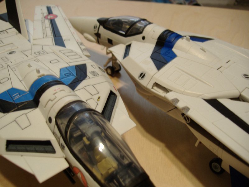

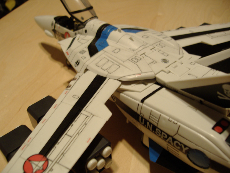

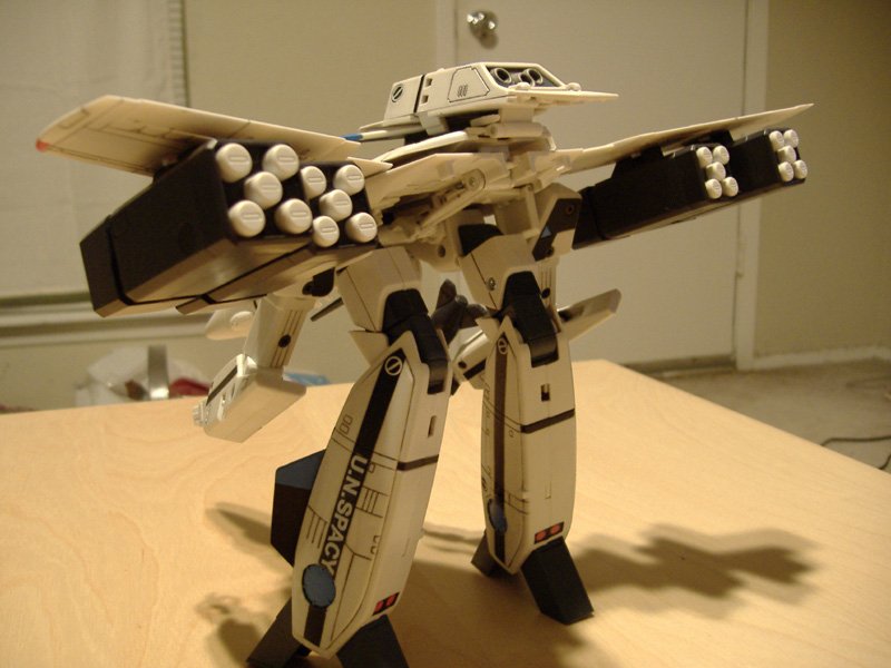

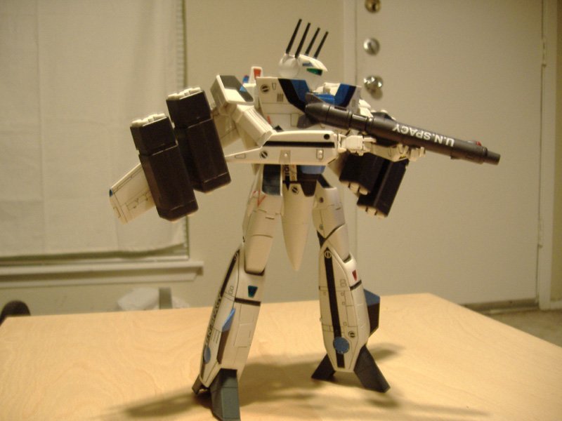

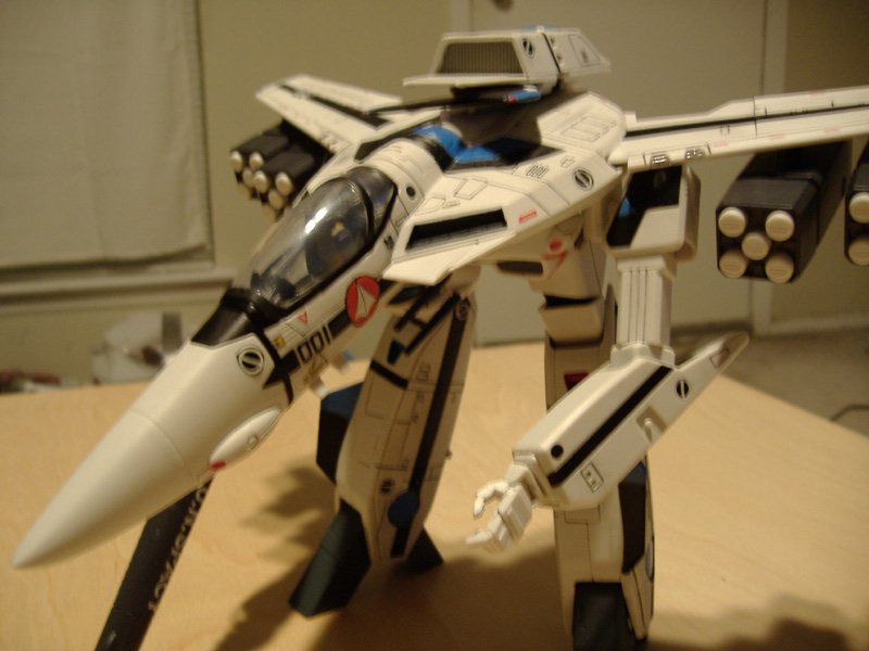

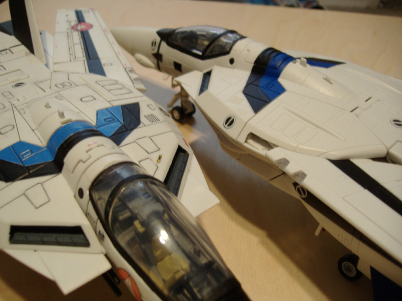

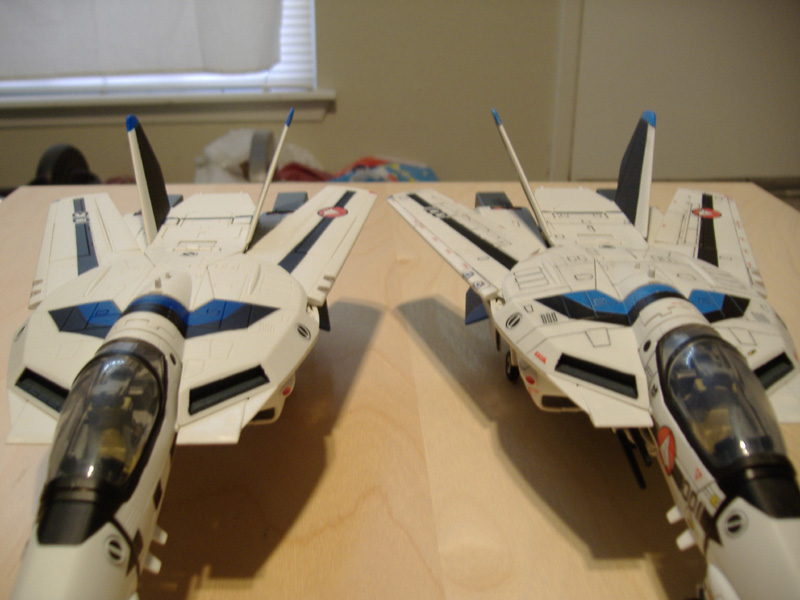

Wicked Ace Posted November 29, 2005 Author Posted November 29, 2005 Skipping ahead a few steps (I think the other disassembly/masking steps are too elementary to post pics of), the result: Quote
Wicked Ace Posted November 29, 2005 Author Posted November 29, 2005 Now I need a 1/48 scale Q-Rau. Quote
Zinjo Posted November 29, 2005 Posted November 29, 2005 Of course, most of you will be able to strip off the black paint and substitute blue on the underside of the heat shield. Not me. Yamato gave me a heat shield with a crooked skull.  My approach was to scuff the top of the heat shield, paint it blue, add a skull decal, and brush on lots of Future. The result didn't turn out too badly; however, looking closely you can see the edge of the sticker -- I'll fix this later by redoing the heat shield with a waterslide. A stock Roy heat shield and mine: 348239[/snapback] The way to "flatten" a sticker is very very time consuming. Essentially you clear coat it several times, sand the sticker area down and clear coat again until the layers of clear coat eventually even out over the sticker.... It isn't impossible, just very time consuming... Quote
Mechamaniac Posted November 29, 2005 Posted November 29, 2005 Cool, thanks for the tutorial. Though, it would have been much shorter if you had just converted a Max 1A to an S head. But for those of us who don't have 1A Max's this is cool stuff. French Blue??? - GAH!! Now Max will surrender evertime he sees an enemy pod! Beautiful custom, makes me want a Max 1S even more. Quote
kensei Posted November 29, 2005 Posted November 29, 2005 Alternatively I would recommend using the sticker undeath a heatshield and then paint over it. Quote
JB0 Posted November 29, 2005 Posted November 29, 2005 French Blue??? - GAH!! Now Max will surrender evertime he sees an enemy pod! It's okay. He's awesome enough to punch through and become the Napolean conquerer type of french. Quote

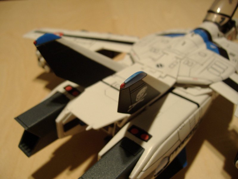

ghostryder Posted November 29, 2005 Posted November 29, 2005 I like the choice in blue, seems more authentic than the yamato 1/48 blue, but not quite as ghastly as the 1/60 blue. Great tutorial for us out-of-practice modelers. Is Max hiding a crooked tailfin skull? Quote
Wicked Ace Posted November 29, 2005 Author Posted November 29, 2005 I like the choice in blue, seems more authentic than the yamato 1/48 blue, but not quite as ghastly as the 1/60 blue. Great tutorial for us out-of-practice modelers.Is Max hiding a crooked tailfin skull? 348336[/snapback] Yup! Actually, both tailfins have crooked skulls. Recap, Yamato let a Valkyrie out the door with three crooked skulls! Quote
big F Posted November 29, 2005 Posted November 29, 2005 Good job looks factory to me. Thanks for sharing it with us. Quote

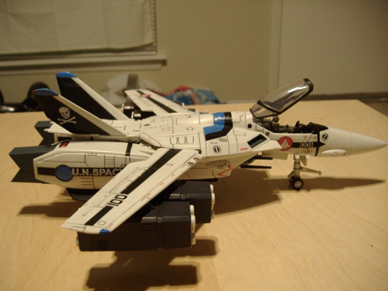

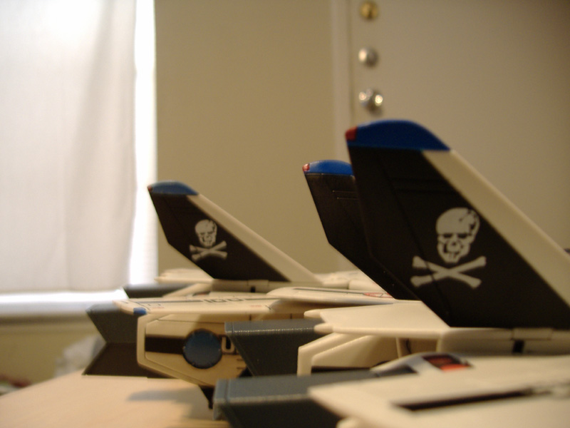

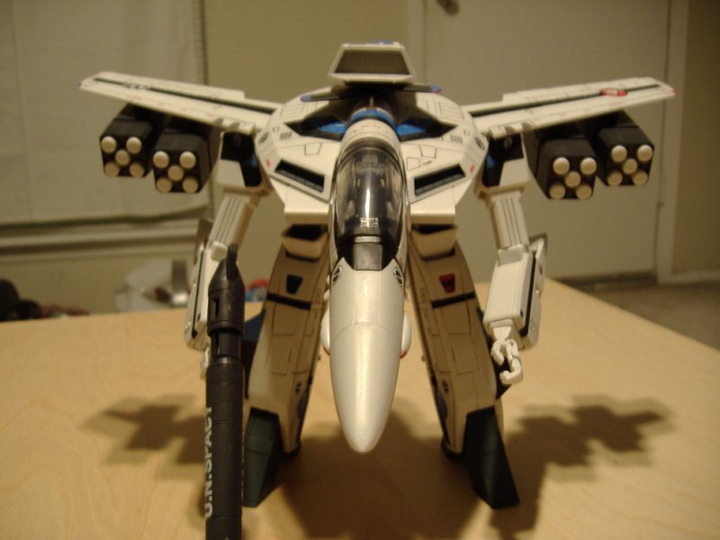

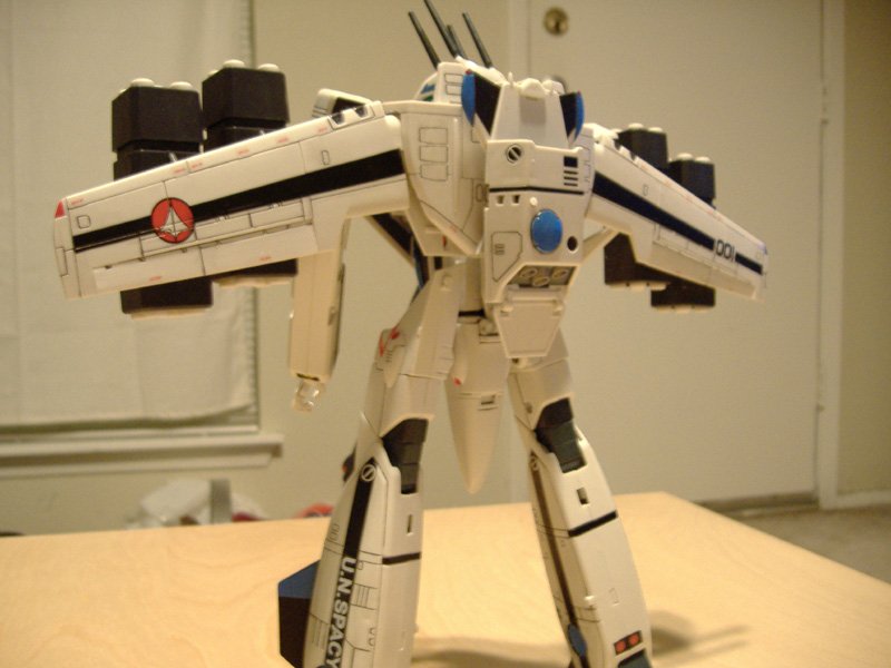

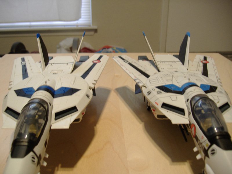

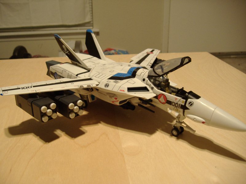

ghostryder Posted January 22, 2006 Posted January 22, 2006 Your little tutorial inspired me to do a Roy-to-Max of my own. I used Rustoleum for Plastic Sail Blue, and left the heatshield black . Quote
aaajin Posted January 22, 2006 Posted January 22, 2006 kool! black heat shield is the bomb! with black skull insignia for the fastpacks Quote
ghostryder Posted January 22, 2006 Posted January 22, 2006 (edited) kool! black heat shield is the bomb! with black skull insignia for the fastpacks 362940[/snapback] Yeah, that's exactly what I intend to take a pic of, once the paint has cured for a week (it's still tacky as I write this). Here's another fighter shot showing how cool the black jolly rogers looks w/ the blue trim. edit: friggin' photobucket won't shrink photo, sorry. Edited January 22, 2006 by ghostryder Quote
Wicked Ace Posted January 22, 2006 Author Posted January 22, 2006 Looks good, ghostryder. I think the blue you used is lighter than what I went with -- more like the 1/60 scale blue (which goes well with your missile pods). Quote

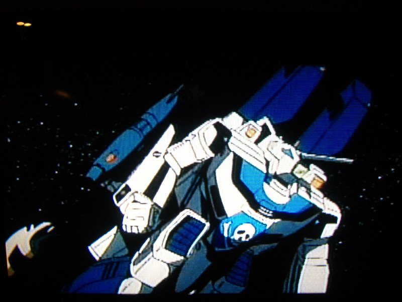

ghostryder Posted January 22, 2006 Posted January 22, 2006 Looks good, ghostryder. I think the blue you used is lighter than what I went with -- more like the 1/60 scale blue (which goes well with your missile pods). 363039[/snapback] Actually, the Sail Blue I used it right between the 1/60 blue and the fastpack sticker blue in darkness and hue. I think it's the picture flash that makes it appear more bright. It's definitely darker than the Tamiya French Blue (checked hobby store). Either works i think, it dpends on which screenshot you're trying to match . Quote

Wicked Ace Posted January 23, 2006 Author Posted January 23, 2006 Actually, the Sail Blue I used it right between the 1/60 blue and the fastpack sticker blue in darkness and hue. I think it's the picture flash that makes it appear more bright. It's definitely darker than the Tamiya French Blue (checked hobby store). Either works i think, it dpends on which screenshot you're trying to match . 363049[/snapback] I think going lighter than the Yamato Max blue is best as being accurate to any of the DYRL screen shots. From your description of Sail Blue, that camera flash must really lighten up things. Looks pretty good at any rate. Quote
