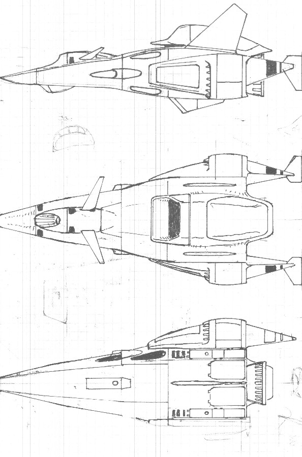

honneamise Posted November 7, 2005 Author Posted November 7, 2005 I request a scan of those schematics that you've got drawn!!! They'll go a LONG way for the 3d people amongst us. 342563[/snapback] Here is a scan, but as you can see my scanner is from the last century and sucks big time. Anyway, it´s completely handdrawn and there are no small details as panel lines etc, just the general outline. Overall lenghth should be 16,7cm in 1/72 but that´s just my guess. If you need a bigger one please PM me! Quote
chrono Posted November 7, 2005 Posted November 7, 2005 Thanks!! Those are very good at their current size/resolution. It's a misnomer that larger scans are better when it comes to simple, uncomplicated schematics. Quote

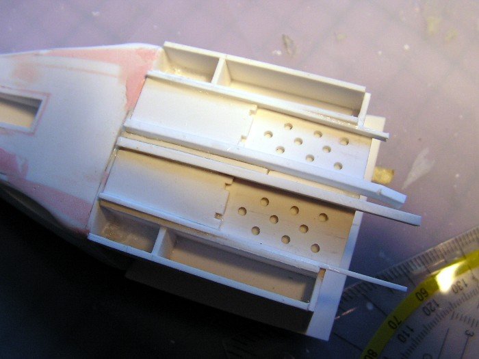

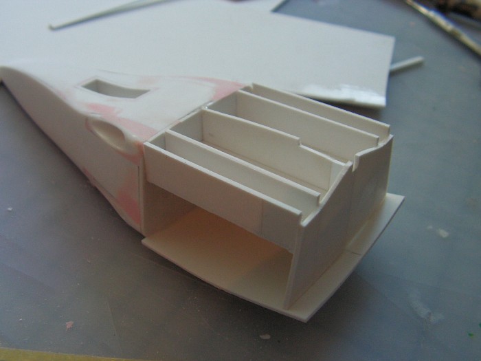

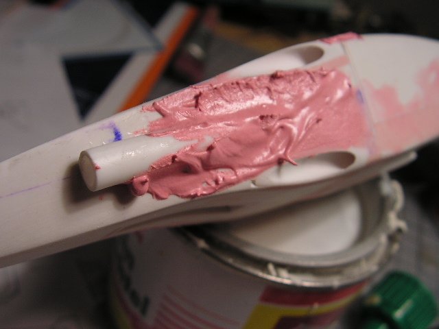

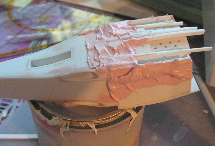

honneamise Posted November 8, 2005 Author Posted November 8, 2005 Today I did the aft half of the fuselage. First I fitted a curved "upper deck" andthen I added some boxes to the underside - these will become the main wheel wells. side view The airbrakes will be attached to the recessed areas with the holes - that was a pain to adjust cause it is all curved, even more than can be seen in the picture Now it is all covered in putty, and what you can´t see , I filled the whole inside of the craft with resin - no warping or breakage from now on! I couldn´t stand this poor sight so I sanded it all down and now it looks fantastic! I´ll have to take more photos! Quote

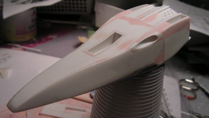

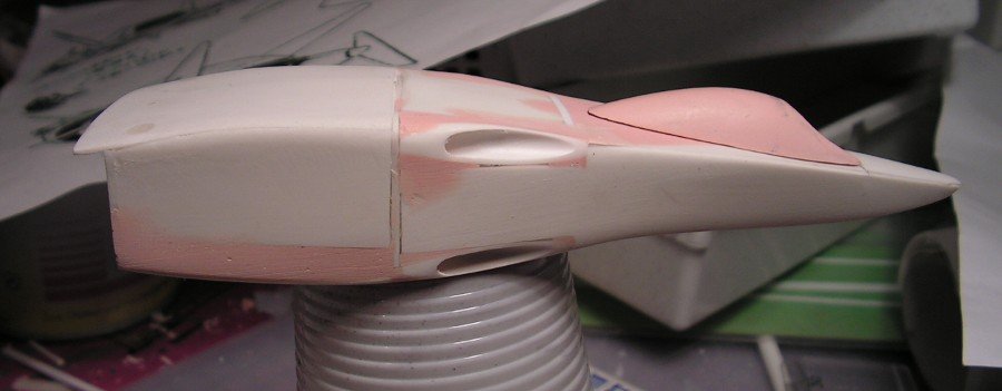

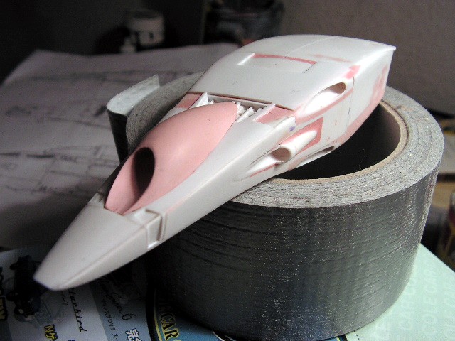

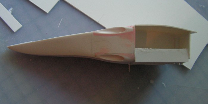

honneamise Posted November 8, 2005 Author Posted November 8, 2005 The underside after my vacuum cleaner sucked in a ton of sanding dust... from the side - the surface is still rough and some adjustments needed but the shape is a Ghost and not a Ford Model T! Quote
Grayson72 Posted November 8, 2005 Posted November 8, 2005 From what Thorsten described in his Oberth thread to us it would be known as Bondo. Quote
honneamise Posted November 9, 2005 Author Posted November 9, 2005 sweet...what kinda putty is that? 343356[/snapback] Thor here in Germany this stuff is just called Polyester putty and it is mainly intended for car body repairs. The putty itself is white and you add the red hardener. We had this discussion before and, as Chad says, this is most probably the same as Bondo. Hardens in about 2-3 minutes, then it is kinda rubbery for 5 minutes, after 10-15 minutes you can sand it (According to the instructions you should use MUCH less hardener than I do (the stuff will then stay almost white, not pink) and then the process takes longer). After some hours it is hard like plastic and it will NEVER shrink! I dropped the use of any other putty because of these advantages. Work is much faster with this stuff and it even the cheapest! Quote

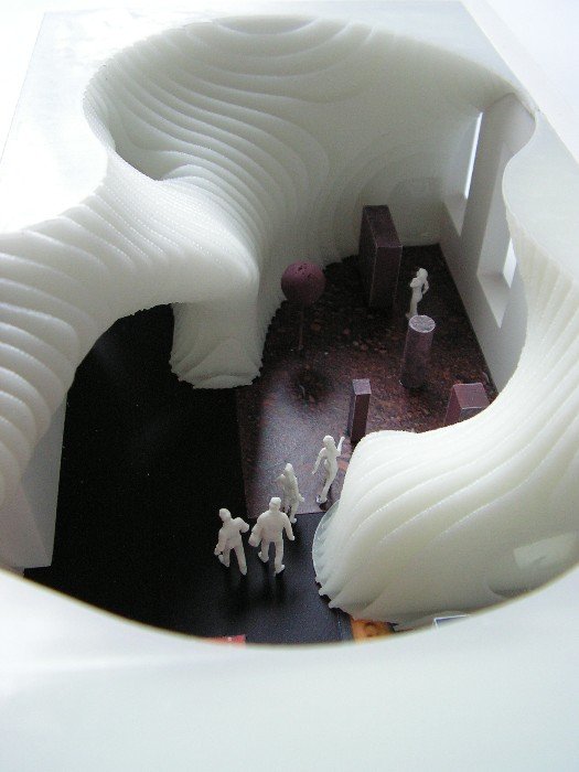

honneamise Posted November 23, 2005 Author Posted November 23, 2005 Hey what's the commission for? 346478[/snapback] It is an interior model of a display room in the German Museum in Munich. A studio here in Cologne has developed a very sci-fi-ish, amorphous interior design and they wanted me to build a model. The problem was that I cannot produce this inner structure within their time (and monetary) limits. I said the only way to do it in time will be stereolithography, but this is very expensive, so their decision was to go with just 3-D- animation and no model at all. Then the museum guys insisted on a model and I was back on it. Now I only build the surrounding walls and display areas and the structure will be "lasered" out of a resin block by another company. If I do my job correctly and they do theirs the two models should fit perfectly - they better do ´cause sunday is the deadline and I wont get the stereolithography until friday! Makes me slightly nervous and time is pressing hard, but it is still fun and I may be able to get more comissions from this company in the future. Quote

honneamise Posted December 2, 2005 Author Posted December 2, 2005 (edited) Wow that Battlestar looks awesome! When I first saw the design I was kind of let down by the "radiator" look but when I finally had the chance to watch it "in action" it soon grew on me. Now with all those incredibly detailed areas this kit gives a real feel of the size of this craft, the more I look at it the more I even like it over the original Galactica. Great work, cobywan!! I finished my interior model last sunday as planned but they kept changing parts of the layout so I got it back and had to work on it again. They changed the structure from amorphous bubbles to ribs- I could have built this from plastic sheet but not in the required time so the thing is still made with stereolithography. Here is a pic of a portion: While all people were mightily excited when the piece arrived from the company, I must say I consider this technique MUCH to rough to serve as a master for a limited run mecha kit. All the rounded surfaces have those tiny steps -as you mentioned, cobywan! - and smoothing the whole thing out to a model kit pro´s quality standard would take a lot of time. Even if it was less expensive I´d say I will go on with scratchbuilding things with my own hands for a while... Edited December 2, 2005 by honneamise Quote
electric indigo Posted December 2, 2005 Posted December 2, 2005 I've seen stereolithography pieces with perfect finish right from the machine (crazy stuff like a sphere within a sphere), but I guess that's still insanely expensive. Good for you. -i- Quote

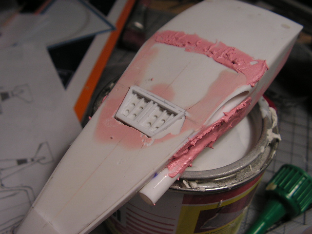

honneamise Posted December 5, 2005 Author Posted December 5, 2005 Hi Guys! Honneamise, I want one Ghost kit for me... what I must to do?Regards, Ruben 349699[/snapback] Hi Ruben, I PMd you, guess Chad will put you on the list anyway! Now I´m back to work on the Ghost. I´m working on the middle gun tbes right now. Tricky stuff ´cause they must be perfectly in the middle between upper and lower gun, face exactly forward and must look the same right and left side. I could not imagine how to fit them while building the body so now I had to drill large holes into each side, glue the tubes in and cover it all up in loads of putty. Hope they look OK, I guess I can only be sure AFTER I sanded it all to shape. This is a GREAT opportunity to screw the whole thing up I also built an "interior" for the speed brake just aft of the cockpit, but I´ll fit that one after I´m through with the messy part.... Quote
honneamise Posted December 6, 2005 Author Posted December 6, 2005 More progress, added panels to the upper side and sanded them to a rounded shape. The gun tubes came out fine, they only need some "fine tuning" now. Quote
