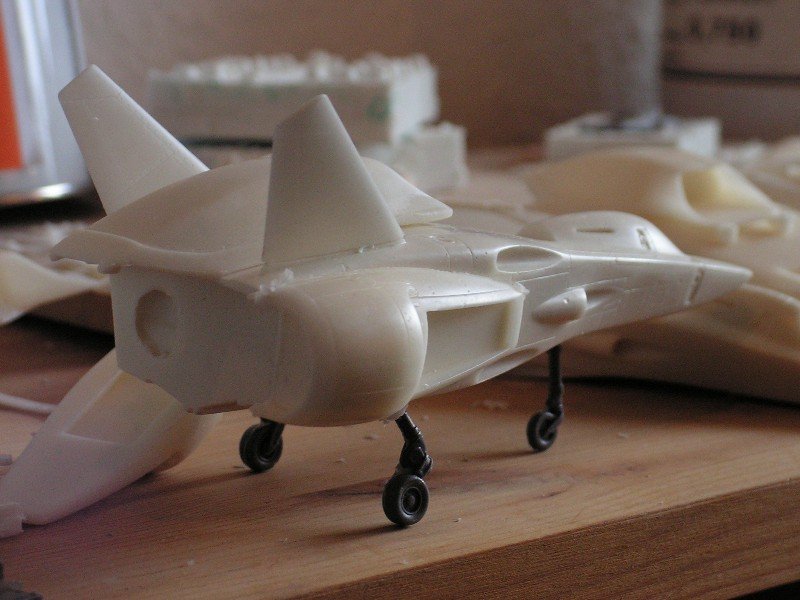

honneamise Posted March 31, 2006 Author Posted March 31, 2006 dibs on the one in the middle 386222[/snapback] Well, the two on the left have some air bubbles ´cause they were for testing out where the "problem spots" of the molds are - don´t know if you want THESE.... Right now I´ve been experimenting with white paint and the resin does almost look like like plain polystyrene now, less translucent. For the gear parts I have added aluminium powder to make the stuff harder, I put one of the models on wheels and try if they are strong enough. I think it works unless you point a hairdryer at full heat right on the landing gear. Quote

nightmareB4macross Posted March 31, 2006 Posted March 31, 2006 dibs on the one in the middle 386222[/snapback] Well, the two on the left have some air bubbles ´cause they were for testing out where the \"problem spots\" of the molds are - don´t know if you want THESE.... Right now I´ve been experimenting with white paint and the resin does almost look like like plain polystyrene now, less translucent. For the gear parts I have added aluminium powder to make the stuff harder, I put one of the models on wheels and try if they are strong enough. I think it works unless you point a hairdryer at full heat right on the landing gear. 386237[/snapback] How about placing brass or steel rods in the mold cavities, prior to pouring? The resin should flow around the rod and make for stronger pieces. Quote

Gundamhead Posted March 31, 2006 Posted March 31, 2006 dibs on the one in the middle 386222[/snapback] Well, the two on the left have some air bubbles ´cause they were for testing out where the "problem spots" of the molds are - don´t know if you want THESE.... Right now I´ve been experimenting with white paint and the resin does almost look like like plain polystyrene now, less translucent. For the gear parts I have added aluminium powder to make the stuff harder, I put one of the models on wheels and try if they are strong enough. I think it works unless you point a hairdryer at full heat right on the landing gear. 386237[/snapback] I'd like one nice casting. However, would you be willing to sell some of your rejects cheap? I got a diorama in mind. Quote

honneamise Posted April 1, 2006 Author Posted April 1, 2006 Looks great honneamise! Better get a couple of those on flying patrol to keep our fellow MW'ers under control. It sounds like they're gonna riot!Have you tried any color dies (besides paint) to tint your resin? It's great stuff! I built a whole Destroid Phalanx in color. No more scratched paint to worry about! "Keep 'em flying..." - MT 386366[/snapback] MechTech I found out that my resin company offers a special paste that comes in several colours, guess you can mix any colour you want. But I´d never leave a resin kit unpainted - over the years they get darker and they yellow as hell, no way around that unless they invent UV-proof resin. If you expose a resin part to direct sunlight you will notice the yellowing (or "browning" if the part was yellow at first) within a week, but only on the sun-lit side! Looks messy. Quote

chrono Posted April 2, 2006 Posted April 2, 2006 For the gear parts I have added aluminium powder to make the stuff harder, I put one of the models on wheels and try if they are strong enough. I think it works unless you point a hairdryer at full heat right on the landing gear. So is powdered aluminium cheaper then powdered calcium? I'm only asking because Rubbermaid uses 14% calcium in some of their products for the same purpose. Only difference is that Rubbermaid looks for the cheapest of cheap source products to use! Quote

MechTech Posted April 2, 2006 Posted April 2, 2006 honneamise, you're right about the yellowing. I build engineering parts out of resin too other than model stuff. I like dying to see that the resin is thoroughly mixed and for a proffesional appearance. I haven't had any dyed parts yellow yet, even after several years. I can't vouch for the color white though. In your case, I could see not using dye to keep production cost down. Plus everyone is going to paint their's anyhow (those who actaully get to buiding them) It's more of a customizing thing really. Take care. - MT Quote
honneamise Posted April 2, 2006 Author Posted April 2, 2006 I think I will try to make like 3 batches with 20 kits each. Ranger 565 I had the same thoughts, I think it is just fair to PM the first people who were interested in the kit first. I can´t handle that many kits all at the same time, so it will take a few weeks before all have their PM - but I´ll keep casting (and making new molds to ensure clean parts) until all orders are filled. As for coloured parts, dye is not expensive. I chose white because of the white portions of the kit - my thoughts were that you´ll need less base colour to actually paint it white if the plastic is already as close to white as it can get. Grey looks somewhat better on unpainted parts and it would make the painting of the blue part easier. Still, if there´s white involved, I always regard it as a limiting factor. For example, I bought 3 Hasgawa VF-1J kits to build the Hikaru, Max and Millia versions but I avoided the Max/Milia 2-kit because I HATE to paint white on blue/red plastic. Of course I can cast subsequent kits in a light grey if you like it better. Regarding reinforced landing gear struts, I had considered putting rods into the molds before casting, but the main gear legs are straight at the wheel wells, then bent outward, then straight again at the wheels - takes hours to bend a metal rod to the right shape, especially if you had to do it 120 times! So I just made them from resin/aluminium (don´t know if this is the cheapest stuff but I already had a can of it) and tried out if the gear can sustain the weight of the plane. Actually, I´ve even put an addidional weight of 500g on top of it and it is still on its wheels! Quote
