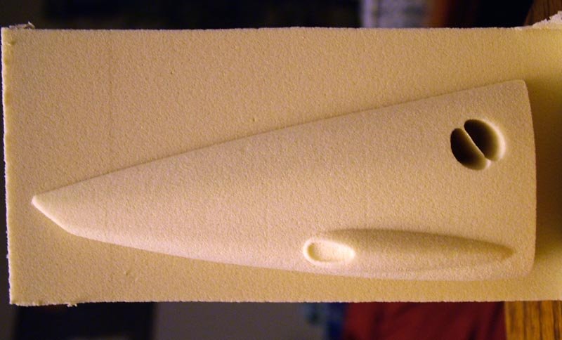

cobywan Posted September 12, 2005 Author Posted September 12, 2005 We got the CNC router going again. I'm cutting a large version of Rodavan's Valk nose with .005" spacing. I can't wait to see how it turns out. Quote

cobywan Posted September 12, 2005 Author Posted September 12, 2005 HWR MKII said: Coby. if all works out well i want to be first on the list Hell lets start the list now he he 327770[/snapback] The nose turned out super sweet. I'll have to take some shots when I get home. Hopefully I'll have time before my sci-fi model club meeting. The modeled scribe lines faintly show up! I don't know if they'll show up in the photo but it's so cool. Quote
HWR MKII Posted September 12, 2005 Posted September 12, 2005 Give it a coat of primer. It will help in the pics. Quote
cobywan Posted September 12, 2005 Author Posted September 12, 2005 I was thinking of that but I wan't to give it a gentle sanding before I do that. Quote

THOR Posted September 16, 2005 Posted September 16, 2005 Coby, It'll be tough using that foam. The foam will suck up the paint, etc. Use machineable plastic like REN or Butterboard. It's way better than the foam, cuts like butta, and won't dull your tools. It's not cheap though... -THOR Quote

cobywan Posted September 16, 2005 Author Posted September 16, 2005 THOR said: Coby, It'll be tough using that foam. The foam will suck up the paint, etc. Use machineable plastic like REN or Butterboard. It's way better than the foam, cuts like butta, and won't dull your tools. It's not cheap though... -THOR 329026[/snapback] Yes, yes. I know already. It would be quite the waste to run tests on Ren before I have the process figured out. The problem with Ren is that the router is having a hard time with the dense foam. And the fact the foam soaks up primer isn't a problem. I sanded that first test smooth already. Quote

Zentrandude Posted September 18, 2005 Posted September 18, 2005 should adjust the thickness of the thruster port on the nose. looks too thin and fragile. other than that its sweet. thinking of making an all brushed alum valk? Quote
Grayson72 Posted September 18, 2005 Posted September 18, 2005 Zentrandude said: should adjust the thickness of the thruster port on the nose. looks too thin and fragile. other than that its sweet. thinking of making an all brushed alum valk? 329418[/snapback] That does look a bit thin, however I don't think those are thruster ports Quote
cobywan Posted September 18, 2005 Author Posted September 18, 2005 Zentrandude said: should adjust the thickness of the thruster port on the nose. looks too thin and fragile. other than that its sweet. thinking of making an all brushed alum valk? 329418[/snapback] That's not what it's supposed to look like. There was a machining error in what I had the software cut. I removed the wall behind the thrustor and the tool went all the way to the bottom of the part. Since the tool was tapered the hole got all wonked out. Quote
Zentrandude Posted September 18, 2005 Posted September 18, 2005 (edited) cobywan said: Zentrandude said: should adjust the thickness of the thruster port on the nose. looks too thin and fragile. other than that its sweet. thinking of making an all brushed alum valk? 329418[/snapback] That's not what it's supposed to look like. There was a machining error in what I had the software cut. I removed the wall behind the thrustor and the tool went all the way to the bottom of the part. Since the tool was tapered the hole got all wonked out. 329526[/snapback] ah so how bout an all brushed or polished alum valk or wait til you make one in secret to amaze us with it? Edited September 18, 2005 by Zentrandude Quote
