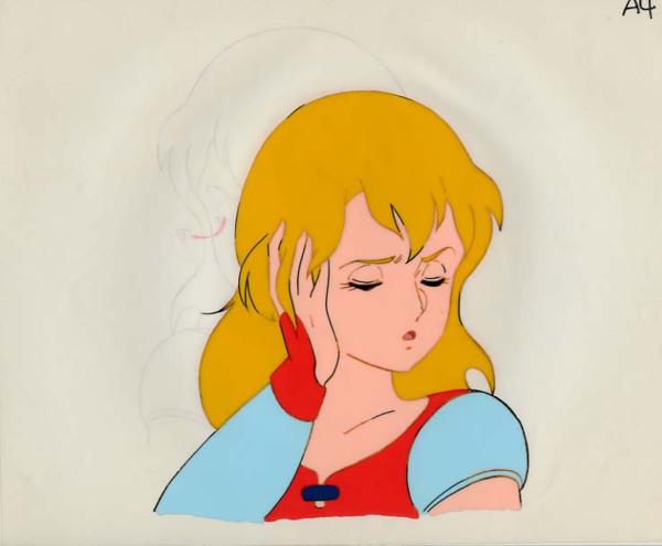

It's kind of sad that when I started collecting cels my only concern was finding cels of my favorite scenes. I didn't even think about condition. Apparently everyone doesn't protect their cels that well. Those framed Akira cels I mentioned look worse than this one of Rook. Actually this Rook cel isn't too bad and it sold this morning. I'm sure it could be restored somehow in the future.

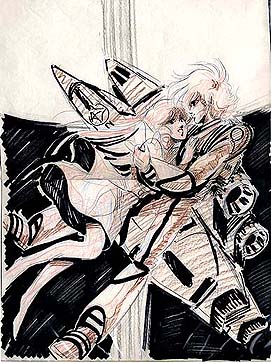

And for the best. It's not a cel but rather two pieces of art. One I saw on a gallery. The other I might have posted the price here before. Good and complete DYRL cels seem really difficult to come across. And as these are one of a kind it makes them really special.

Depends on the translation software used some say it was production cel.  Go figure.
Saw that genga, even if authentic which is doubtful, it is excessively overpriced.  For me the composition isn't worth the cost and it isn't even a sequence.  What do you think?

On 1/26/2017 at 3:04 PM, jvmacross said:
I think it is legit.  However, I agree, it is over-priced.  I think if it was a straight auction with no reserve it would fetch 200-300 USD.
I'd wager if it was an authentic hanken mono it would sale at a higher price.
