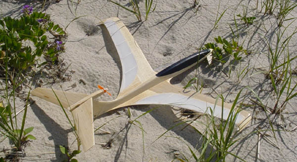

IAD Posted September 18, 2005 Posted September 18, 2005 This is a cross-post from RCG, but pretty much covers all the latest flight-data: Well, got quite a bit of testing in, the canards really get the control to a point where I can LAND without damaging anything. Unfortunately, as a side-effect, they also make the airframe nose-light. (I did remove the reflex in the fins after a couple tests, to zero in on the issue.) On every flight, it basically came down to the same thing: On launch, the nose would go up a bit. Naturally, I'd give a down elevator command. After that, it would fly straight, gaining speed, and the control was perfect (though I'd have to hold the down elevator.) On the first turn, it would balloon up a bit and stop in mid-air. (Classic nose-light behavior.) The thrust-vector would get the nose back down enough to putter in and land. (The fans couldn't get the airframe back up on step in time, after the mid-air stop.) After more than an hour of short hops, the airframe was still in one piece, however. This is a big step forwards, and is testimony to the much-improved control system. Towards the end of testing, one of the motors started making a 'click' sound as it was throttled down to 'off'. Sounded like a blade of grass caught in the fan, but I didn't see anything. The last flight went a bit off-course, and I crashed into a fence, while flying at 75 deg. alpha...(!!!) Thrust-vector + canard + nose-light make for very interesting capabilities, it would seem. Very minor damage, but I decided to stop while I was ahead. So, looks like the profile job may have given me the proper CG location after all. The active canards did the trick, all my control headaches are gone, and aside from the motor noise, things are looking good. Could have been better, but could have been a lot worse, too. More modifications coming up. ~Luke

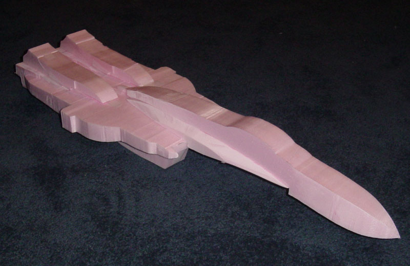

IAD Posted October 11, 2005 Posted October 11, 2005 More work... Starting to loose the blocky look. (Thank goodness!) http://www.rcgroups.com/forums/showpost.ph...8&postcount=312 ~Luke
