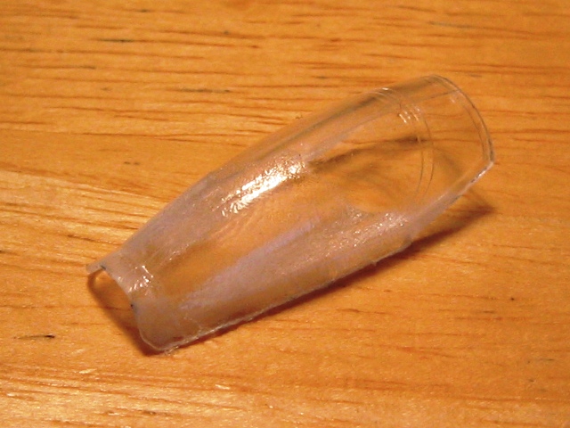

Gabe Q Posted May 26, 2005 Posted May 26, 2005 A little disaster occured. I spilled my Tenax all over my work table. Unfortunately, my canopy for my Hasegawa valk got covered in it. Now my canopy is all foggy and melted along the edges. I don't know if I can salvage it. Any suggestions or advice would be appreciated. Quote
promethuem5 Posted May 26, 2005 Posted May 26, 2005 Wow man, that sucks major ass-age.... I dont know much about it, but depending on how melted the front bit is shape and contour wise, you MIGHT be able to sand it down with multiple grits of sandpaper until you get to a really fine one, and then dip the canopy in Future.... otherwise, it looks like you will either have to get a replacement from somewhere, or do a battle-damaged valk Quote
Gabe Q Posted May 26, 2005 Author Posted May 26, 2005 After some test fitting, I found that the edge of the canopy is warped and does not sit flush against the cockpit. I think my only option now is to find a replacement canopy. I have about ten other unbuilt Hase valk kits I could take a canopy from but, eventually, I'm gonna need a new canopy. Does anybody have one they can spare? I'll make it worth your while. Quote

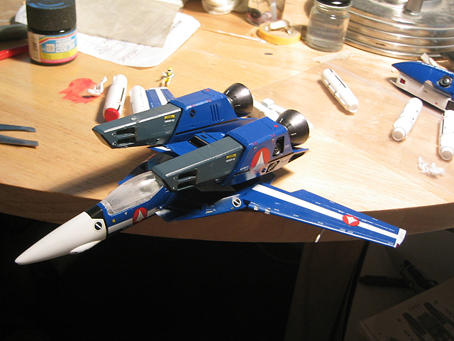

Gabe Q Posted May 27, 2005 Author Posted May 27, 2005 Thanks for the replies. It's nice to know I can turn to you guys for help. Hopefully, I can figure out what to do about a replacement canopy. Anyway, this is what I'm working on right now. It's a Super Jenius. I guess I'll pull a canopy out of another kit in the meantime. Oh well, I'm sure I'll get a replacement one day. Quote
rarityraider Posted May 27, 2005 Posted May 27, 2005 Wow man, that sucks major ass-age.... I dont know much about it, but depending on how melted the front bit is shape and contour wise, you MIGHT be able to sand it down with multiple grits of sandpaper until you get to a really fine one, and then dip the canopy in Future.... otherwise, it looks like you will either have to get a replacement from somewhere, or do a battle-damaged valk Hi Gabe Q, I can give a little suggestion on your problem: After you did the step from "promethuem5" advise, you can use the "Finishing Compound" to re-shine the sanded canpoy, just like removing the parting line on it. Gloss finish can be obtained with super fine level compound. Quote

Stamen0083 Posted May 28, 2005 Posted May 28, 2005 HLJ parts always cost more than they should, really. If you can, go with Rainbowten. That canopy doesn't look too bad. With a little elbow grease, I think it can be salvaged. Sand it down and polish it up. It is going to be discarded anyway, right? So it is worth a try. Quote

Gabe Q Posted May 28, 2005 Author Posted May 28, 2005 That canopy doesn't look too bad. With a little elbow grease, I think it can be salvaged. Sand it down and polish it up. It is going to be discarded anyway, right? So it is worth a try. The canopy became slightly warped. If I do buff it out and get it sparkly clear, it still won't fit right. It's just not the same shape anymore. I suppose I can try it seeing as I have nothing but time on my hands. Quote

Skull-1 Posted April 22, 2007 Posted April 22, 2007 (edited) Here is how you fix a canopy....... - Under running water sand with fine sandpaper in a circular motion. - Work your way to finer and finer sandpaper. - Finish with BRASSO or some form of metal polish (no need for running water here! LOL). - Dip in Future. Edited April 22, 2007 by Skull-1 Quote
VF-19 Posted April 23, 2007 Posted April 23, 2007 Here is how you fix a canopy....... - Under running water sand with fine sandpaper in a circular motion. - Work your way to finer and finer sandpaper. - Finish with BRASSO or some form of metal polish (no need for running water here! LOL). - Dip in Future. Actually, you can skip the brasso, IF, the canopy appears to be clear when submerged in water. When you submerge it in water, you get a preview of what it will look like once you coat it in future. Quote
