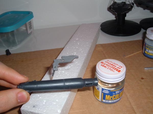

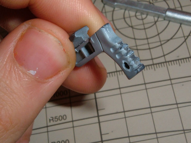

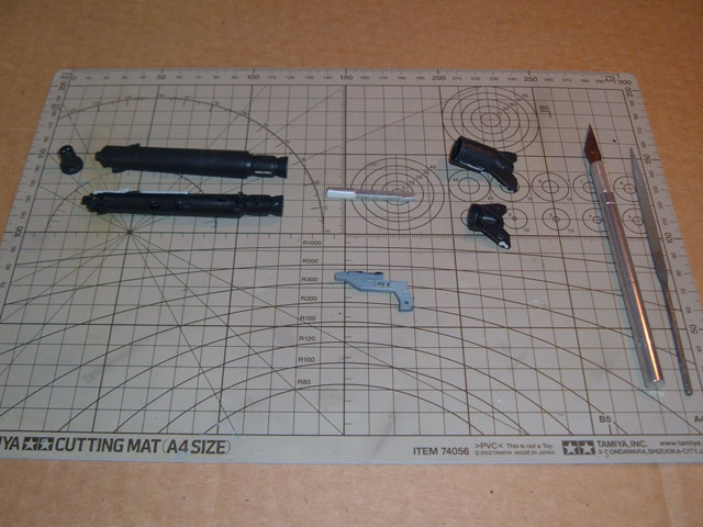

Ido Posted May 21, 2005 Posted May 21, 2005 (edited) I'll start my costumized yammie 1/48 vf-1 gunpod and gunstrap, my obiective is to obtain a nice model like gunpod without seams. What do you need: Airbrush Primer (mr. surfacer 1000) Putty(mr.surfacer 500, tamiya basic putty) Precision screwdriver Sanding paper Some Files hobby knife Paints( I'll us mr.hobby paints by gsi/gunze) Anasazi decals Something for weathering (oil paints, pastels) Here how the dissasembled gunpod its like, I'll start to work on the grip thats already primed and sanded. Edited May 21, 2005 by Ido Quote

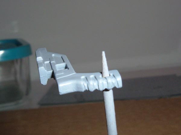

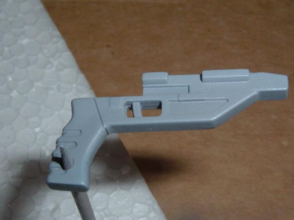

Ido Posted May 21, 2005 Author Posted May 21, 2005 Here the grip, I sanded down the parting line and resculped teh rear details with a file, now I will sand it with 800-1000 abrasive paper and paint it with RLM75 Gray like suggested in the hasegawa directions. Quote
Ido Posted May 21, 2005 Author Posted May 21, 2005 EHm.. forget what I said, before painting it I must cover it completely with the primer, Why? because the gray don't cover the dark spot very wel, the surfcaer will cover it quickly and you'll see a smooth uniform gray surface, I noticed some imperfection that I need to sand, I'll paint in the late evening or tomorrow morning, local time. Quote
promethuem5 Posted May 21, 2005 Posted May 21, 2005 Don't you have to be really careful about the diameter of the hole for mounting on the forarm? if you file it too much it wont stay on.... Cool idea otherwise. Quote

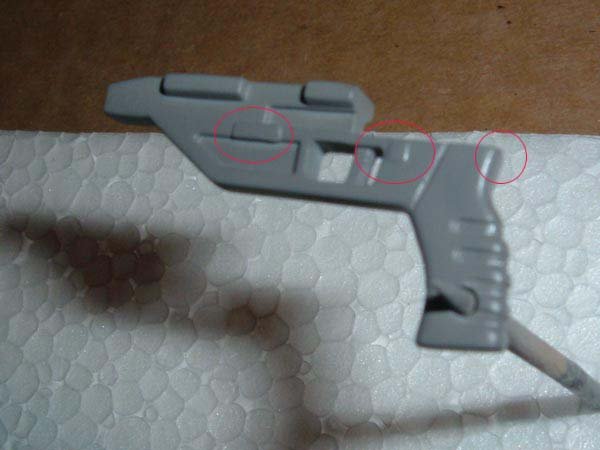

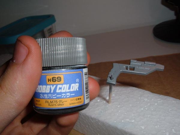

Ido Posted May 21, 2005 Author Posted May 21, 2005 Don't you have to be really careful about the diameter of the hole for mounting on the forarm? if you file it too much it wont stay on.... Cool idea otherwise. Didn't filed it at all, i'm just using it to hold the grip Here the grip painted, it's pretty glossy for a semi-gloss. I'll clear coat it with mr.super clear tomorrow. Quote
promethuem5 Posted May 21, 2005 Posted May 21, 2005 Judging by that pic, I assume your gunpod won't be the dark grey color of the toy one... looks good, my bad for mis-interpreting the pic with the file in the hole... Quote

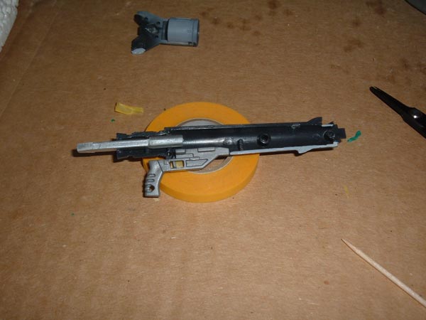

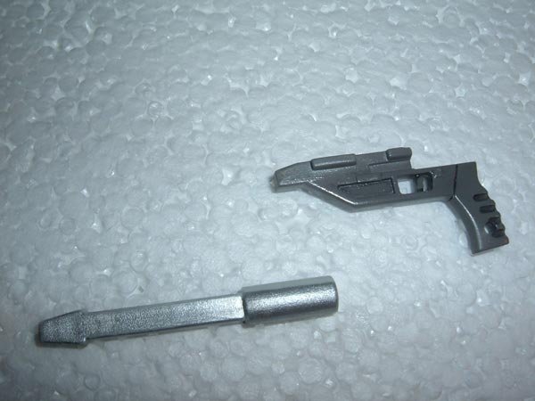

Ido Posted May 23, 2005 Author Posted May 23, 2005 I dont' get really why is so glossy, damn, I'll give a shot of clear flat at this point There is a white piece inside the gunpod that allow the gunpod to extend, i suggest to paint it in some metallic color cause is visible inside. I used a silver color. Quote
Ido Posted May 24, 2005 Author Posted May 24, 2005 The gun grip is finished, so I started to assemble the gun, there is some putty cause I'm closing the ring holes, there is no need of them for my custom gunstrap Quote

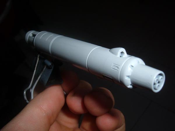

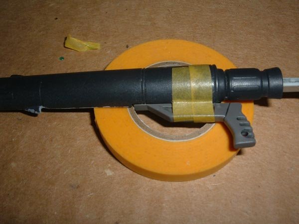

Ido Posted May 24, 2005 Author Posted May 24, 2005 I suggest to fix the grip with some tape for simplify the things. Quote
Ido Posted May 24, 2005 Author Posted May 24, 2005 (edited) I used CA glue and some ca remover to remove the residues, but I discovered that the CA remover can melt the gunpod plastic, so I damaged almost all the surface I fixed the problem by covering the gunpod with mr.surfcaer 1000 and smoothing the surface with a sponge file 1000 grit, I also filled some gaps, perfect. I'm using for the first time mr. dissolved putty, I must say its really nice stuff, it's like melted styrene and shrink much more less then mr. surfacer 500 or tamiya putty. Edited May 24, 2005 by Ido Quote

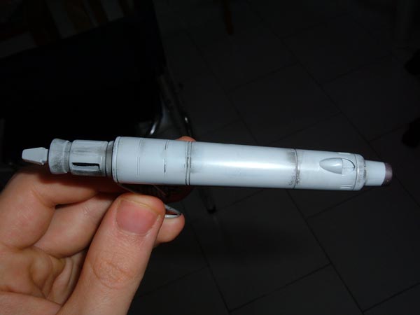

Ido Posted May 27, 2005 Author Posted May 27, 2005 Okay I finished with the putty and the primer, there are some seams near the grip that I couldn't get rid of cause the plastic split a little when the grip fold out, I think that with some pre assembling fix you can fix the problem, however nothing big, i'll hide them in the painting job... I united the panel lines and scribed some rivets on the tip of the gun like in this artwork, they looks cool. Now I'll do some little pre-shading and other things I'll show you later, ah, the tip of the gunpod isn't glued but just snap fitted. Quote

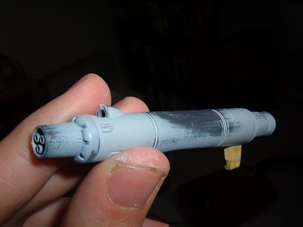

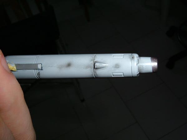

Ido Posted May 28, 2005 Author Posted May 28, 2005 More then pre-shading I should call it pre-weathering , I used flat black acrylic so I can wipe it off is something go wrong. I also painted the very tip of the gun with lacquer burnt iron Quote
