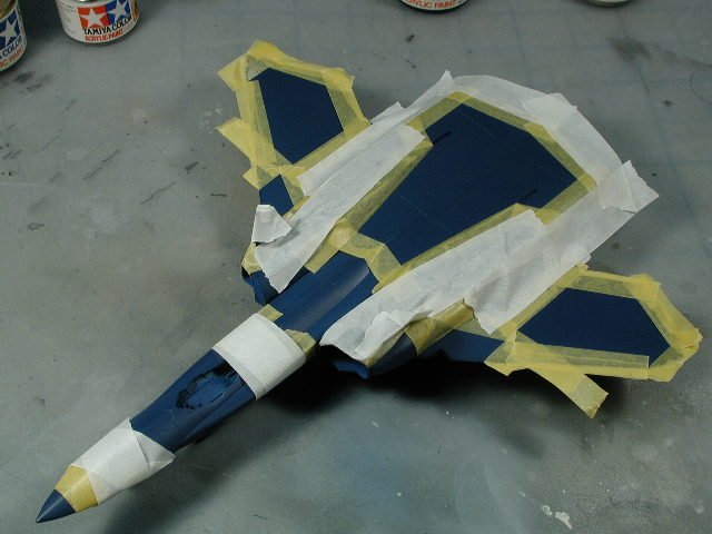

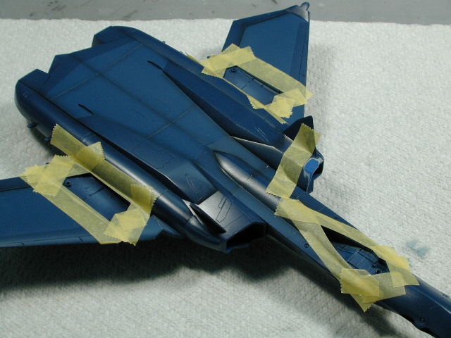

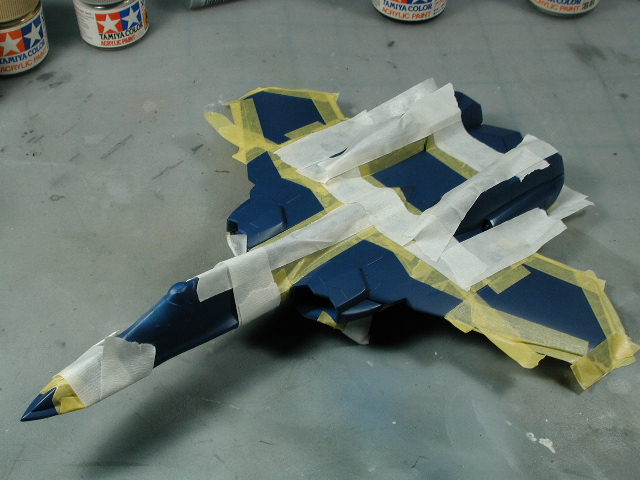

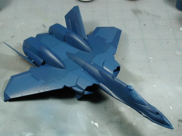

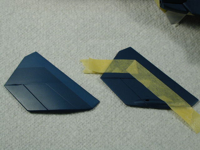

wm cheng Posted September 30, 2003 Author Posted September 30, 2003 And still more masking... I was thinking that I will do a shade lighter and a shade darker - then with three shades, I will vary the finish from semi-gloss to flat, giving me a total of 6 shades in the end I hope. Quote

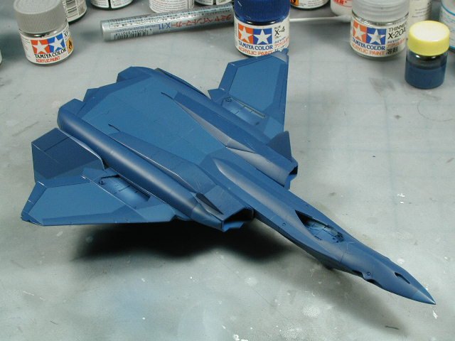

wm cheng Posted October 1, 2003 Author Posted October 1, 2003 Hmm, I think I'll do a colour inbetween the two blues tomorrow instead of a darker one. When I weather it slightly, the different shades will tie together better. Quote

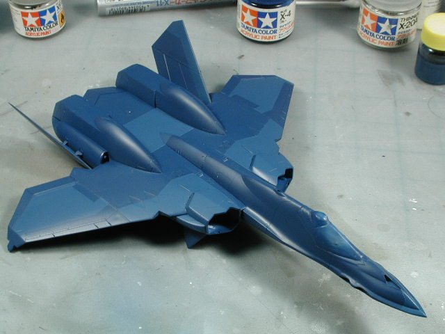

wm cheng Posted October 1, 2003 Author Posted October 1, 2003 Well, the 3rd shade of blue is on there - damned if I can tell Its tough getting something inbetween. What I'll do later is weather around it a bit to pick out the colour separation, and alternate the flat / semi-gloss finish at these areas - it should work out (keeping my fingers crossed). Quote

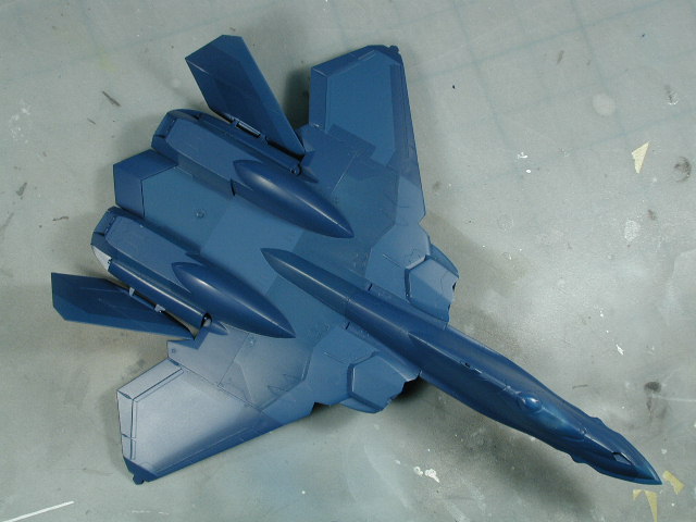

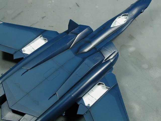

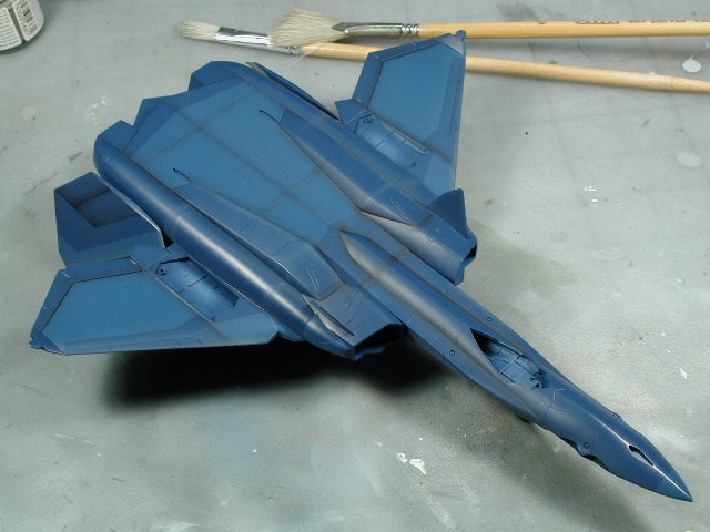

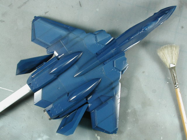

wm cheng Posted October 1, 2003 Author Posted October 1, 2003 (edited) This top view shows off some more of the different panels. I'll give it a few hours to dry and I'll do a clear-coat to protect it before I do a little weathering post-shading. The plan is to do a black shading on the crevices, and a light grey/blue to pick out the highlights and convex surfaces. Edited October 1, 2003 by wm cheng Quote

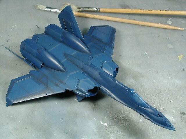

wm cheng Posted October 1, 2003 Author Posted October 1, 2003 Here's a little more life - I know the weathering is a bit heavy, but after the overall gloss coat, it will tone down substantially. Quote

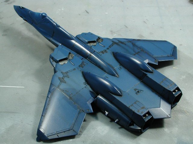

wm cheng Posted October 1, 2003 Author Posted October 1, 2003 Underside ready for the oil wash... Quote

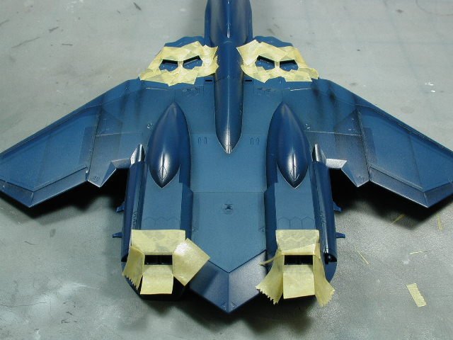

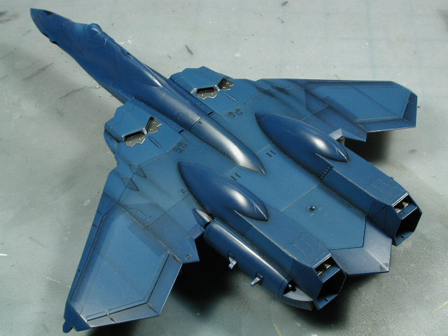

wm cheng Posted October 1, 2003 Author Posted October 1, 2003 Here, after the gloss coat, almost all the lighter weathering has dissappeared. I'll bring them back after I decal this sucker, and selectively airbrush a flat clear coat over where I want a lighter shade to show though. I need to mask off the underside white wheel wells and the little bleed intake vents above as well as the rear little thrusters above the engines. Quote
J A Dare Posted October 2, 2003 Posted October 2, 2003 (edited) Sorry, I just have to see your top view shot compared to your reference material on the same page... DAMN! It's looking REAL good! Edited October 2, 2003 by J A Dare Quote

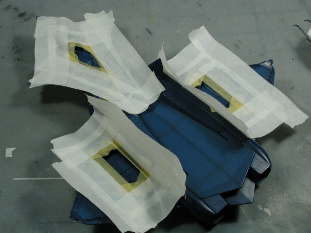

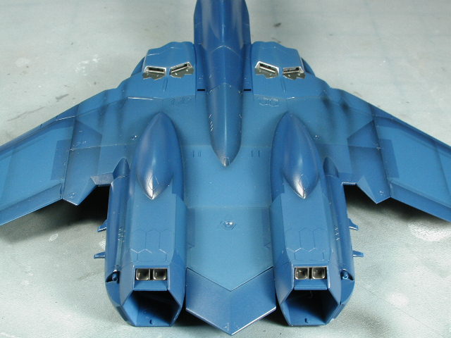

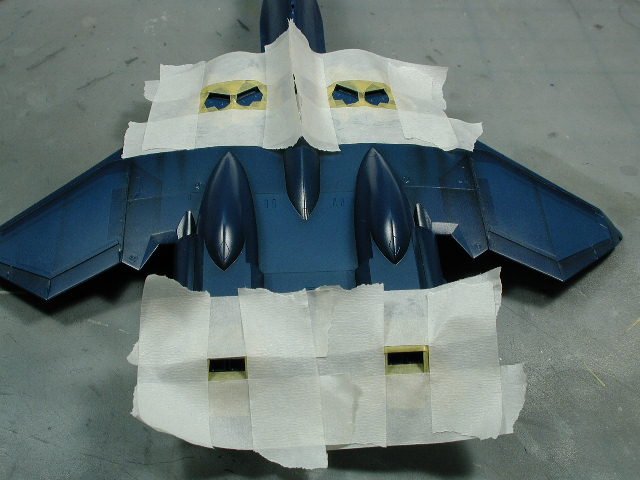

wm cheng Posted October 3, 2003 Author Posted October 3, 2003 Thats not the final gloss finish - I'm not a fan of glossy models either (unless its a car or bike) its just a gloss coat for the decals. I will tone it down to a semi-gloss after the decals with some flat panels. Here's the masking for the bleed intakes and rear thrusters. I decided to mask the little triangular plates behind the intakes as well - I have seen references that have them blue as well as metallic grey. Quote
wm cheng Posted October 3, 2003 Author Posted October 3, 2003 Here's the cheap masking tape around the good stuff to provide more of a barrier in case I over spray too much metallizer. I am spraying AlcladII steel for these areas. You can see that I usually build up lots of little masking pieces for more complicated shapes. Quote
wm cheng Posted October 3, 2003 Author Posted October 3, 2003 Here's the rear thrusters finished. There will still be a wash and a light black burnt dusting to simulate some wear. Quote

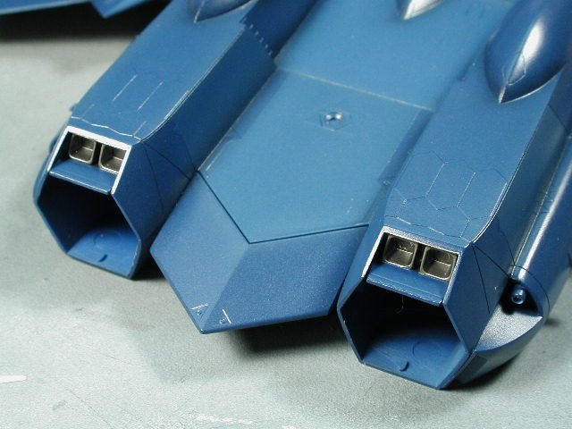

wm cheng Posted October 3, 2003 Author Posted October 3, 2003 This shot shows the intake bleed doors painted Quote

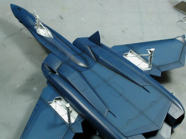

wm cheng Posted October 3, 2003 Author Posted October 3, 2003 The white wheel wells are now to be masked and painted. I thought this would be the easiest way - I wasn't sure. One could always paint the these areas white first, then mask it off to paint the rest of the plane blue, but I tought that masking around the holes would be easier. Quote
wm cheng Posted October 3, 2003 Author Posted October 3, 2003 Again, the cheap stuff to prevent overspray. I still stick the tape to my jeans first to take away some of the tackiness first. I made the area extra large since I would be trying to spray at odd angles trying to get into the crevices of the wheel well. Quote
wm cheng Posted October 3, 2003 Author Posted October 3, 2003 Since its gloss white over a dark base colour, I decide on a really thick mixture. I used 4:1 paint to thinner ratio and bumped up the pressure to 20PSI. The glossiness of the paint works against you when you want to cover up dark undercoats. So I sprayed it on pretty thick - a few passes holded the airbrush far enough away that the paint is almost dry on contact. It looks pretty good, there were some bit of overspray because I was attempting such a heavy coat - I would suggest multiple light coats next time. The little bit of overspray around some of the edges were cleaned up with some windex on a brush - since the previous gloss coat of ModelMaster Acrl protected the blue beneath. Quote
wm cheng Posted October 3, 2003 Author Posted October 3, 2003 One of my favourite parts - the oil wash. I used straight black this time, since it would be pretty hard to see it against the dark blue otherwise. Quote
wm cheng Posted October 3, 2003 Author Posted October 3, 2003 Here's a shot with the gears test fitted into place and the excess oil wash for the underside wiped away. Quote

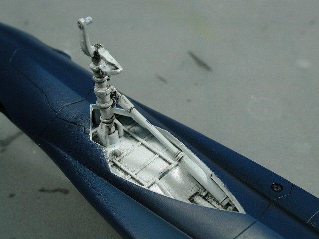

wm cheng Posted October 3, 2003 Author Posted October 3, 2003 Here's a close up shot of the forward gear with the oil wash - I haven't painted the chrome silver of the actuators or shock strut yet. Quote
wm cheng Posted October 3, 2003 Author Posted October 3, 2003 A top view with the excess oil wash wiped off. Quote
