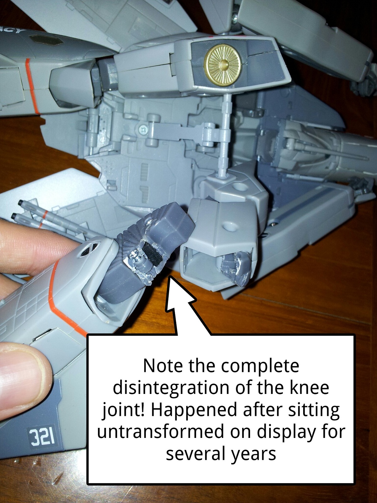

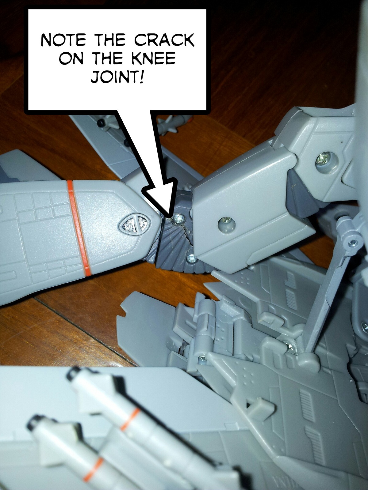

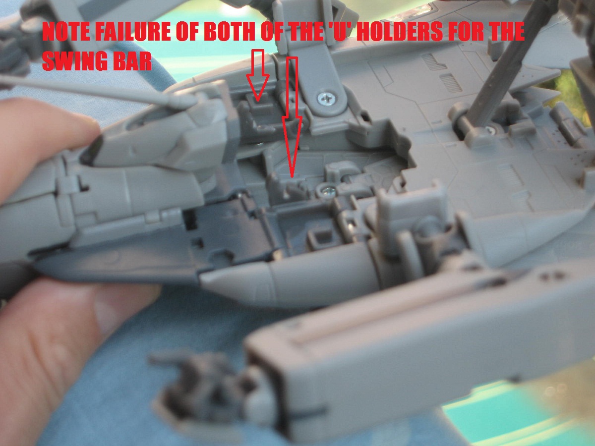

Graham Posted December 11, 2011 Posted December 11, 2011 CATASTROPHIC FAILURE OF VF-0A I have a first issue VF-0A Cannon Fodder that has been on display in my display cabinet in Gerwalk mode since it was first released. It's probably only been transformed 2-3 times before it went on permanent display and has not been touched in several years. The other day, I noticed that it was no longer standing properly and the nose was touching the shelf of the cabinet. I picked up the toy, to attempt to get it standing properly and the left leg suddenly sheared off at the knee joint. Upon closer examination, I noticed the right knee joint was also cracked almost all the way through. I also found that both the plastic "U" clips that hold the metal hip bar had also sheared off while just standing on display in Gerwalk mode. Anyway, see attached pics. Graham
eugimon Posted December 11, 2011 Posted December 11, 2011 yeah... I just had one of my "replacement" arms fall apart at the elbow. POS
MacrossJunkie Posted December 12, 2011 Posted December 12, 2011 Wow. I don't understand how these things are just flat out disintegrating. It's not even like it's under a whole lot of stress. I found one of the "U" clips on my 1/48 Milia VF-1J had also sheared off just like Graham's so I'm not sure if we should expect more failures like that over time or not.
Chronocidal Posted December 12, 2011 Posted December 12, 2011 (edited) Yep, can't say I'm at all surprised. Each of the pieces Graham mentioned were made using the same plastic that was used for the arms, which we all know tends to explode. I got a first issue 0A, and I SOAKED both entire knee joints in superglue. All sections. Then I added a coat to the hip bar clips for good measure. When I got it, the knees were covered in spiderwebs of stress fractures starting to form. You can see the same types of cracks further up the knee joint in that picture. Those were all over both knees on mine. I saw them from the outside, and then opened them up to soak everything in glue. That plastic was BAD. I think it got better with later releases, but something in that batch of releases just did not work. Edited December 12, 2011 by Chronocidal
Ignacio Ocamica Posted December 12, 2011 Posted December 12, 2011 Very bad choice of plastic. Extremely brittle. Checked my two VF-0A's and my VF-0S and they're all fine. Time will tel if they'll suffer the same fate
Shin Densetsu Kai 7.0 Posted December 14, 2011 Posted December 14, 2011 Wow. I don't understand how these things are just flat out disintegrating. It's not even like it's under a whole lot of stress. I found one of the "U" clips on my 1/48 Milia VF-1J had also sheared off just like Graham's so I'm not sure if we should expect more failures like that over time or not. 1st I've heard on the 1/48 man....that sucks!

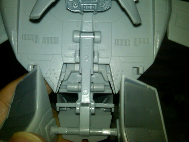

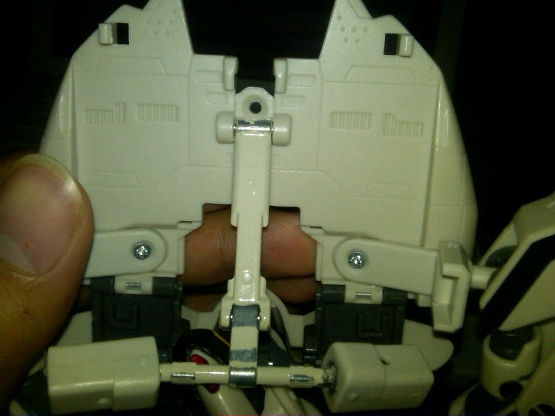

Macross_Fanboy Posted February 5, 2012 Posted February 5, 2012 Ok, now for another VF-0 gripe, this one has to do with my VF-0S though, when I initially got this re-release in 2010 as a reward for my harrowing life or death experience, I attempted one transformation. I couldn't get it because of the swing bar, so I just said eff it and put it back in fighter mode. Now, I want to change up my M0 display and the bar cannot go in no matter how hard I try. It isn't a hard thing to do at all because my CF-0 is lying in a heap in Battroid mode with Nora readying the execution. Anybody else experiencing some kind of warped swing bar? It's a damn shame I live in the States now so I can't send it back to Yamato and sick my wife on them.
mr.chogokin Posted February 5, 2012 Posted February 5, 2012 The vf0s has been known to have very tight plastic pincer grips. Just use a bit more strength to yank the swing bar away and sand the pincers down.
Macross_Fanboy Posted February 6, 2012 Posted February 6, 2012 The vf0s has been known to have very tight plastic pincer grips. Just use a bit more strength to yank the swing bar away and sand the pincers down. No. I took a look at my CF-0A once more and I discovered this!! See? Now look at these last two: See how the number should be facing away from the backplate clamp for Battroid mode? Apparently the sweatshop worker was exhausted when he put my particular VF-0S together. I'm trying to get the bar off and flip it, but it seems like it was set in place and then the plastic piece where the third set screw for the torso/fuselage goes is cemented on or something. Any expert modelers have any recommendations on how I should go about this corrective backbone surgery?
mr.chogokin Posted February 6, 2012 Posted February 6, 2012 ah, I see. This misassemble is also known on the vf0s. In fact, I made the same fix on my friends copy. All you need is a thin screw driver to push away the pin and everything else will be easy to fix.
Macross_Fanboy Posted February 11, 2012 Posted February 11, 2012 ah, I see. This misassemble is also known on the vf0s. In fact, I made the same fix on my friends copy. All you need is a thin screw driver to push away the pin and everything else will be easy to fix. Where exactly? I got a tiny eye glass frame flat tip and it just seems to be damage the plastic piece where the 3rd set screw goes.
Chronocidal Posted February 11, 2012 Posted February 11, 2012 I remember seeing someone with this problem before, and I'm not sure they were ever able to fix it. The way the swing bar is assembled can make it impossible to get out from what I remember them saying. They just couldn't push the pin out to get the bar detached to flip it around. Taking a look at mine.. you have to remove the three screws holding the backplate on. Looks like you've already done that from your photos. What you need to do is find a way to get the swingbar to pop out of the slot it's in on the back side of the lower back plate. This is where I remember another person giving up, because they could not get that pin to pop out of the place it sits. It's in there good, and you might need to chip away at some of the surrounding plastic to let it free. Then you'd need to push the pin out somehow, pull the swingbar back through the hole, flip it around, re-insert the pin, and then put everything back together. What might be easier to do, but I don't know if it would work... you could just flip around the lower segment of the swing bar. The section of the bar that the hips are attached to is offset a little on that lower pivot point, so flipping that over may be all you need to get it to latch into the nose.
