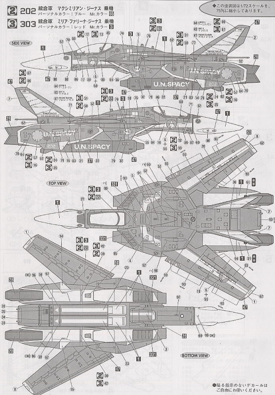

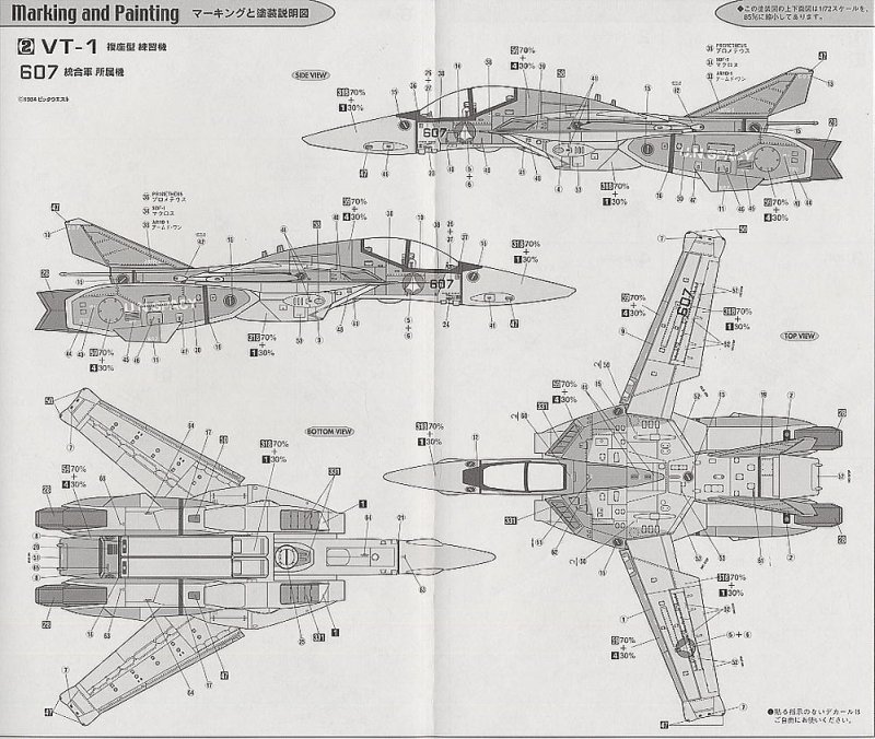

Mechamaniac Posted February 26, 2005 Author Posted February 26, 2005 (edited) That lineart pic definitely needs to be in this thread... And while we won't need new tailfins for the VE or the VT, there will either need to be a new backpack piece, or new metal mounting pins for the Packs since the angle of the packs definitely needs to change on the VE or the VT. Anyone know how to die cast?, Those pieces are probably metal for a reason... Edited February 26, 2005 by Mechamaniac
TheLoneWolf Posted February 26, 2005 Posted February 26, 2005 Interesting, the VT-1 Ostrich tailfin is exactly the same as the regular VF-1?
promethuem5 Posted February 26, 2005 Posted February 26, 2005 Why does the VT-1 Cockpit bubble up so weirdly? Also, why does the VF-1D only have one radar/radio/FLIR? spine (the fin in the back) while all the others have two?
Mechamaniac Posted February 26, 2005 Author Posted February 26, 2005 (edited) Why does the VT-1 Cockpit bubble up so weirdly? Also, why does the VF-1D only have one radar/radio/FLIR? spine (the fin in the back) while all the others have two? The VT and VE cockpits bubble up because the cockpit is stepped, so the RIO seat is elevated from the forward seat.... As to the antennae on the VF-1D, see here... the antenna fins are side by side on the head hatch..... Edited February 26, 2005 by Mechamaniac

kensei Posted February 27, 2005 Posted February 27, 2005 Now I know why Yamato redesigned the tailfins. It's to make the Valk look better in fighter mode with the FAST Packs on. Check out he 1/48 with the tailfins in the position like the VT-1 above. Doesn't look too flash.
Mechamaniac Posted February 27, 2005 Author Posted February 27, 2005 Yes, and therein lies the problem... No matter what the lineart says, look at the Hasegawa pic above, the flat portion of the tail section is parallel with the fuselage. Therefore, either we make new shorter tailfins, or modify the backpack so that the flat portion folds down to lay parallel with the fuselage as shown. Either way, the backpack or fins are gonna have to be modified.
kensei Posted February 27, 2005 Posted February 27, 2005 Yes, and therein lies the problem...No matter what the lineart says, look at the Hasegawa pic above, the flat portion of the tail section is parallel with the fuselage. Therefore, either we make new shorter tailfins, or modify the backpack so that the flat portion folds down to lay parallel with the fuselage as shown. Either way, the backpack or fins are gonna have to be modified. Then again, the VT has a stepped up cockpit, bringing the backpack and the cockpit closer to each other. As for those two being parallel, I think we have to look at the actual model as we don't have a good side profile pic to look at. While the artwork is cool, it's not very good for figuring out our problem.

captain america Posted February 27, 2005 Posted February 27, 2005 Just out of curiosity, how did Hasegawa solve the backpack/V-tail issue on their models? I don't own either, but perhaps they could offer a clue as to how based on the Movie stylesheets, the backpack appears to be in its "normal" horizontal super configuration, but the V-tails still appear to be extended with the tips out on either side of the fighter's spine? I swear sometimes! Kawamori-kun outta learn to *inaudible grumble*
chowyunskinny Posted February 27, 2005 Posted February 27, 2005 It looks like Hasegawa altered the Tailfin shape to accomodate

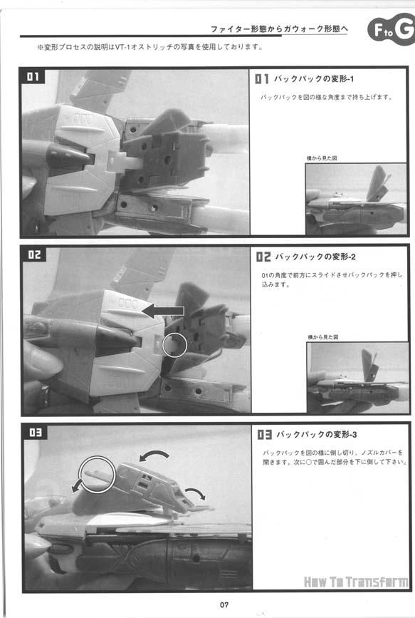

TheLoneWolf Posted March 1, 2005 Posted March 1, 2005 What I'm wondering is how the backpack for the VT-1 and VE-1 will fold up in battroid mode. Don't forget, the tailfins don't fold away like the regular VF-1. So how's the backpack supposed to support the weight of the fastpacks without the backpack folded all the way back? Does anyone here know how the 1/60's managed this? Personally, if push came to shove, I'd have no problem if John fudged it and went the 1/55 route (just fold the wings away like a regular battroid).

do not disturb Posted March 2, 2005 Posted March 2, 2005 What I'm wondering is how the backpack for the VT-1 and VE-1 will fold up in battroid mode. Don't forget, the tailfins don't fold away like the regular VF-1. So how's the backpack supposed to support the weight of the fastpacks without the backpack folded all the way back? Does anyone here know how the 1/60's managed this?Personally, if push came to shove, I'd have no problem if John fudged it and went the 1/55 route (just fold the wings away like a regular battroid). well with the 1/60 design, they had to change the backpack hinge all togther in order for it to hold(w/o froppiness). i don't know how to describe it if you don't own one, but its like the reg. 1/60's, you push the hinge forward, fold the tailfins out, then the backpack itself get pushed down(and clicks) into the hinge and holds fairly tight. does that make sense? back on topic, it seems there more hoops to jump through the further we get into this discussion...as far as the VE and VT are concerned. but i'm a bigger fan of the 1D(and it doesn't have all these issues), so as long as that gets made, i'll be a happy guy. i just hope all these little details for the VE and VT doesn't deter the cap'n from going ahead with the project in the future.

Die, Alien Scum! Posted March 3, 2005 Posted March 3, 2005 Unfortunately, the pics in the Toys section don't really show much. About the best view of the backpack hinge is shown in the instructions. The thin part of the hinge slides up into the backpack a little bit. The regular 1/60 hinge doesn't do this.

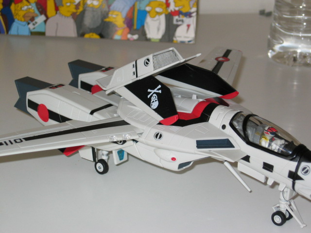

Doctor Paragon Posted March 7, 2005 Posted March 7, 2005 (edited) Here's a pic of the sacrificial lamb VF-1J that's on it's way to Captain America... Everyone wave goodbye! Via con Dios! OK guys, got an update from the Cap'n today...He got the sacrificial 1J, and reports the following... I was looking over the design quickly to see what would need to be modified, and though it will be a TIGHT fit, it looks like it can be done.I only have one concern, and it's a significant one: when the chest armor detaches to pivot foreward and over the canopy, the 1D's lengthened cockpit may cause the whole thing to bind. It won't so much cause a problem for the chest armor, but rather for the heatshield, which, in fighter mode, butts right against the back wall of the cockpit, so the longer cockpit would stick out back almost a quarter inch further, and simply jam the heatshield from coming foreward in battroid mode. Anyhoo, I'm sure that there's a way around this, and it seems to be the only real snag that would prevent this from working. I'll keep you appraised as I continue to tinker with the design. Maybe the excess can fit back into the area below the "back flap" since we would need a new one anyways for the 1D Edited March 7, 2005 by Doctor Paragon
