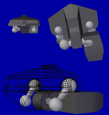

Zentrandude Posted December 22, 2004 Author Posted December 22, 2004 Hmm thanks for the price they usualy cost that will certainly help decide if I should jump in the water or not. Figuring the prices might take me till summer save enough to get ready to build since I will be paying off the bills from xmas, pay Mr.IRS if i have to next year, and normal cost of living. Most likley if I do jump in the waters I'll make just one unit and store the molds in a nice place till I need to make another. That will give me enough time to finish the 3d file. if your curious heres a picture of it but im still finishing the legs and arms and i forgot the radar detail from the previous files. Quote
