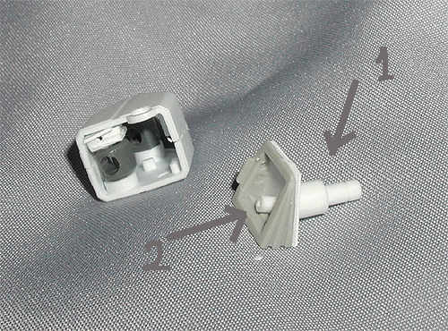

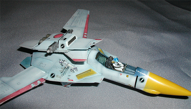

007-vf1 Posted November 22, 2004 Posted November 22, 2004 (edited) UPDATED !!!look bottom for pics ... I been requested a comission job for a couple of Hasegawa gerwalks and I thought it would be nice to show some of the steps I came up with as I indulge on a project of this level for a second time.. Some of you might have seen the Minmay guard I build before where 3 different models were kitbashed to make the Gerwalk a reality. I originally made a complex convertion on the shoulder Joint using a bandai model, the hasegawa fighter and the battroid model models but now I am following the 2002 Hobby japan magazine techniques that actually are not only easier to follow but also mechanicaly sound Edited April 28, 2005 by 007-vf1 Quote

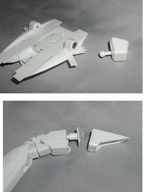

007-vf1 Posted November 22, 2004 Author Posted November 22, 2004 (edited) The pics above are probably the 2 most important pasrts of the whole construction. as you can see i try to use as much as possible on the kits peices that practically discarded during the convertion build up - the shoulder Joint on the Gerwalk are pieces of the hip joint from the battroid. the shoulder socket has been trimmed down to fit a cut on the back of the chest plate right under the wing and close to the wing pivotin point and filled/packed with pieces of styrene to obtain a solid "weld" between both pieces. -the shoulder peg has been glued in after drilling a hole on the upper part of the shoulder which will create a clearance to the wing. The original peg on the battroid shoulder joint had been cut off ( it will eb use later on in the modified gerwalk hip joint) and covered with styrene to create a smooth surface and a thicker wall for the new peg attachment; as you probably will figure out the new peg is the ball joint of the battroid hip. ***** ***** ***** A close up of the intake leg joint ; On this post pic (arrow 1) you can se the cut off battroid shoudler joint that has been attached to the foldable "joint cover" with a pice of styrene. ( arrow 2) I have added extra support by drilling a hole through ( the styrene and the peg) and glueing a piece of styrene rod. Edited November 22, 2004 by 007-vf1 Quote

tetsujin Posted December 21, 2004 Posted December 21, 2004 - the shoulder Joint on the Gerwalk are pieces of the hip joint from the battroid. the shoulder socket has been trimmed down to fit a cut on the back of the chest plate right under the wing and close to the wing pivotin point and filled/packed with pieces of styrene to obtain a solid "weld" between both pieces. I recognized the hip part that you used to mount the arms. Very clever! Quote

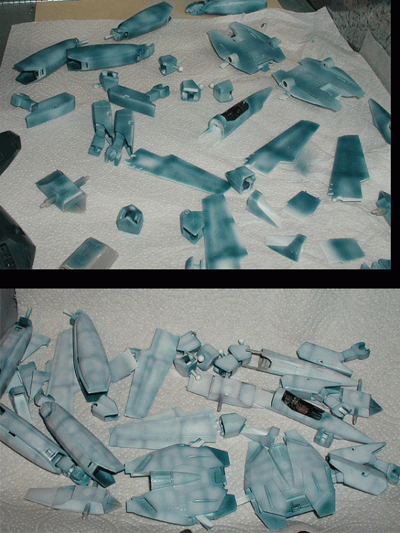

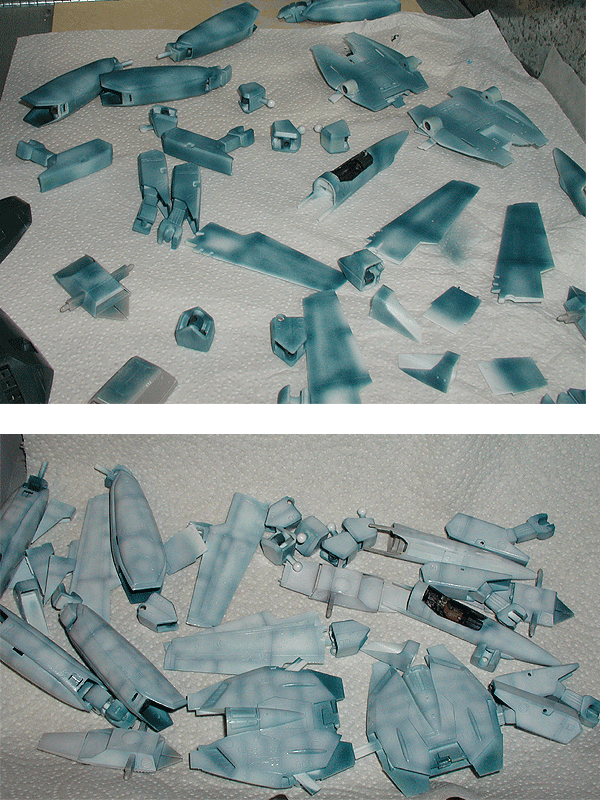

007-vf1 Posted January 3, 2005 Author Posted January 3, 2005 here's an update. the main parts have been painted here's the sequence for the painting process. 1 -base color for panel line shading; dark blue mixed with grey and white 2- second base color for panel highlights; white mixed with medium blue 95/5 ratio Every panel is individually airbrushed, but most times this process is too tedious and overwhelming so I skip details on some panels and blend the panel lines. Quote

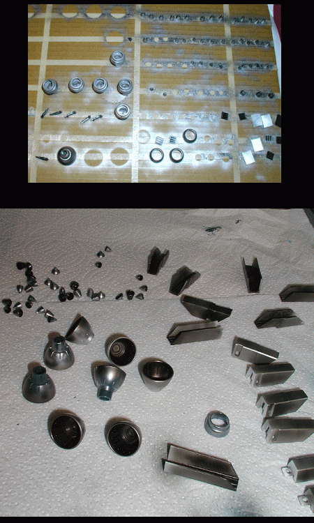

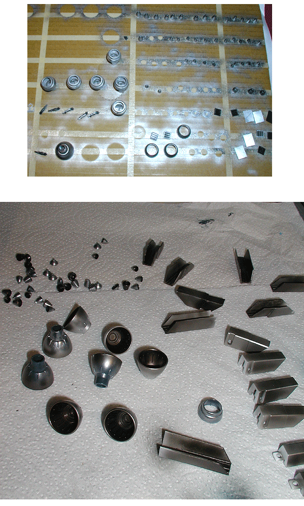

007-vf1 Posted January 3, 2005 Author Posted January 3, 2005 the trusters and verniers are another pain in the butt but a necessary evil. Again; every single nozzle (yes even the tiny ones) are painted in 2 colors the outside of the verniers are painted with alclad polished aluminum and the inside a mix of jet exhaust and copper. The top pic shows the first spray with aluminum. The ones in the bottom are the ones I took from the top pic; about half of the ones I have to paint in total. The difference here is that the very small ones will be painted by hand brush since they are nearly imposible to figure a way to hold them still when airbrushing... Quote

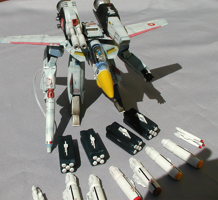

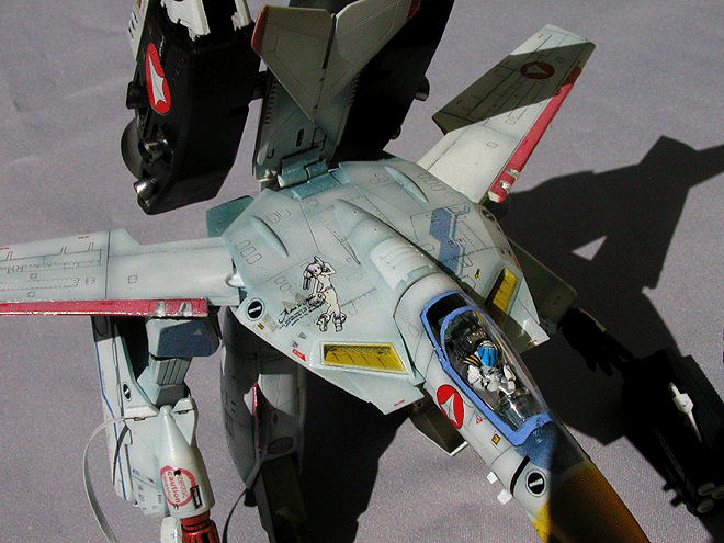

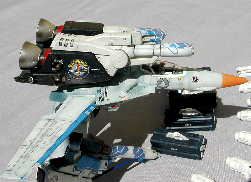

007-vf1 Posted March 25, 2005 Author Posted March 25, 2005 update.. afetr painted and oil washed and detailed here goes some extra stuff that can be thrown into the mix Quote

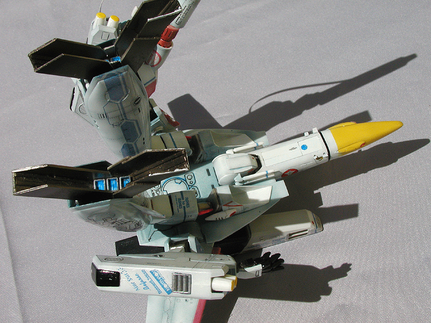

007-vf1 Posted March 25, 2005 Author Posted March 25, 2005 (edited) fuselage details... I am telling you guys you must have heart to do this things...I spent a day and a half just placing decals on this sucker and I have another one to go... Edited April 28, 2005 by 007-vf1 Quote

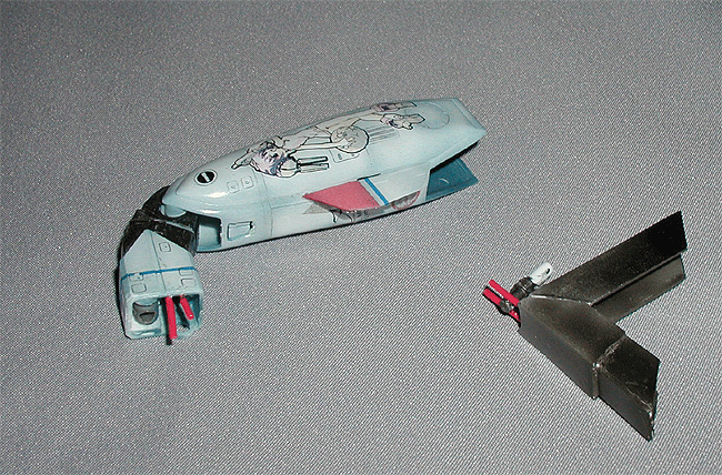

Grayson72 Posted April 28, 2005 Posted April 28, 2005 That's a great build and appreciate you sharing the tips, looks pretty straightforward. One thing I don't get is the large gap between the intake and the rest of the leg? Quote
007-vf1 Posted April 29, 2005 Author Posted April 29, 2005 Oh the gap is not that big once I plug the legs all the way in... besides giving it a pretty unique look and enhance the leg detail it doesn't constraint the movement with the shoulder ball join thus allowing more free movement and poseability.. Quote
