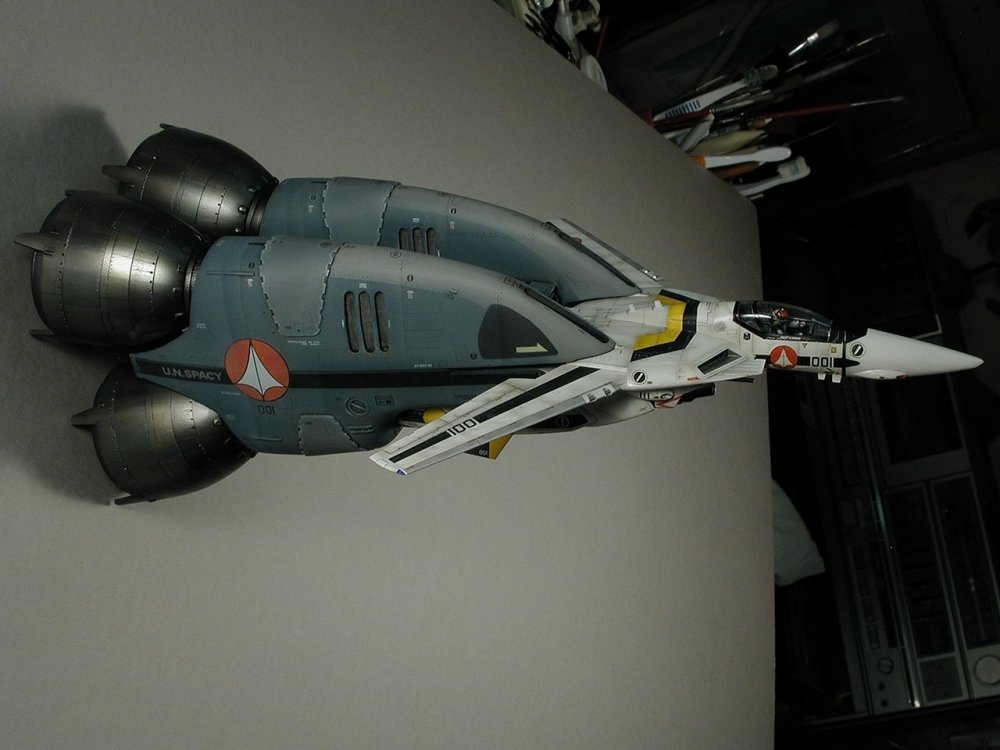

Urzu7 Posted July 18, 2007 Posted July 18, 2007 After the decals had fully dried, I decided to do an oil wash over them to tie in the panel line details over the decals - this is an essential step to make the decals look painted on, part of the model instead of laid over top of your paint. I used white over the dark or black stripes and a medium grey over the lighter areas of the decal such as the UN SPACY lettering or the yellow stripes. hi, Nice work, mr Cheng, I have some questions: 1.-an oil wash over the decals directly? without a layer of clear gloss?. Can I use water colors for the washing? So let this be a lesson to all ya, don't leave anything with a liquid mask on while you take a year break! 2.- How many days do you recommend to leave a liquid mask in the canopy? thanks

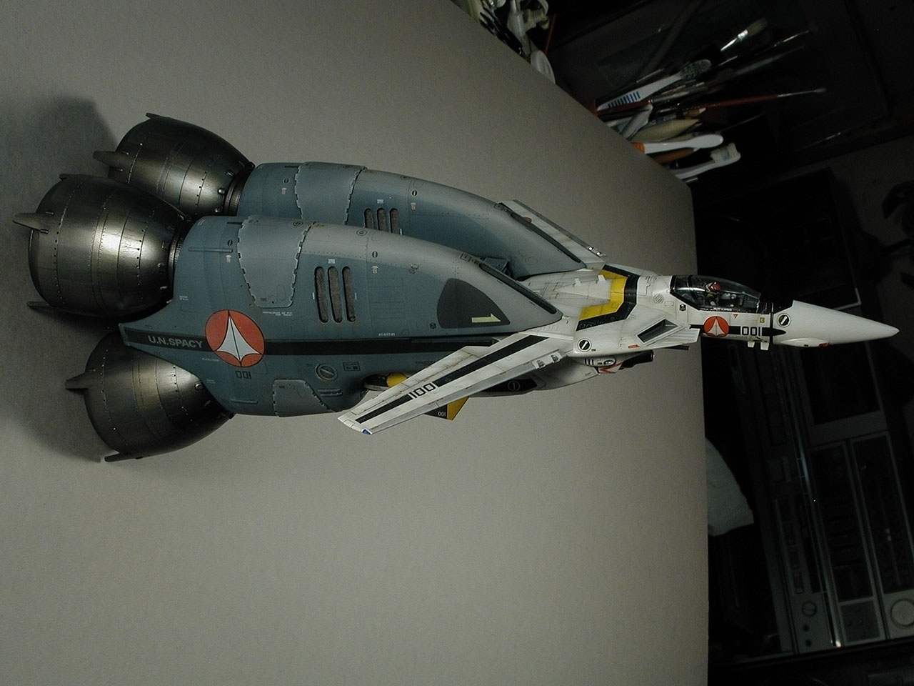

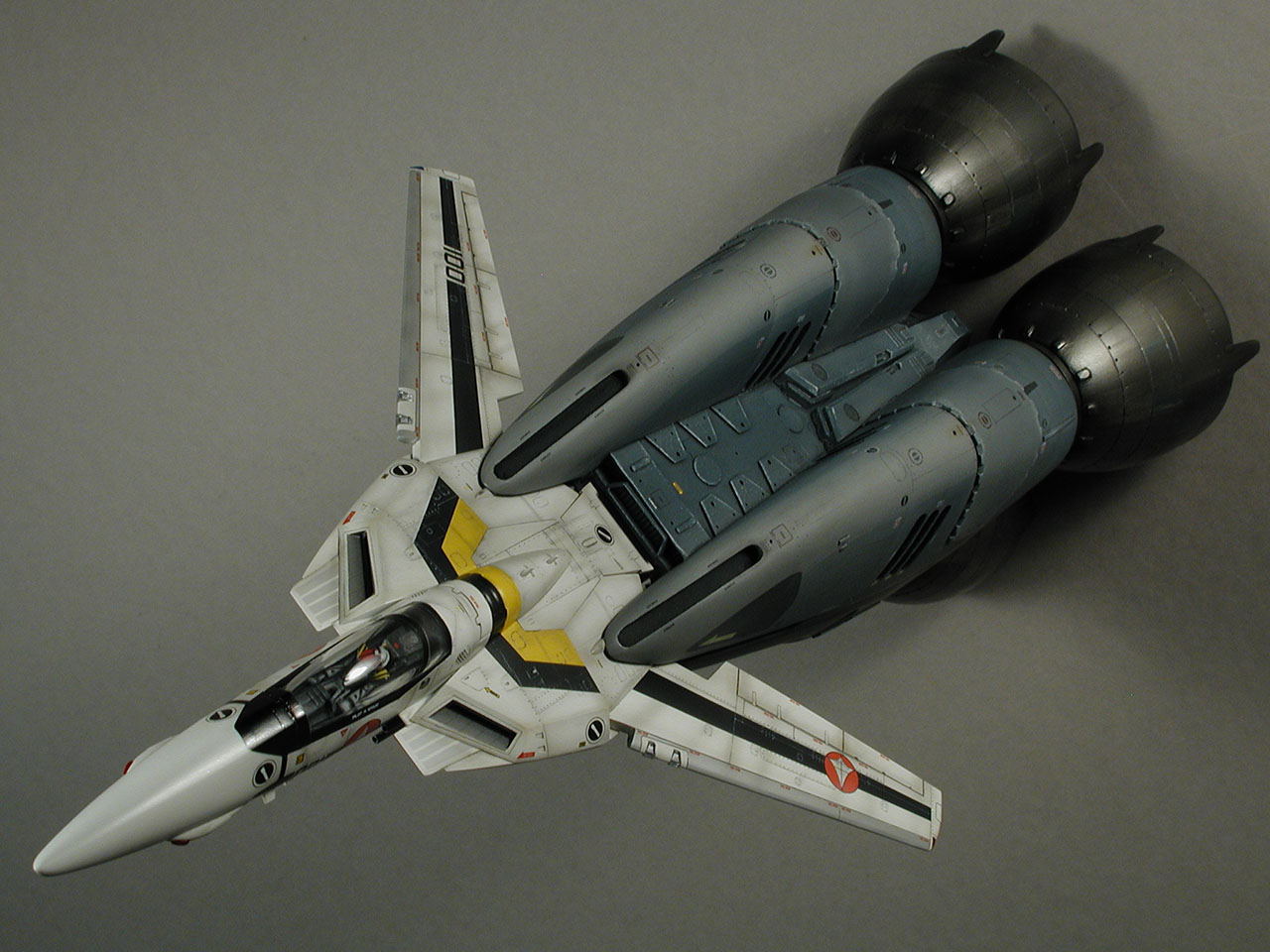

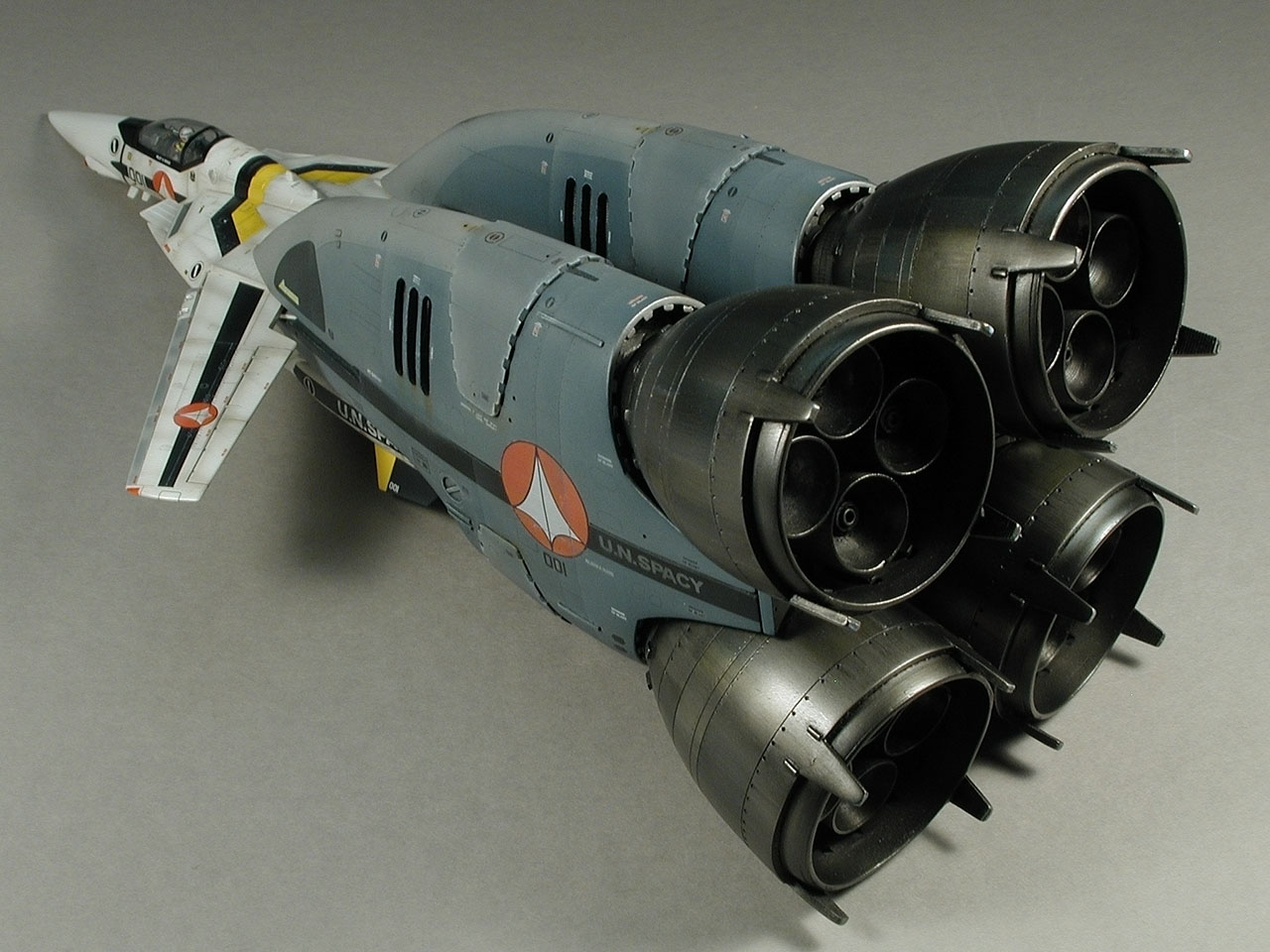

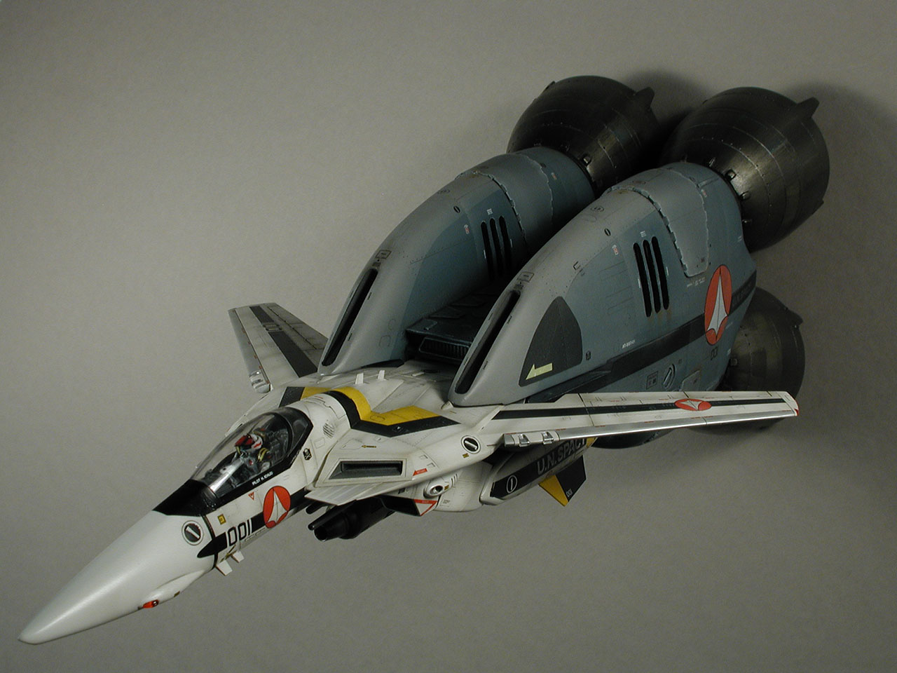

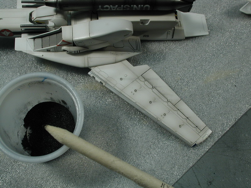

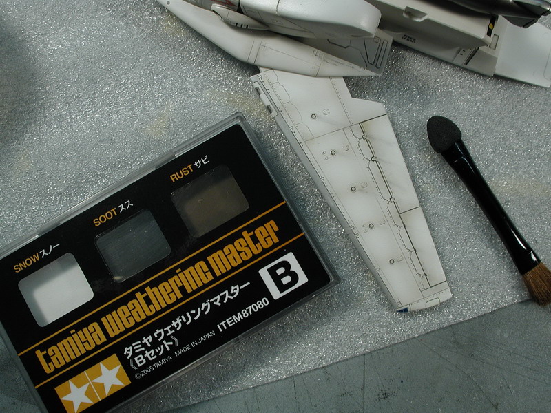

wm cheng Posted July 19, 2007 Author Posted July 19, 2007 Yay! I got to sneak a few hours last night to finish off this puppy! I save my graphite (from the bottom of mechanical pencil sharpener) and its useful to add little streaks here and there. I has have what is called a rub stick or paper blender used in sketching, basically a rolled up paper stick with shaved ends that I use to apply the graphite and literally draw on the streaks where I think they would occur. I can also do a little heavier post shading on panels that would have to be accessed often that accumulates dirt from crew hands too. It's always useful refer to real-world aircraft photos and references for weathering. Note that I start on the bottom surfaces first (although they would receive less weathering than top surfaces - they are less visible) because I always need to warm up to the technique (I always tend to start too dark) and when I get better and more confident, I move up to the more visible parts of the model. The last time I was at a hobby shop, I picked up this Tamiya Weathering kit, its basically a compact make-up kit that allows you to rub pigment in the form of "foundation" cakes. It even comes with a spongy applicator, and its really easy to apply - and really easy to over-do it! Luckily it seems to come off with a little water and some rubbing. In fact I keep a kneadable eraser handy (you can get them from art supply stores) - they're great because you can shape them into anything you need to lift up excess graphite or this tamiya weathering stuff. The goal is to do a general weathering and spot up some areas of heavy movement on the Valkyrie so that it becomes less of a stark white contrast against the darker grey boosters and overall tie both pieces together (and experiment with using the Tamiya Weathering Kit.

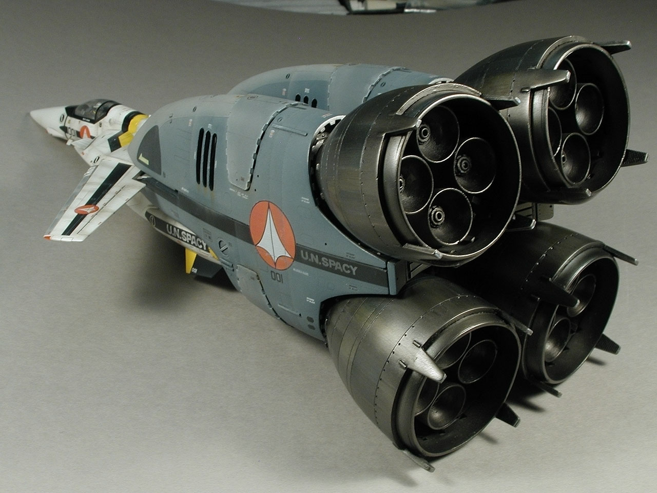

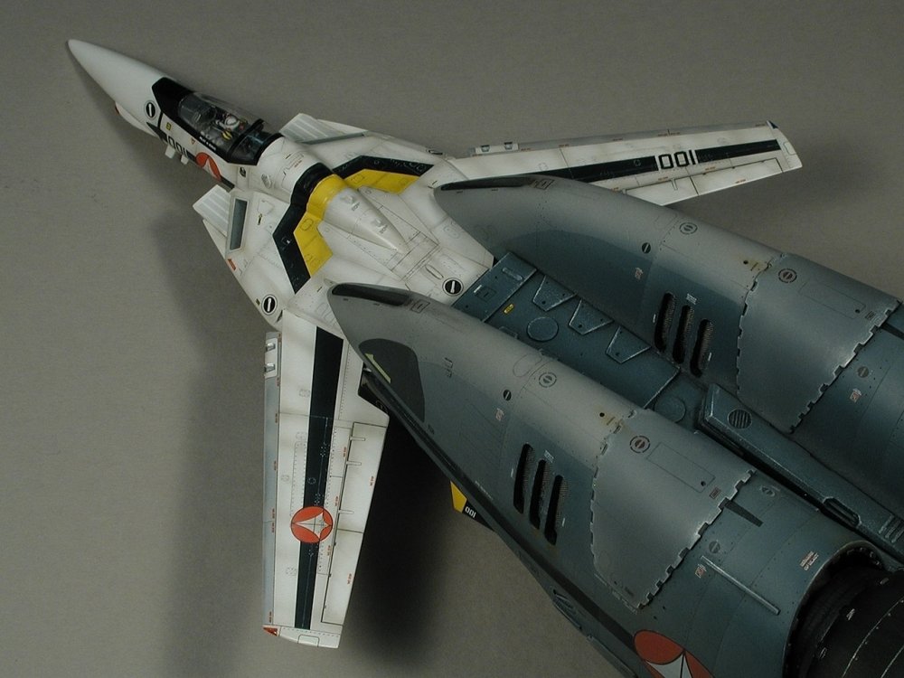

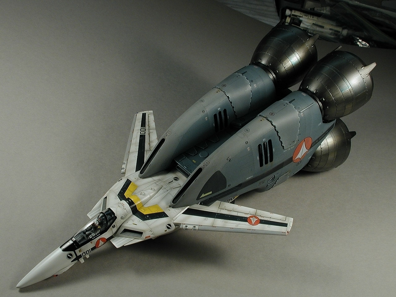

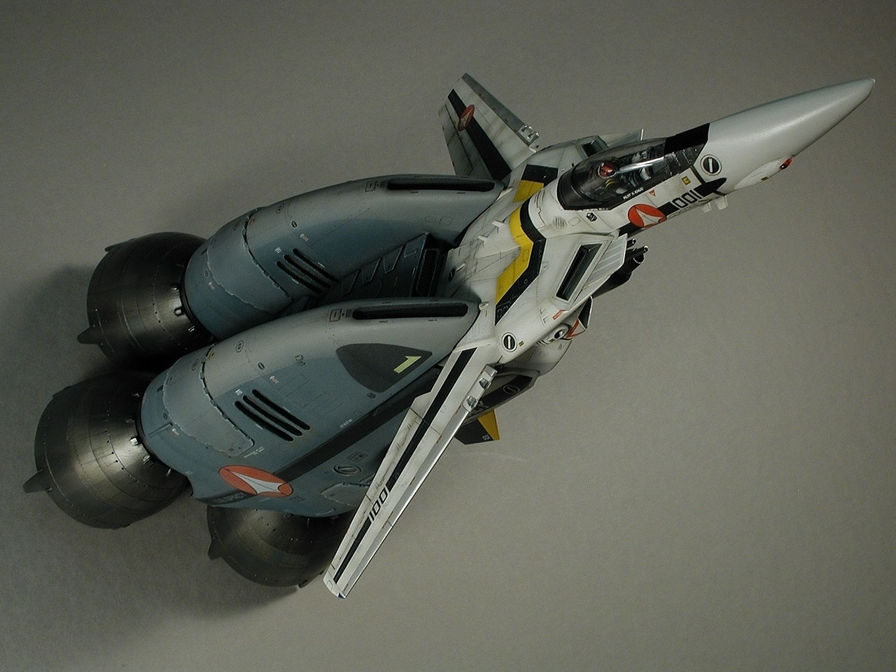

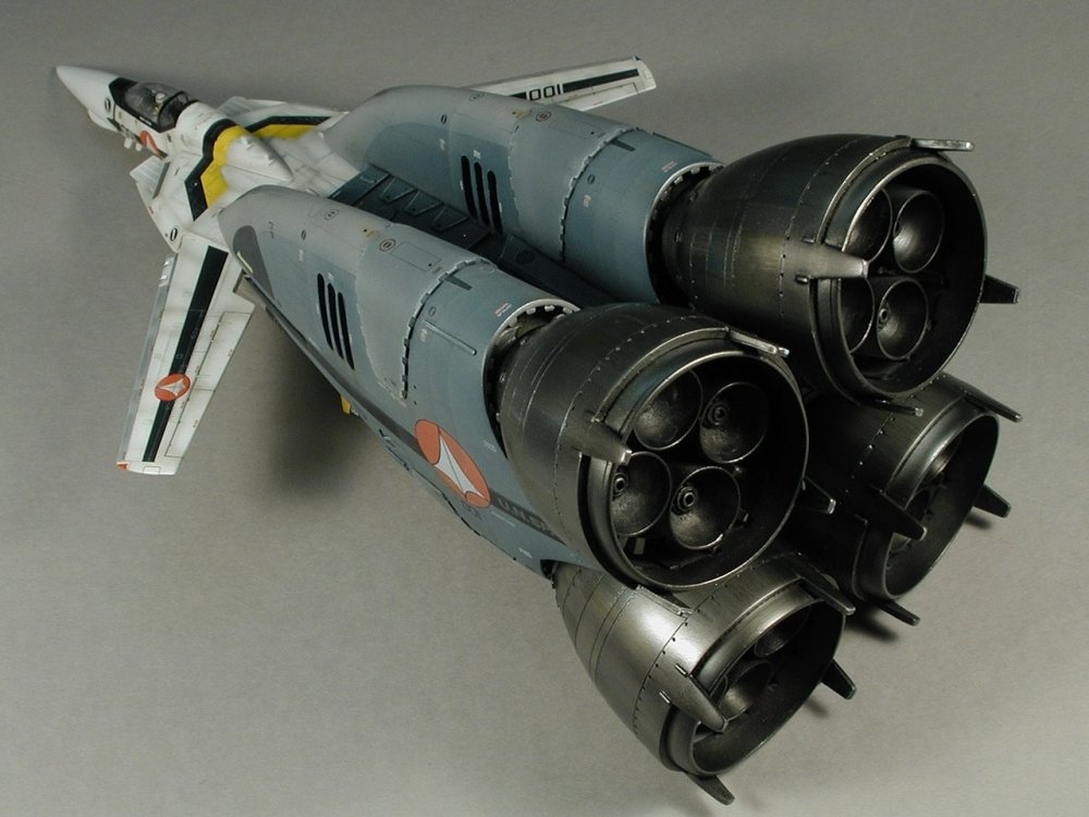

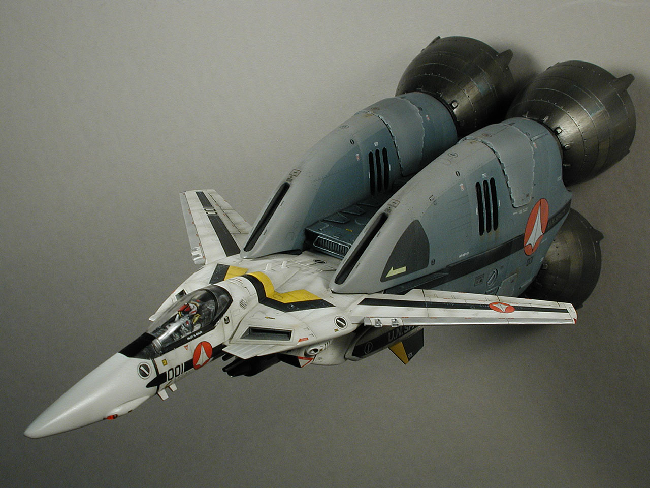

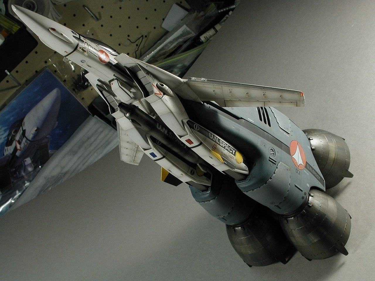

wm cheng Posted July 19, 2007 Author Posted July 19, 2007 Here are some initial shots at a higher resolution - I just threw a grey card behind it on my work bench (so the lighting isn't great - and its only my Nikon990). When we get a sunny day, I'll take it out to get some proper photos of it, probably with the Launch Rail whenever I get that built. Oh, yeah... I glued in all the clear pieces. They were painted with Tamiya Clear Red and Blue while still on the sprue (since the sprue connection points are all hidden when they are glued onto the Valkyrie. Funny, the wing root lights didn't fit as flush as some of the other Valkyries I've had, maybe the molding has deteriorated slightly (this is one of the later kits that combine all 3 versions, VF-1S/A/J). I back the lights with the Tamiya silver chrome marker, so that from the front you see a nice reflective backing behind/under the clear red or blue (plus it hides the glue mark beneath. I used this stuff called "World's Best Canopy Glue" - its basically a kind of white glue that dries cristal clear and somewhat elasticy - I bought it years ago, and its lasted me - good stuff. I use this to glue all my clear parts. I'm pretty happy with the way it turned out now. I love the non-canon colour scheme (I'm a canon guy - but the white was pretty boring - although Brett did an amazing job on it!) - which is based on my colour scheme for the other super Valkyrie's fast packs. It was intended to sit on the same shelf with the other Valks, so the Booster will be at home right there! Thanks for joining in... I'm so glad to finish this finally! It was so sad sitting on my bench for so long - I hope I get some more time soon to start and finish the Captn' amazing Launch Rail to properly display this bird. Come on! I want to see more Boosters out there.
Dante74 Posted July 19, 2007 Posted July 19, 2007 I have a noob question. If I wanted to use that Tamiya weathering stuff on a toy, would I need to spray a clearcoat over it to protect it?
Noyhauser Posted July 19, 2007 Posted July 19, 2007 I have a noob question. If I wanted to use that Tamiya weathering stuff on a toy, would I need to spray a clearcoat over it to protect it? No and yes. By itself, it comes off with water, but I don't know how good the contrast would look with just the regular toy paintjob underneath.
big F Posted July 19, 2007 Posted July 19, 2007 (edited) No and yes. By itself, it comes off with water, but I don't know how good the contrast would look with just the regular toy paintjob underneath. I just tried it on a Cybertronian Jetfire and it works well. It does need to be rubbed in slightly but I tend to do this anyhow so NP. Im sure for general play use it would eventually come off. so I would suggest a coating of Future or a Proper mat Varnish. Edited July 19, 2007 by big F
Dante74 Posted July 19, 2007 Posted July 19, 2007 So if I applied the weathering stuff and only occasionally handled it to transform it, lets say twice a year, i'd be fine? Up to now, I used a gundam marker and smeared it a bit, but it doesn't look good enough.

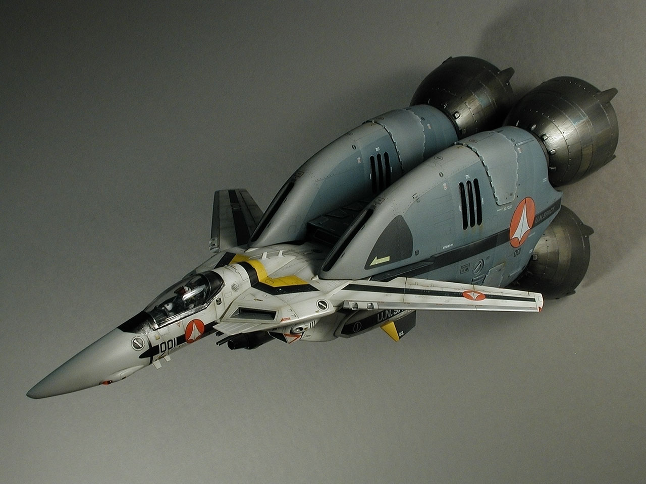

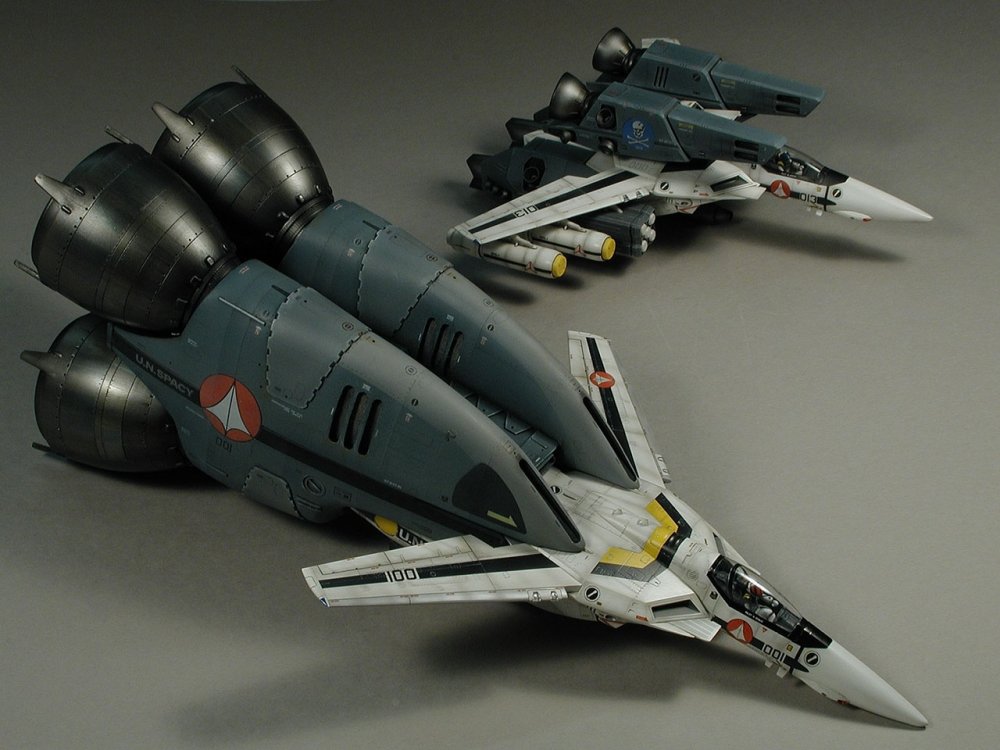

PetarB Posted July 19, 2007 Posted July 19, 2007 Okay, so that final shot, with the other Valk and it's fast pac boosters, those two together look amazing. Simply amazing. Very very inspiring work. Having said this, Im going to have to put mine on hold for a bit, since there is a more personal project I simply must finish before 'rewarding' myself by moving on to other things. Stay tuned. And WMCheng, thank you so much for all your effort in recording this extraordinary build-up. We are lucky to have people like you on this forum.
big F Posted July 20, 2007 Posted July 20, 2007 So if I applied the weathering stuff and only occasionally handled it to transform it, lets say twice a year, i'd be fine? Up to now, I used a gundam marker and smeared it a bit, but it doesn't look good enough. Well the bit of Tamiya Rust I ( same as WM) put on using the blusher stick Tamiya supply with the set, It has stayed on real well even though I have deliberately rubbed it and didnt really bother to put it on that well in the first place. I havve not even bothered to Future it so its all "Ou Naturel". It stays in the knooks and crannies well and just makes it look a bit dirty and used. When I finish it thats the sort of look im going for. This after all a good sculpt toy of a robot that fights other robots and flies around at mach 5 or whatever. Worn out and abused it should be, not showroom fresh.
