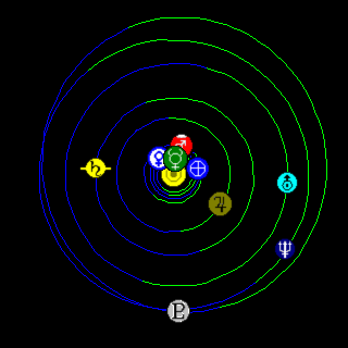

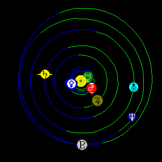

ewilen Posted September 16, 2003 Posted September 16, 2003 Hm. We can calculate where the planets will be at the time of SDF Macross. I'd be surprised if it turns out that they'll be lined up in such a way as to make efficient "way stations" on the road home to earth. This is useful: http://www.fourmilab.ch/cgi-bin/uncgi/Solar We don't know exactly where the SDF-1 folds to at the beginning of its journey--somewhere around the orbit of Pluto, I believe, but not necessarily near Pluto's current position at the time. We do know the SDF-1 flies by Saturn on April 3, 2009, lands on Mars at beginning of October, 2009, and reaches Earth around mid-November. (All this from http://macross.anime.net/story/chronology/...2009/index.html ) Here are the planets' positions at those times, based on the web-based calculator above. First, April 3, 2009: Quote

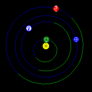

ewilen Posted September 16, 2003 Posted September 16, 2003 October 5, 2009 (just the inner planets): Quote
ewilen Posted September 16, 2003 Posted September 16, 2003 November 15, 2009 (just the inner planets): Quote
ewilen Posted September 16, 2003 Posted September 16, 2003 Since Saturn is the only giant planet on the "left" side of the solar system at the time, it seems likely to me that the SDF-1's trajectory would start somewhere to the left of Saturn, curve around that planet, and then head more or less straight/clockwise toward Mars's October 5 position. After taking off from Mars, SDF-1 would continue clockwise to Earth. In order to meet the other gas giants as well as Saturn, SDF-1 would have to follow a very long, spiralling, counterclockwise trajectory. Quote

ewilen Posted September 16, 2003 Posted September 16, 2003 (edited) Another possibility would be to follow a counterclockwise trajectory from Saturn past Jupiter to Mars. This would give them one more gas giant to suck up some reaction mass, and I'm guessing it would be easier to enter into Mars orbit if you're approaching the planet from "behind". Edit: but if they took this route, they might as well have gone straight to Earth from Jupiter. Edited September 16, 2003 by ewilen Quote
