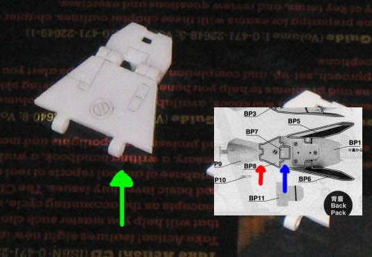

do not disturb Posted October 28, 2004 Posted October 28, 2004 (edited) well here the makeshift instructions from the first page.... to start, remove the pin with a pair of plyers using twist and turn method. shoot how do i explain this? the BP8 has two tabs where the pin would go through right? placed the pin in by itself and twist and turn the pin. i did this cause the holes for the pins on the BP8 are tight, and "teeth marks" made by the plyers on the pin will sort of sand the resin inside the holes to make it go in a little easier. does that make sense? i did the same for the middle part(dunno what to call it) that the pin would go through as well. once thats done, try and sand the pin a little to get rid of the marks from the plyers(causes friction) to make it go in easier. i used some diamond coated sandpaper since regular sandpaper ain't doing jack to metal. smooth it out til all the plyer marks are gone and take a little extra off for good measure. if you did everything correctly, the pin should go in fairly easily but you might have to bang it in with a hammer or some blunt object. to answer your question, no the pin is not glued into part# BP7, its just a really tight fit. the above is the way i went about it and mine was stuck like a mofo. heres a pic...i did this in seconds, so don't make fun of me. the blue arrow is pointing to BP7, thats the pain in the ass pin to remove. the red arrow is pointing to the secondary pin, this one slides right out and its a different size so don't mix them up. the green arrow is pointing to the part that probably snapped on the valk. this its a tight fit there as well as a tight fit in the BP7. you gotta twist and turn like a mofo to get that pin out of BP7. its a total bitch and it might feel like you're gonna breaking it but it wil eventually come out. once out, it'll have the plyer marks from all the twisting and turning. use the pin itself to ream/sand the holes(highlighted in green)out a bit and repeat the process for the BP7. you might want to use some kind of lubricate, maybe that hari spray or some KY jelly(you got a girl )once the piece goes into each part fairly smoothly, then reassemble it and you'll be good to go. well i think thats it. i don't know how else to describe it without making an instruction video on "how to". hope that helps Edited October 28, 2004 by haterist Quote

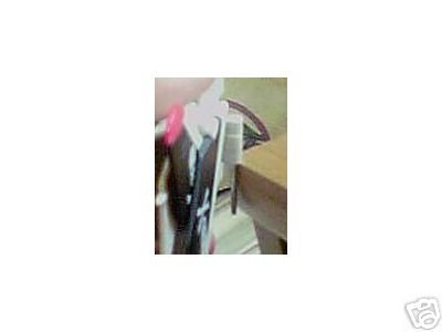

goldenboy_forever Posted October 28, 2004 Posted October 28, 2004 (edited) Actually the pin isn't stuck in the bp8 but in the back pack hinge Bp7 The easiest way I just removed it was step 1: you need a hammer, a sharp table edge, a sewing needle, and a helper step 2: hold the bp7 over the edge of the table but let the metal pin hang between the Bp7 and the edge of the table. step 3: While holding the bp7 with you left hand over the sharpe edge of a table hit the pin with the hammer in your right hand. This makes most the pin hang out on one side of the Bp7. So basicly the table provides a upward force on the bp7 and the the hammer will provide a down ward force for the pin step 4: Now use the left hand to hold the Bp7 over the sharp edge of a table and use the right hand to hold the sewing needel above the metal pin. Step 5: Tell the helper to lightly hammer the sewing needle that you are holding over the metal pin in the Bp7. Hammering the sewing needle will drive the rest of the metal pin through Bp7 hole. Make sure the helper puts his or her left hand under the pin so the helper can catch it when it fall out. This took not even 1 minute to do. This way there will be no teeth marks trying to remove it with pliers From Rich Edited October 28, 2004 by goldenboy_forever Quote
do not disturb Posted October 28, 2004 Posted October 28, 2004 Actually the pin isn't stuck in the bp8 but in the back pack hinge Bp7 thats what i said man, i even put it in bold BP7. if you got someone else there to help you, it'll definitely make things easier but i'm single and i live.... allllll by mysellllllfffff. Quote
goldenboy_forever Posted October 28, 2004 Posted October 28, 2004 (edited) ah so sorry bro bye the time I was done typing the previous post you type the bp7 before I saw your post. your right I tried the pliers but It was to slippery and I didn't want to leave teeth marks on the metal rod. Thanks a bunch From Rich Edited October 28, 2004 by goldenboy_forever Quote
do not disturb Posted October 28, 2004 Posted October 28, 2004 no problemo, now what the heck is that a pic of??? Quote
goldenboy_forever Posted October 29, 2004 Posted October 29, 2004 Haha let me explain thats actually the Bp7 on the left of the pick and thats little metal pin at the bottom middle and the desk at the right. See how I place the Bp7 on the desk so the metal pin will slide out when hit the hammer then the sewing need will drive the rest out. Ment to put the pic with the previouse explanation. From rich Quote
