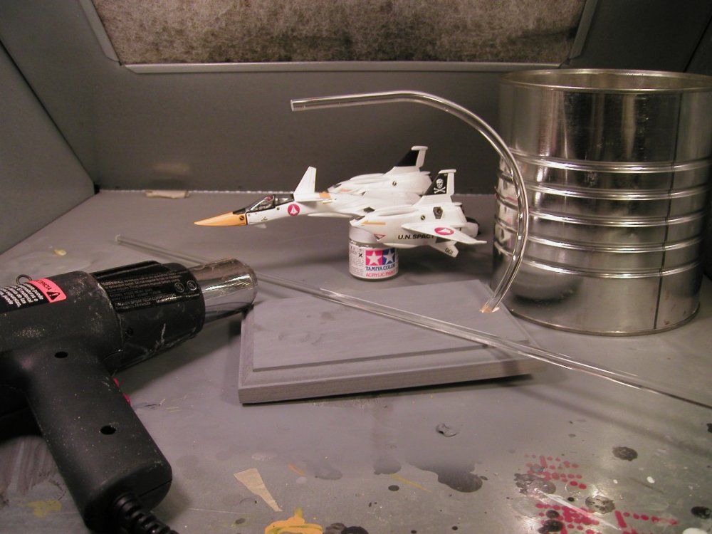

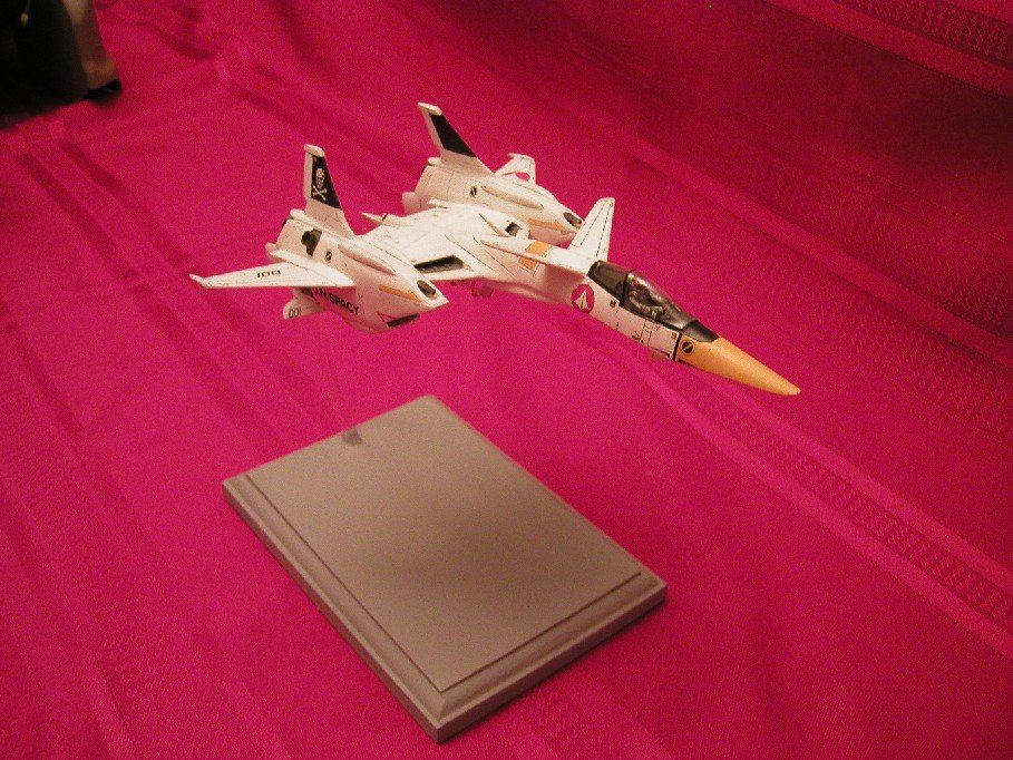

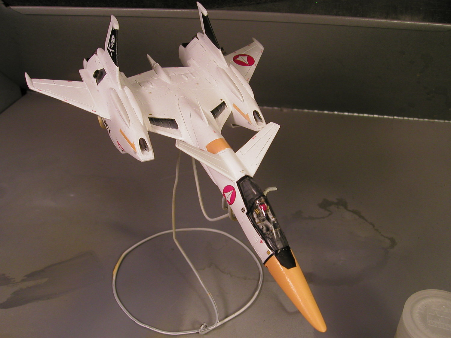

Thanks guys for all the encouragement. Especially you WM CHeng... you are really the inspiration for me getting back into the hobby. On to my next project... my half finished yukikaze super sylph from Bandai. As for the stand, it couldn't have been easier to build. As I said before bending the acrylic rod was super easy with a coffee can, heat gun, and a pair of gloves. As for the stand. I just drilled a hole at an angle into the base. As for the attachment to the VF-4, all I did was drill two little holes in the acyrlic rods and the plane. Then I superglued two nails that I sawed in half into the base. Turned out great... you can barely see the attachment points underneath and you can take the plane off the stand fairly easily. I'd love to put the Macross Kite on the stand, but I have NO idea how to accomplish that so it looks nice. I imagine I'll just paint it black (in the words of mick jagger). Happy modeling all. -

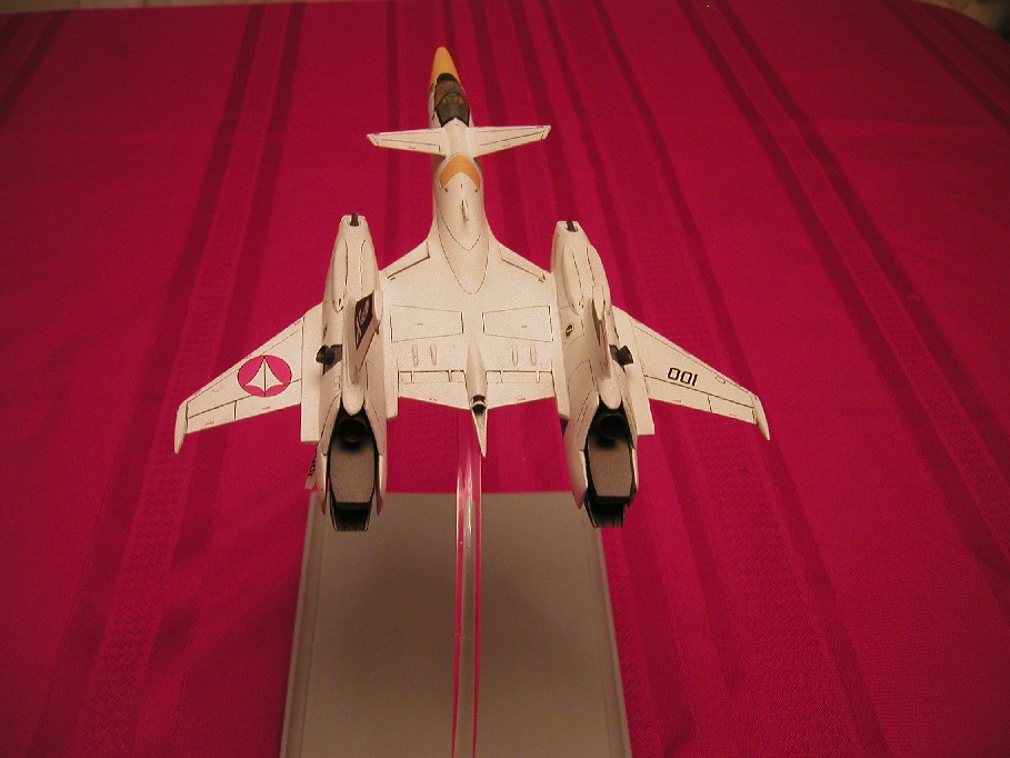

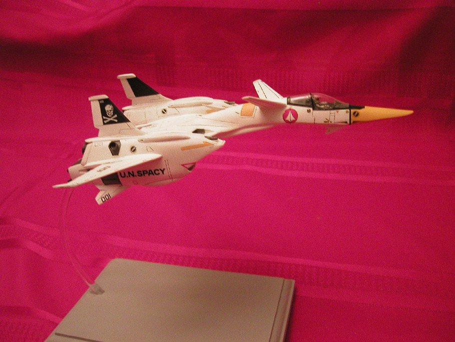

Ok folks... I think I'm done for now. I'm actually pretty pleased for my first resin model, but its clear that I have ALOT to learn about modeling. I'm still frightened to do anything except an oil wash in terms of weathering. My airbrush skills keep letting me down every time I try pre shading or post shading. I think adding those touches would really make it nice. I over sanded, over glued, over scribed, over everything, so it looks really choppy in parts. I think alot of that has to do with a lack of patience. I only have opportunities to model for about 30 minutes at a time, so I think I rush through the steps to quickly. I really like the base and the stand. I need to paint the base (as you can see it only has primer on it now. I can't wait to do more In-flight models like this. I have sooooo many acrylic rods now that it should last me for a lifetime. I should have thought about the decals before I started the model. As you can see they are a hodge podge of scraps from old Hasegawa models. By the way... if any of you are interested in this resin kit... Valkyrie has some available for sale. I think he is charging $50, if I'm not mistaken. -

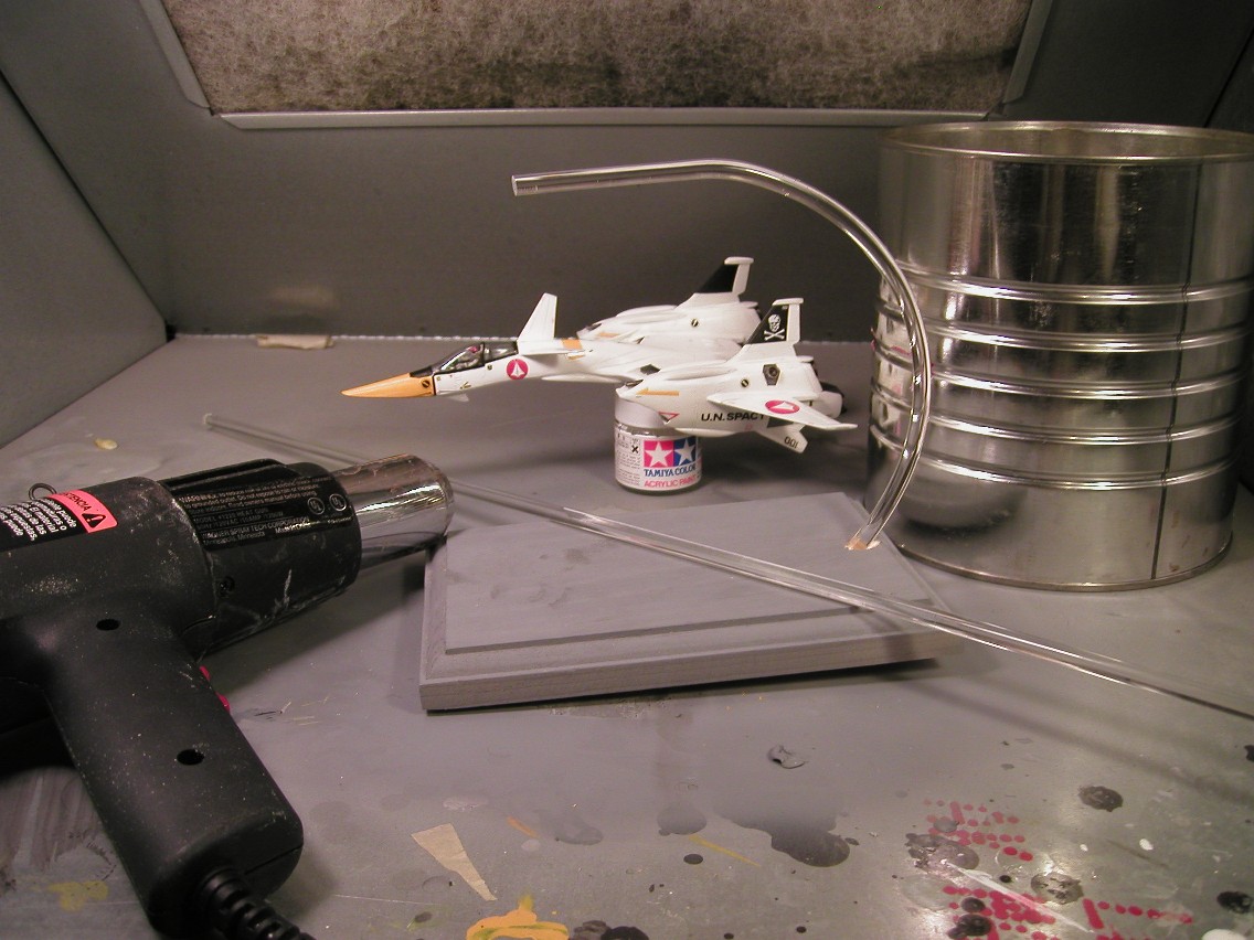

The gloves I guess are for the hot rod? Exactly. and for holding the can which gets hot too. Where online is US Plastics? It is www.usplastic.com and here is the link to the acrylic rods: http://www.usplastic.com/catalog/product.a...ded+Acrylic+Rod Funny thing... in the package they sent me was the acrylic rods and some religious literature about being a born again Christian. Who knew that Bible Beaters were big into plastic manufacturing? The heat gun, is it just the kind to strip paint? Exactly. I had one from working on the house when I was painting. Very cheap and you can direct the heat source better. spray booth, neat set up, where did you get it, and how much do they cost? It is a Paasche hobby spray booth and it is BIG! I got it on ebay for $179. I actually live in Chicago, and picked it up right at the Paasche manufacturing facility (NO SHIPPING COST!!). Here is the guy I got it from on ebay: http://cgi.ebay.com/ws/eBayISAPI.dll?ViewI...&category=28111 So does it vent outside? Yep... the vent booth has an exhaust motor by which you attach a 4" dryer vent. I bought a little vent from Atlanta supply Co. to exhaust to the outside: Exhaust vent is toward the middle of the webpage -

Well... I thought I'd take a little break from the model and build the stand. Since this is an in-flight model, I thought I would have to make some sort of rig to hold it. The coat hanger thing won't cut it, so I decided on something I saw is FineScale Modeler. The article had a guy who used acrylic rods which I kinda liked. I ordered various sized extruded acrylic plastic rods from U.S. Plastic. I got more clear acrylic plastic than I will go through in six lifetimes for $8.00 shipped! As you can see below, I'm not done yet. I took the straight acrylic rod and taped an end to a coffee can side. I heated the plastic with that heat gun (very cheap too!), and then pushed the rods along the groves in the can until I got a U-shaped piece of plastic. Remember to use gloves! I cut off the ends, smoothed them too. Finally I drilled a hole in the base and fed the plastic rod in. Now I plan to hand drill two holes near the top for small metal rods... then glue those in place... then drill similar holes in the base of the VF-4, so the rods will fit in to hold it to the top of the acrylic base. -

I expect to finish circa 2044. Seriously, I get about 5 minutes here, 20 minutes there, an hour if I'm lucky. Truth is very young children are a modelers worst nightmare. Keep in mind this is only my third model since I got back in to the hobby and my first resin kit. Hopefully, I will get better. I really want to get my weathering skills down. -

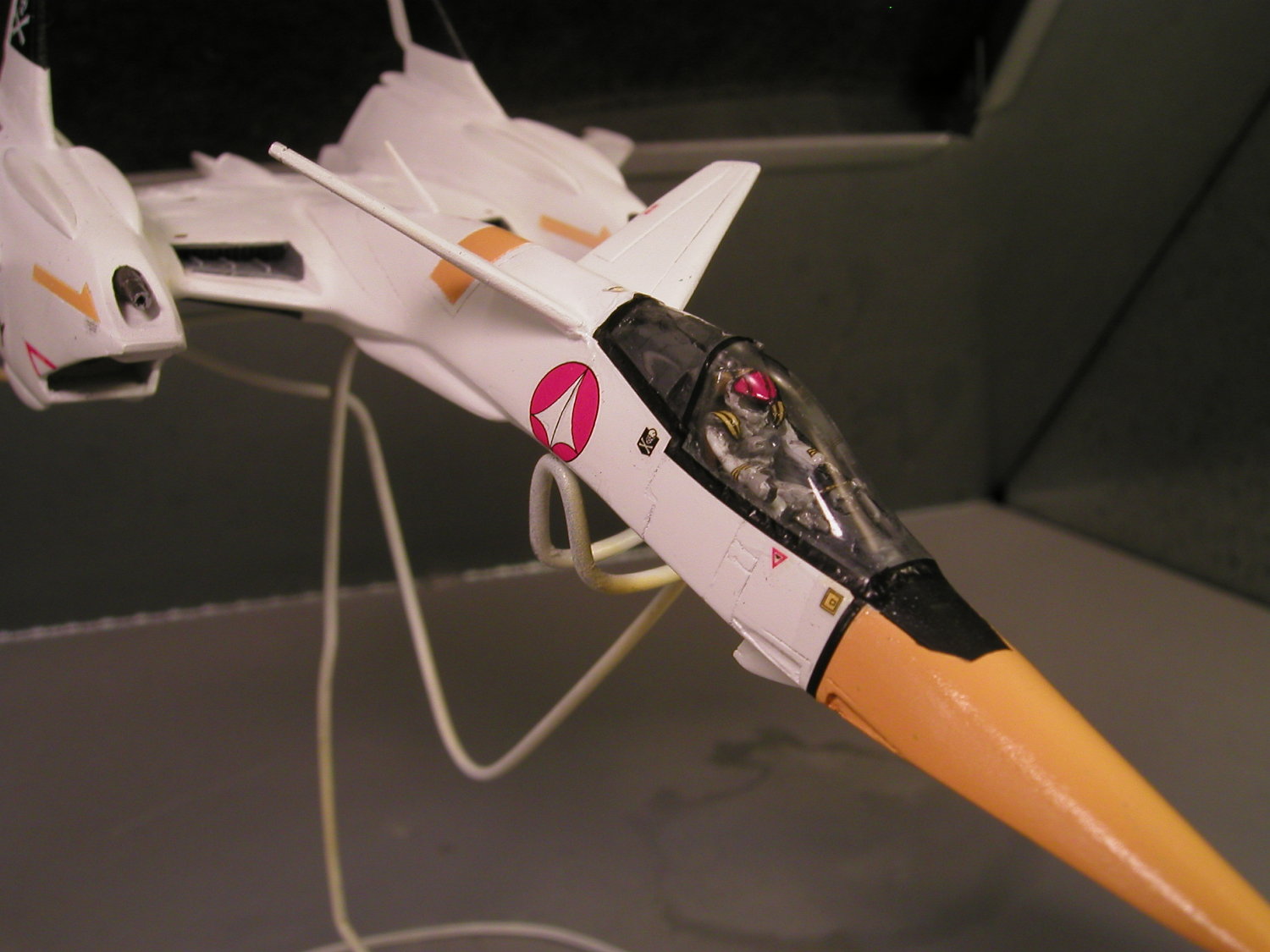

Yeah baby. Do I get a free gunpod for doing an advertisement for your beautiful work? Yep... very displeased with the paint job... but it is my first resin try. The UN Spacy logos are big, but I had to work with what I had... not many extra decals. -

By the way, I don't have any VF-4 reference materials, so I made up where the markings are and the decals go. I'm sure I made some mistakes, but I don't mind. -

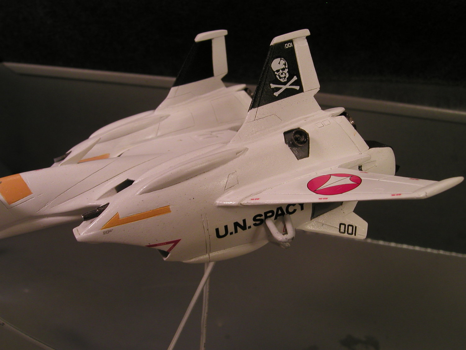

Here's another view... I am not horribly pleased with the paint job. I had to rescribe some panel lines, and I did a HORRIBLE job. (see near the cockpit). Next time I plan to use label tape to guide the scribing saw that I just got. -

Ok... I added some decals tonight. I basically scrounged these up from old Valkyries I had (mostly Hasegawas). I have not done the panel lines yet. I plan to do an oil wash. I also may use some pastel chalks. I put down a coat of future first, so the decals would glide on nicely. Then I plan to seal it with another coat of future. Then do the wash and other weathering. And then a flat seal at the end. -
