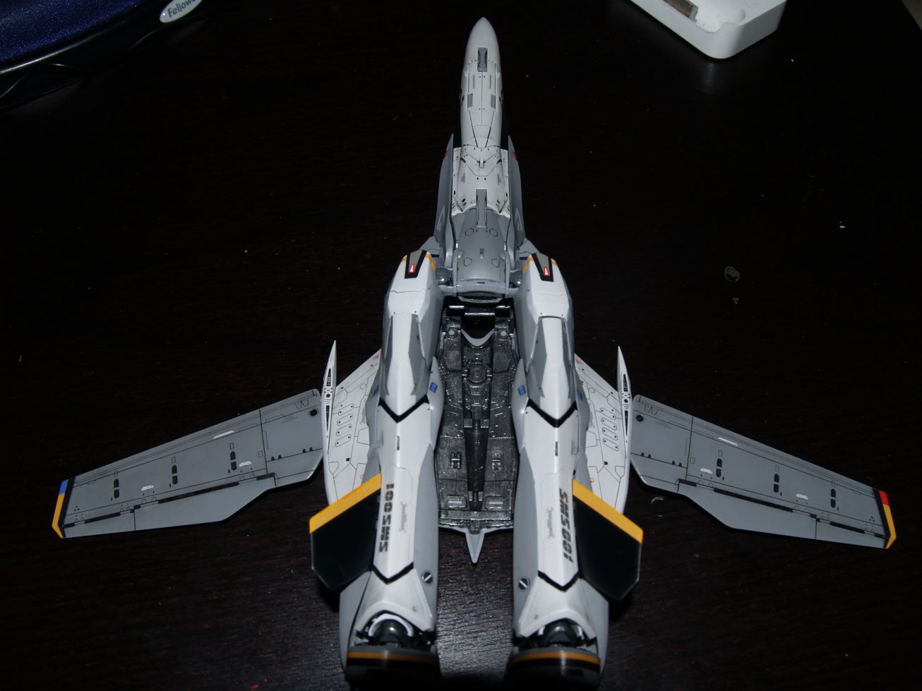

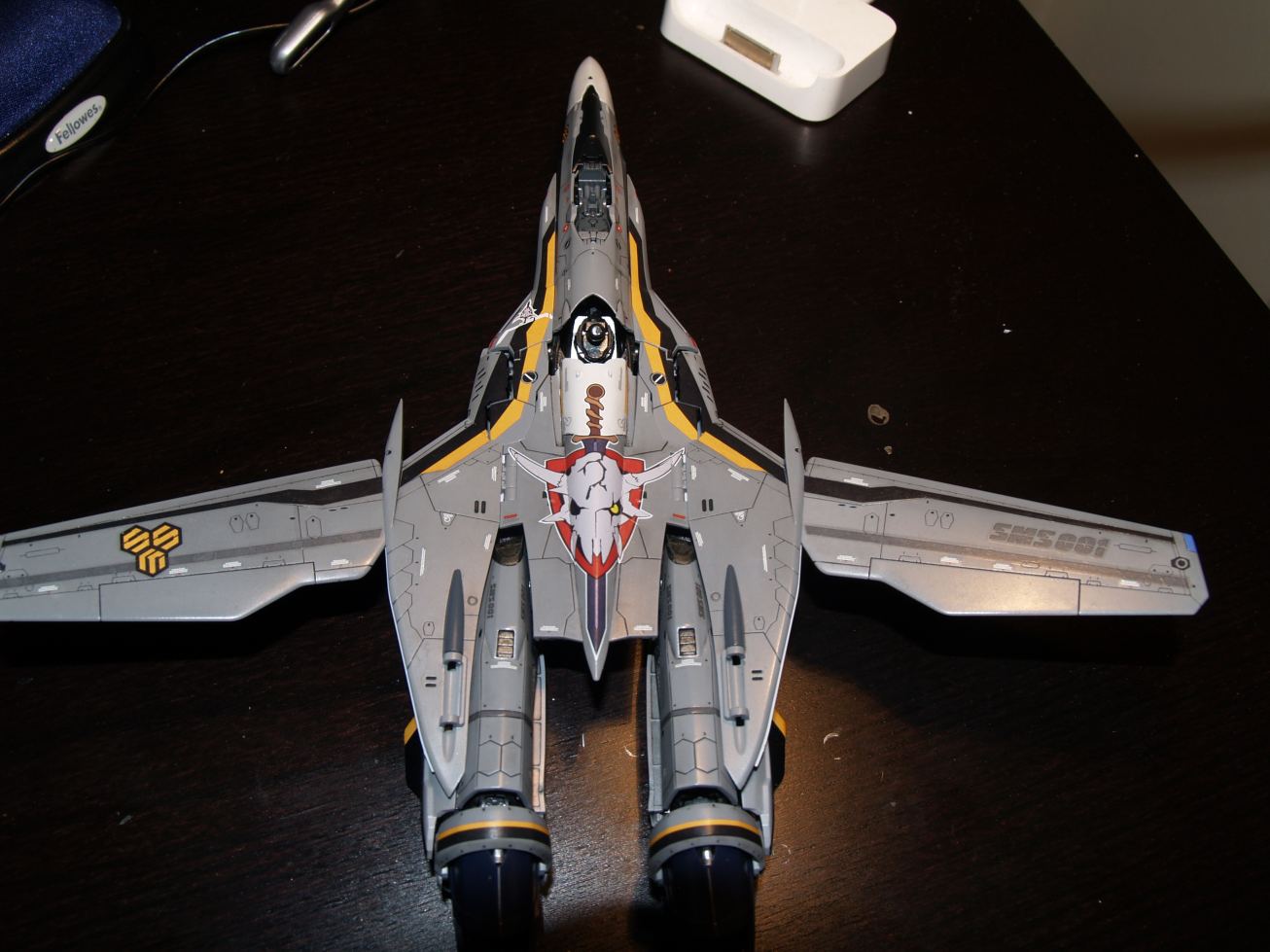

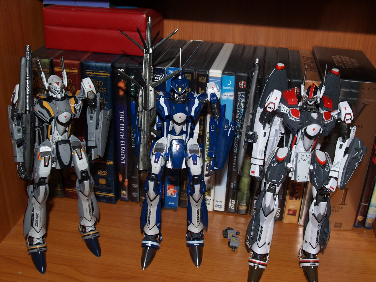

Tamiya Aircraft spray USAAF Neutral Grey is very close. Its a little darker but a very good match. Attached sample colors used: Tamiya Aircraft sprays - USAAF neutral grey and insignia white. No clear coat needed since its semi-gloss. You can oil wash right on top of it and decal. Extra decals used - Gundam Decal Set vol 6 -

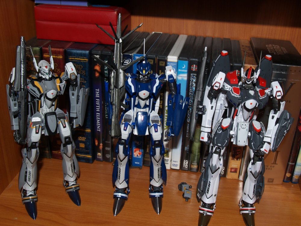

These models dont really need an airbrush set to look good. Tamiya sprays will do fine with great results. Things to get: 1. Sandpaper - I recommend the tamiya ultra fine. 800-1000-1200 grits 2. Bottle of future. 3. Tamiya sprays 4. Some gundam markers - black, silver - or as needed just for touch ups. 5. Tamiya Flat/gloss clear spray VF-25F - I recommend that you dont really paint them as they are white already any form of white paint over it will not really help. Thats unless you prime first, but then again thats a pain in the azz to do so i dont really recommend it. This model will look fine by just applying the water slide decals, and panel lining the kit. As for the non white parts, i recommend that you use Tamiya Light Gun Metal. Dont spray the entire runner, especially the joint parts since it will thicken it and when you assemple, it might actually break or snap off. Panel line, spray, assemble and place water slide decals. Seal with future. You can apply with a brush. After its all dry 1 to 2 days - I recommend that you apply several coats. After its dry (1-2 days) spray with Tamiya Flat/Gloss clear to the finish you want. Or just leave the future as your sealer. Vf-25S i used Tamiya spray cans - Light gunmetal, Insignia White, and USAAF Neutral Grey. Clear coat with Future, panel line with Oil wash (use turpenoid) place decals... reseal and then done. -

Also a suggestion if anybody messes up like i did with my vf-25s decals. Do a high rez scan of the waterslide decal sheet. Get something like testors clear decal paper and print. Was able to redecal an entire model this way by recoloring some of the vf-25f decals. Also as an added bonus I was able to make some custom decals. BTW can someone post a high res scan of vf-25s?
