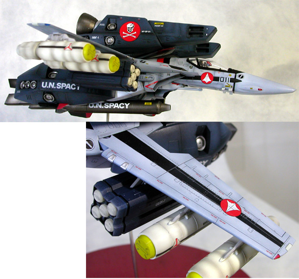

	To Less than Super Ostrich : Yup, it's the Hasegawa Battroid 1:72. To HWR MKII : I make the surface as smooth as possible, ie as glossy as possible. Then did a wash method with diluted enamel black. To nightmareB4macross : I felt that the Skull would add more depth to the otherwise bland area. (you were spot on HWR MKII!) To Grayson72 : It's just Preshading. Cover the whole kit in dark Grey. Then preshade with white using an airbrush with a low pressure (psi). Thanx for all comments. I'll bear them in mind esp regarding the shading sections.

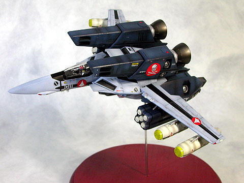

	Hi Ido... Don't have many pics. Here're some of the better ones. btw, the strike VF-1 was one of the harder macross kit IMO.
	Ido, I forgot to mention one thing. I did quite a lot of kits to have today's skill because I started from Zero & learnt most of the stuff myself. 8 years ago, I had no Internet access & no one around me had even heard of mecha models. But with today's modelling forums & hobby magazines, I believe the rate to improving modelling skills can be shortened by a lot lot lot. (Assuming you practise.) Screwed up a kit? Just pose some pics & help is on the way. Want to know what is the Wash method? Just check the threads. Fact that you can do decals & all that stuff with only 2 plane kits is itself pretty remarkable. Kudos
	Hi Ido, hope these helps. Ans 1) I did about eight 1:100 Gundams & four 1:144 Gundams. Then 3 Battroids before I reached this standard to do the Strike VF-1. (See pic). These are the kits which I did professionally. I also screwed up countless kits previously when I was much younger before I decided to go pro. Ans2) No gloves. I only handle them when fully dried so there'll be no prints of any kind. Lacquer dries really fast so there's no worries for me. If you do leave prints, it means it's not dried yet or you could have sweaty palms. I always wash my hands with soap & dry them completely before touching the pieces. Maybe you'll like to elaborate more. Ans3) I use a small duster that has very long soft bristles like the ones woman use to brush their makeup on their faces. The softness of the bristles will cause minimal harm. Or use the soft cloth that usually comes with a new pair of spectacles. Ans4) It depends on what you want. If you want to learn preshading, I recommend you try it on a gundam since it has lots of space to work on. VF-1 is panel line crazy, not for preshade learning unless you're more experienced. (My strike is done with preshade) Then again if you really like VF-1 & want to make it, then do so. Like I said, it depends on what you want. Since you feel you can do a decent kit, just do it. It is after all your own journey. Good luck :-)

	One more angle pic. By the way, is it ok to delete the pics from hard drive once I have uploaded them into the forum?
