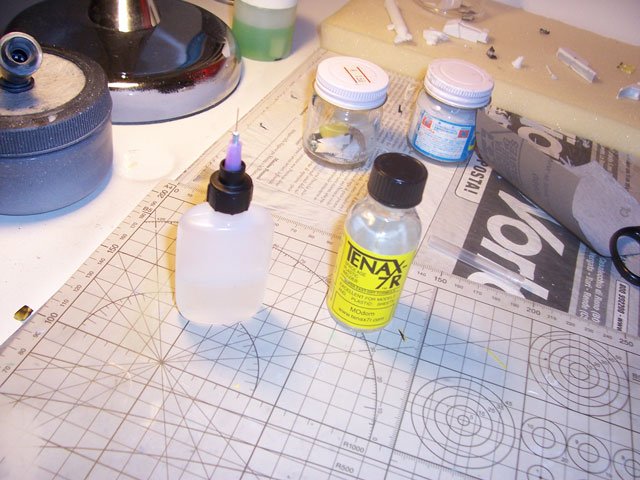

Here what its missing, gunpod, head, arms, all glued and with putty applied. Meanwhile I painted some other little parts, like the laser cannon, head visor and arms sensors/lights (what the hell they are???) I tried your tip kazuki and washed the black part of the head with silver enamel mixed with flat base and it worked out, thanks. Today I received a package from hobbylinc, I ordered the tenax plastic construction kit, it cames with this little toy, it should be more pratical then touch and flow applicator. Too bad there isn't anything left to weld togheter with it.

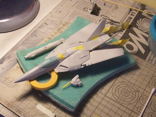

I'll do some minor fixing on the little defects the primer its showing then I'll start assembling head, arms and gunpod. The Intakes are a little crappy, I'll try a different approach next time. Can't wait to start painting this baby.
My favorite ones are Tenax 7r(welding): If you really needs strenght, it evaporate so quickly that it can't do a lot of damage. Mr. cement S(welding type), not strong like tenax but its really easy to use, when I need precision and strenght. Mr.cement (adhesive) Quite strong for an adhesive glue, but IMO the brush its too big for 1/72 kits, I plan to replace it with mr.cement s smaller brush. Microweld(non toxic adhesive/welding): I use that on pre-painted part cause it is safe on mr.color paints, or where I need a very precise and clean application. Micro krystal clear/ testor clear parts cement: for clear plastic parts ps Don't be scared by welding cement, I found it a lot safer then adhesive glues and with that you can be sure the parts will not split apart.

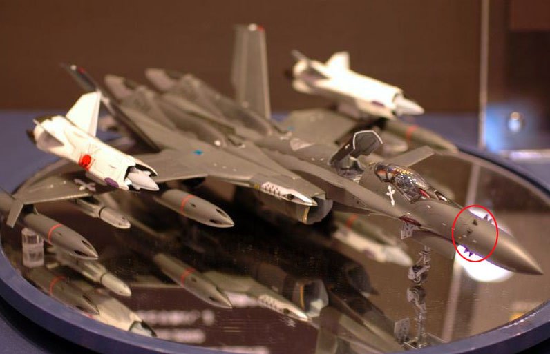

Estetically not variable models look better, but if look at these model from a modeling point of view and you consider how complex these kits are and how hard make one of them plus the modeler skills they are wonderful Applauses to S.H.E. and to who built them.
Looks great. I wonder, will you add these nosecone details to this model? The balsa version didn't have them if I am right.

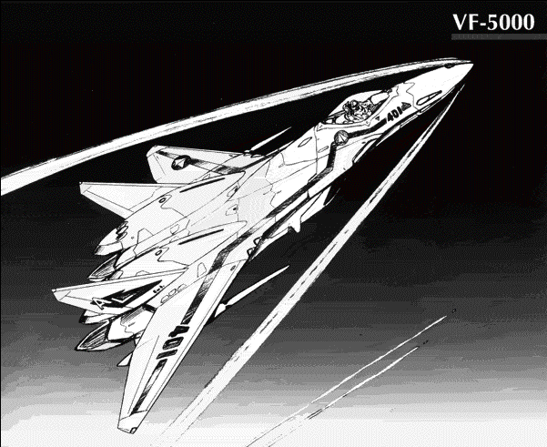

Notice: The SHE models its the VF-5000B, (I like the VF-5000 better then the vf-1 but I don't like SHE model cause it isn't very close to the artworks, it has an orrible fuselage and canopy.) What appears in M7 Dynamite is the vf-5000G (crappy looking legs and fastpacks plus some minor differences). <- B <- G PS Dynamite sucks bad as story but It doesn't have that M7's super robot anime taste and at least so you can enjoy the valks as battles are good.

If you use a plastic welder correctly the melted plastic fill the seam, a lot of people don't even apply the putty cause there ins't any seam to fill, but its possible that the plastic have some depressions, here Mr. surfacer show them very well. Its very important to propely clean the piece after sanding especially the panel lines, a wet used toothbrush its great for this. Seriously, modeling paint applied lightly with an airbrush don't harm details but the sanding residues are awful. Now the parts are clean and ready for mr. surfacer 1200 I suggest to use this on 1/72 valks cause its very detail friendly and its a lighter in colour then mr. surfacer 1000. There were a big depression near the exhausts, I'm glad mr. surfcaer 500 did the job.
