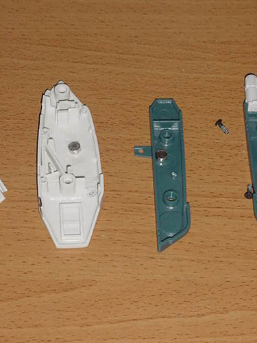

do not disturb Posted May 17, 2004 Author Share Posted May 17, 2004 heres a shot of the disassembly...the littel silver things are the magnets. Quote Link to comment Share on other sites More sharing options...

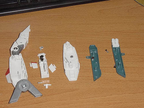

do not disturb Posted May 17, 2004 Author Share Posted May 17, 2004 heres a close up... Quote Link to comment Share on other sites More sharing options...

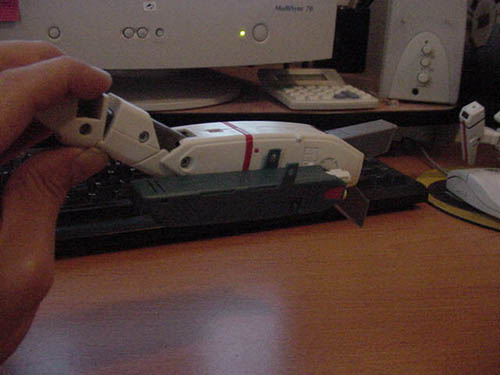

do not disturb Posted May 17, 2004 Author Share Posted May 17, 2004 and here its is holding on for dear life. Quote Link to comment Share on other sites More sharing options...
do not disturb Posted May 17, 2004 Author Share Posted May 17, 2004 the best part about this was i only had to mod one leg. i guess i could do both legs but the magnetic force might keep the arms pulled towards opposite legs and cause the gunpod to fall off....does that make sense? anyway the link in the 2nd post is where i got the magnets. just be sure to get the thinnest and smallest ones you can get. Quote Link to comment Share on other sites More sharing options...

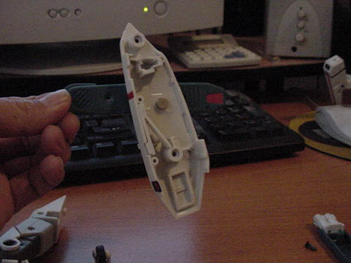

do not disturb Posted May 17, 2004 Author Share Posted May 17, 2004 (edited) heres the last one assembled.... the power of magnets at work. Edited May 17, 2004 by haterist Quote Link to comment Share on other sites More sharing options...
