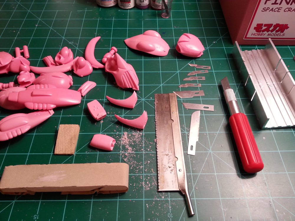

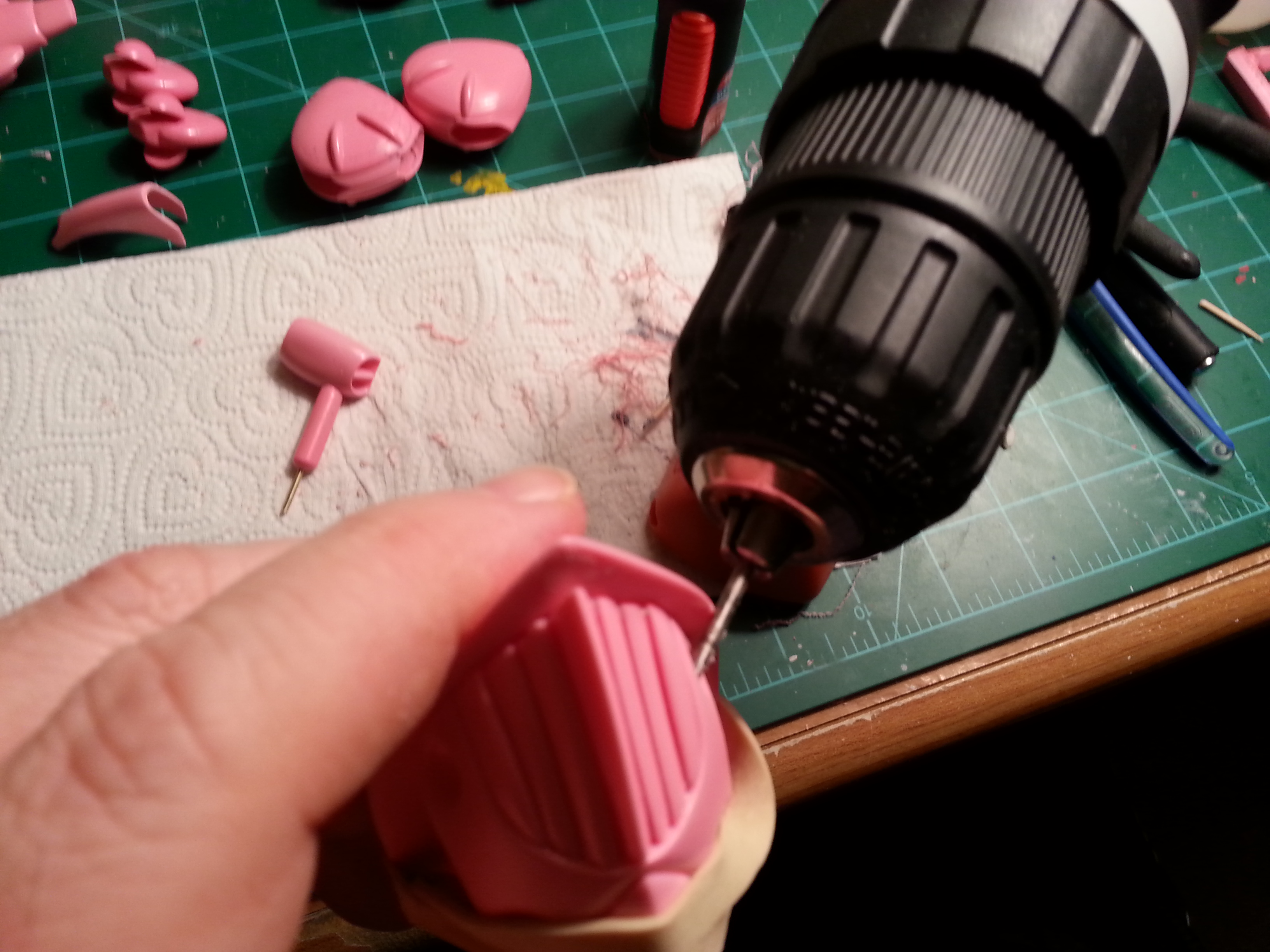

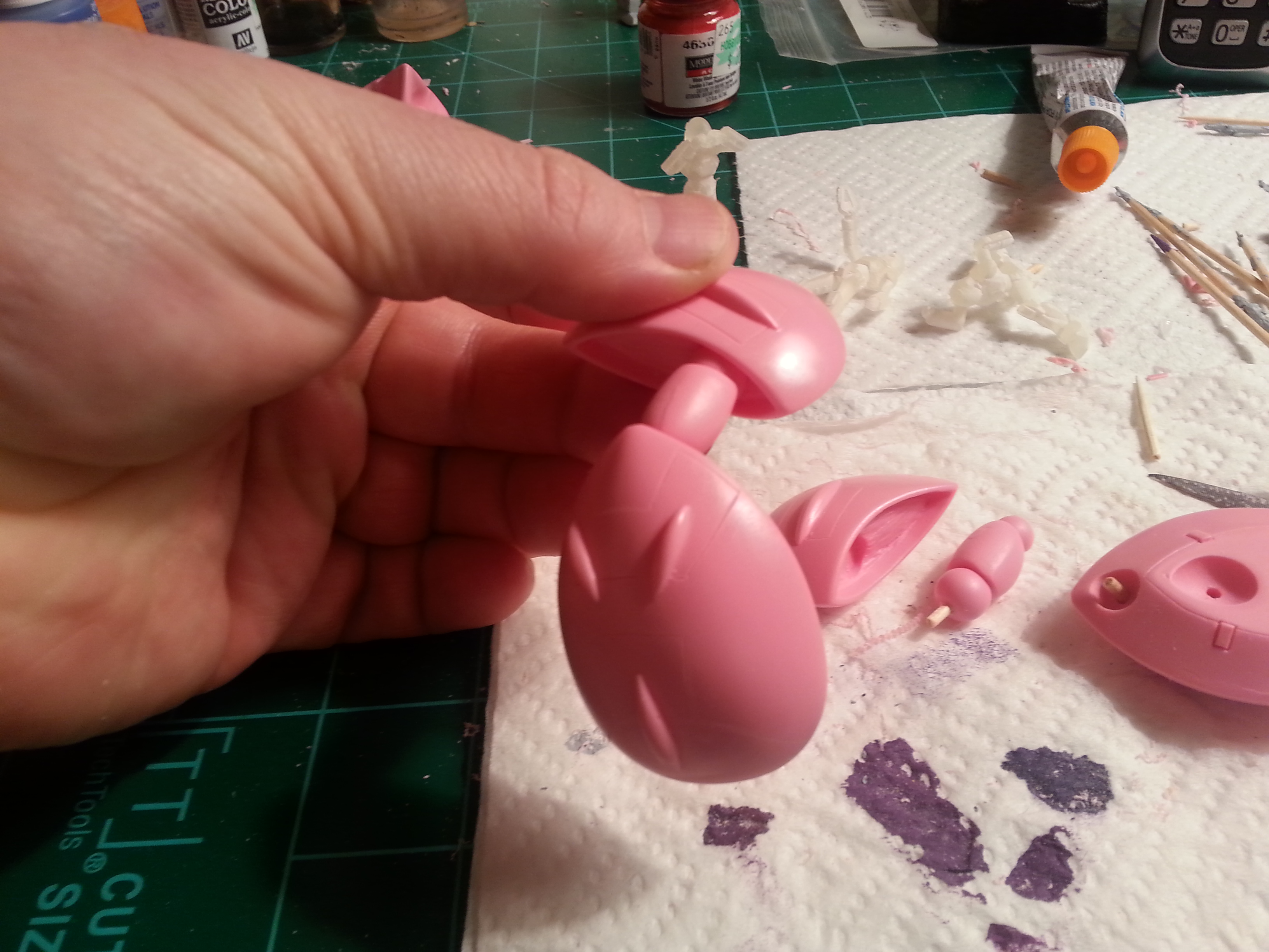

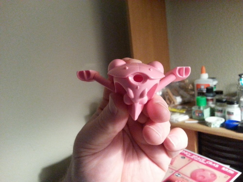

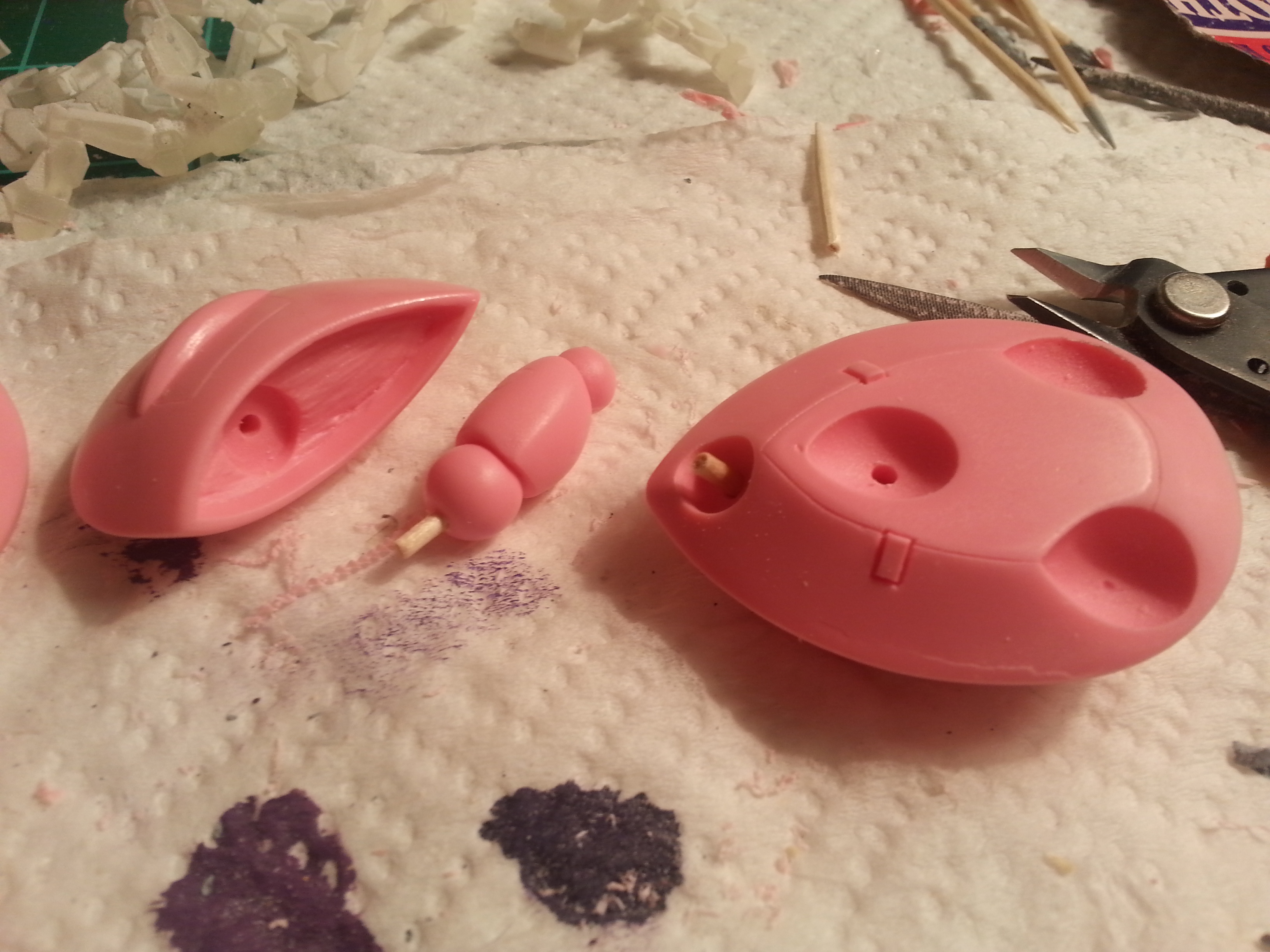

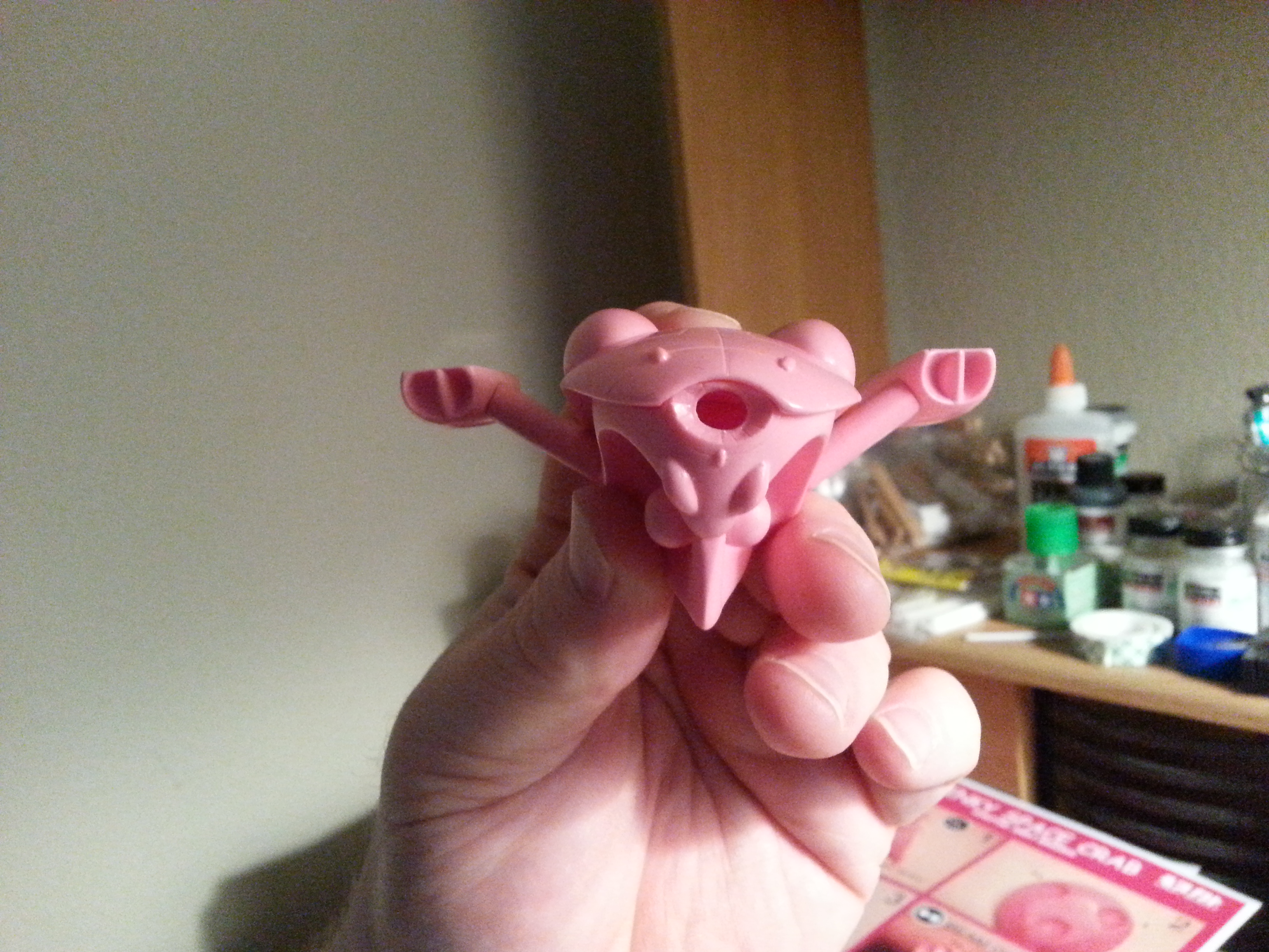

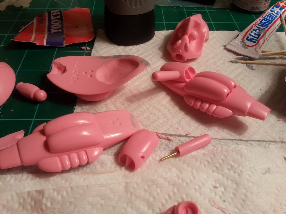

derex3592 Posted May 26, 2015 Posted May 26, 2015 (edited) Hey guys, as I am finishing up another resin kit, I thought I would try to put together a guide for people to follow that have never built a resin kit before. It sure would have helped me in the beginning! Here's what I have so far. Please feel free to share your thoughts! How to build resin kits 1. Cut all flash and extra mold parts off. Leave or saw off ball joints depending on the situation. (sprue cutters, x-acto knife, sandpaper, razor saw.) 2. (WEAR A MASK OR A RESPIRATOR!!!) Sand down all mold lines/pour stubs and unwanted blemished so all areas to be painted are 100% mark free and smooth. Also use Tamiya white putty to fill in any holes, or cracks or whatever else. Sand completely smooth. (sand paper) 3. Drill holes for pegs. (Pegging EVERY single part with either brass rod or the center part of a wood toothpick isn’t a horrible idea) Assemble entire kit with pegs in place and make sure the position of all parts is correct. (The pegs should hold things fairly tight). Glue pegs in place with CA (superglue) 4. Wash all parts in warm water with Dawn dishwashing detergent. Let parts dry overnight. 5. Wear gloves and mask off areas where parts will meet for assembly later. (IMPORTANT!) 6. Use white primer (I use Rust-O-Leum White 2X) to prime all parts. 7. (WEAR A MASK OR A RESPIRATOR!!!) Sand primer smooth and prime again. Repeat this step until everything is 100% blemish free, all putty is perfectly smooth and everything is ready for painting. At this point use increasing grit #'s of sand paper all the way up to 12,000 polishing stuff. The primer should actually be semi-glossy and smooth as glass before you lay down paint. 8. (WEAR A MASK OR A RESPIRATOR!!!) Mask and paint parts as needed. Unmask parts if necessary and let paint dry 48 HOURS. No if’s and’s or but’s!!! DO NOT TOUCH. 9. Polish/buff painted parts with 100% cotton cloth. 10. Assemble parts with MINIMUM amount of CA (superglue) needed. (The pegs should hold things fairly tight) 11. Clearcoat with gloss if needed. 12. Apply decals/weathering as desired (if any). 13. Clearcoat again if needed with gloss or semi-gloss or flat. 14. Display and enjoy! Edited May 26, 2015 by derex3592 Quote

arbit Posted June 3, 2017 Posted June 3, 2017 Thanks Derex. Did these Invids need pegs to attach the parts, or just super glue? Quote

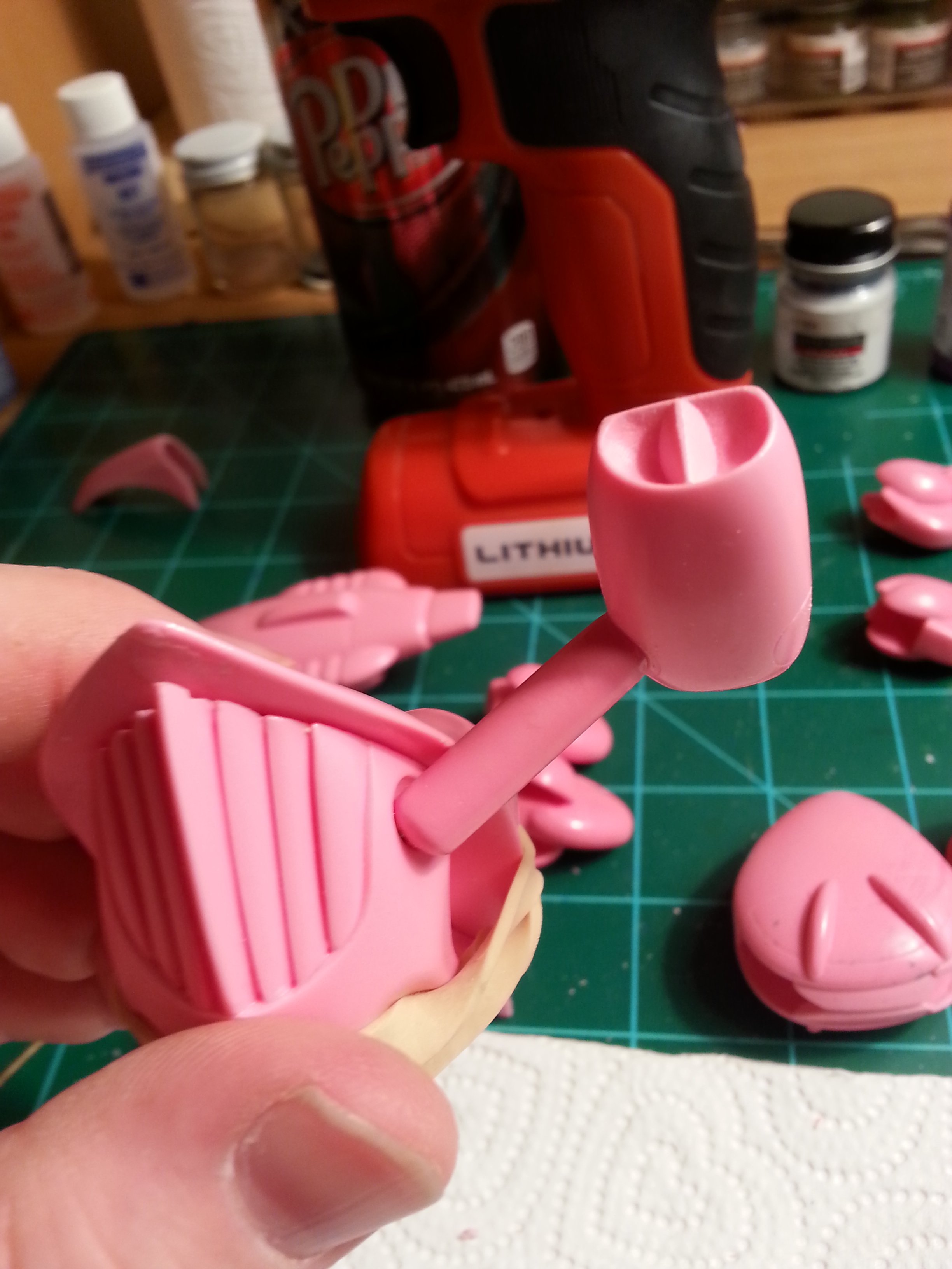

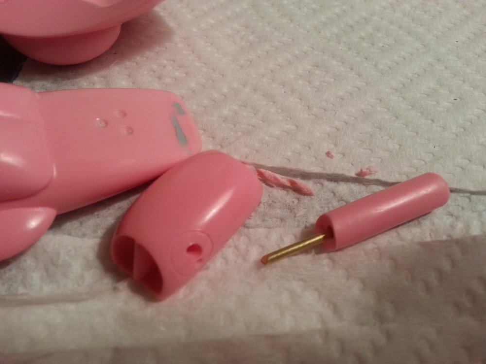

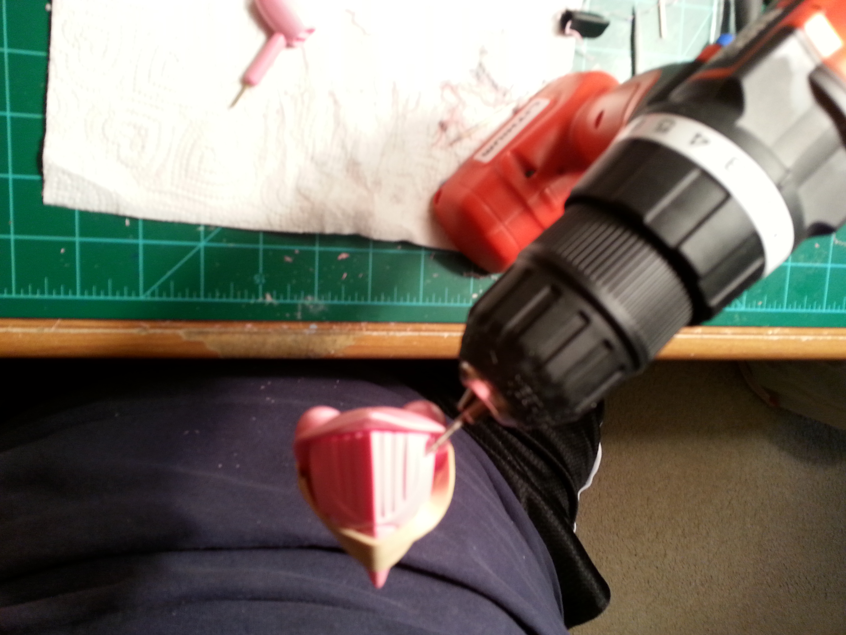

arbit Posted June 4, 2017 Posted June 4, 2017 15 hours ago, derex3592 said: I went with pegs on most parts. Could you give a few snapshots of your peg tools and how you trim and place them? Quote
derex3592 Posted June 4, 2017 Author Posted June 4, 2017 My peg tools consisted of toothpicks with ends chopped off and cut to length...LOL, I later tried very small brass rod, which is actually better if it's something you think that you might want to change the angle of the attached part, as it's slightly flexible. There's definitely a learning curve. Quote
