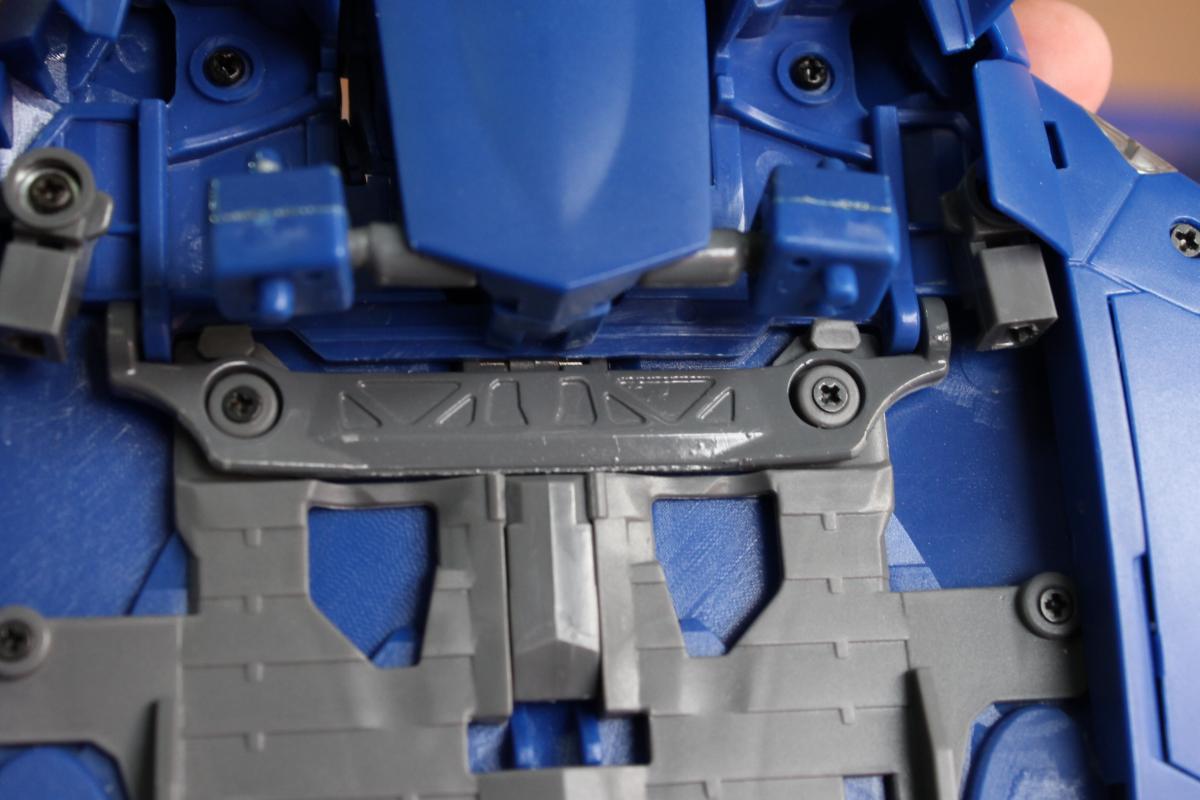

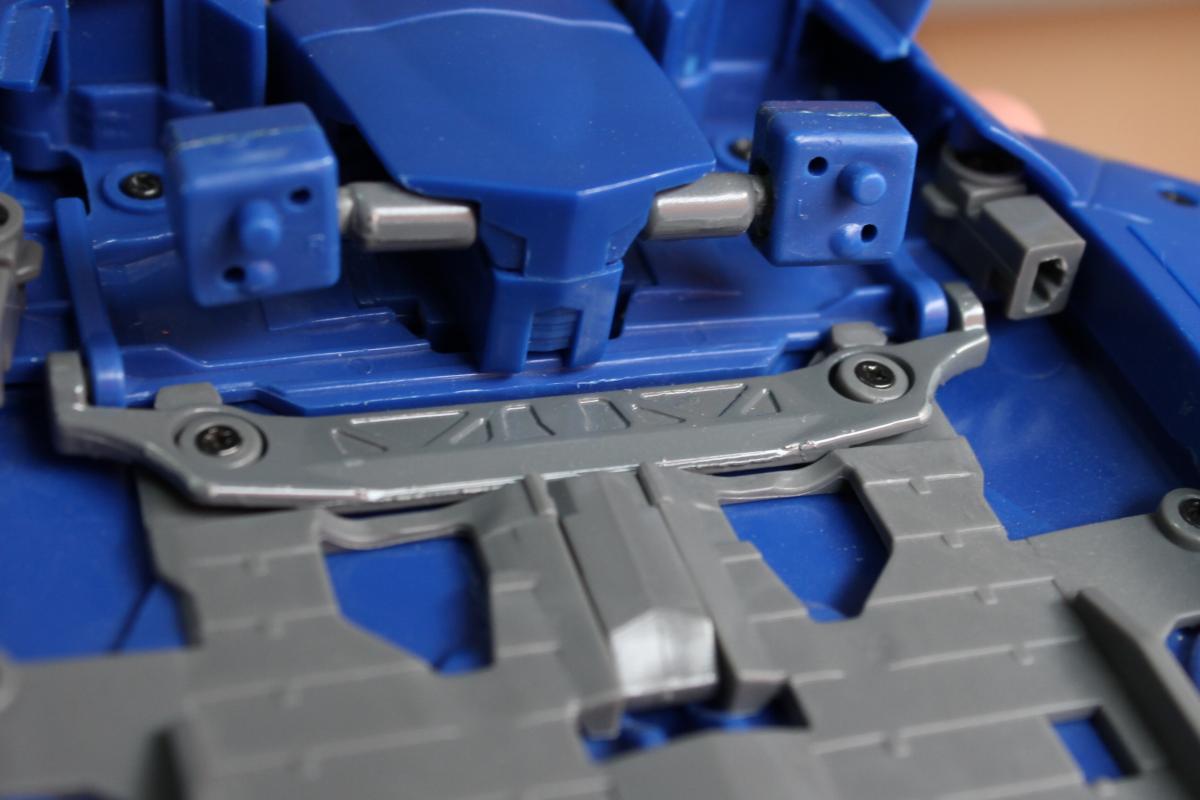

Brand-X Posted November 4, 2014 Author Posted November 4, 2014 Okay here's some pictures that may help. First off, we have the left side. As you can see in the first picture, the top is flush, as the shoulder joint is pegged into the wing. However on the other side, we have this: As you can see, the shoulder swing joint doesn't peg into the wing. I can manually press it down and it'll snap into place, but then pop right out again. Quote
Ignacio Ocamica Posted November 4, 2014 Posted November 4, 2014 It seems the metal bar is slightly bent. Have to study the last picture a little more. Quote
Brand-X Posted November 4, 2014 Author Posted November 4, 2014 (edited) Well, I believe the bar is supposed to be bent into a bow shape, but here's a picture of the bar itself (Please ignore the door being pushed down near the intake, that was just in this picture, so that's not the problem) Edited November 4, 2014 by Brand-X Quote
Ignacio Ocamica Posted November 4, 2014 Posted November 4, 2014 It's bent both sides the same, yeah it's not the problem. Will check the pics with my YF-21/VF-22's when I get home. Quote

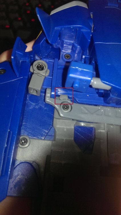

Scyla Posted November 4, 2014 Posted November 4, 2014 So first deliberate guess since I have not handled my VF-22S in a while. Is this clip snapped in. I can spot a difference there between the left and the right side. Here is a third video maybe this also helps: Quote
Brand-X Posted November 4, 2014 Author Posted November 4, 2014 Yup that clip is snapped in, so it's something outside of that. Quote

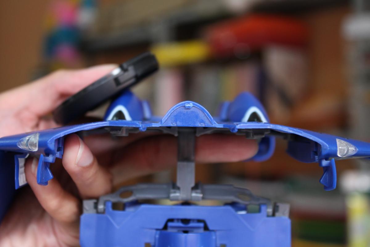

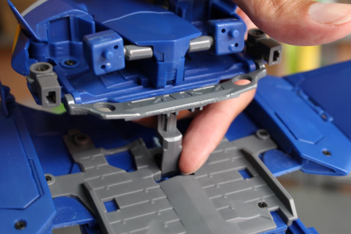

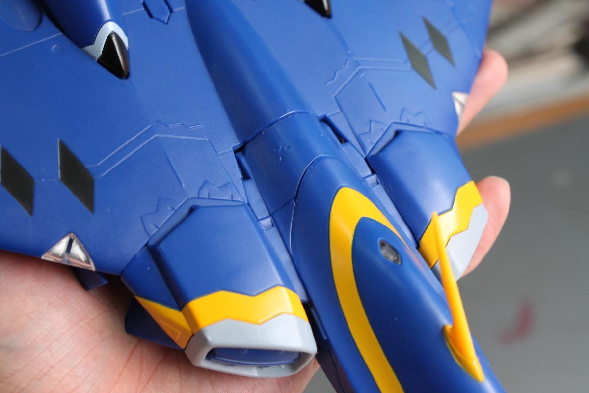

Froy Posted November 4, 2014 Posted November 4, 2014 (edited) Here are some pictures of mine. I don't see any problem with the metal parts. Maybe the plastic is warped a bit. Use the last picture as reference and check is that plastic part is symmetric. Edited November 4, 2014 by Froy Quote
