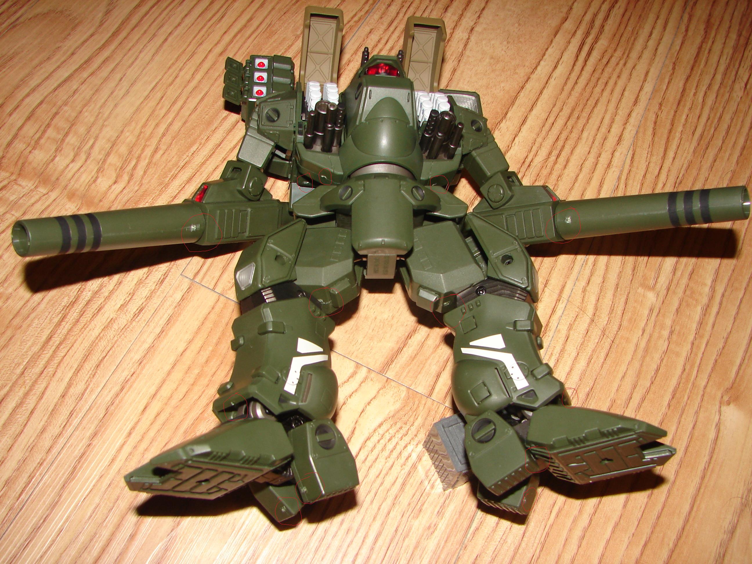

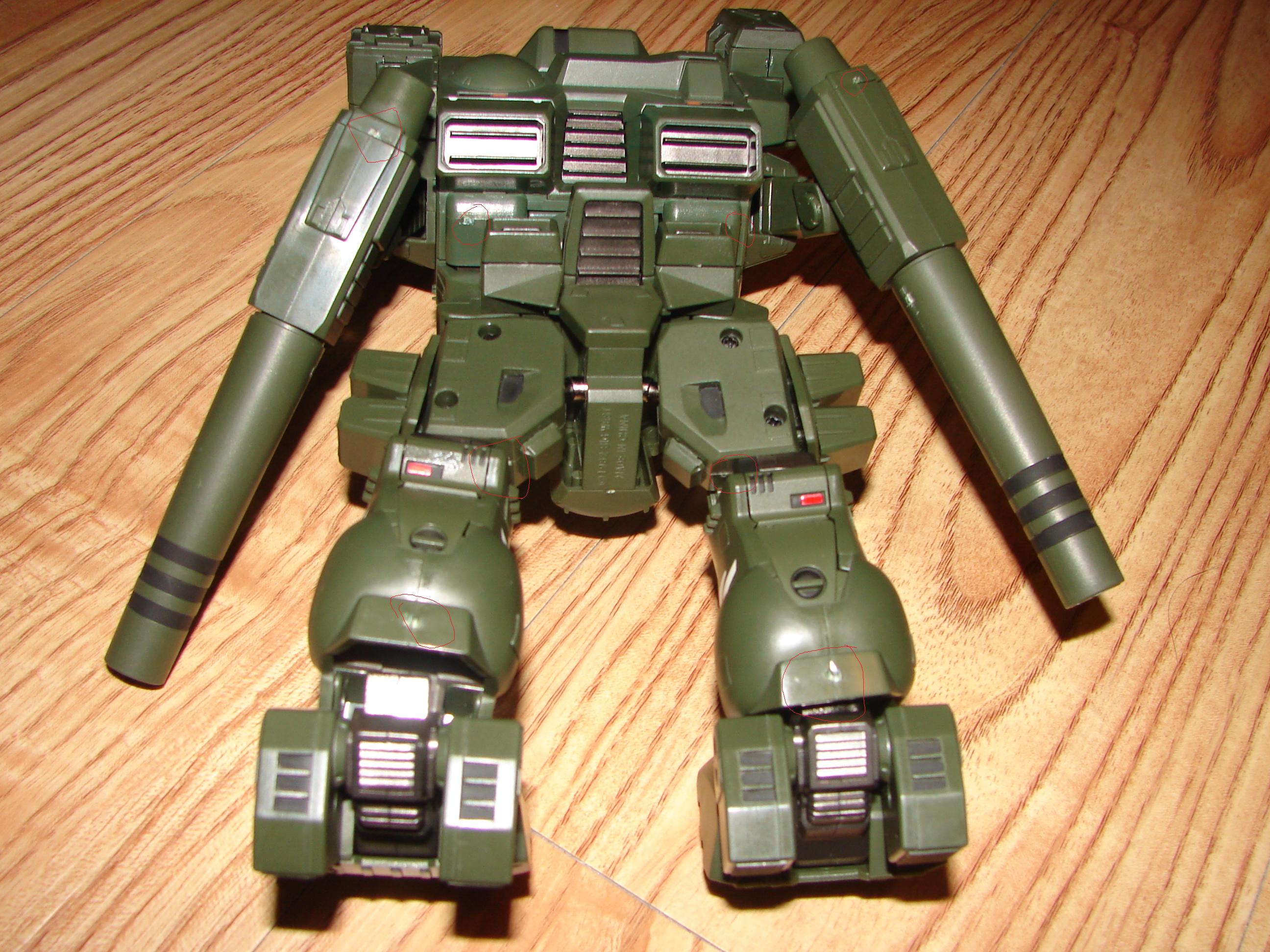

beatsing Posted January 17, 2010 Posted January 17, 2010 (edited) Hi, I've just received my OD Tomahawk in the mail yesterday, and upon inspection, there are ugly sprue cut marks on the cannons, the back of the cannons, back of calves, next to the knees' swivel joint. I've collected 5 valks now, and haven't had any problems. As this is the OD version, the ugly white cut marks are very visible. Has anyone had this problem? I've read the reviews, and haven't seen this problem mentioned before. Did I get a faulty unit? Please reply soon as I need to discuss this with the seller. Thanks. Edited January 17, 2010 by beatsing Quote

CF18 Posted January 17, 2010 Posted January 17, 2010 (edited) Probably all units have them, just not very visible on the standard version. Here you can see them on the cannon and back of calves in the first two pics. http://gamu-toys.info/goukin/yamato/60dest...estroidtom.html They are standard on most toys so you don't see complains. The 1:60 VF-1 hide them very well. For example on the hand held gun you can find the sprue cut under it and I believe they either got painted over with matching color, or the cut is so sharp they don't show the stress mark (which is where the white come from). On my Max VF-1J the marks under the wing-mounted missile box have more visible sprue mark under them. Your best bet is try to paint the white spots with matching color. Edited January 17, 2010 by CF18 Quote
beatsing Posted January 17, 2010 Author Posted January 17, 2010 (edited) Any pics? I have 6 destroids and experienced no problems (except loose waist joints maybe). Hi, here are the pics, I've circled the sprue cuts in red. ff95gj, thanks, mine is loose at the waist too. As I've read that this is a common issue but not considered a problem, I can overlook the waist. The feet seem fluid (not tight, but not loose). CF18, thanks for the pics and your comments. Good eye regarding the VF-1 gun pod. I'm looking at my VFs, and I don't notice any glaring cuts on the body of the valks. I think I would overlook the valk's gunpod as it was also painted over on my VF, and that it is in a relatively small and hidden spot. But the Tomahawk's is rather large cuts. For example, the cuts on the trim above the Tomahawk's feet are hidden from view if looking from above, but the cannons are gouges, not small marks. I think you are right about the stress marks, perhaps the assember tore the part from the sprue rather than cut sharply. As this is the OD color the contrast makes it very noticeable. I'm quite disappointed in the QC for this issue, as the VFs marks (if any) aren't very visible. I suppose I was expecting the same quality that the valks came in. I considered the paint cover up job, like they suggest for beginner modellers to use Gundam markers on cheap kits, but I'd have to match up the color, and the gouges on the cannons would still not be smooth. I'm considering asking for a replacement, but I'd like to know how common this problem is, as I wouldn't want to pay for the expensive shipping (it cost me more than half the cost of the product) only to receive another Tomahawk with stress marks. Do you guys have any other suggestions? Edited January 17, 2010 by beatsing Quote

Vi-RS Posted January 17, 2010 Posted January 17, 2010 It is a raw plastic toy, not some painted model kits. All toy have the sprue mark and it will be much visible on dark color plastic. As far as I concern yamato has done a pretty good job hiding those mark, and if you understand how the mold works to cast the individual piece out then you will understand why the sprue is here but not there where both parts meet. Even a model kit will have the sprue at side due to the way part were molded. Quote

eugimon Posted January 18, 2010 Posted January 18, 2010 all plastic discolors when you cut or stress it. Quote
BlueMax Posted January 18, 2010 Posted January 18, 2010 Hi Beatsing, While I understand your frustration, it must be noted that this is not a professionally built model, but rather a mass produced toy. The professional modeller (or at least a serious model kit builder)have to go through quite a tedious process to smoothen out/ putty in the sprue marks, something that I'm sure is not realistic to expect on a mass produced toy. All toys have them, just whether they are obvious or not, like what the other members have pointed out. Here is a sugegstion if you must get rid of the white sprue marks, though please use caution if you were to try it: use a lighter (a small candle would be ok as well), in a back and forth motion, run the part through the flame so that it gets heated up, but not to the point of burning/ melting. You will see the white (stress) marks disappear within a couple of seconds. But of course, use it at your own risk. I suggest you try on some unwanted dark piece of plastic, bend it so that you see the stress mark and try the above method. Quote
brenttoyou Posted January 18, 2010 Posted January 18, 2010 (edited) Based on my modeling experience, those cut marks are something to be expected on plastic toys. To hide those marks, you will need to use 800 or 1200 grip sandpapers to smooth them and use some polishing compound to hide the sand. To have the least cut/stress/white marks, one needs to cut the sprue about 0.5 inches from the actually end using a model scissor and use art knife to cut the remaining. I don't think any toy factory always has the luxury of doing that. Edited January 18, 2010 by brenttoyou Quote

beatsing Posted January 18, 2010 Author Posted January 18, 2010 the only reason you don't notice them on the other valks is because they're made from white/off-white plastic. every yamato (and most unpainted, injection molded toys for that matter) have them, but the white marks show up more on dark colored plastic. Most people either don't notice or don't care. personally I don't care. Hi anime52k8, Good suggestion. Perhaps because the plastic cuts are the same color, they are less noticeable. I thought the same at first. However, I went back to examine my valks and although I have valks that are white/off white/grey, I am deliberately looking for these marks. Perhaps my valks have been done by a pro, as I really don't notice any upon close inspection (not counting the accessories). The outside body of the valks are really smooth and the offwhite/grey valks should show the white marks more obviously. They don't show. Either the assembler has cut very sharply or sanded them smooth. Quote
beatsing Posted January 18, 2010 Author Posted January 18, 2010 Yes both my defender and tomahawk have those marks, the weathering version is less obvious since they sprayed the paint on it to create the effect. If you look close enough there are lots of spryer marks on V2 as well especially max, millia and vt-1 which is pretty much self explanatory. You just need some final touch up if you can't live with the sprue marks and there is no big deal. Even a bandai PG kits have those sprue marks if you build it unpainted. Hi Vi-RS, Thanks for your reply. Perhaps this is a common issue, if other's kits have the same. Do you remember where the sprue marks are on the V2? I inspected them earlier today, and mine don't show any noticeable marks. I'll look again if you can point them out. I have the VF1A Hikki v2, VF1J Hikki v2, same in 1/48. My buddy has the vf0 production in grey, and I don't notice the sprue cuts. I am leaning towards doing some "repair" work, sanding and painting touch up. If I had more time, I would putty and repaint, but I bought this variation for its color injection. It looked so good on the photos that I didn't have to paint it. I like painting, and customizing Gundam and other scale kits, but for these kits I don't have to worry about chipping paint off with too much posing (unless I paint this kit). I do have a PG Rouge kit and it would have cut marks if you don't sand it down. It's not so bad, because presumably I would sand these parts down before painting and assembly. I haven't tried "repairing" a pre-built toy. Some of these cut marks on the tomahawk are hard to reach, like the knees. Also I don't cut so deep as the cuts done on the cannon. Quote

beatsing Posted January 18, 2010 Author Posted January 18, 2010 Well, you're not going to see a mass produced toy that has sanded parts. Short of using a water knife or someone switching out or sharpening the cutting surfaces every half dozen cuts, you'll never have a mechanical system sharp enough to minimize sprue marks in the way you're suggesting. And just for kicks, I looked at my takara transformers, MP, binaltechs and alternity and they all have sprue marks. Several of the binaltechs have rather hideous gouges from where the sprue was obviously snapped off instead of cut off. Hi eugimon, Perhaps you may be right. I guess I assumed that Yamato's QC was really good based on my personal experience with my collection so far. As I've mentioned before, it's not that there aren't any cuts, in my collection, just that they were done in a fashion that doesn't appear unsightly. Good to hear from another TF fan. I haven't collected that many transformers, mainly because of the low quality, but I have collected some MPs, and only one binaltech, because the detail and quality is so high (and price), I wouldn't consider them toys. As I am paying a premium, I would expect that the staff would treat these products better than those cheaply made products. So far, other than the Tomahawk, I've seen acceptable cut marks on my other kits/toys, or more specifically like CF18 pointed out the cut mark under the valk's gunpod, it was done nicely that I don't mind it. It should be noted that the gunpod is black, and yet the cut mark leftover was either painted or cut nicely as it is still black. Thank you for assuring me by taking the time to check your transformers for these sprue marks. I was really considering returning it to the seller, and would have to pay for the shipping (again). I'm going to try some of the suggestions here on some spare trees before deciding. Quote
eugimon Posted January 18, 2010 Posted January 18, 2010 Hi eugimon, Perhaps you may be right. I guess I assumed that Yamato's QC was really good based on my personal experience with my collection so far. As I've mentioned before, it's not that there aren't any cuts, in my collection, just that they were done in a fashion that doesn't appear unsightly. Good to hear from another TF fan. I haven't collected that many transformers, mainly because of the low quality, but I have collected some MPs, and only one binaltech, because the detail and quality is so high (and price), I wouldn't consider them toys. As I am paying a premium, I would expect that the staff would treat these products better than those cheaply made products. So far, other than the Tomahawk, I've seen acceptable cut marks on my other kits/toys, or more specifically like CF18 pointed out the cut mark under the valk's gunpod, it was done nicely that I don't mind it. It should be noted that the gunpod is black, and yet the cut mark leftover was either painted or cut nicely as it is still black. Thank you for assuring me by taking the time to check your transformers for these sprue marks. I was really considering returning it to the seller, and would have to pay for the shipping (again). I'm going to try some of the suggestions here on some spare trees before deciding. The sprue marks aren't as noticeable on the lighter colored destroids and yamato usually does a decent job with the sprues by hiding them but I have noticed that on wonky surfaces the cuts are bad. The yf-21 has hideous sprue marks on the lower leg (right above the rear ankle cuff) but it's hidden by the paint job. Quote
MechTech Posted January 18, 2010 Posted January 18, 2010 Sprue marks are an unfortunate part of life. Bandai has taken steps to make theirs easier to remove on some newer kits, but those are styrene. If your toy is made with ABS, that is even tougher to clean up. I have the 1/200 Nichimo Yamato Battleship. It is ALL ABS and a MAJOR pain to sand and clean up compared to styrene. If you have any spare accessory sprue pieces, heat up a section with a lighter and smell it. Petroleum smelling is styrene and kinda pine smelling is ABS. I use the edge of a steady flame (the blue part) and put it near the whitened area. It causes the plastic to flow back together and clear up the blemish (if only acne was that easy) That method takes some practice, patience and being VERY CAREFUL. Method two involves covering the blemishes with some "dirt" or oil marks (paint). I use this on transforming models since paint on them scratches off. Just my two cents. - MT Quote
